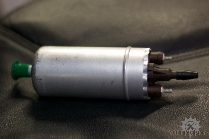

McMark
post Apr 22 2012, 08:24 PM
Post #425
914 Freak!
Posts: 20,180
Joined: 13-March 03
From: Grand Rapids, MI
Member No.: 419
Yeah, disappointing, but the car otherwise ran great and handled AWESOME! (IMG:style_emoticons/default/smiley_notworthy.gif)
New pump on the way. (IMG:style_emoticons/default/thumb3d.gif)
Mike Bellis
post Apr 22 2012, 08:28 PM
Post #426
Resident Electrician
Posts: 8,347
Joined: 22-June 09
From: Midlothian TX
Member No.: 10,496
I had the same problem on a Worblo (sp) style pump. Turns out the pump expands and the mounting clamps do not. CLamps would jam the pump until it cooled. I moved the clamps the the edges of the pump. problem went away

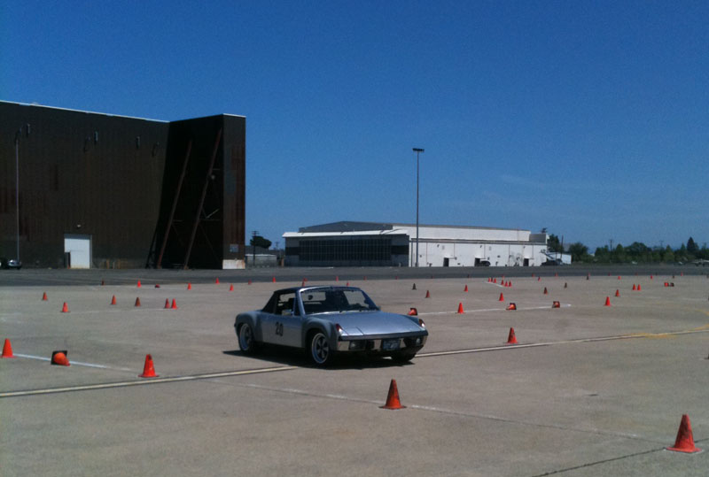

JStroud
post Apr 22 2012, 08:47 PM
Post #428
Posts: 1,463
Joined: 15-January 11
From: Galt, California
Member No.: 12,594
Ya Rob that was a bummer. First time out with the BIG tire.
Here's a picture from his first run
And the second
Don't worry you'll be ready to give em hell next time.
Jeff
