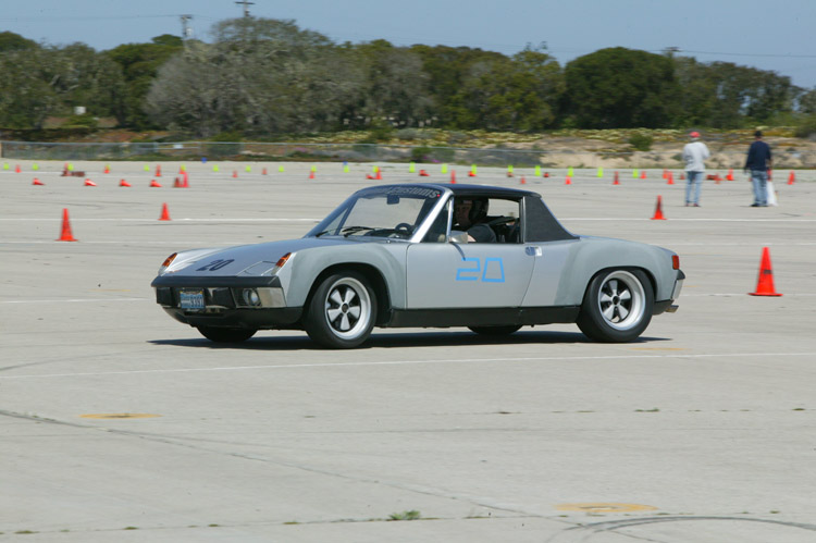

How do you like the 8.5's?
ConeDodger
post Apr 25 2012, 08:49 AM
Post #443
Apex killer!
Posts: 24,246
Joined: 31-December 04
From: Tahoe Area
Member No.: 3,380
QUOTE(Eric_Shea @ Apr 25 2012, 05:27 AM) *
E,
They were a little wide for George's factory flare reproduction. The flares have a bit more of a inside lip than the factory ones. I have often heard it said that the factory flares were of a lighter gauge metal but never that the inner lip was half that of the repops. Fortunately, Mark had a car with factory flares on the project floor at the OC. So when he put the wheels on the car and discovered the 'rub' he checked the other flares on that car and modified the reproduction flares on mine.
I think Mark said there was room for 3/4" inside offset but Harvey may not be able to do that with this method.
The purely esthetic answer to your question is that I love them! (IMG:style_emoticons/default/wub.gif)

Really just wondered how they looked against the inside. 3/4" total or another 3/4" left to go? I would think another 3/4 would max it out.

There is a little room on the inside. Definitely more breathing room than the outside. But you would be hard pressed to max it out unless you were building completely custom wheels and could specifically choose your offset. I did a bunch of measuring and math today based on Robs wheels and decided that if you built a 9" wheel with a 11mm offset and ran a 245 tire it should fit. But everything would have to be just-so and the sidewalls on the tire you buy would be a big concern.

As for the offset, instead of trying to find the perfect offset, one can simply use long wheel studs and spacers to get the wheels just right.
Not really. The 911 8's (x15") are very close to the lip generally. Adding a spacer would simply put the tire into the fender. The 9's are even worse as the extra inch comes on the outside. If you look at the factory cars with 9's they had the fenders pulled. Knowing this going into it, you can mount the flares out a bit.
With the 8's there seems to be about an inch plus on the inside. Spacers won't do much good in helping maximizing that useable space. I tried a custom 9 that was an 8 with an inch added on the backside. My tires rubbed. That's why the 8.5's came to be which is why I was wondering how they fit.
Stock flares can be tough.

I don't think Harvey came up with this by accident. These 8.5" wheels fit like a glove. Last I talked to Harvey, he said he could take my fronts and add an inch to the inside to make them 8"...
I had little time to fool with pressures at the event on Sunday so I just told Mark where to start. He must have done some reading because he told me after his first three runs that the car was pushing. I said to either add air to the rear or take air out of the front and he already had! That burger boy learns Mcquick! (IMG:style_emoticons/default/biggrin.gif)
