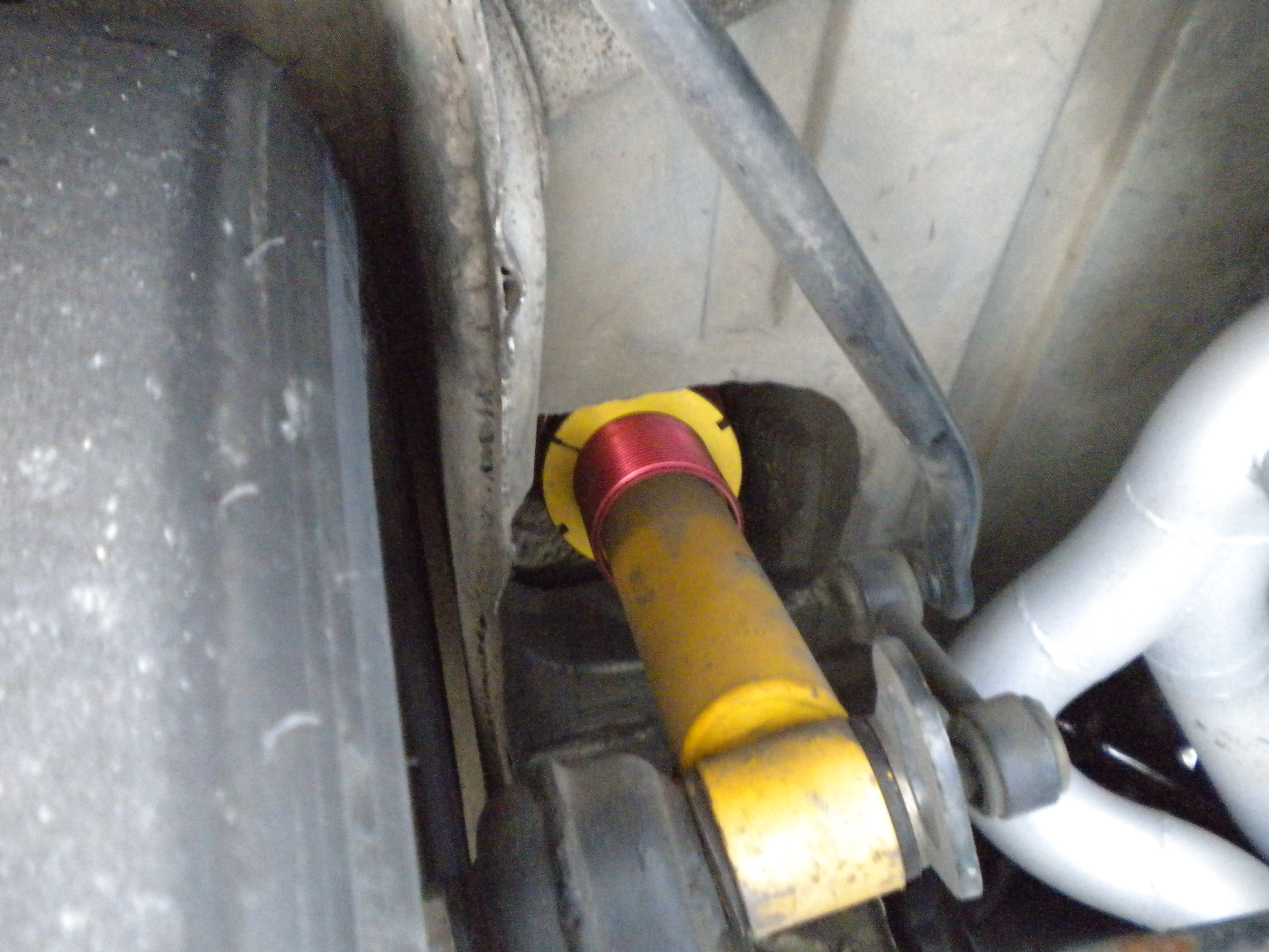

Hope this shows what you want Eric... (IMG:style_emoticons/default/smile.gif) The fender wheel arch flange was too close for Mark's comfort and I am sure mine (I wasn't there to see it). I guess there is much more flange on these reproduction flares than on the factory original flares. As you can see here, Mark has done some very nice trimming to make wheel rub a non-issue...

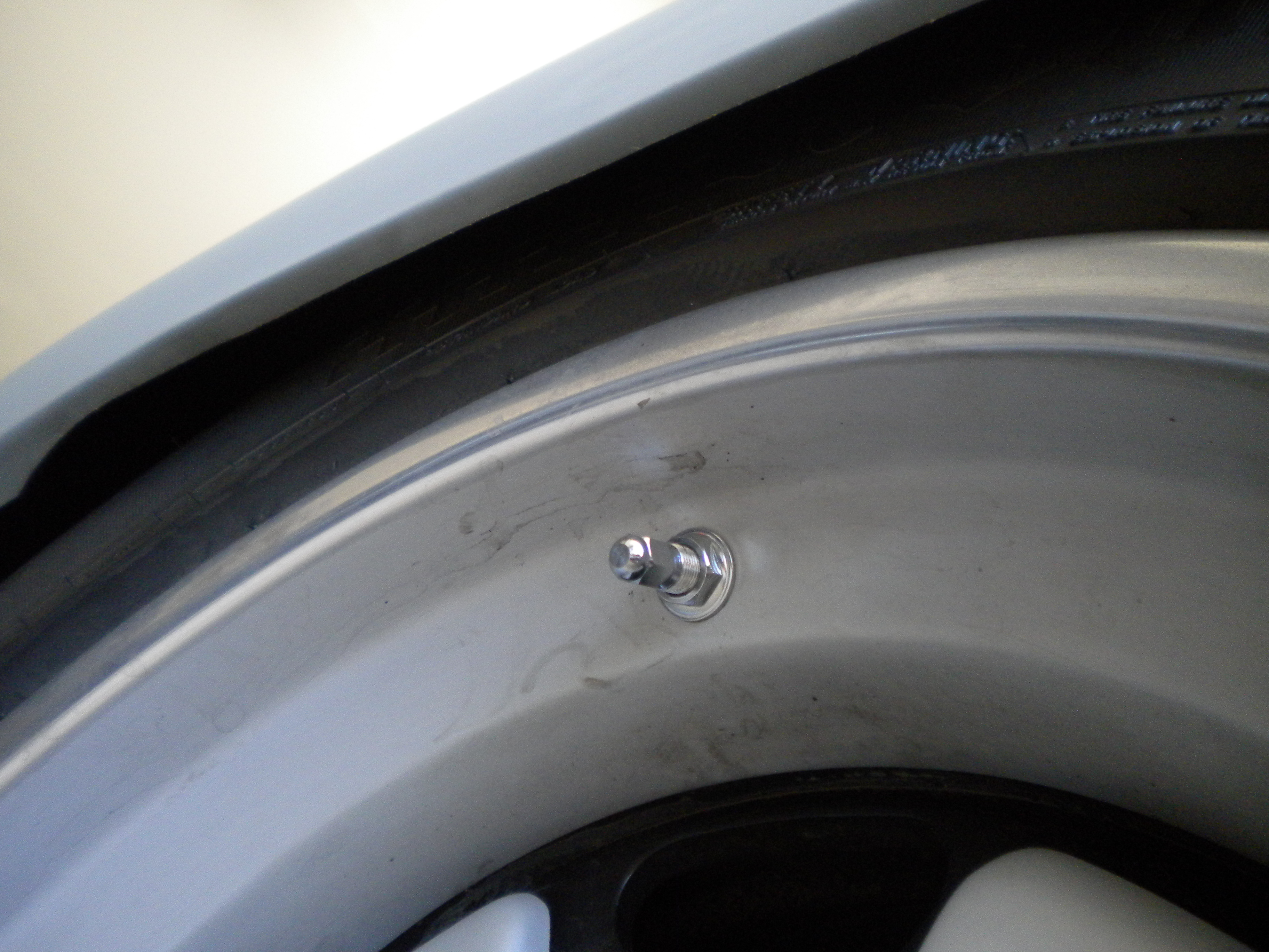

Another... Looks like plenty of room but as we know, the car gains negative camber under acceleration and suspension squat. I will pull one of the rears and see if there has been any rub...
I would say that Harvey knows exactly what he is doing. I had thought 8.5 was all he could do with the 2 - 16X6 wheels he used to make these wheels. Now I believe he knew that it was the limit without extending the flares.
