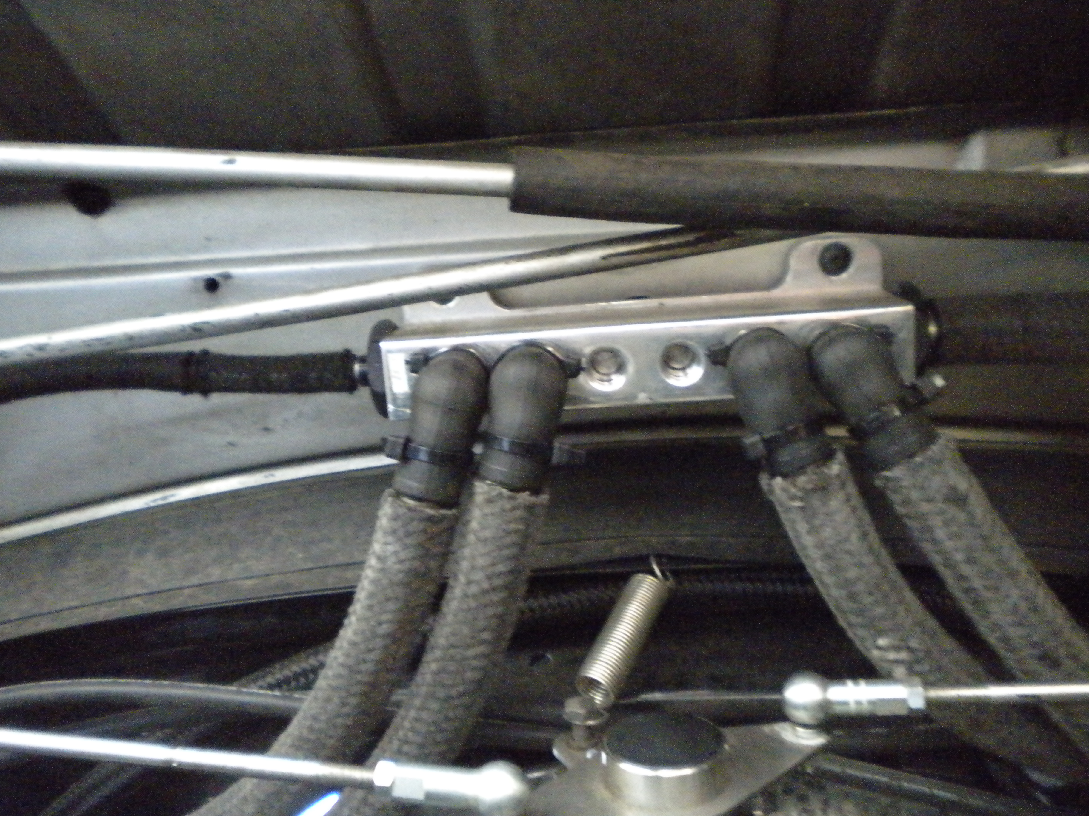

Another tiny little project today: Protecting the elbows from blowing off under intake pops...

Oh, that reminds me. I have doubts that the MAP sensor was damaged because of the hoses popping off. Pressure relief. (IMG:style_emoticons/default/wink.gif)

QUOTE(McMark @ May 22 2012, 11:50 AM) *
I agree, I don't think it is damaged. But besides the elbows blowing off, where is the pressure relief?

No, I meant the elbows blowing off. (IMG:style_emoticons/default/ph34r.gif)
It was a design feature...

Here's a shot of mine....tight fit rubber on barb fittings--I do get the backfire, but not blown any of these off.....smaller diameter than yours...maybe 1/8".

Well the nylon ties are working. Since I made the mixture richer throughout all the 'usable' rpm set-points it has run better. In fact I suspect I am a bit too rich.
One thing I would suggest to SDS would be to write there manual with a tuning sequence. They really don't give you a 'do-this-first-then-do-this' approach in the manual. (IMG:style_emoticons/default/wacko.gif)

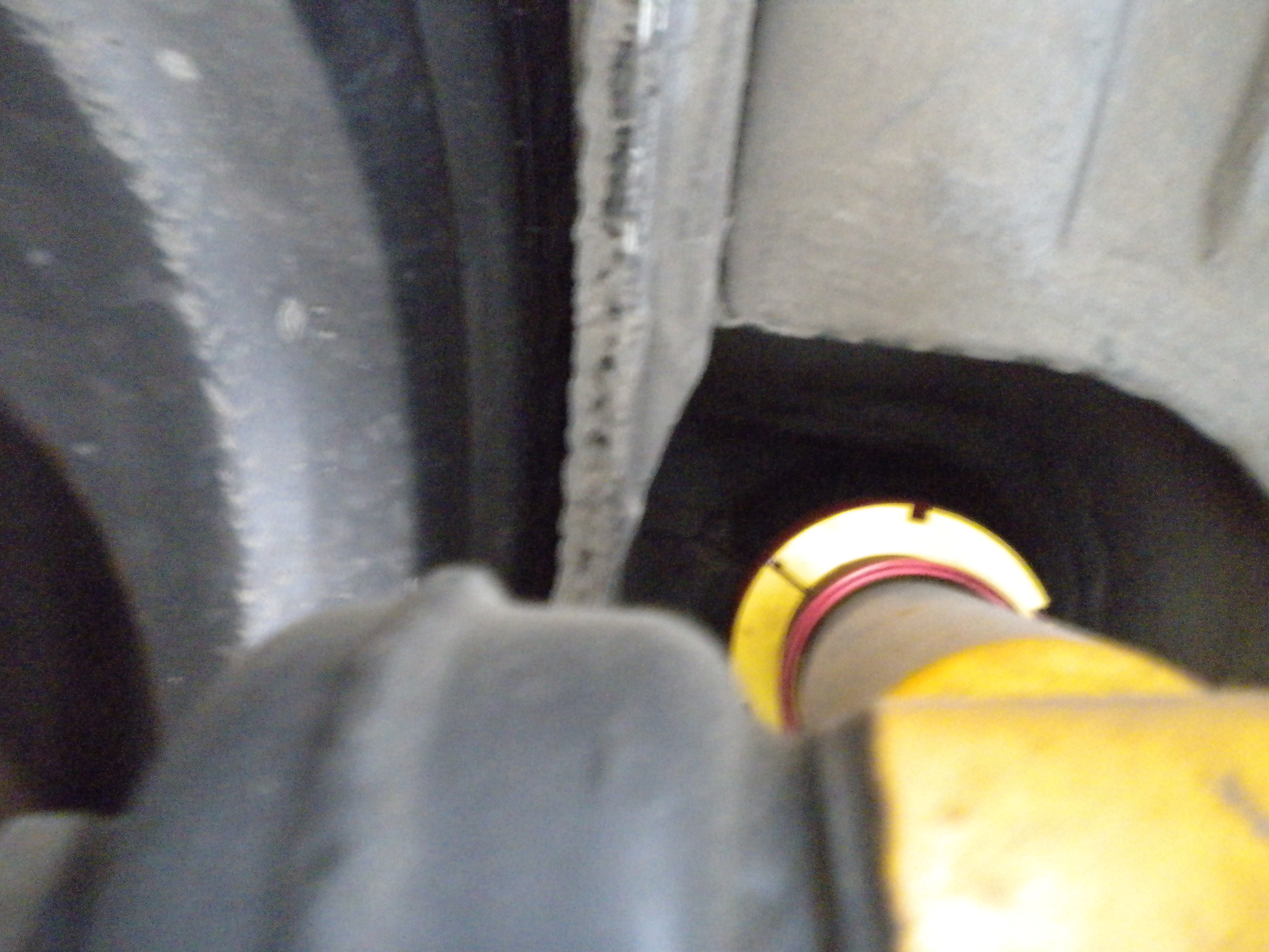

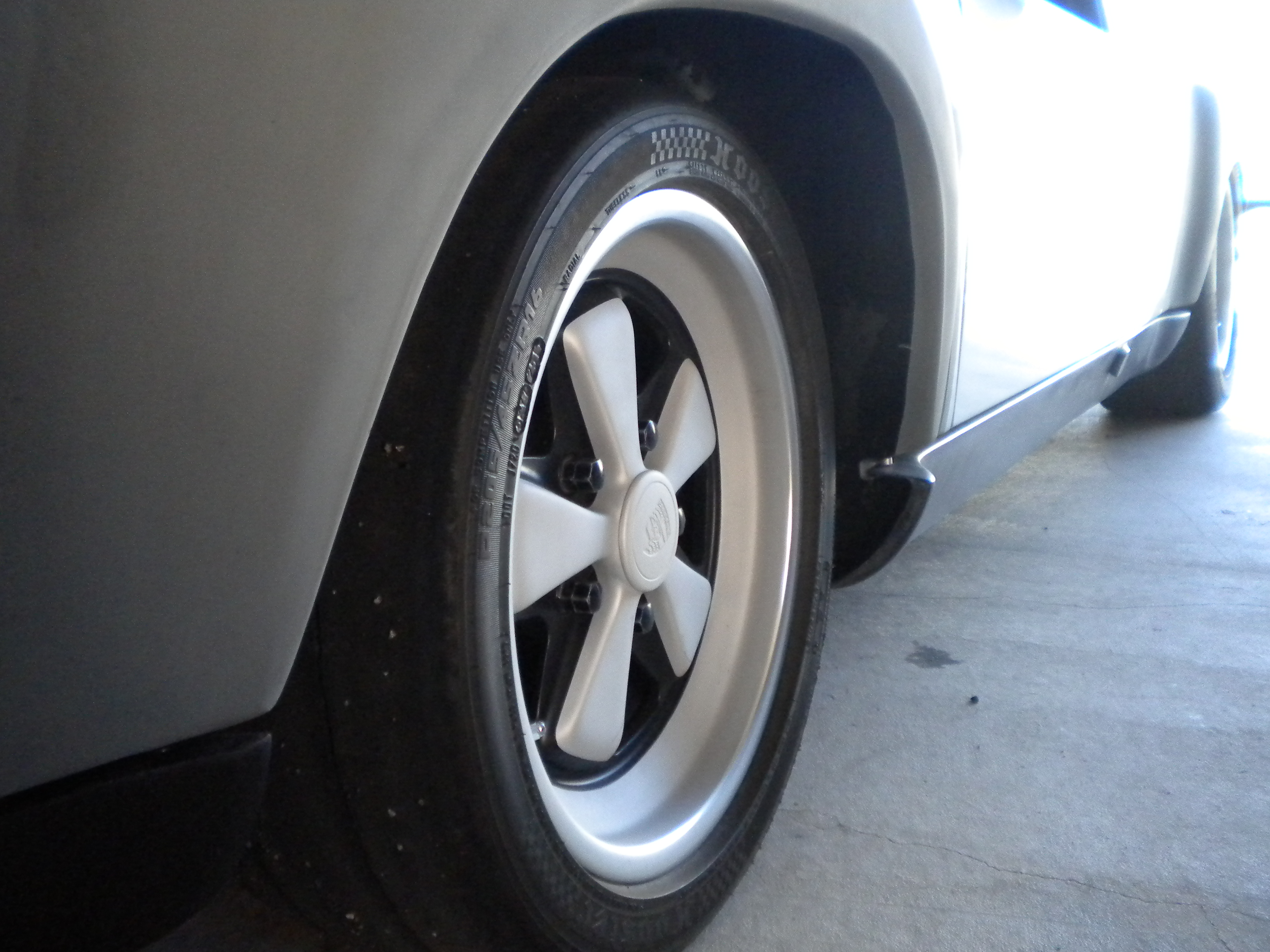

ConeDodger
post Jun 3 2012, 10:26 AM
Post #489
Apex killer!
Posts: 24,246
Joined: 31-December 04
From: Tahoe Area
Member No.: 3,380
A bit of PMB goodness peeking through the wheels! Love these brakes!!! (IMG:style_emoticons/default/drooley.gif) I can't wait for some matching rear calipers!

QUOTE(ConeDodger @ Jun 3 2012, 12:25 PM) *
Need to find spacers for these front wheels though... Maybe 3/4"?
Aren't the 944 spacers 21mm? I bought a set for $25.

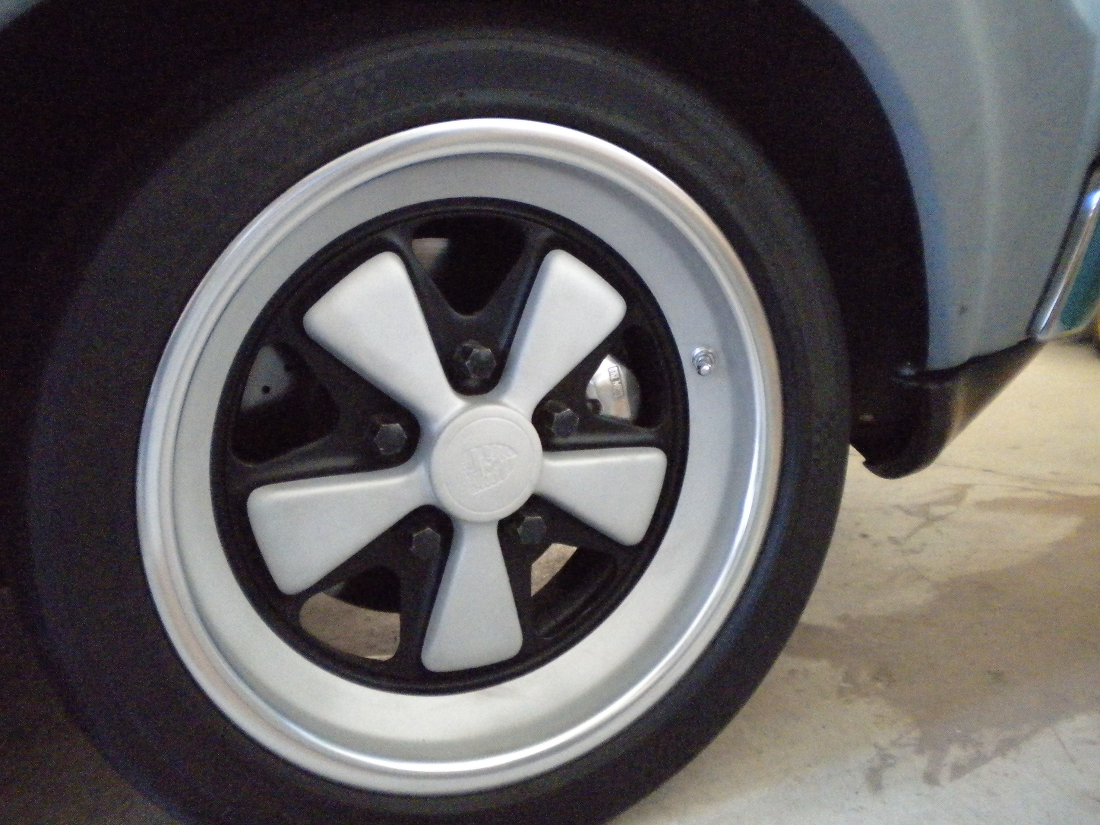

Nice. Yeah, the 8.5 thing simply plays out. I experimented with an inside 9 and it rubbed inside. The inside 8.5 would pull a little off the flare and just clear inside (as your pictures show).
I have another full set ready to send his way I guess. I'll keep the 7's and 8's I have and use those for street tires. Then, as the 911 develops I'll probably move those over there and send those off for 8.5" treatment as well. Seems like the magic number. Actually, I'll have to check the offset on the 911. It might like a set of 8.5's as well. (IMG:style_emoticons/default/wink.gif)

QUOTE(Eric_Shea @ Jun 3 2012, 08:34 AM) *
I'm glad that picture worked for you. I was just about to take another with a ruler for a reference...
Harvey is doing a full polish on a set of 7X16 for the street. His wife Susan is hand painting the crests so it will be full-blown sexy!

Actually Eric, Harvey said he can add an inch to the fronts too. I suspect he puts together some kind of offset that brings it out so it is perfect both inside and outside. That guy has forgotten more 914 tricks than I will ever know. Got to be different than just an 8X16 or he would have just told me to source some and he would RSR them.
