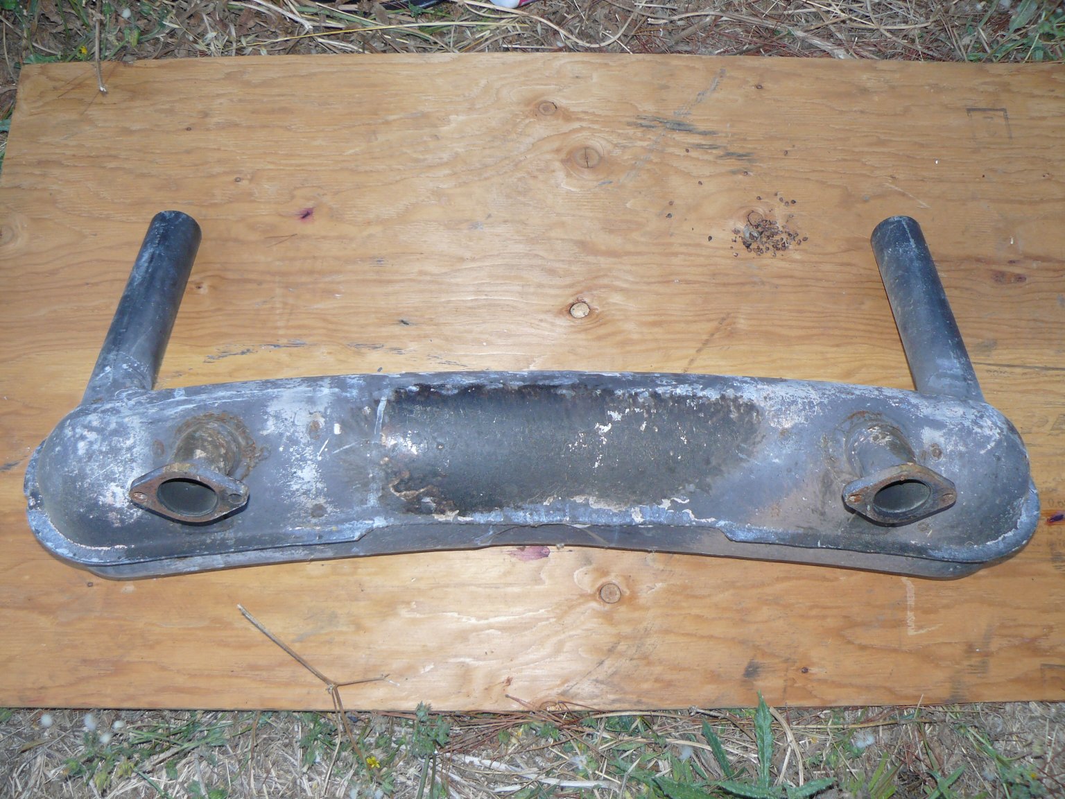

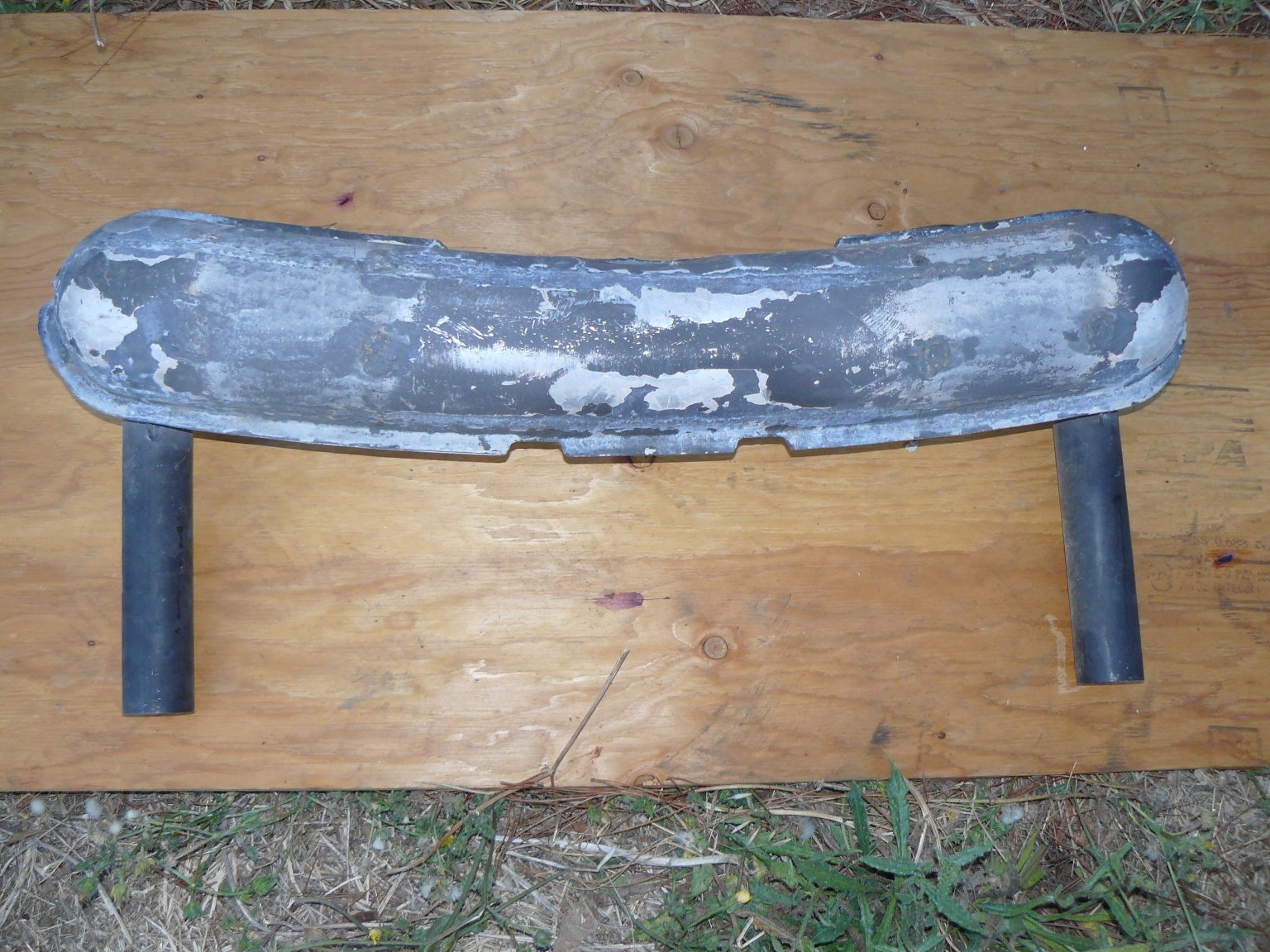

Here's the muffler:
It's a modified, two-in two-out 911 unit.
I believe the internal have been changed to improve exhaust exit flow.
KT

Not sure I like the long pipes. But I suppose that can be modified too. Like I said, run it by Mark. He will be back in the shop next Tuesday... (IMG:style_emoticons/default/biggrin.gif)

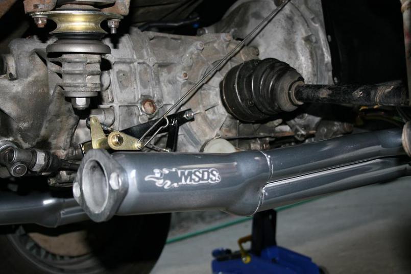

Picture stolen from Martin Schneider... What I think my headers will look like!
Trekkor
post Aug 22 2013, 09:17 PM
Post #707
I do things...
Posts: 7,809
Joined: 2-December 03
From: Napa, Ca
Member No.: 1,413
I have those same headers, just not coated.
KT

Probably flows pretty good, but might be too loud... (IMG:style_emoticons/default/confused24.gif)

A little clean up, shorten the pipes and hit it with cold galvanizing compound and that muffler will be badass!

QUOTE(Travis Neff @ Aug 23 2013, 06:34 AM) *
On my car, it would have to be ceramic coated. Plus, I want to keep the rear valance. It looks like those pipes are high up. Mark needs to look at it...

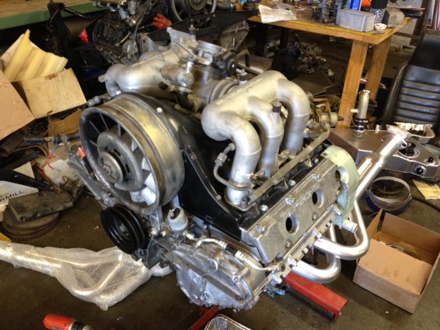

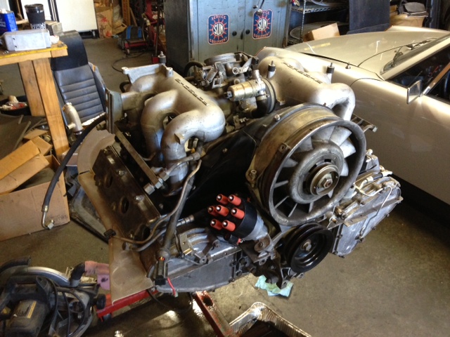

Went down to the OC today. Work was in progress on a couple of tasty projects. An engine/transaxle was on its way out. For what I never asked. A 2002 was getting a new headliner... And I was there to make my clean 3.2 engine look, well.... More like an engine!
Made a good deal of progress. The 'tin' that can go on, is on. Some can't because the on engine oil cooler has to be modified. The intake is on. The breather has a new gasket. I put one of the headers on. Can't put both because the engine can't be spun on the stand with both... (IMG:style_emoticons/default/blink.gif)
Looks more like an engine now. (IMG:style_emoticons/default/biggrin.gif) Oh, and yes, that is the oil tank in the background...
