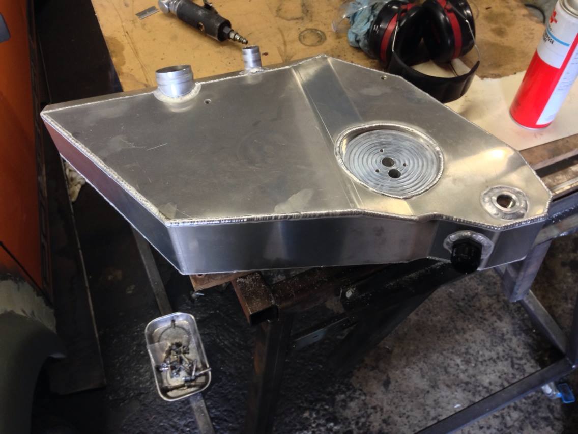

Time to make some progress. If you have followed along, you know that we are putting an 87 3.2 Carrera motor into my 914. Today, we put in the oil tank.
We are using the Patrick Motorsport oil tank. There are alternatives. But I wanted a tank in the stock location, and the OEM tank though available new, is expensive. The DW Design tank is NLA. I would have loved to use it.

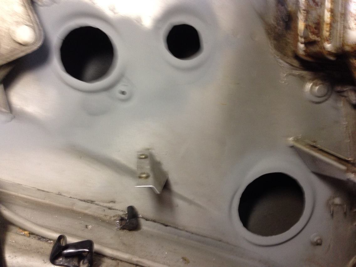

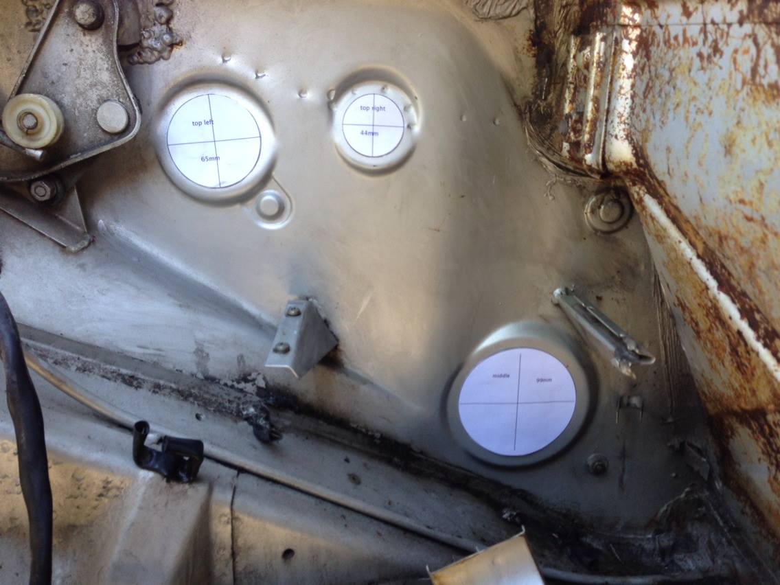

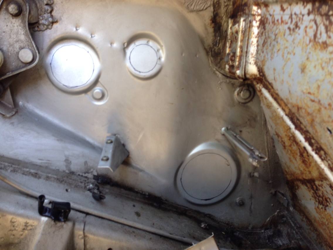

The first step in putting in an oil tank is some preliminary work. The relay board and 'hair dryer' fan are in the way. Unscrew the relay board and set it aside. Remove the 'hair dryer' fan and sell it or give it away. McMark has a template file for the holes that have to be made on his computer. George at AA sells a book on conversions and it includes the template. The AA book has gotten a little dated, and though I have it, I chose to use McMark's templates. Here you see the little circles taped in place and then, using the circles as a guide, I traced a Sharpie circle around them...

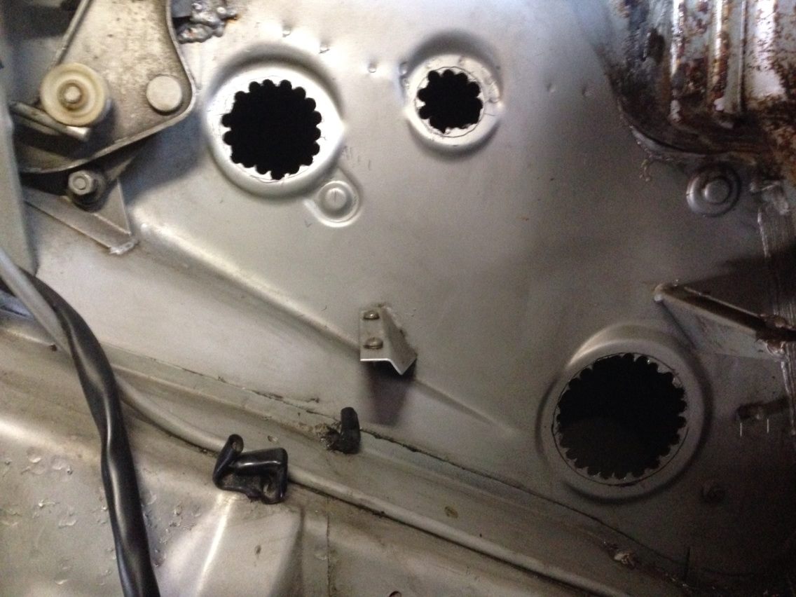

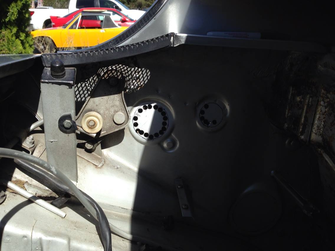

Hole saws are available, but McMark feels that you get a better result by drilling holes inside the diameter of the Sharpie outline. Once holes are drilled around the perimeter, you use a Sawzall to connect-the-dots and make a hole. Finally, a die grinder cleans it all up. Don't forget to squirt a little primer to keep the dreaded 914 'standard-equipment' rust at bay!

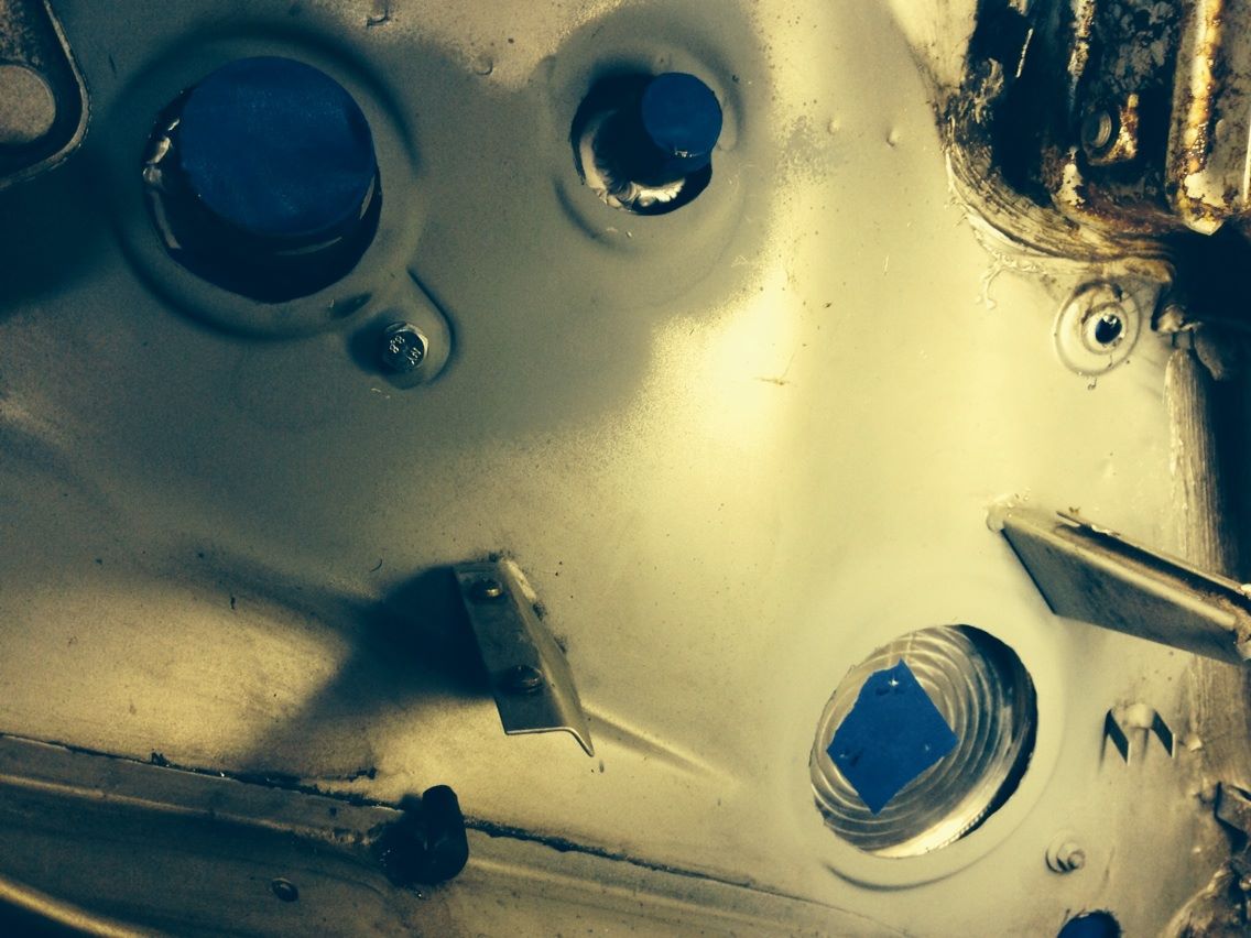

Once you've drilled the mounting bolt holes and hogged out the four tank holes, it's time to put in place. We chose to do a temporary install for now. We chose to seal off the holes with painters tape and protect the beautiful surfaces from being marred. The tape will come off when the tank goes in permanently.

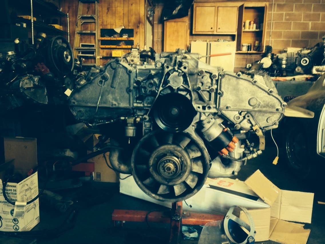

Here you go... I took this one special just for you today. An Australian 911 motor! (IMG:style_emoticons/default/blink.gif)

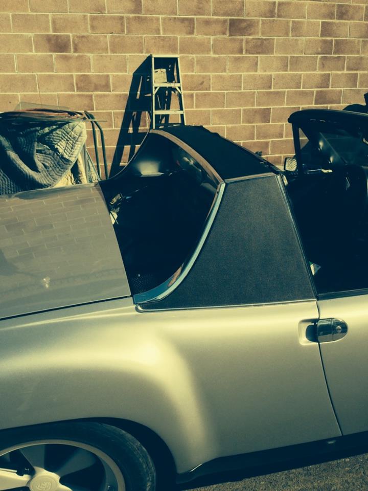

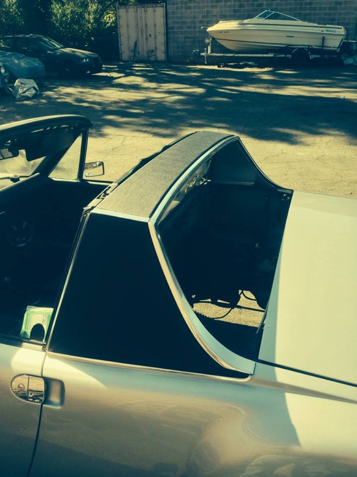

As promised, I put new sail fin vinyl on today. I have nothing significant to add to Eric Shea's excellent write up in the Lapuwalli Classic Threads so I will just show you the results...
