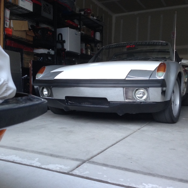

I had a little problem with the way the front Getty hood fit. These are the GT replica fiberglass hoods with the balsa underframe. When I originally installed them, I discovered that if I put the hood springs on the lowest setting, it wouldn't cause the hood to jump up violently. I thought that it might work. But the sides of the hood stood about 1/4" proud of the fenders. McMark suggested eliminating the springs and going with a prop or? So, I tried it. The fit is now pretty close to perfect. I like it... (IMG:style_emoticons/default/biggrin.gif)

For comparison, this is from that photoshoot a couple weeks back at the Truckee River. Notice the way the hood stands up behind the headlights...
