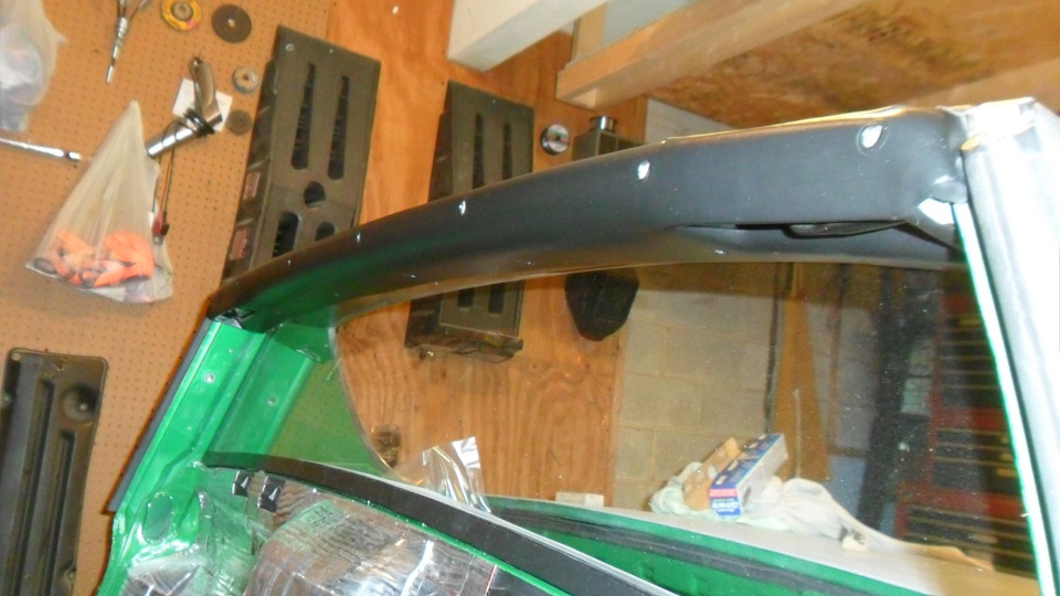

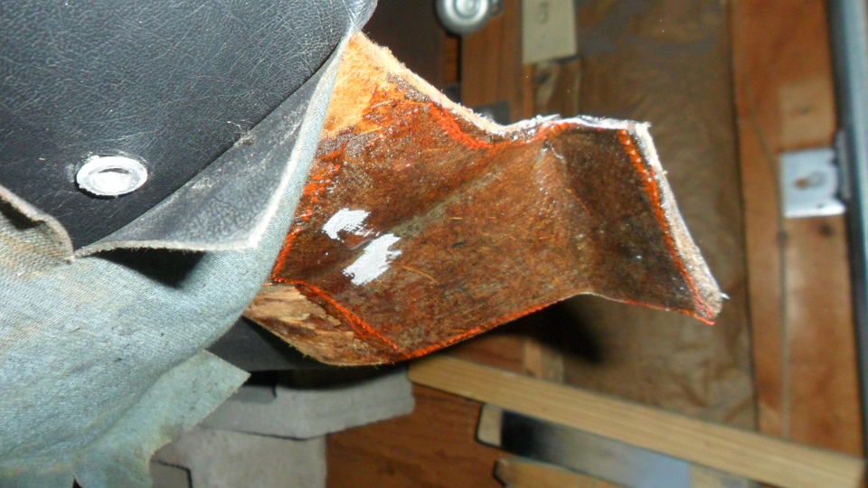

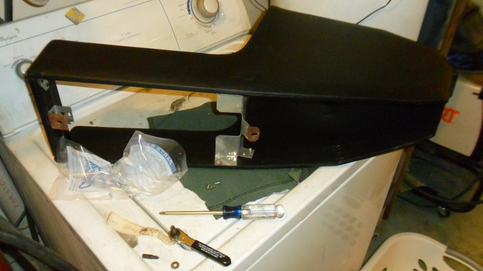

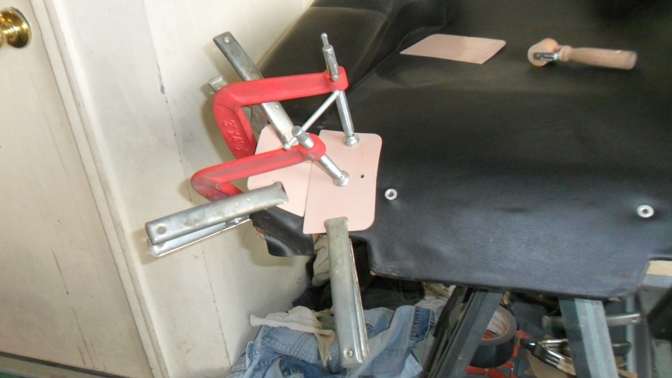

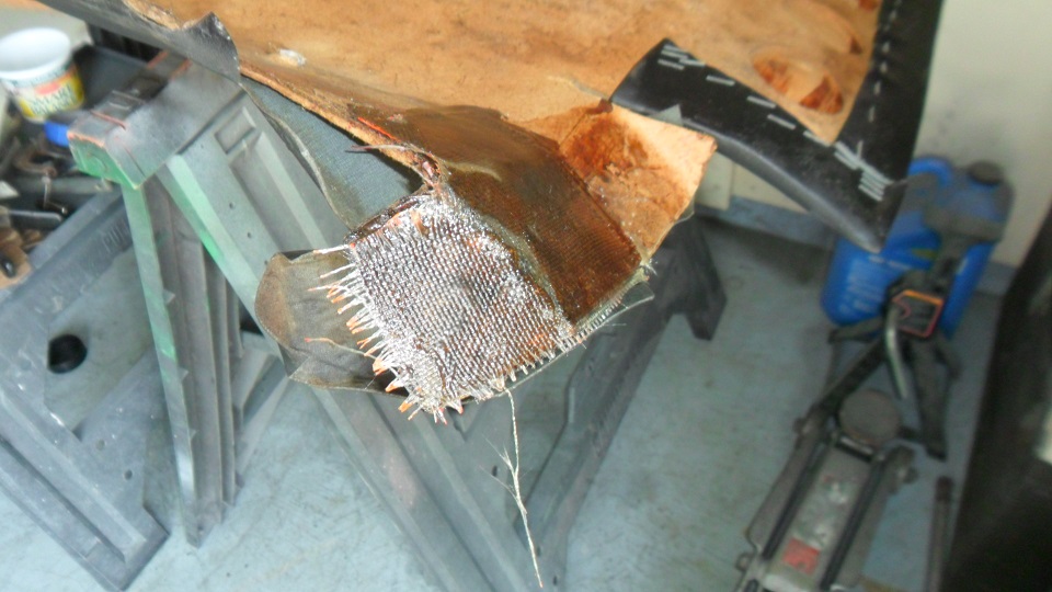

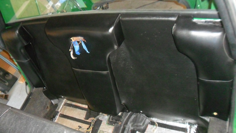

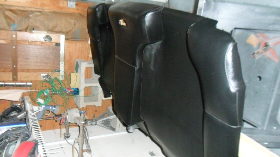

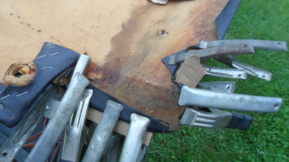

Took a look at my backpad. Overall, it is in decent shape, except for the upholstery coming off the back. One of the bottom corners was broken so I used fiberglass cloth on both sides to re-attach it, then worked my way around re-gluing it with 3M adhesive:

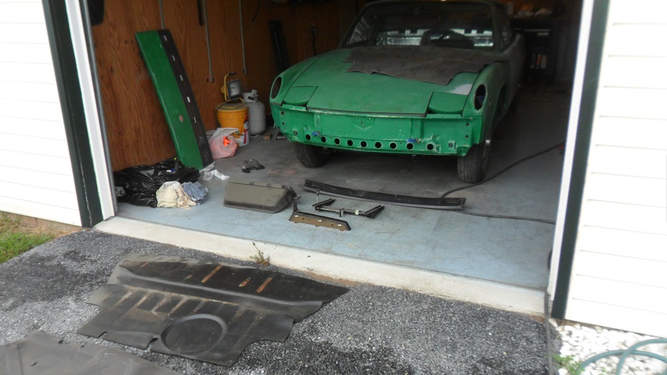

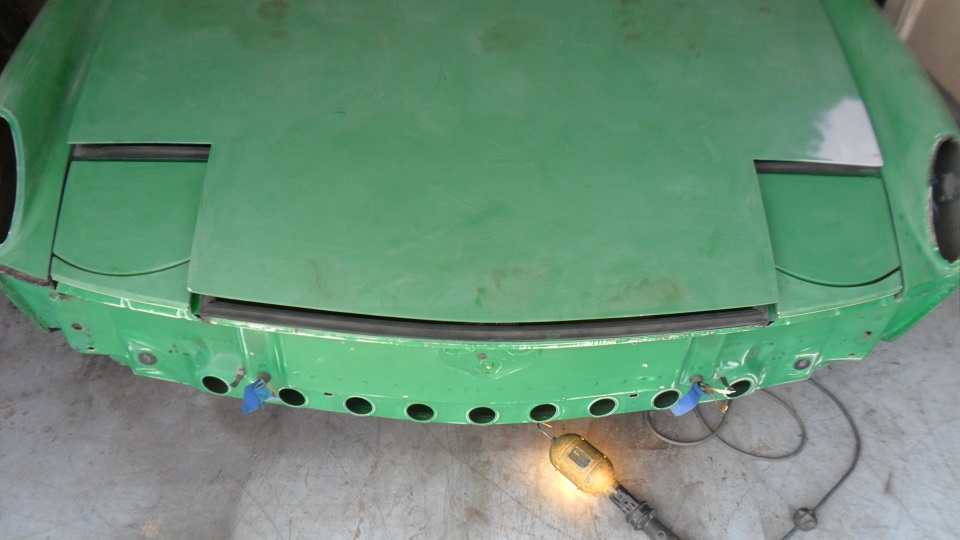

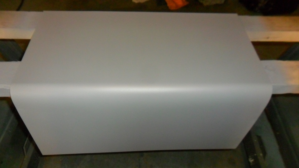

I was not happy with my rattle can paint job on the engine deck lid so I re-sanded it. It will be painted with the rest of the car:
Started sorting out the interior parts. Most were covered in four years of grinding dust. (IMG:style_emoticons/default/mad.gif) Overall my interior was in pretty nice shape. There are a few odds & ends to be addressed after the car is on the road, but I am rolling with what I have. The targa pad plugs didn't stay in, so I picked up a couple packs of 5/16 hole plugs at Lowes - they look good. For the door sills, I went with stainless steel screws. I couldn't resist cleaning the dash:

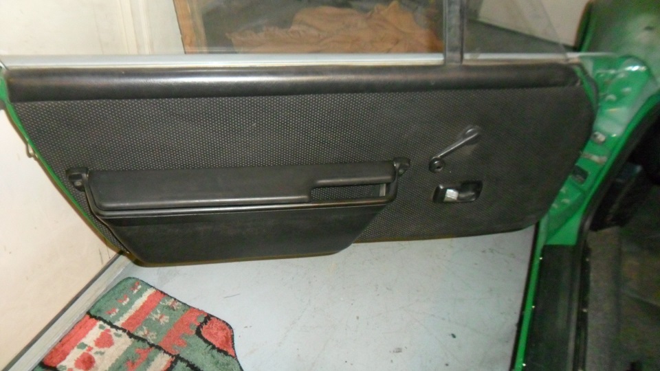

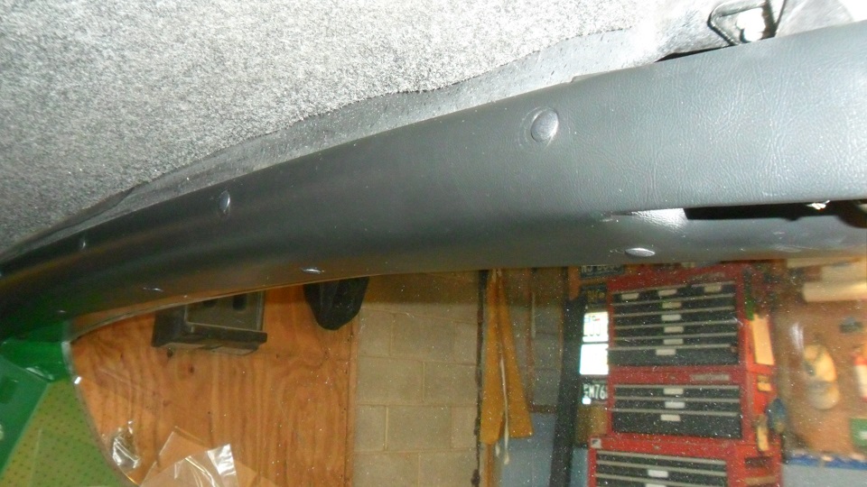

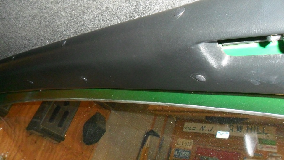

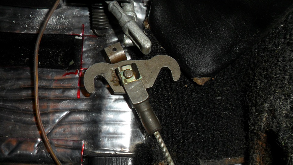

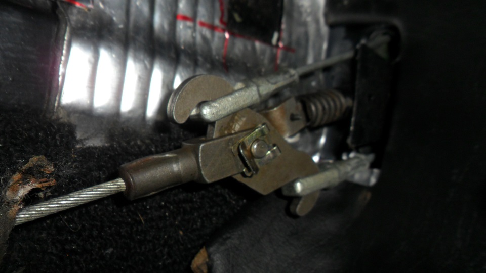

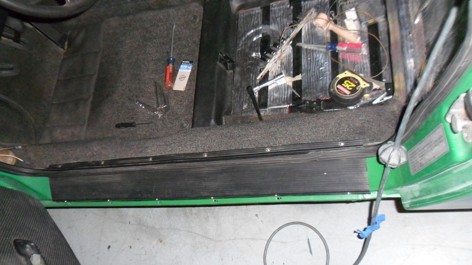

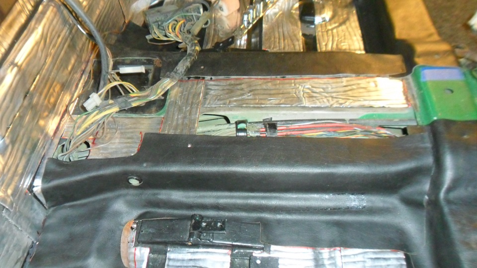

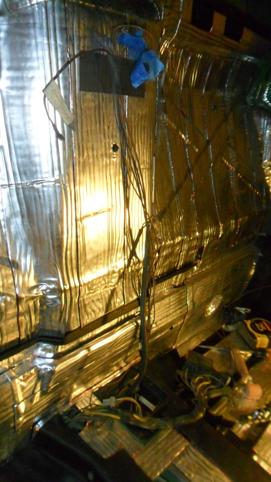

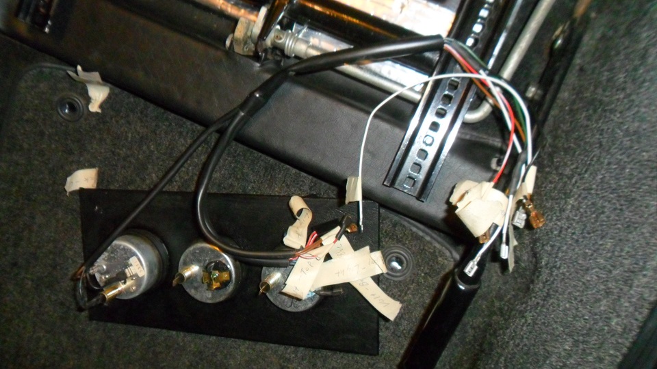

Re-connected the emergency brake cables in the cockpit with help on the from 914 world, completed the installation and adjusted the parking brake:

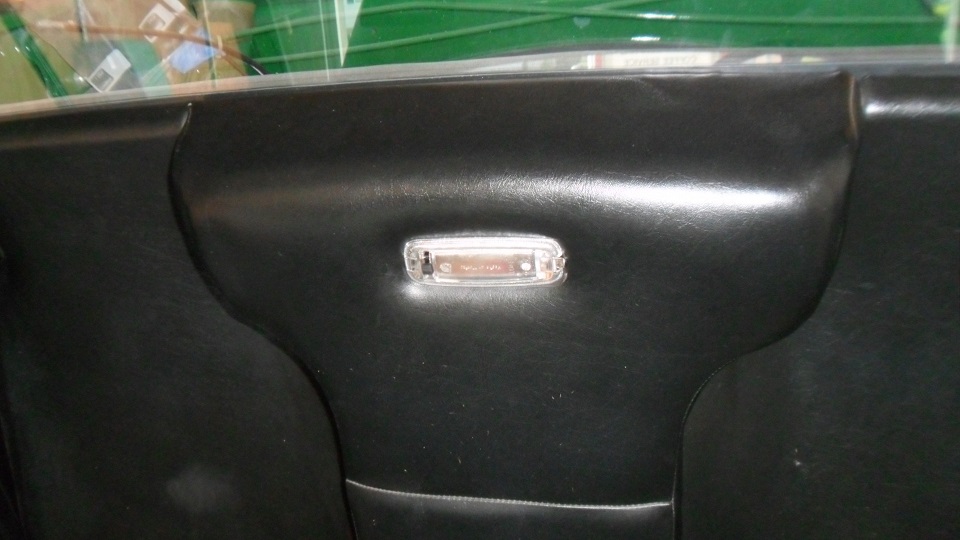

Installed the back pad and dome light, I realized tonight that I have to yank it off again to attach the seat belts (IMG:style_emoticons/default/mad.gif) :

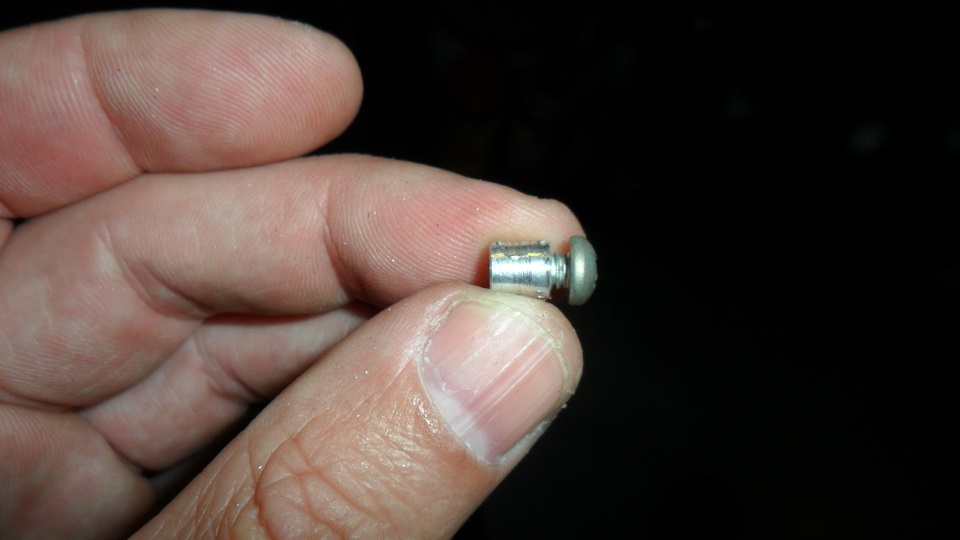

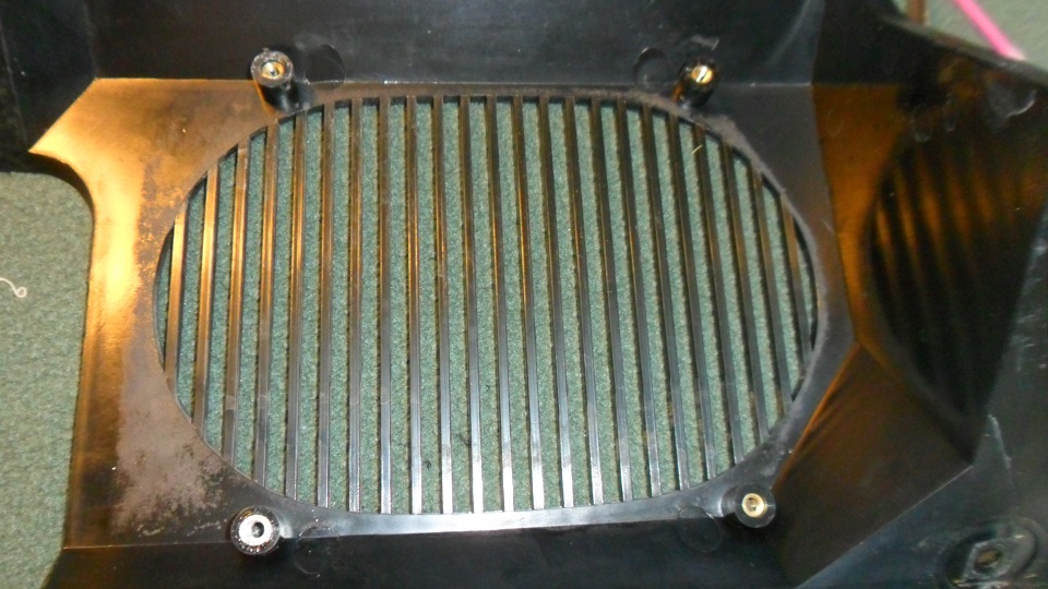

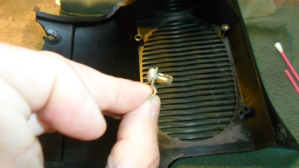

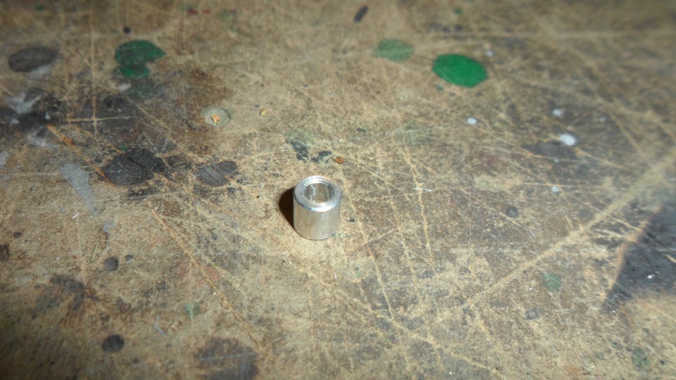

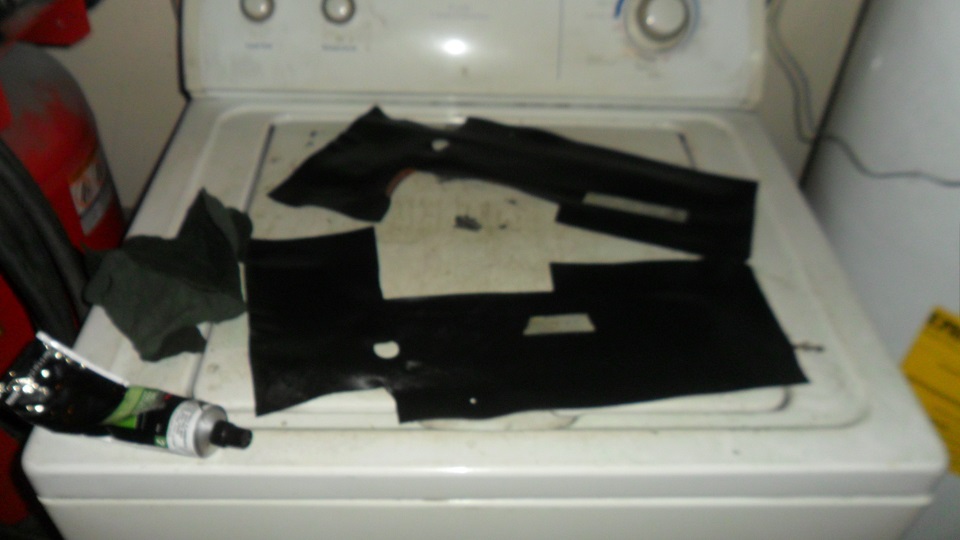

Had to remove the speakers so I could run the grills through the dishwasher. Two of the brass inserts started spinning in the holes. One broke when I tried to remove the screw. Ran to Ace Hardware & picked up an aluminum insert, drilled the plastic out to 1/4" and installed it with a thin coat of epoxy:

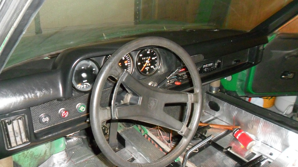

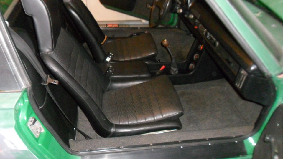

Interior is about 90% installed:

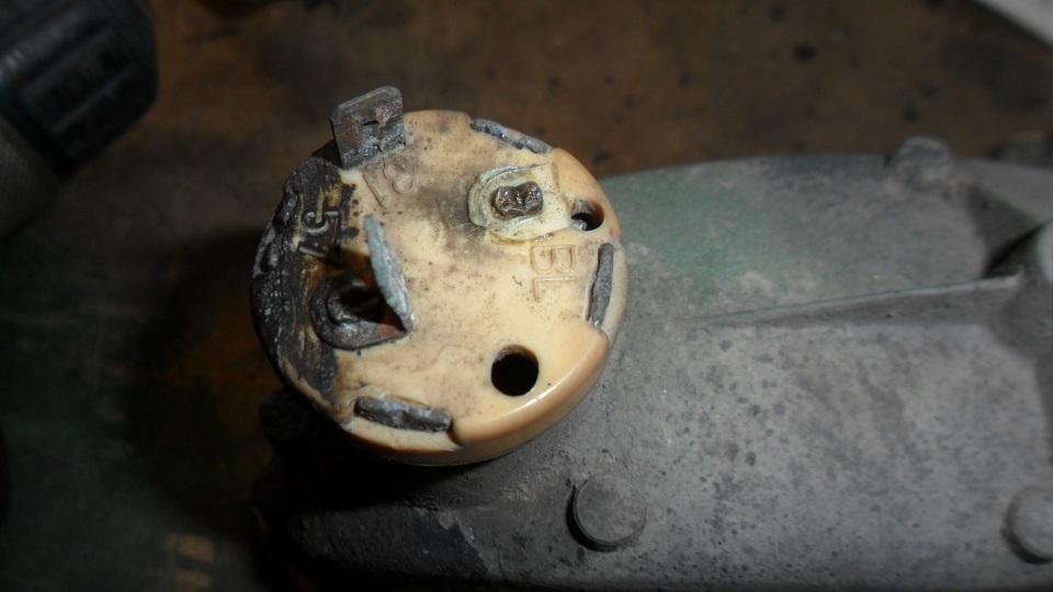

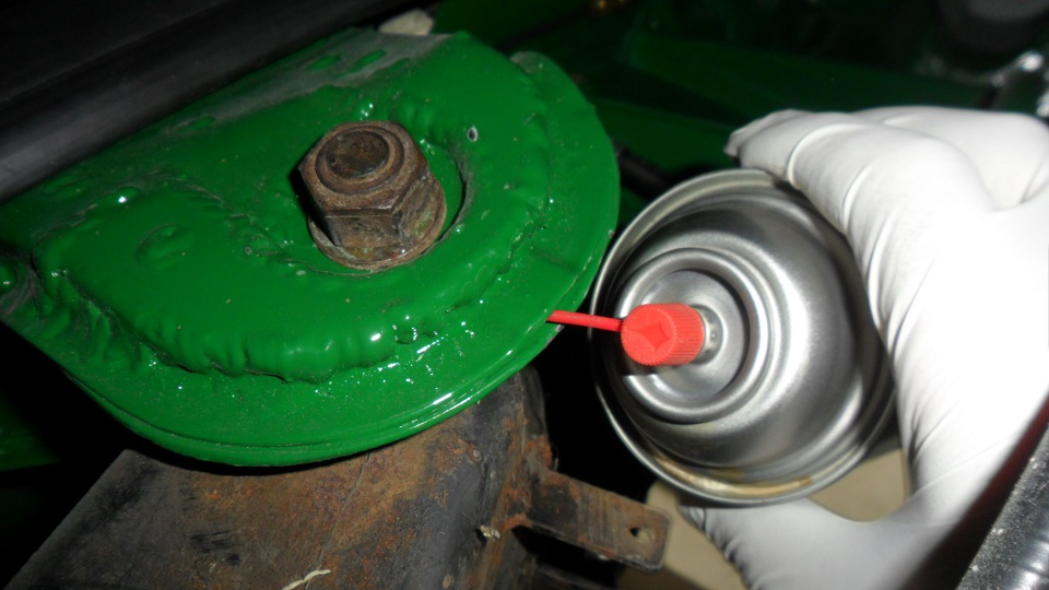

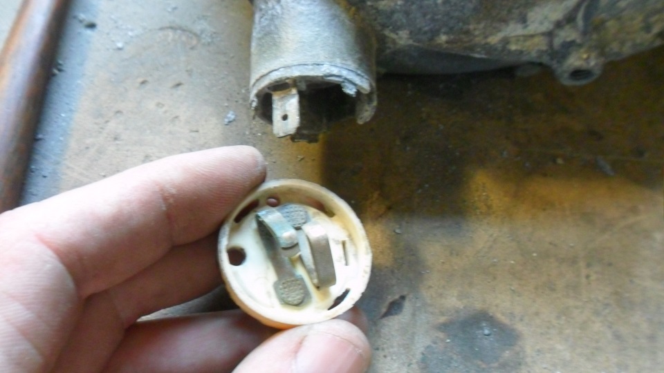

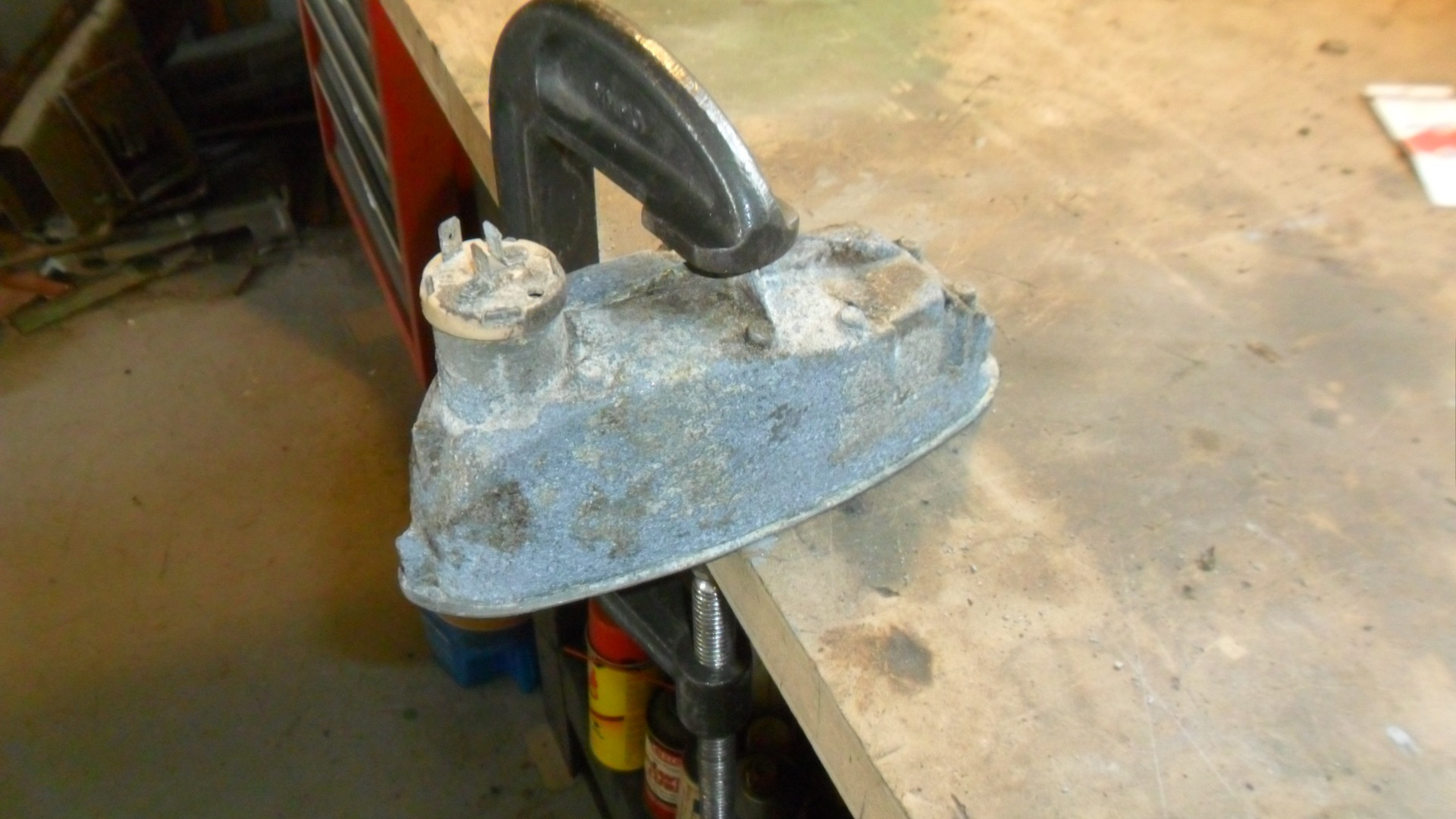

The drivers side suspension arm is plenty strong with the Tangerine racing reinforcement welded on, but I really don't know the condition of the inside of this area. Sprayed a heavy dose of Extend rust treatment in through the drain holes. I will follow up with some Rustoleum:

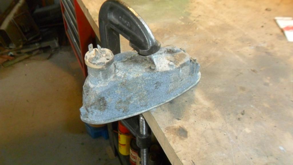

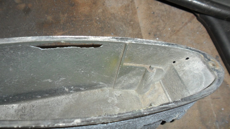

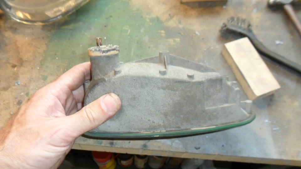

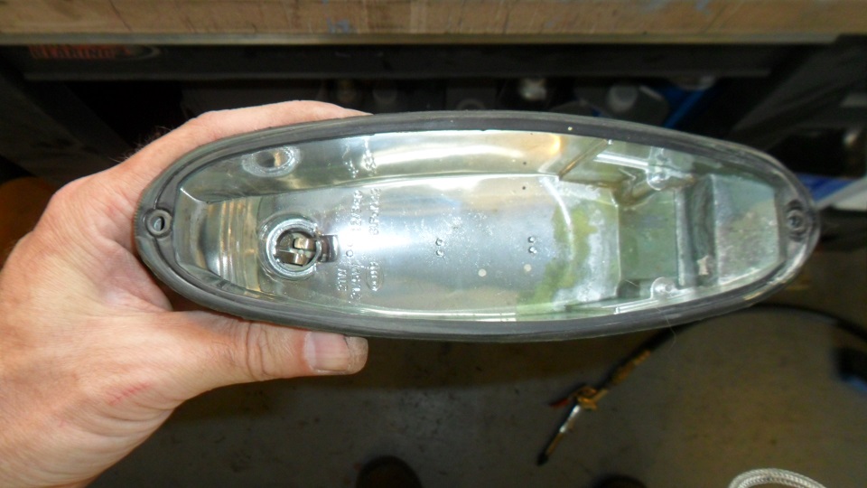

Donald (Hotshoe) donated a front turn signal bucket to the cause. It had some corrosion on it that I wanted to clean up. As soon as I hit it gingerly with a wire wheel, holes started to appear. It had a good plug on it, so I transferred the socket to my old one. Thanks Shoe! (IMG:style_emoticons/default/beerchug.gif)

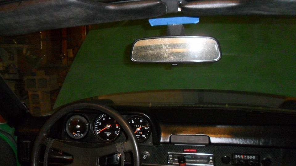

Re-attached the rear-view mirrow with a kit from Autozone:

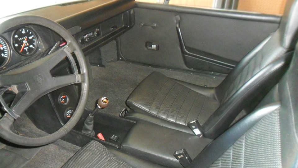

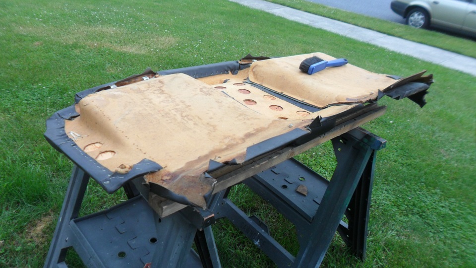

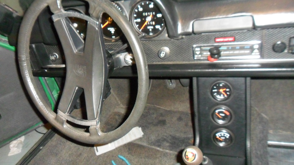

I am pleased with how the interior went back together. The drivers side seat upholstery needs to be replaced, but it will do for now:

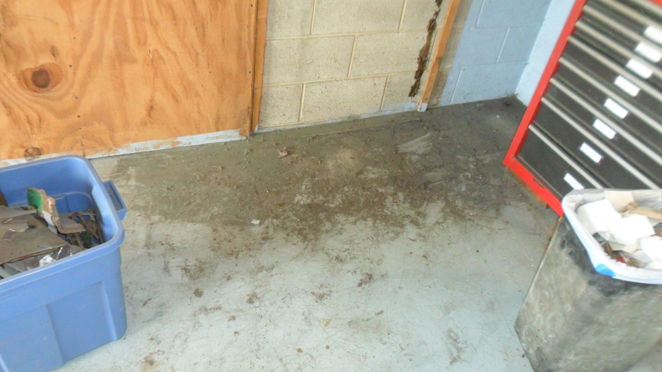

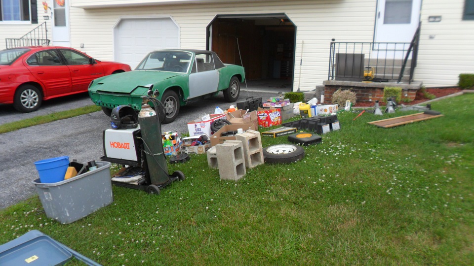

In preparation for paint, I dumped the garage and gave it a thorough cleaning to remove four years of grinding dust. Don't want any of that crap landing on my freshly painted car:

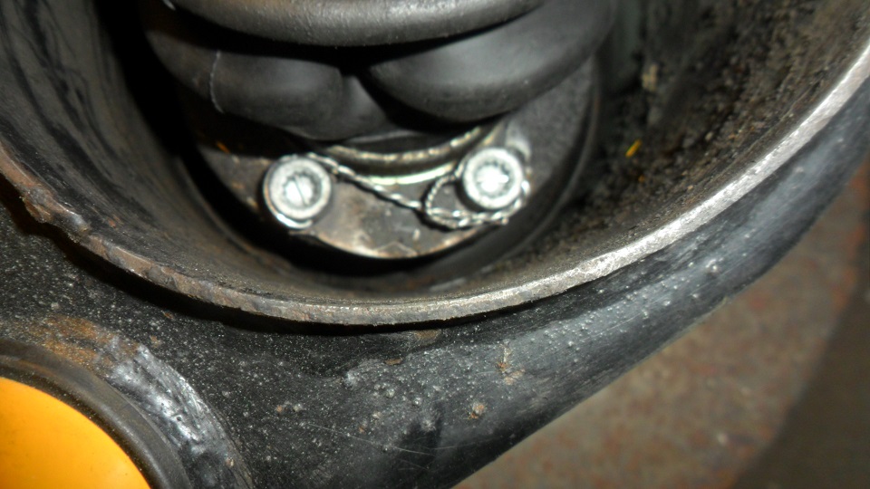

After reading a couple of horror stories on CV joints coming loose, I decided to install the CV's with new schorr washers and safety wire. What a PITA running safety wire in here:

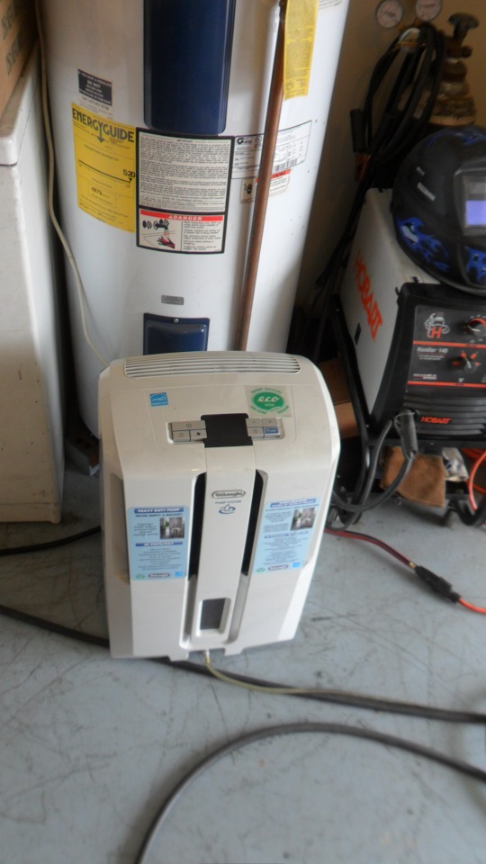

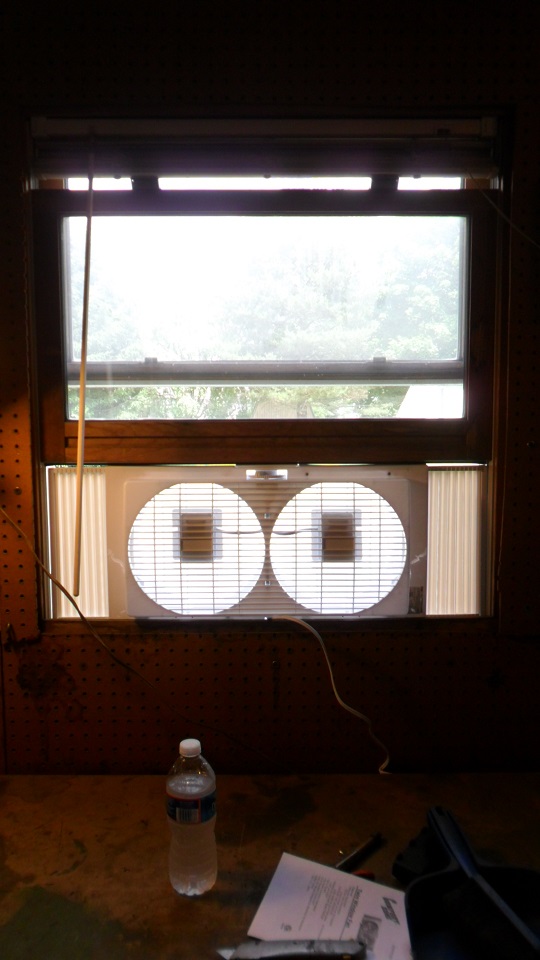

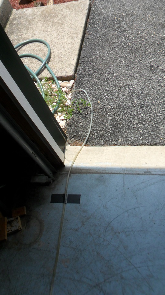

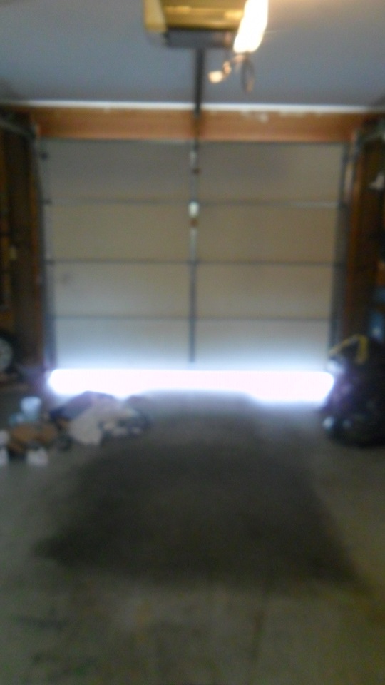

Pushed the car out and made an attempt to turn the garage into a paint booth. Installed a window fan backwards to draw air through the garage and cracked the garage door. Was hoping for a venturi effect, but the fan is not strong enough. Pulled the dehumidifier out of the crawl space and ran the tube outside. It will remove humidity from the garage pretty quickly. Everything running (including the air compressor) was to much for my 10 amp garage circuit breaker, so I ran an extension cord down from the kitchen:

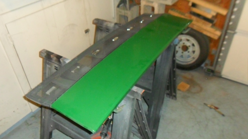

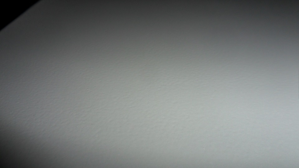

Bent up a test panel for painting with a piece of 2' X 2' sheet metal and prepped it for paint. I am glad I did this before I started painting the car. The $12.99 HVLP Harbor Freight paint gun came with a 1.4 tip that did not allow enough primer to flow. I ended up with a very rough finish shooting primer. I ordered both a 1.7 and 2.0 tip tonight and found it amusing that each replacement tip costs as much as the gun itself (IMG:style_emoticons/default/WTF.gif) . I won't touch the car with paint until I can make this test panel look good:

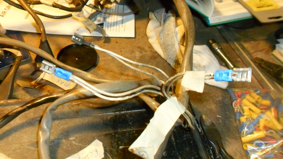

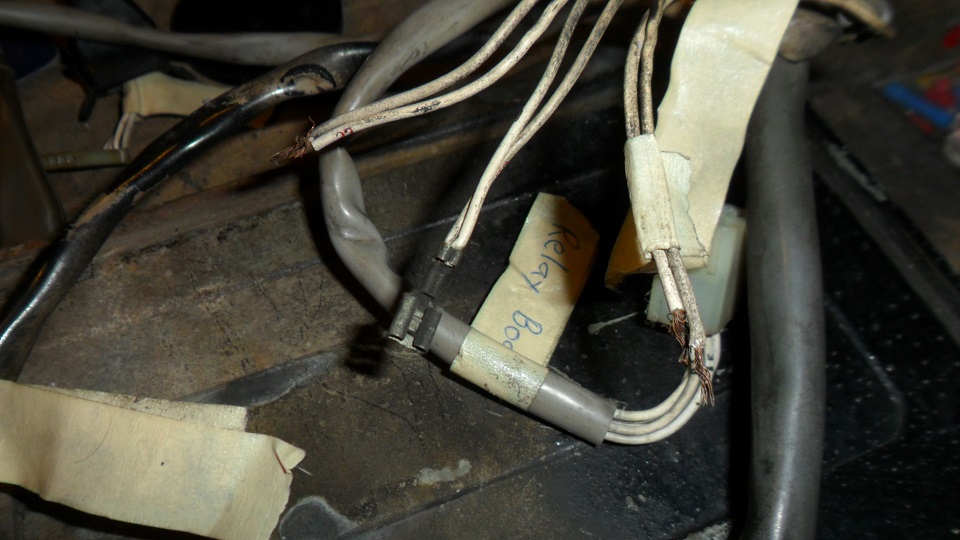

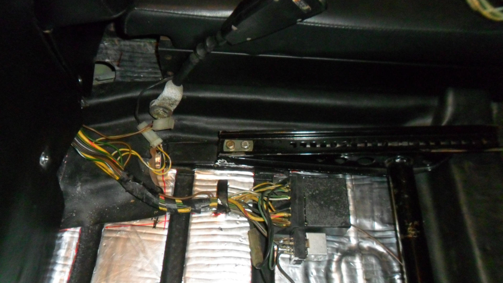

Started sorting put the ECU and MPS mounting & wiring. Picked up the mounts at car shows over the last few years. Had to replace the female connectors on two of the ECU wires:
