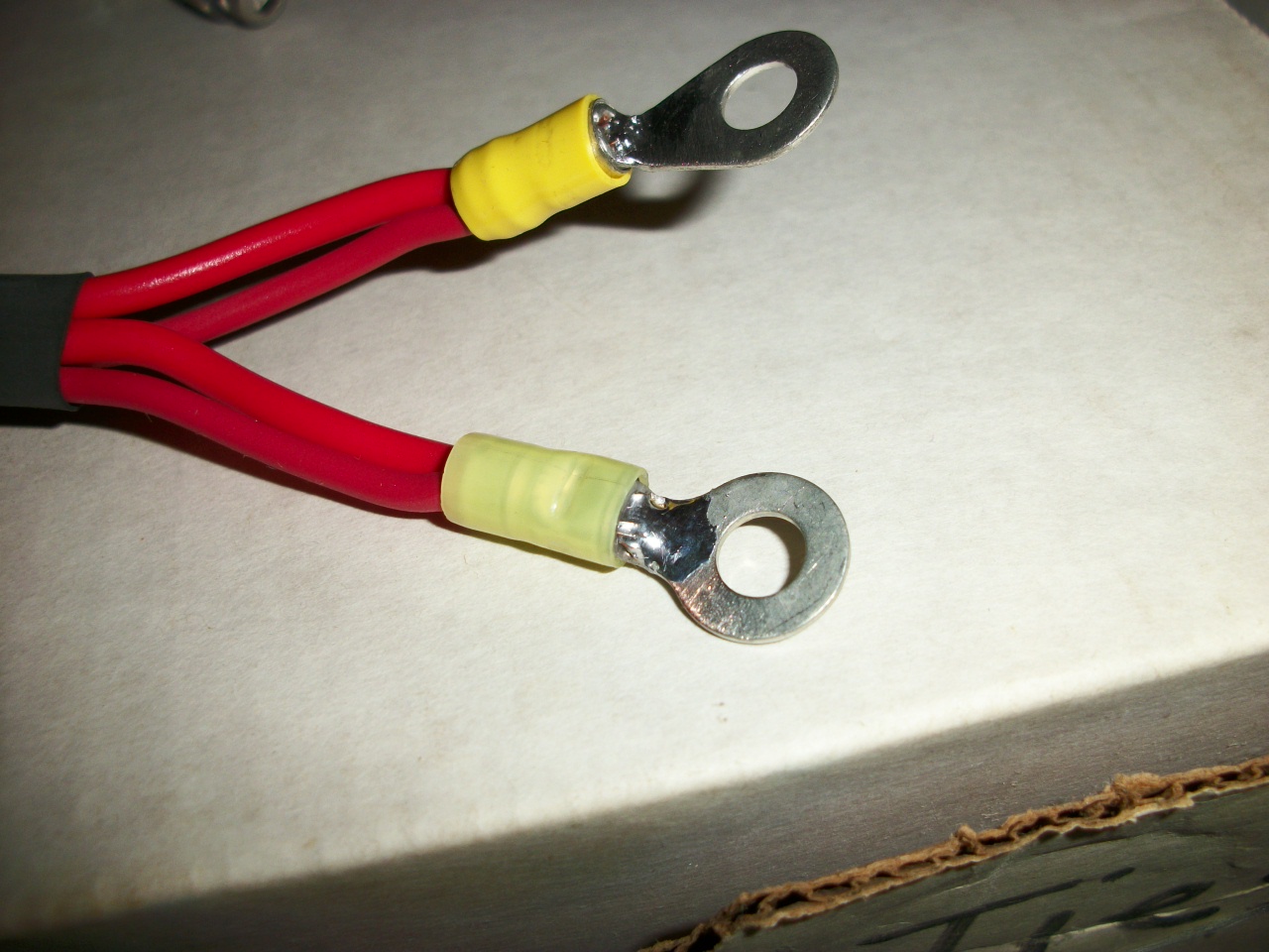

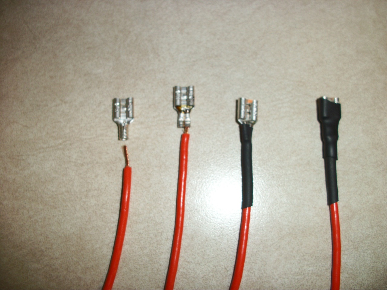

Finally got it finished and tested. (IMG:style_emoticons/default/piratenanner.gif) All good. See first post for installation pics. You may not be able to see from the pics but I used two 20 amp fuses and two 25 amp fuses. Tried the starter, lights, turn signals which are the higher amperage loads, no problems. (IMG:style_emoticons/default/smile.gif)
If you are interested in this kit, be aware that it requires some rewiring and connection of lugs and proper connections are critical. I always use uninsulated lugs where possible and solder them at the lug end of the wire slightly just to be sure of a good connection. If one is careful, even insulated lugs can be soldered at the lug end without damaging the insulation. PM me if you are interested.
EDIT: the wires in the top picture are for illustration only, they are not the correct size.
