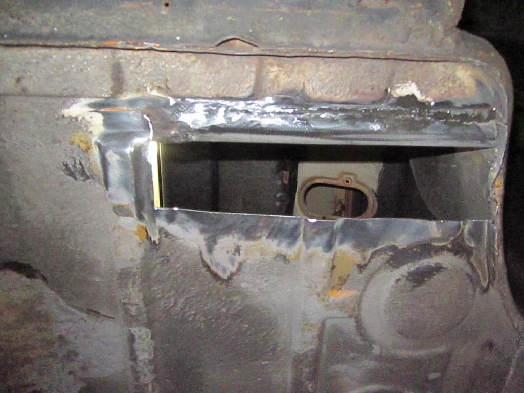

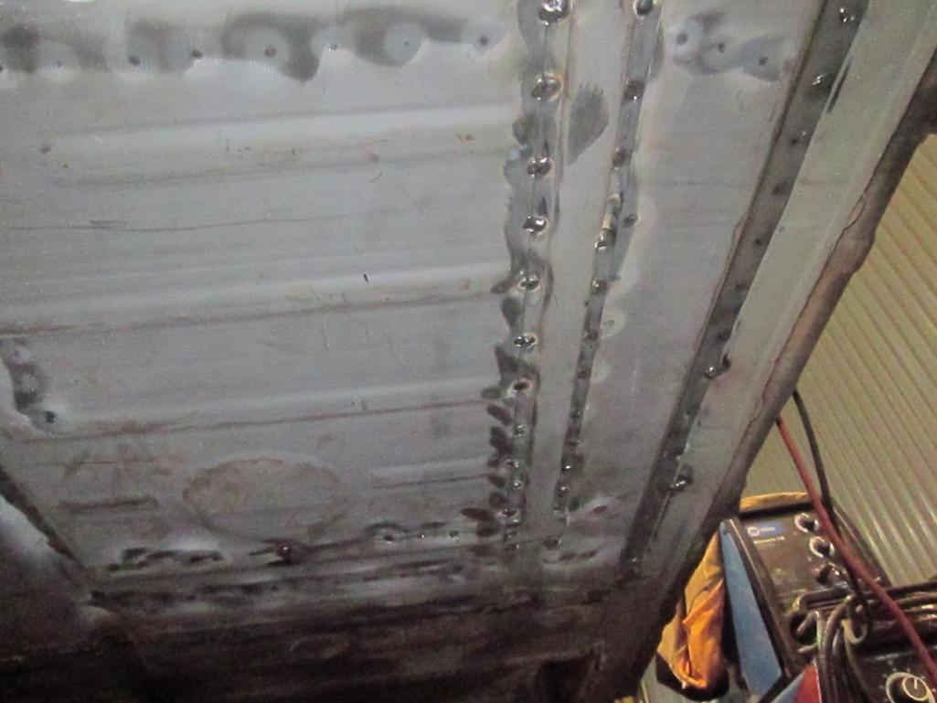

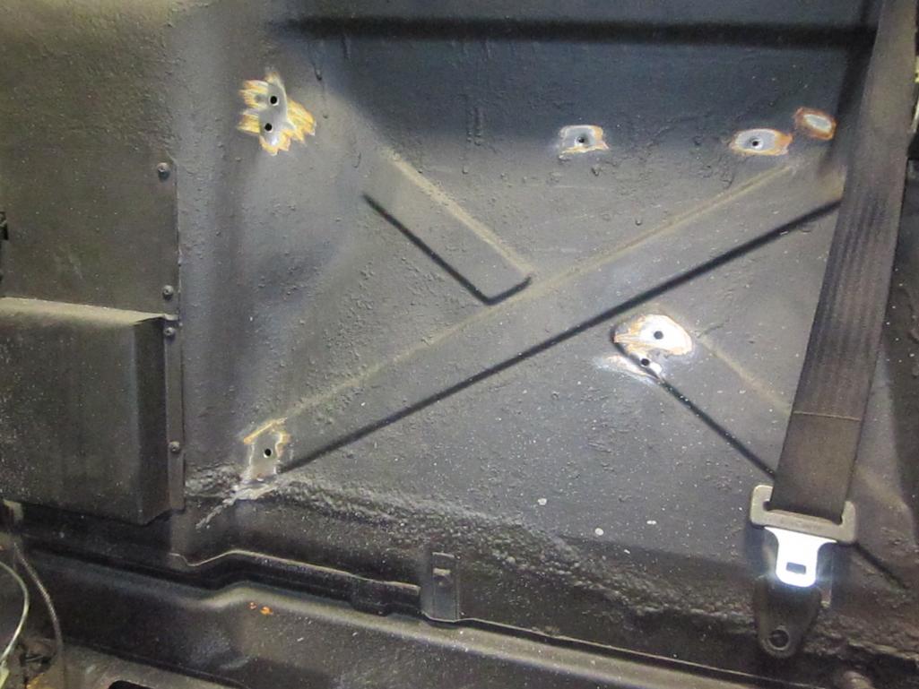

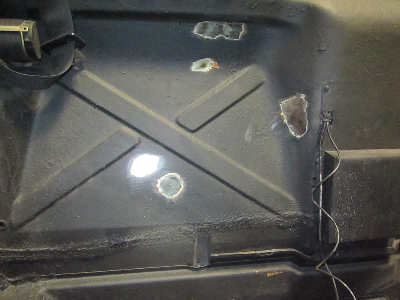

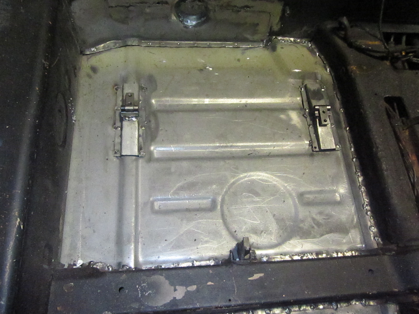

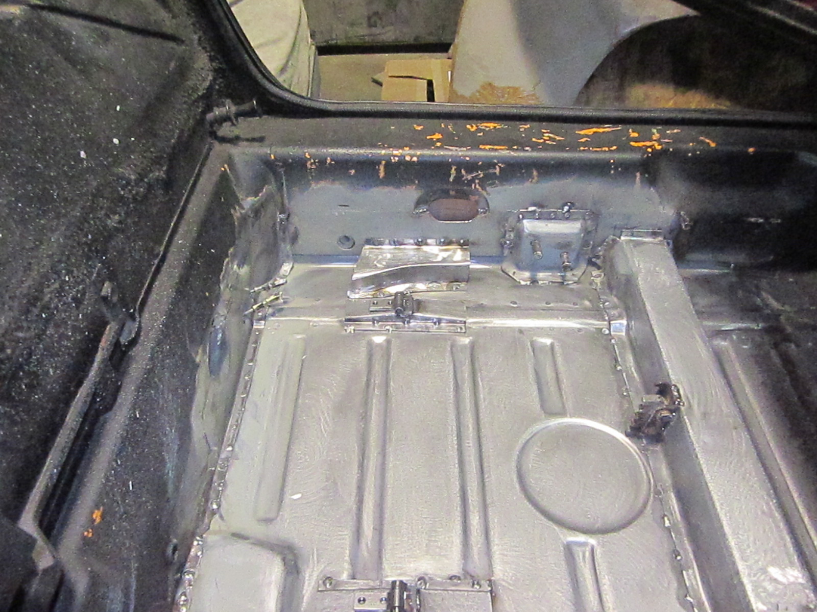

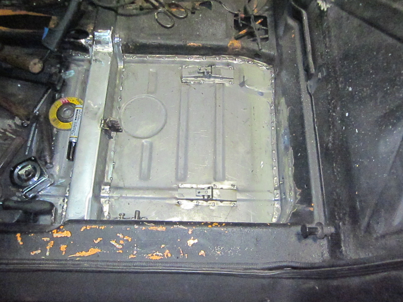

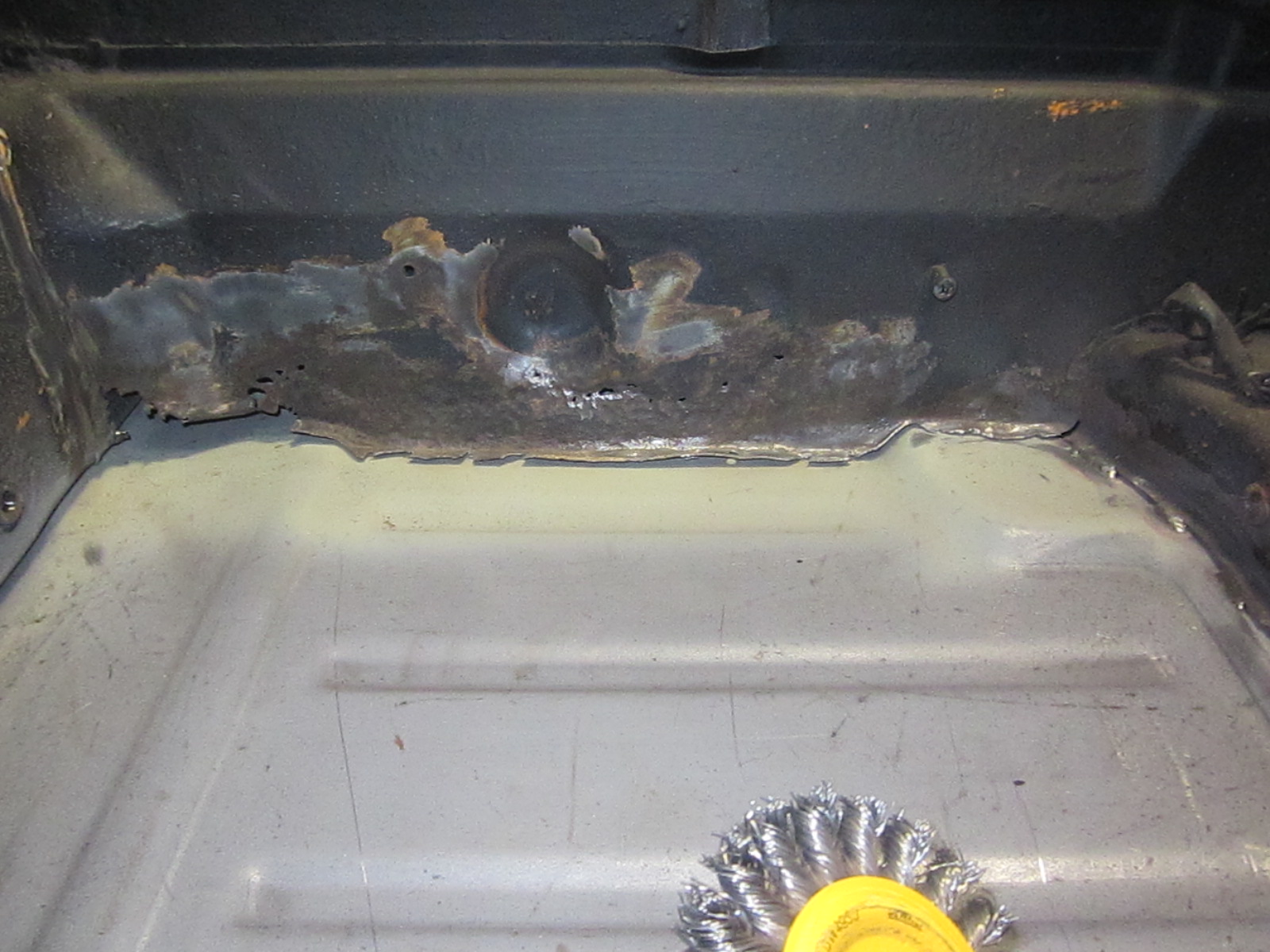

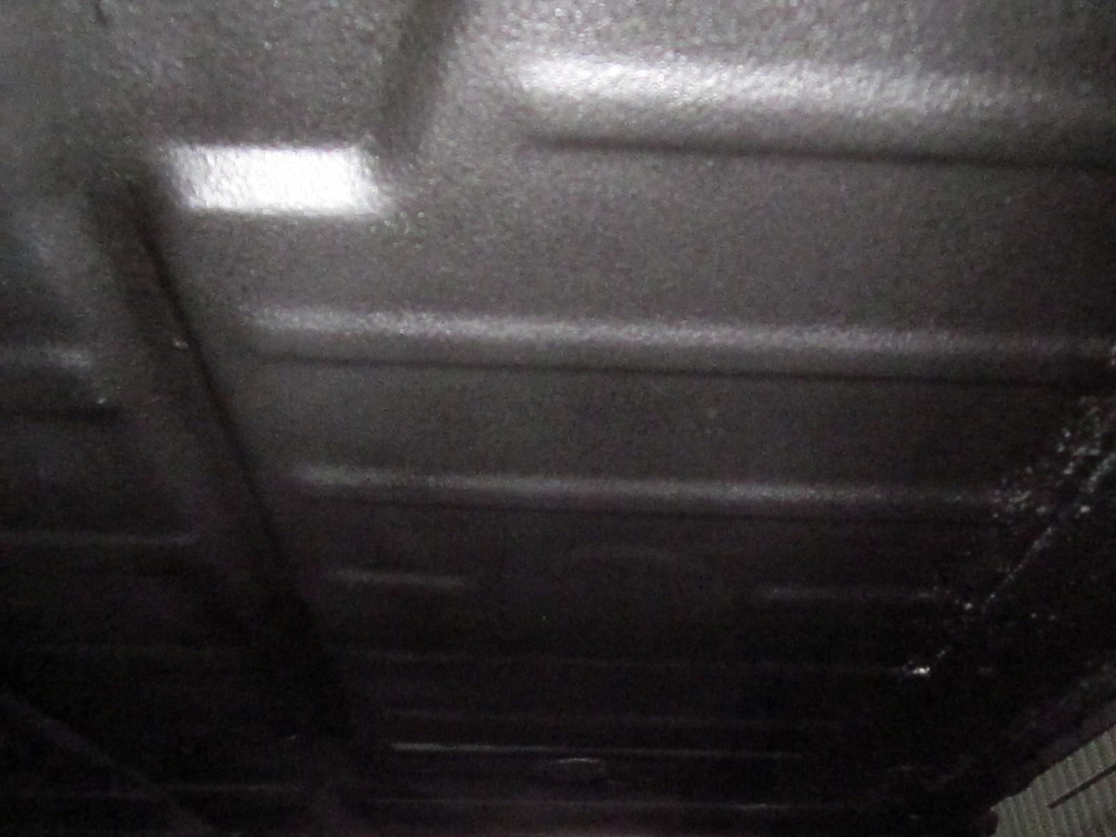

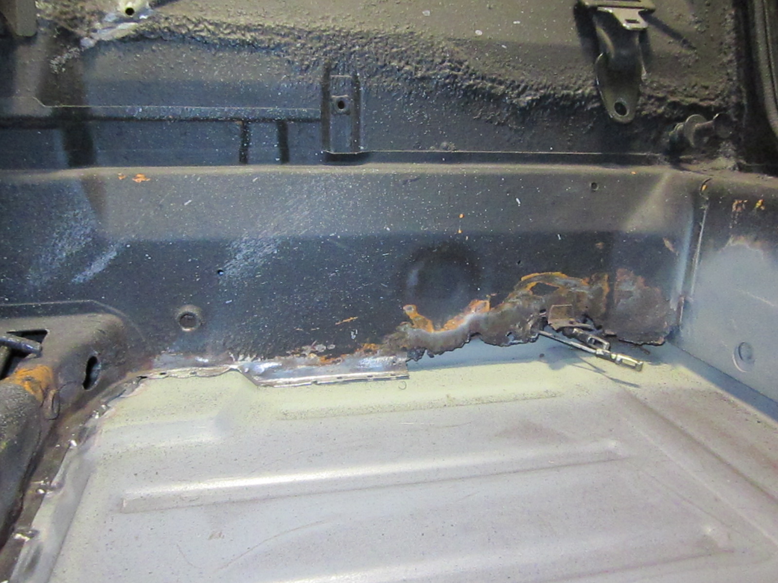

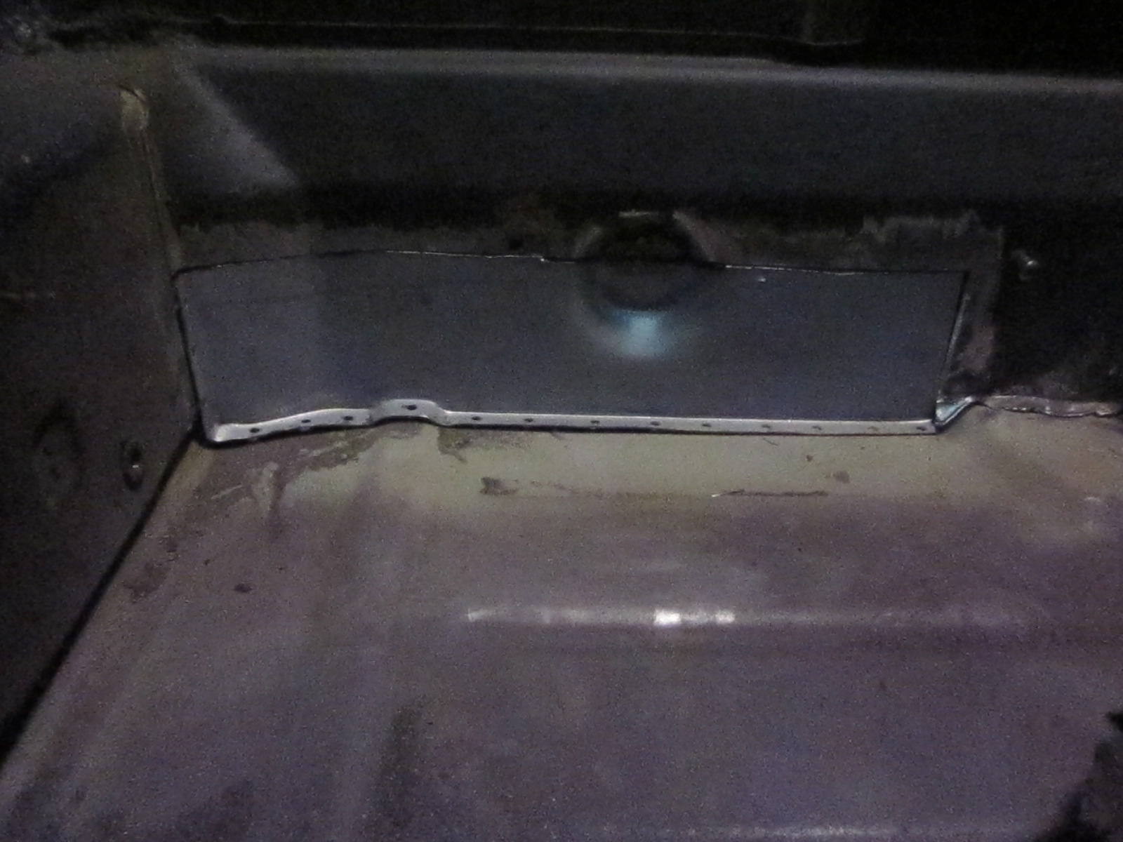

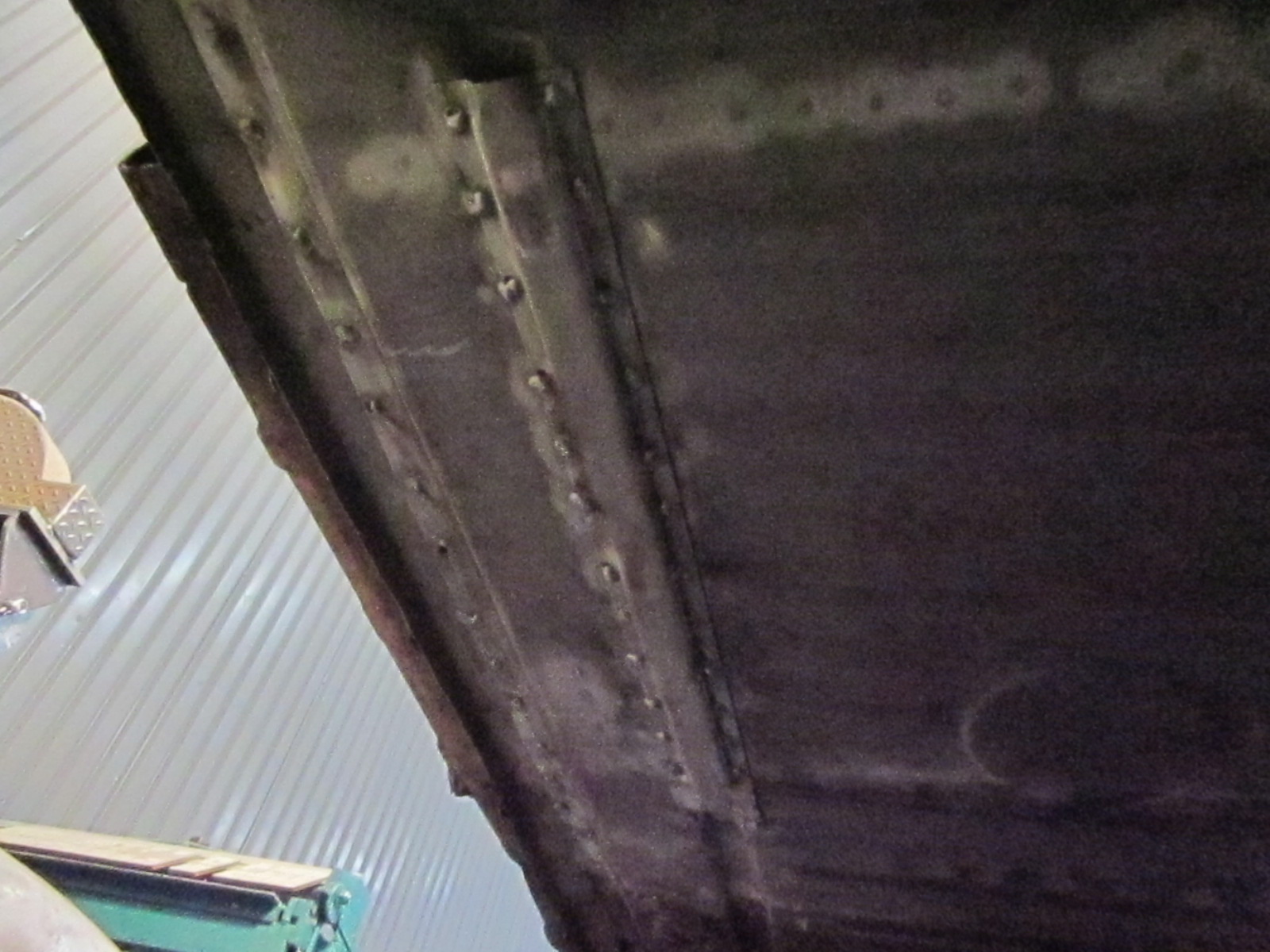

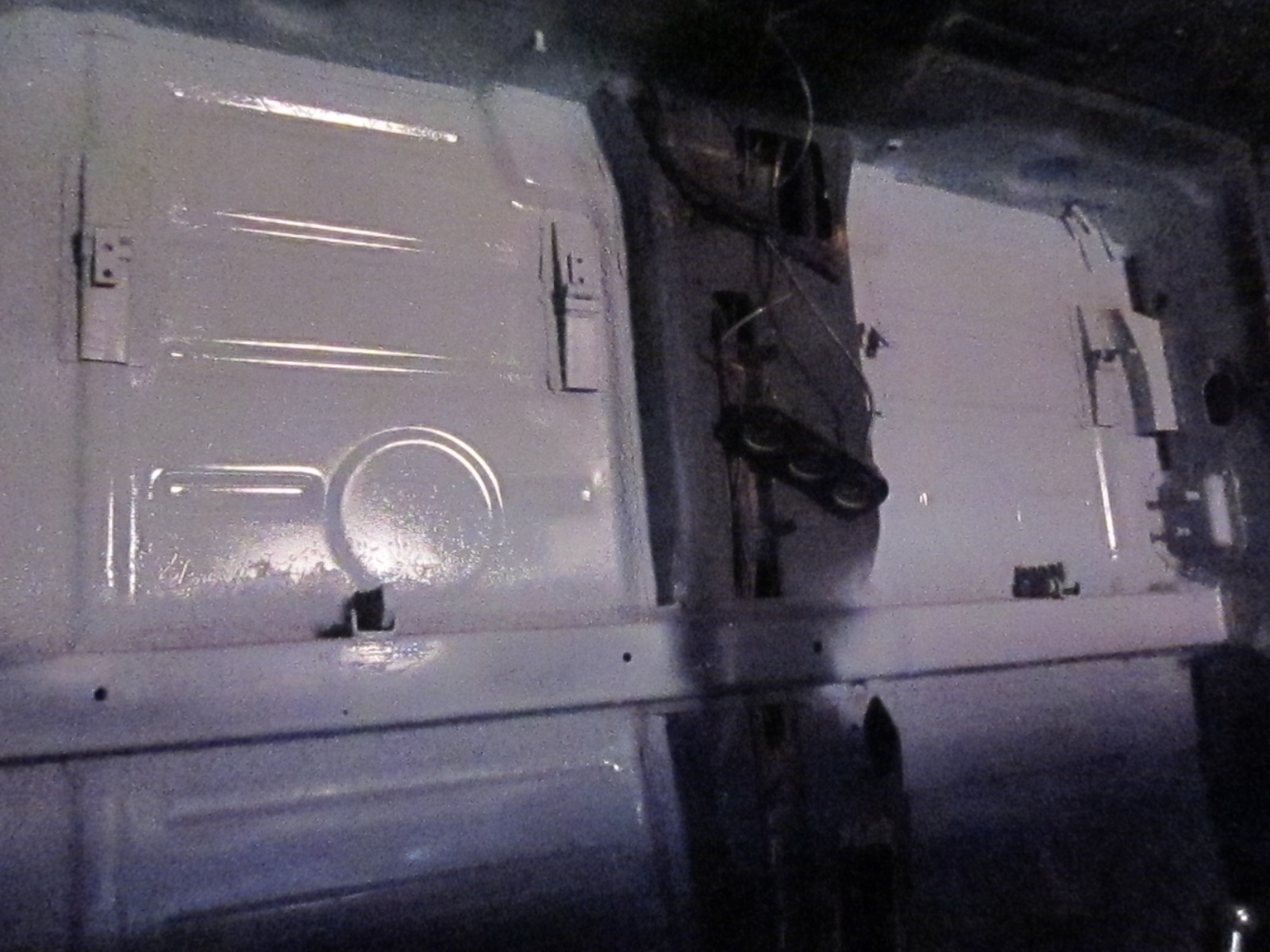

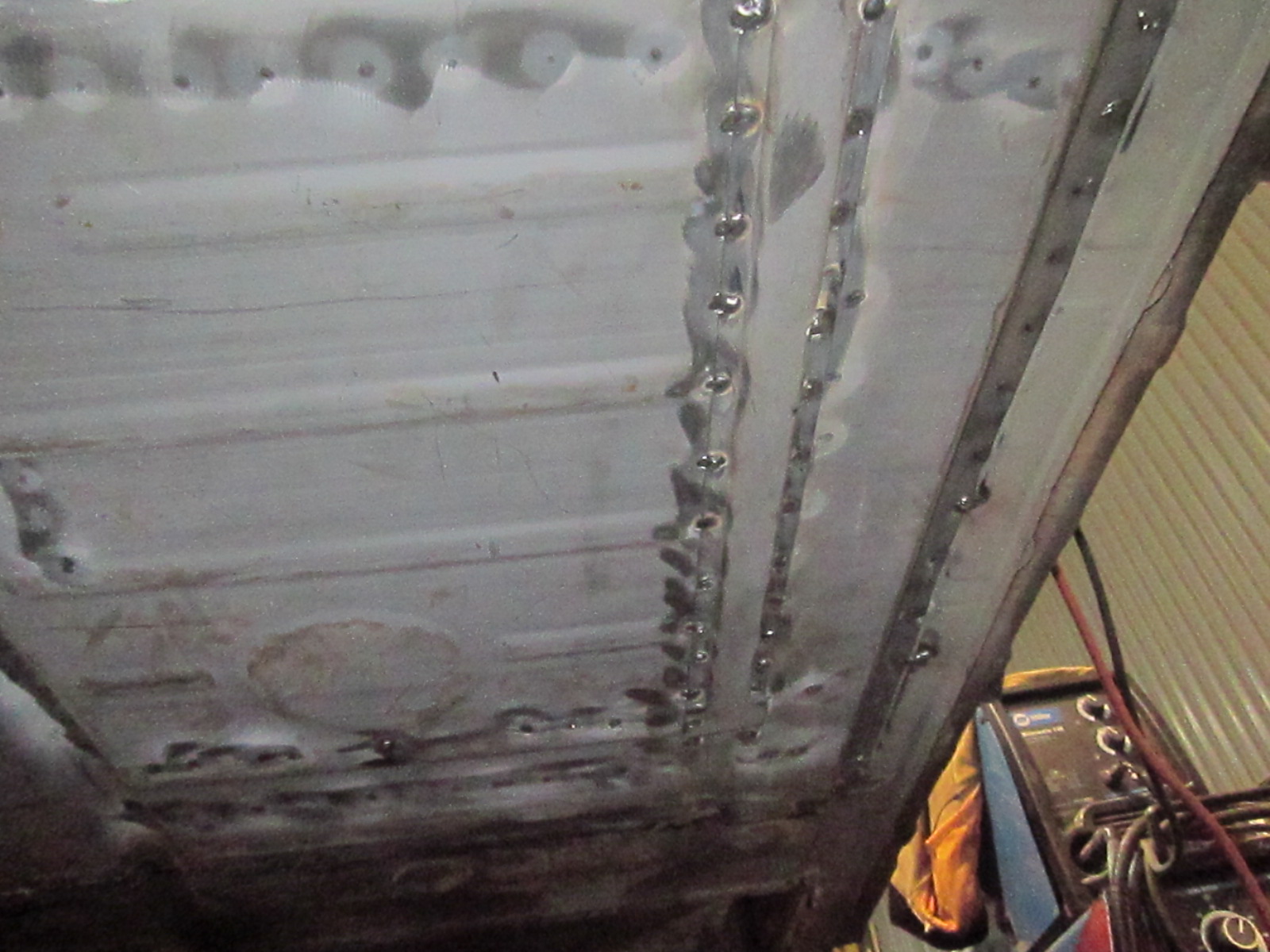

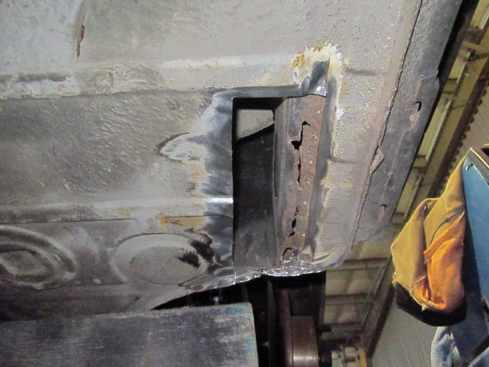

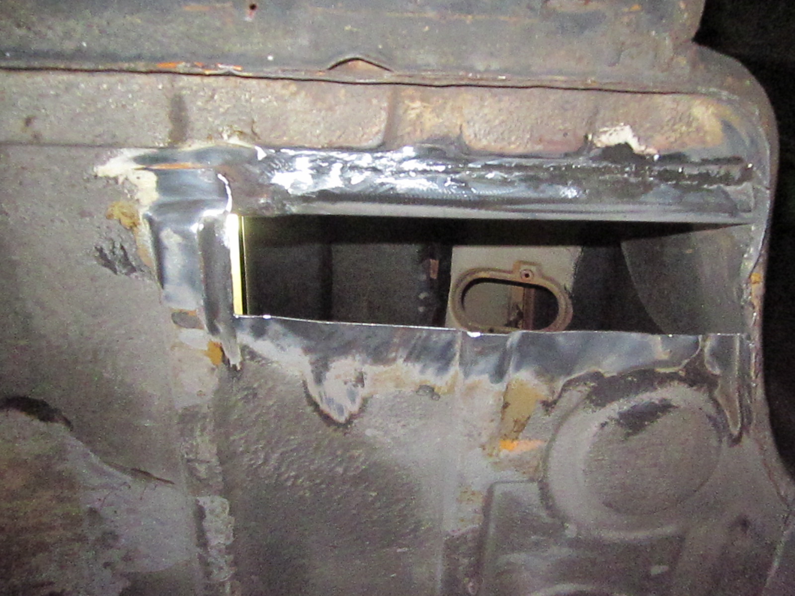

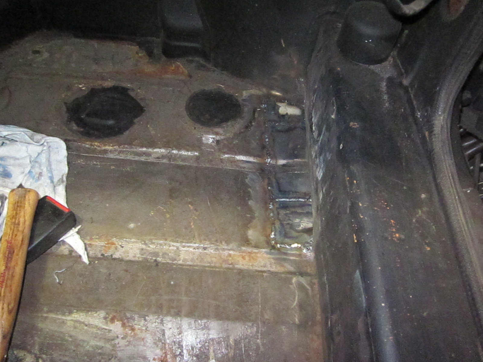

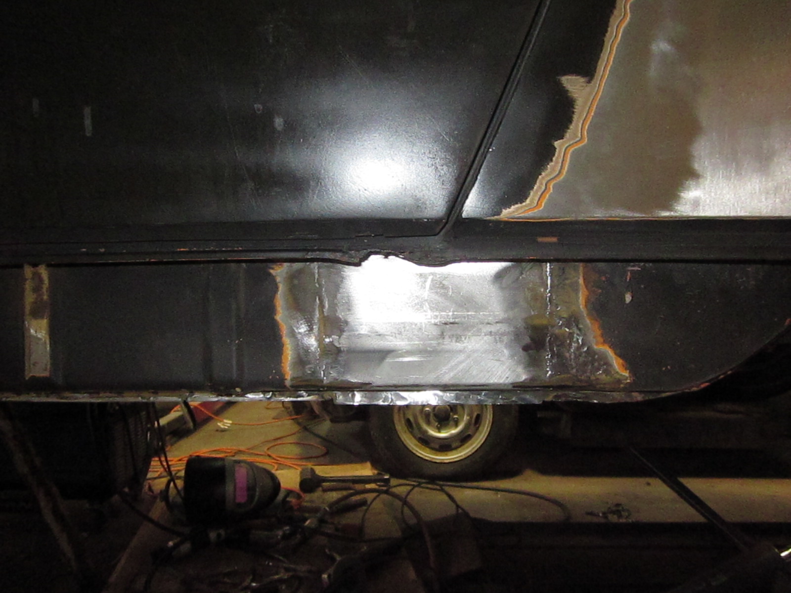

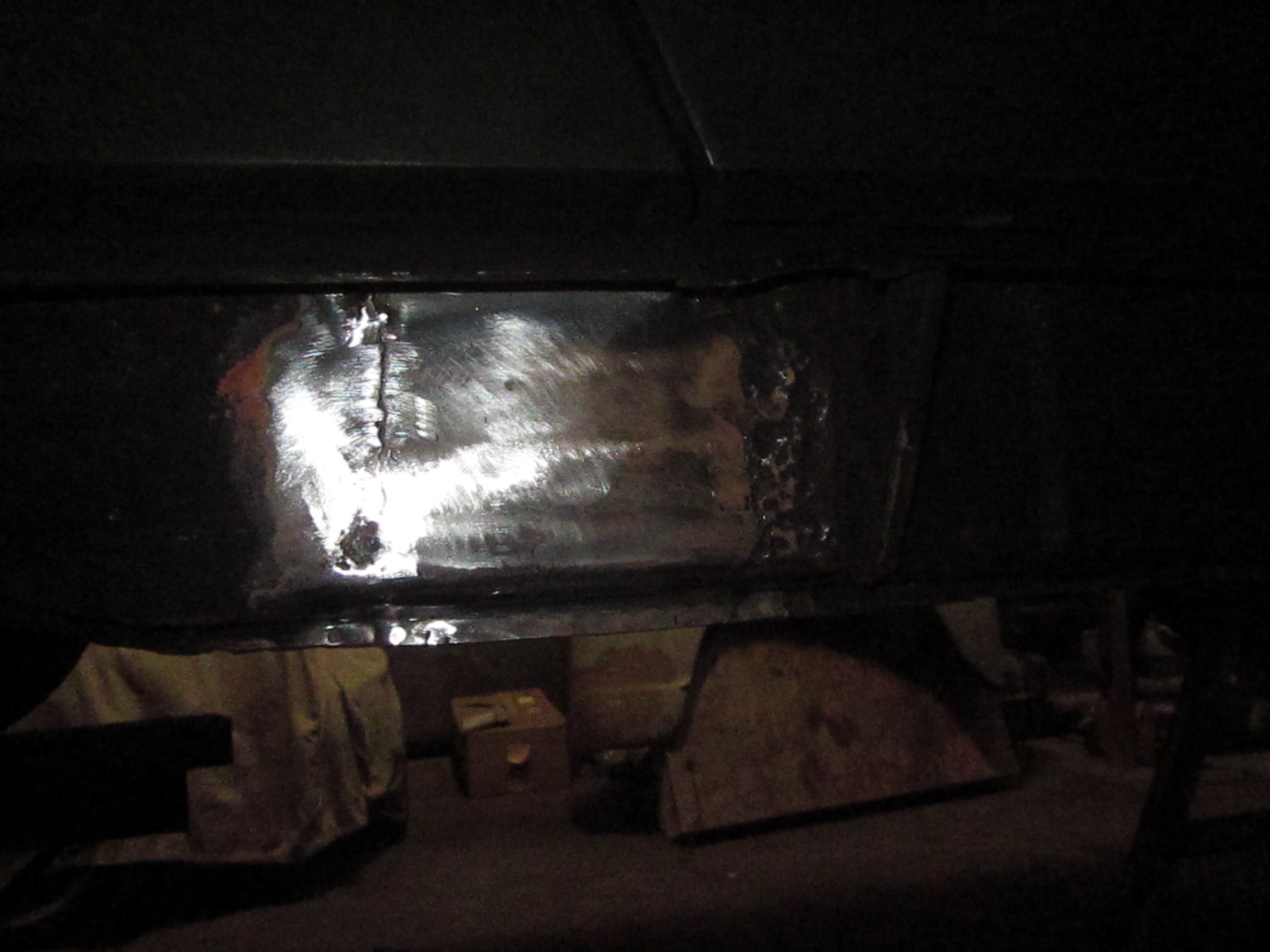

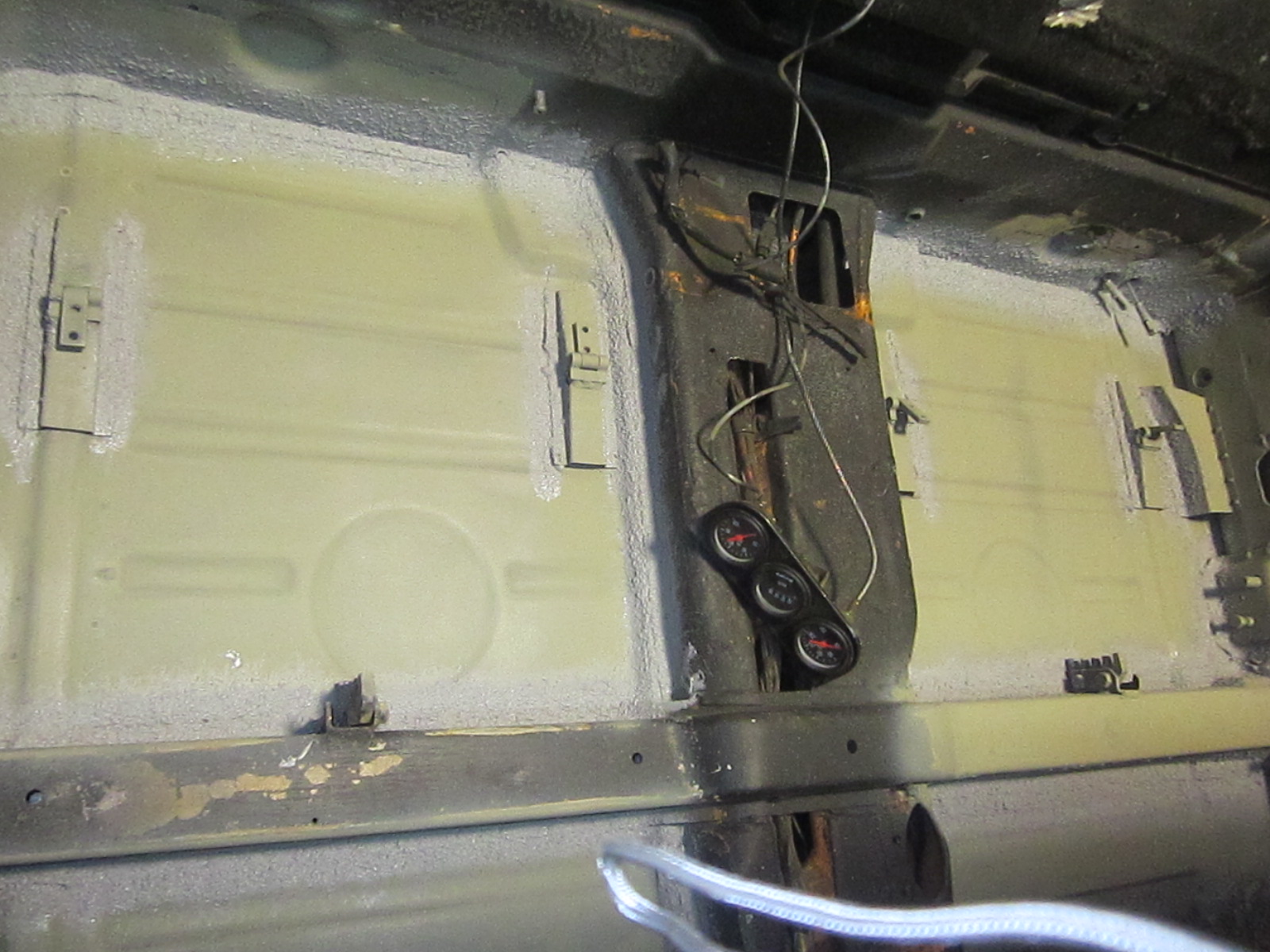

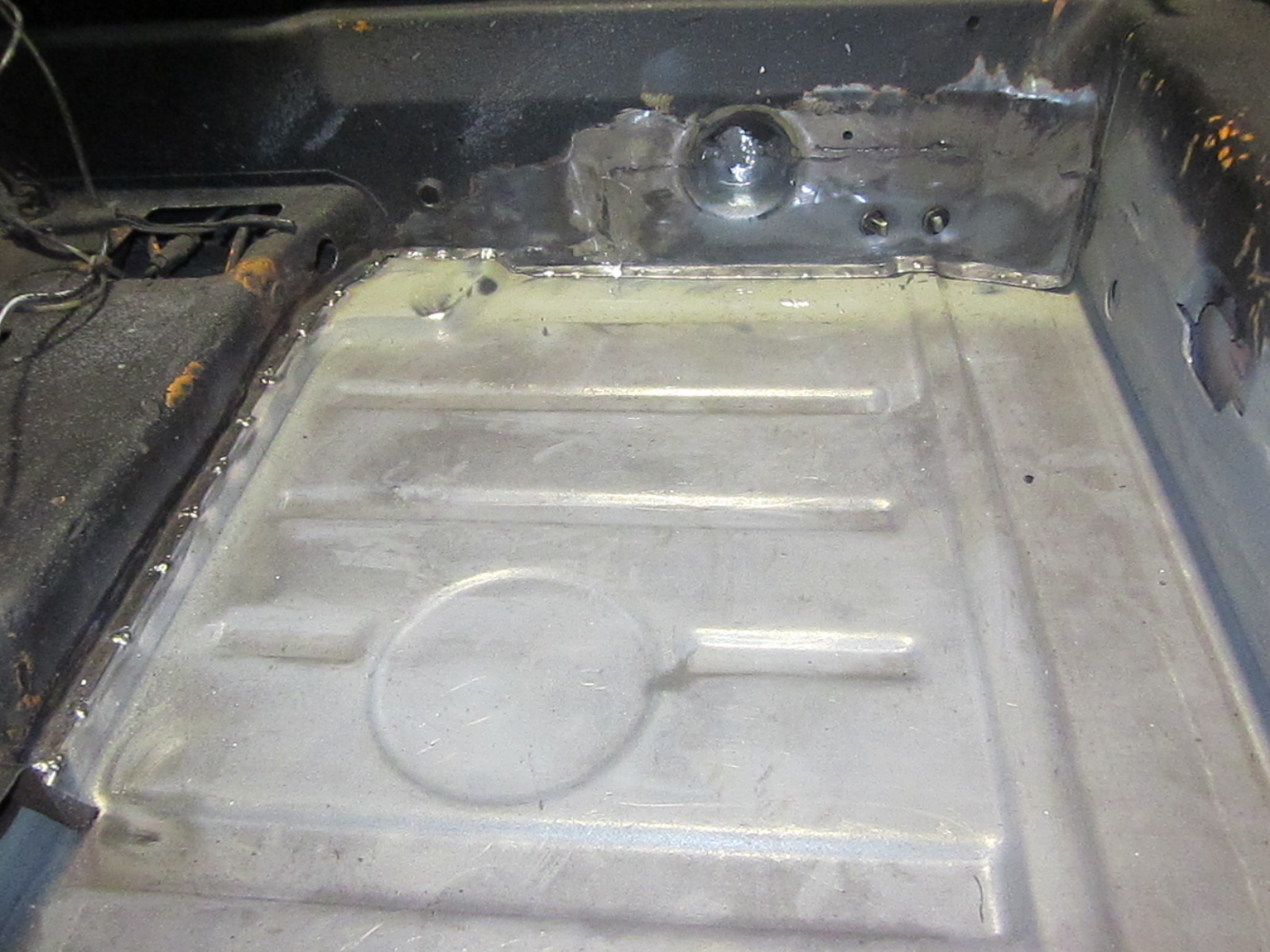

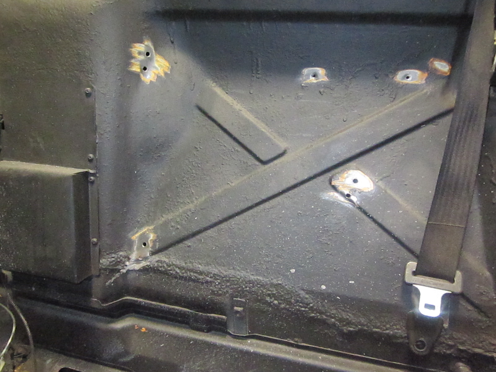

I REALLY didn't feel like welding upside down under the car today so I did some of the on top work. (IMG:style_emoticons/default/biggrin.gif)
Attached Image Attached Image Attached Image Attached Image Attached Image Attached Image

Rust repairs are done. Time to paint, undercoat and start the reassembly (IMG:style_emoticons/default/smile.gif)

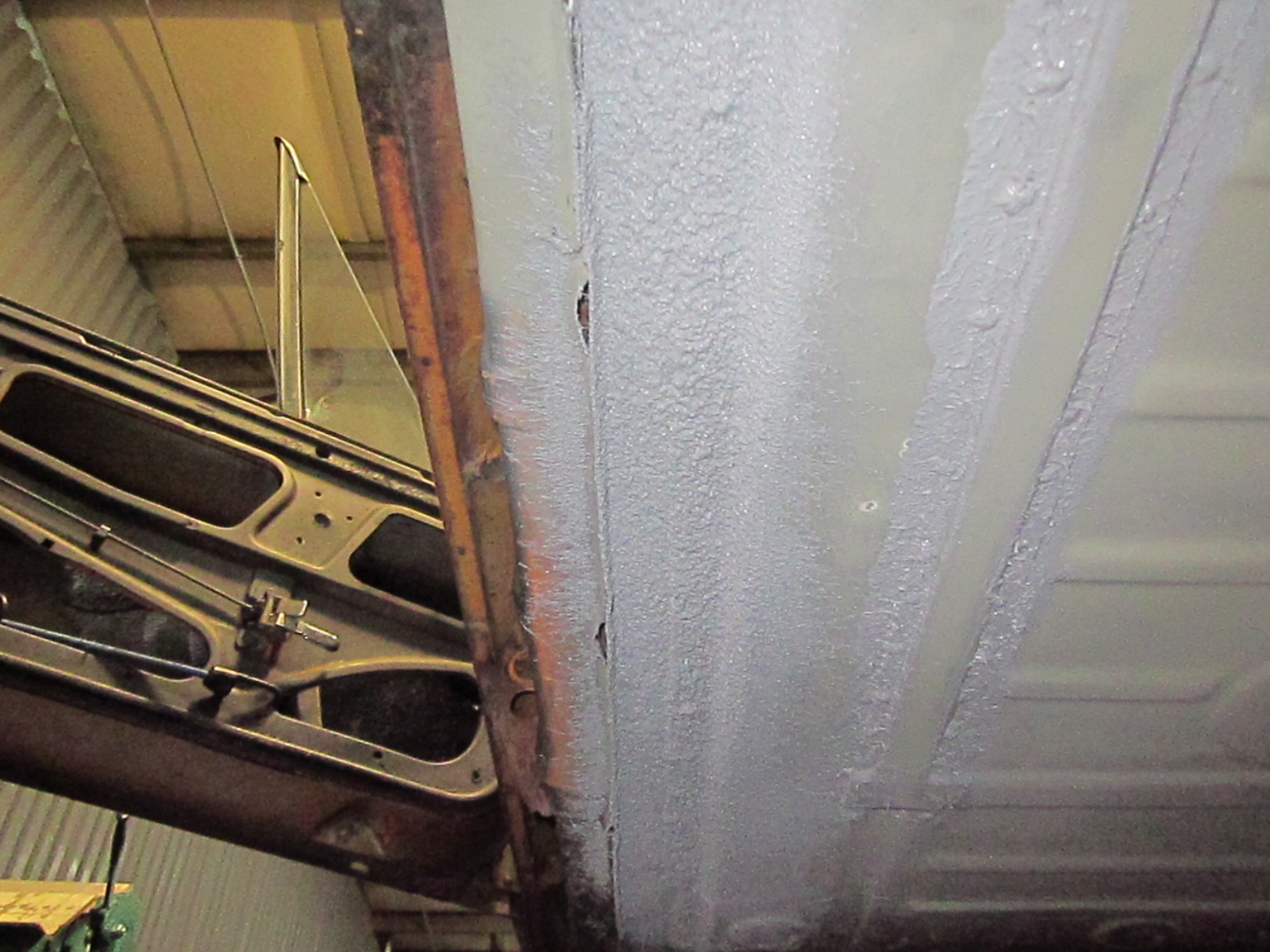

(IMG:style_emoticons/default/slap.gif) DING floor is done (IMG:style_emoticons/default/smile.gif) Jim and I both orderd sheet metal form resto design and neither of us thought about the e-brake " tunnel" so I took a piece of his old floorpan and made one up. Not perfect, but not bad for 20 min and a piece of old metal (IMG:style_emoticons/default/confused24.gif) Everything got sanded, wiped down, etch rimed, seam sealed, primed, and got a coat of black. Then the underside and longs got a couple coats of undercoating

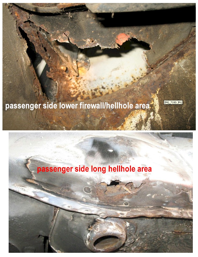

here are some pics from my 1975 914 - i got a feeling PO had someone cover rust with new metal ??
that said - all the best - remember - restoration design WILL be your best friend.
more pics of my LOW RUST 1975 914
