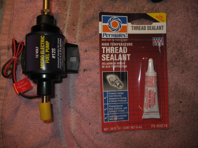

stopped by advance auto and ace hardware today to get a few bits.
i'm gonna initially go low tech with my fuel system to speed up the process.
ace does have a nice selection of small to medium grommets.

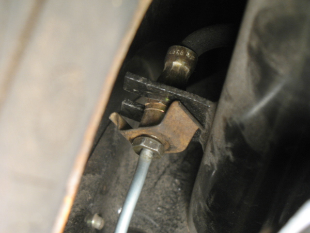

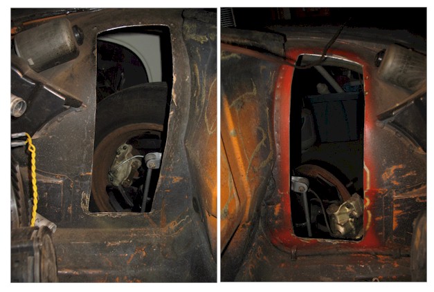

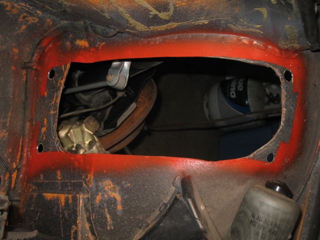

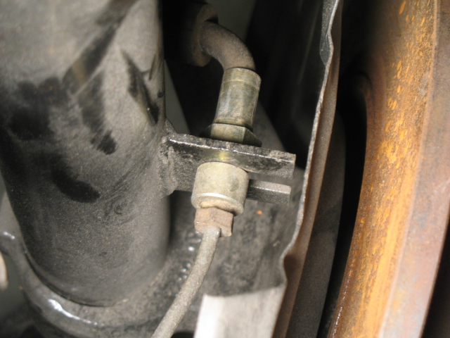

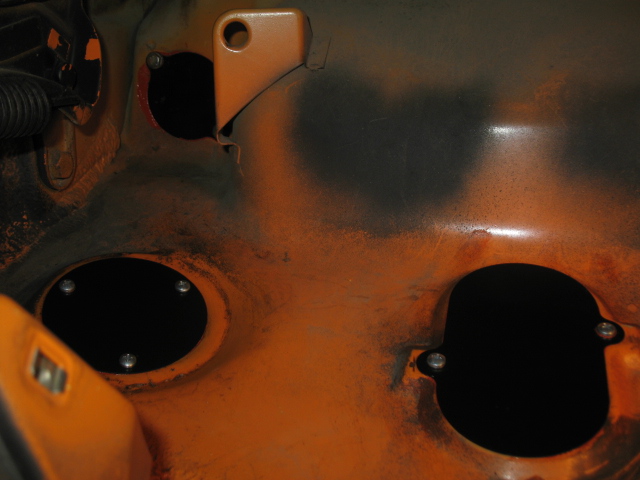

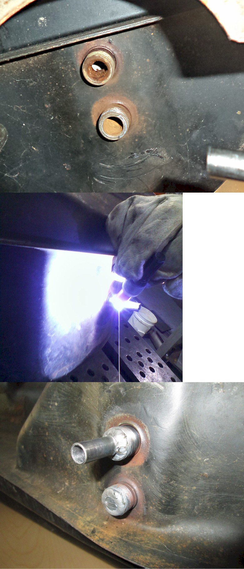

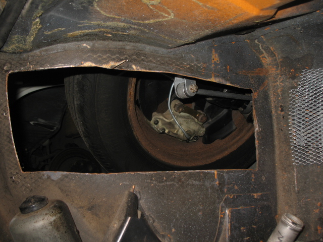

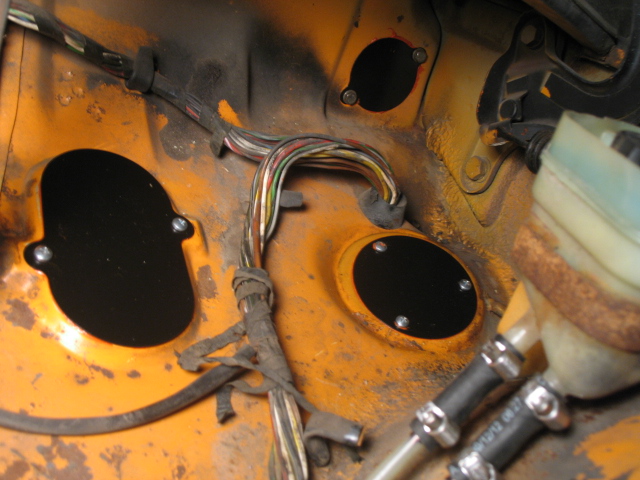

still waiting on my banjo bolt waskers for the brake system, so i decided to get the engman block off plates installed and noticed i need a couple of correct brake line clips. looks like i'll need to replace one of the soft lines too, to the type that take the flat clip - later style.
i want to get the brakes completed and bleed before i move on to fuel lines/pump - so i don;t get ahead of myself (IMG:style_emoticons/default/smile.gif)
i rushed when originally cutting out the holes in the front wheel wells, so tomorrow i will clean them up a bit to more resemble each other (IMG:style_emoticons/default/blink.gif)

cleaned up drivers side wheel well opening - they match pretty closely now.

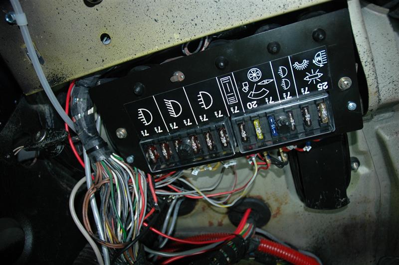

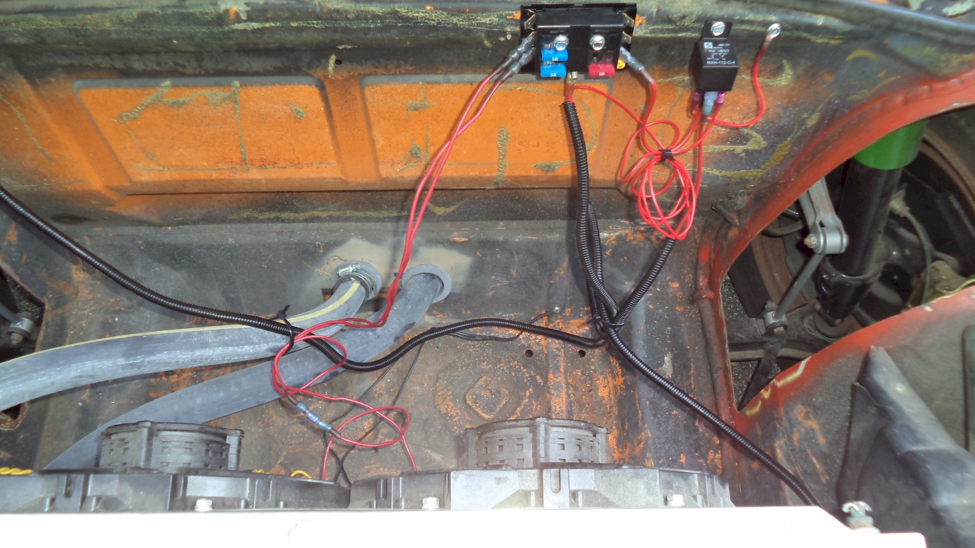

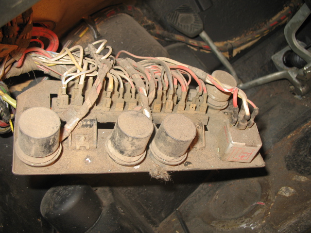

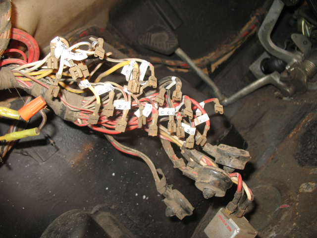

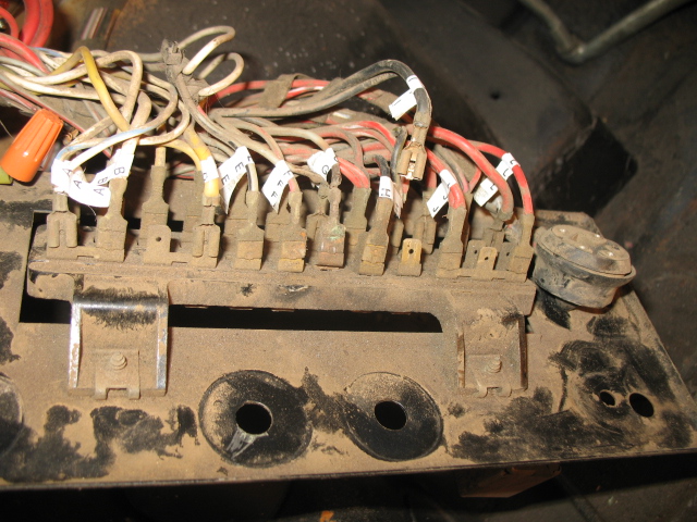

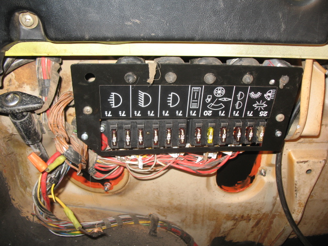

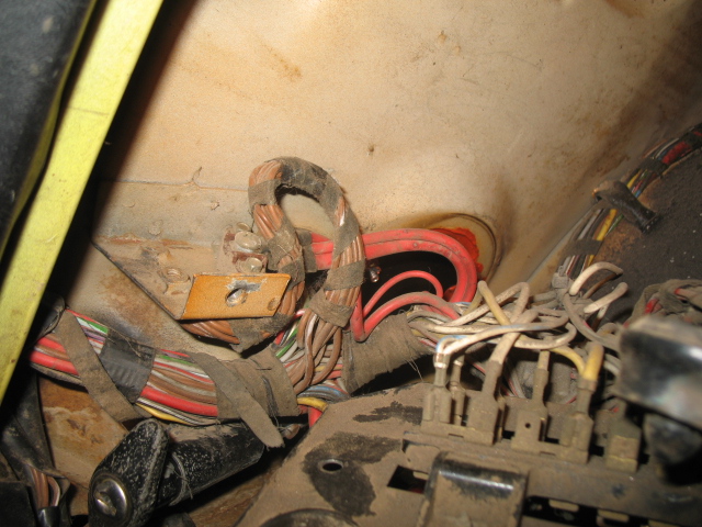

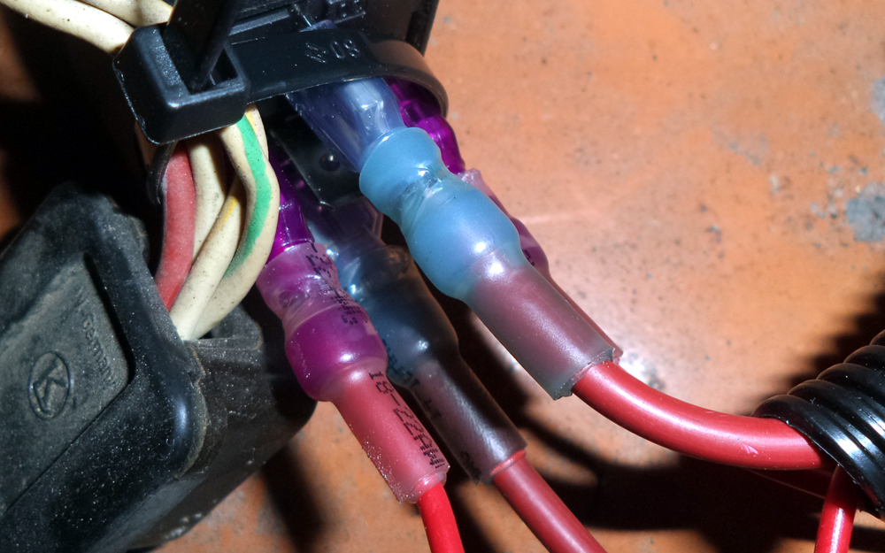

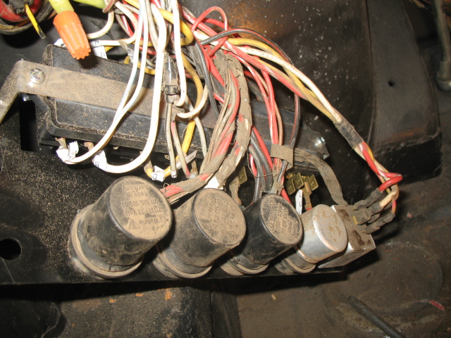

engman fuse panel in.
the hardest part was mounting it back up once wires were all connected to it.
**also note where each relay was and which had the metal reay in it.
i think i will get 2 longer screws and drill some 1/4 inch plates to let the fuse panel rest 1/4 further into car. the wires there hinder easy peasey reinstall.
BTW - the right way would be to heat shrink wrap all the female connections.
see a different installed pic
http://www.914world.com/bbs2/index.php?sho...=104969&hl=
(IMG:http://www.914world.com/bbs2/uploads/post-9003-1269202197.jpg)
Attached Image Attached Image Attached Image Attached Image Attached Image Attached Image

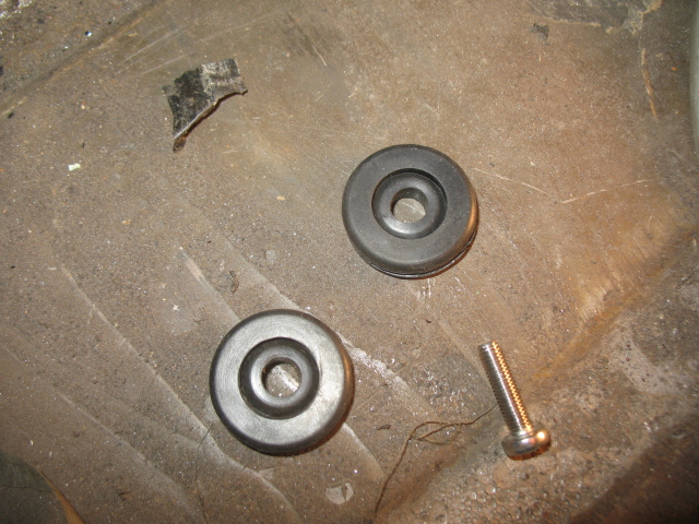

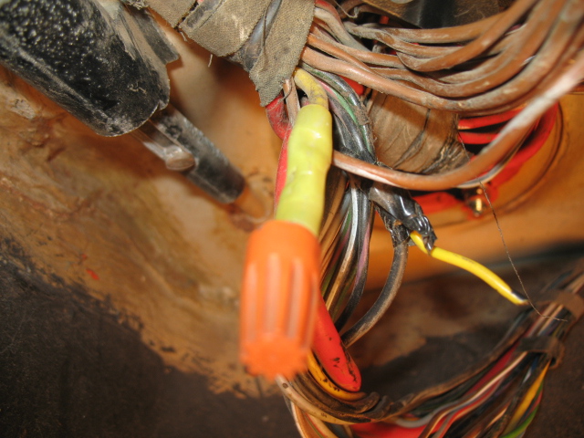

went to ACE but could not find a suitable 1/4" thick piece of plastic to make a spacer out of - so i went with a grommet inside of a grommet. of course ACE had the longer metric screws needed.

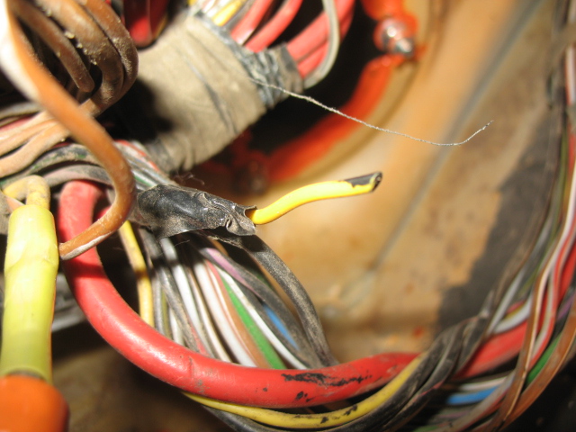

question - the thick yellow wire under the dash - that is not connected on my vcar, what is it for??
and i have a thin yellow wire tapped into a black wire qwith brown stripe?
my car had an alarm system in it when i bought it, that i removed.

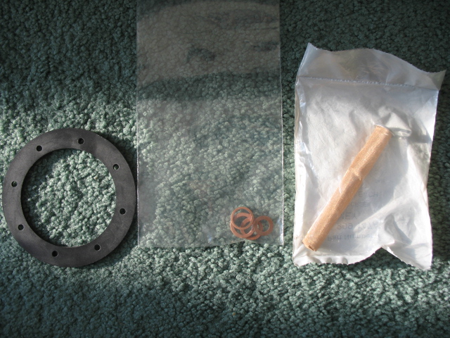

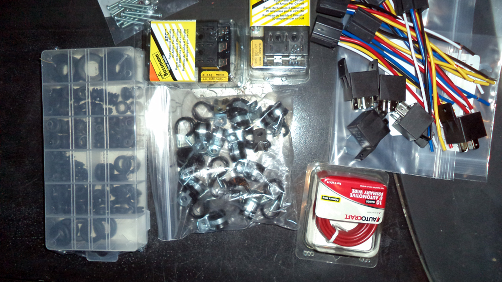

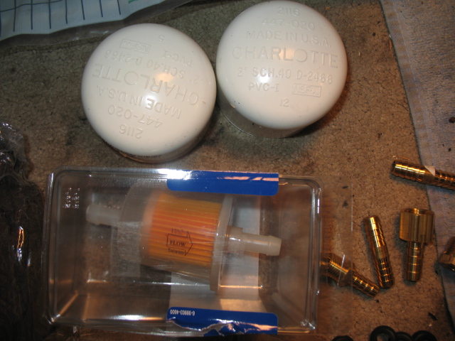

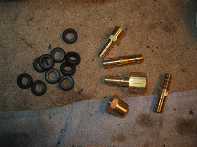

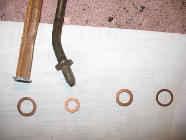

pic of some bits i rcvd today from automobile atlanta.
the downside is i do not know which metal gasket is which : (
2 are for the fuel tank nipples and 2 are for brake MC banjo bolt.
i should be able to figure them out.
ordered some stuff today from PMB today.
http://www.pmbperformance.com/catalog.html
and ordered some hose clamps from bus depot - yet to arrive.
**update - just got email from bus depot - they are out of stock and have no idea when they will - canceled order - will check napa

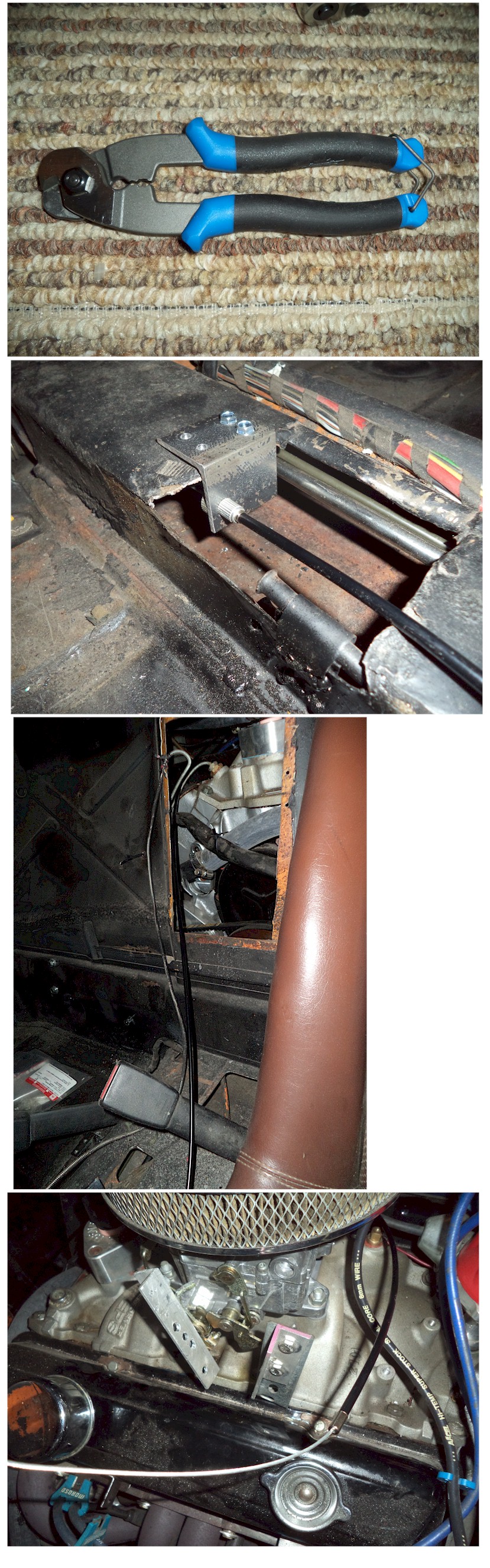

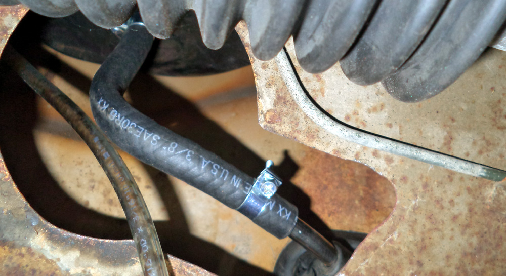

been slackin and might get back to slackin again, who knows.

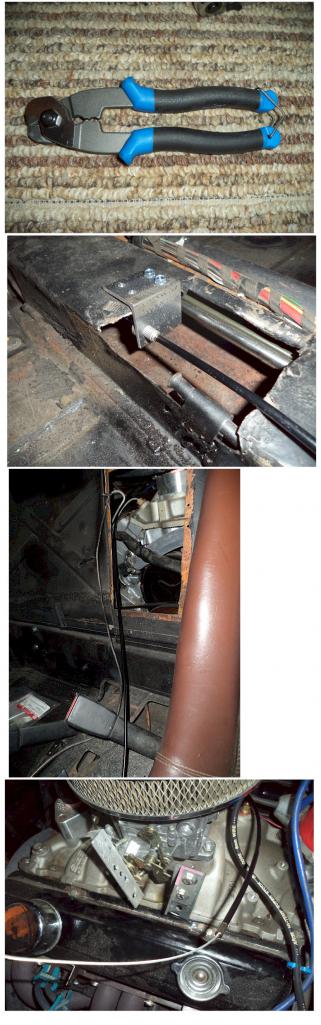

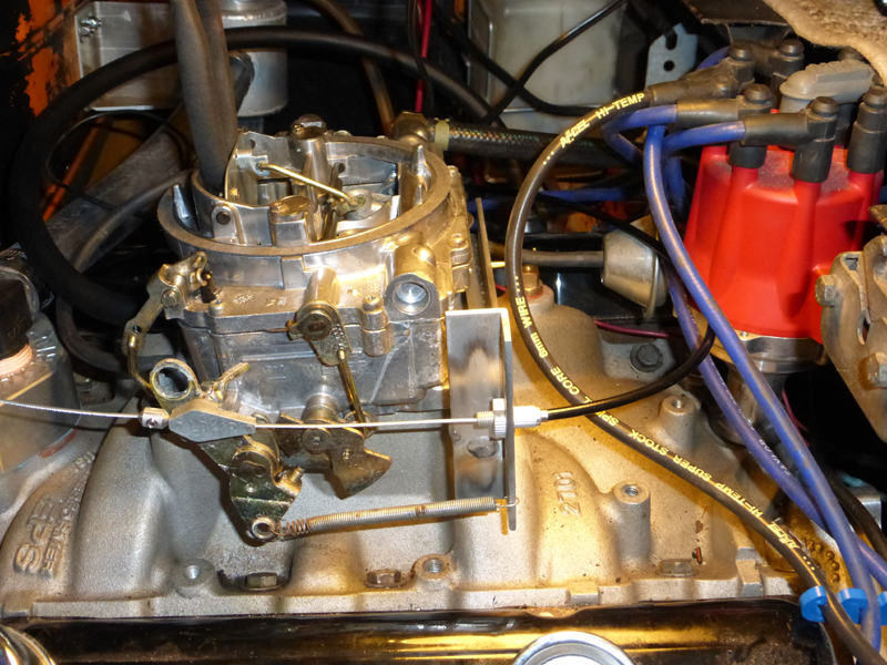

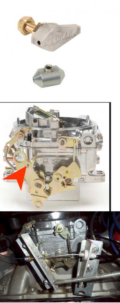

but my attempt at jerry rigging a throttle cable came out good : )
could not use the tunnel and it was not open all the way from end to end and I have no way to clear it out at the moment. so I ran a bicycle cable outside the tunnel.
next up I need to check clutch cable setting.

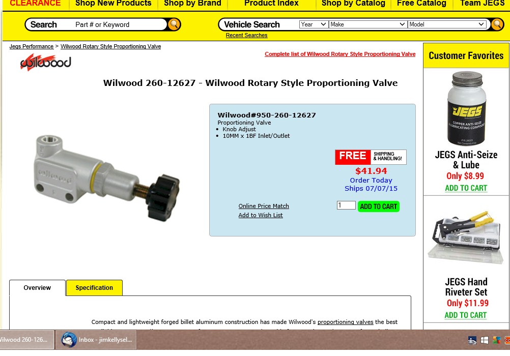

and I have decided to swap out proportioning valve for an adjustable unit cause I must have tons of air in my brake lines : (
pn's for lokar stuff:
http://www.summitracing.com/parts/lok-s-2412
http://www.summitracing.com/parts/lok-s-2411/overview/
https://www.youtube.com/watch?v=8SqM1mONOYs

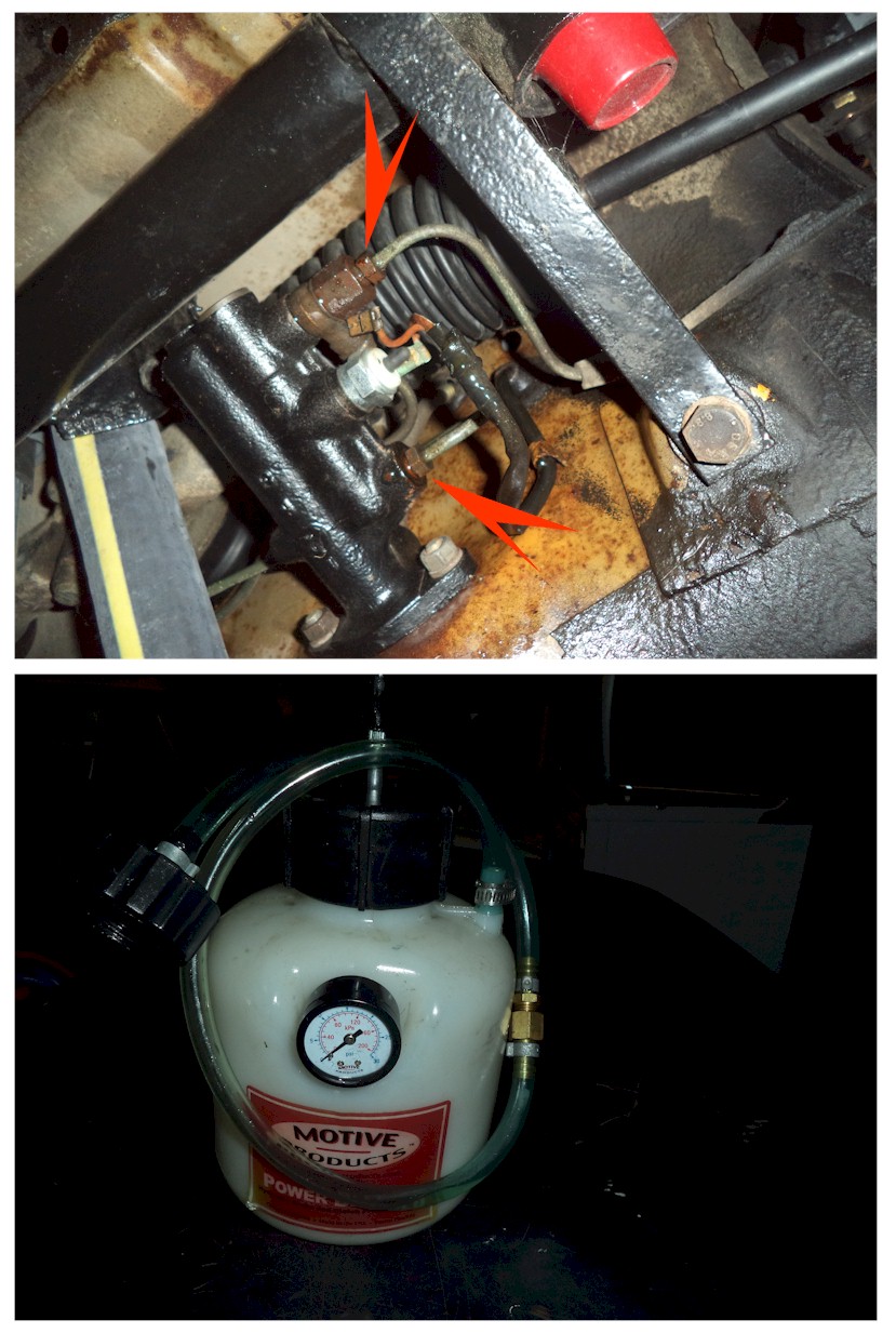

starting to get some peddle. cracked the lines at the MC and let them drip a bit under pressure from my Motive Power Bleeder and going caliper to caliper several times. I think I need to drive it some to move the rest of the bubbles outward. one thing is my rubber hose on my Motive sprung a leak twice now, due to ???, it is a mess when the line springs a leak UNDER PRESSURE : (

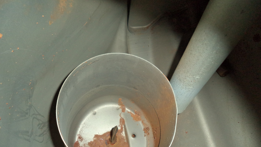

got a video for you guys coming later today. it is of me taking my first PARTIAL test drive. anyway, my tank is rusty but iu have a 1975 tank that looks good, so I will swap them out. video to come.
better tank modified for my single carb set up.

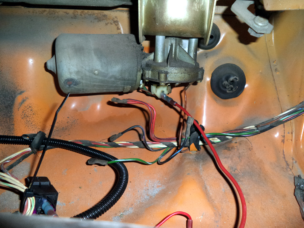

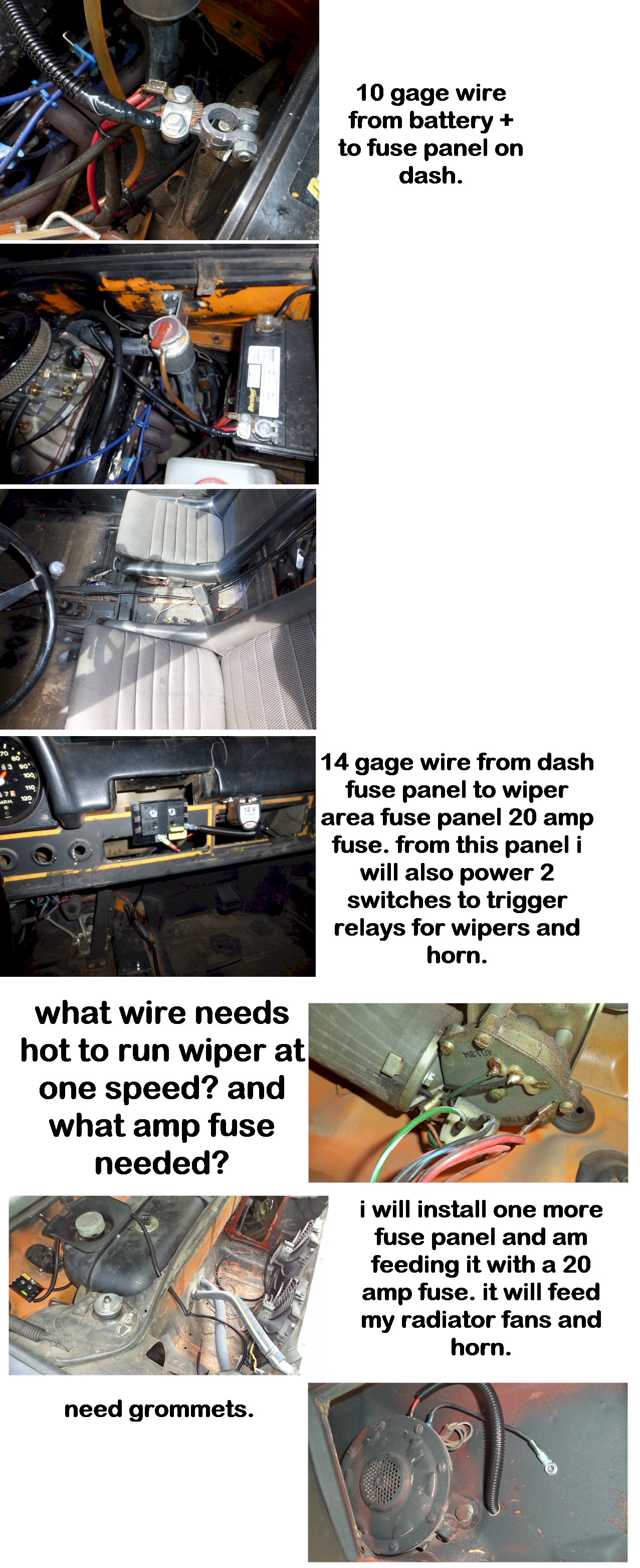

doing a little more wiring today. adding to what I did last week. to get my horn and wipers working enough for inspection. latter I will try to fix correctly using car;'s harness. gonna run 10 guage wire to all fuse blocks so I can feed all relay pin 30's with 10 guage wire.
horn and wipers are now wired and working. also installed 2 emergency brake line clips on rear trailing arms, that I bought new at pelican cause my old ones were rotted.
carb has crap in it, so I must pull it apart and clean it out of any debris. then I should be able to take it for a spin and get it registered.
