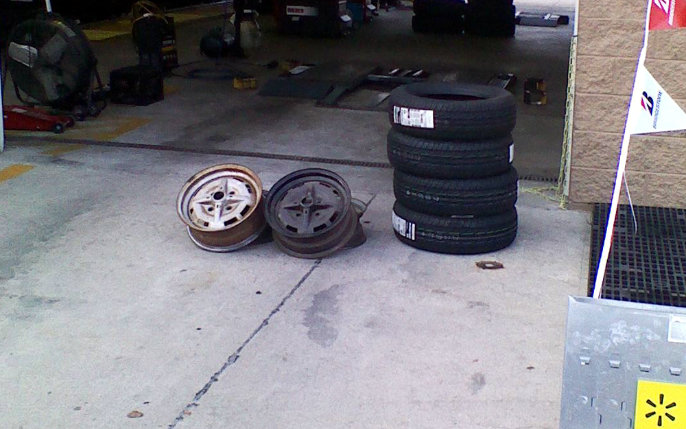

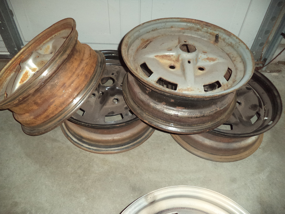

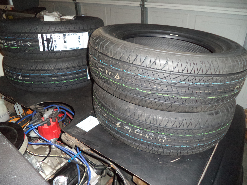

tomorrow I put new tires on some ratty rims : )
update: tires on rims : )

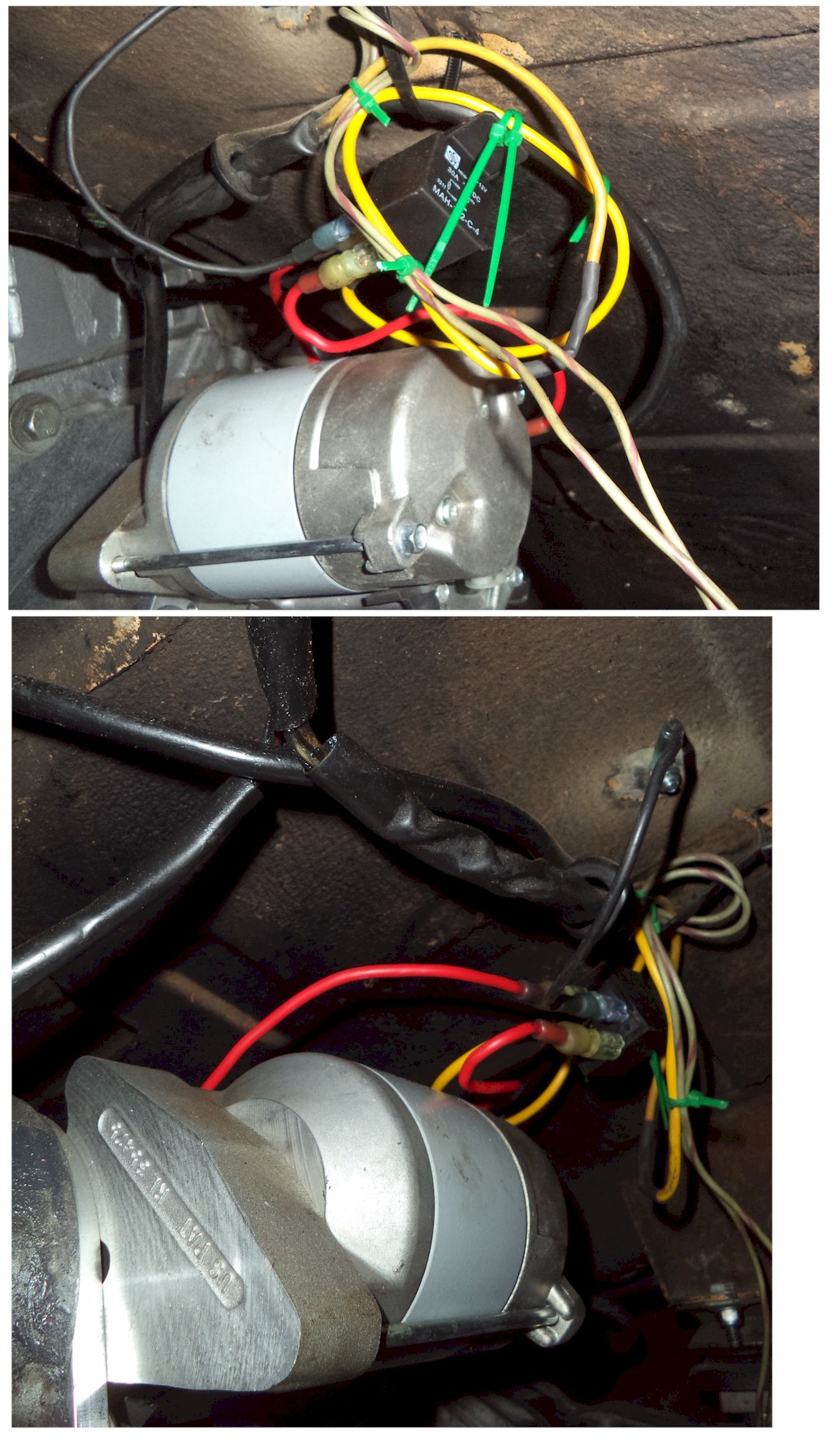

decided to add a mcmark style starter relay, since I had a few extra.

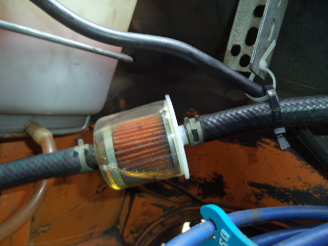

seems my carb may not have crap in it, my filter between tank and pump was dirty, replaced it and my carbs squirt again. need to run it and test all I've done but want to give my neighbors a break, it's sunday : (
tires are on (IMG:style_emoticons/default/welder.gif)

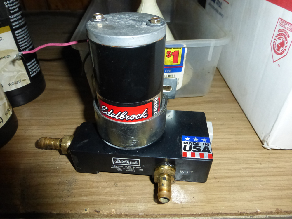

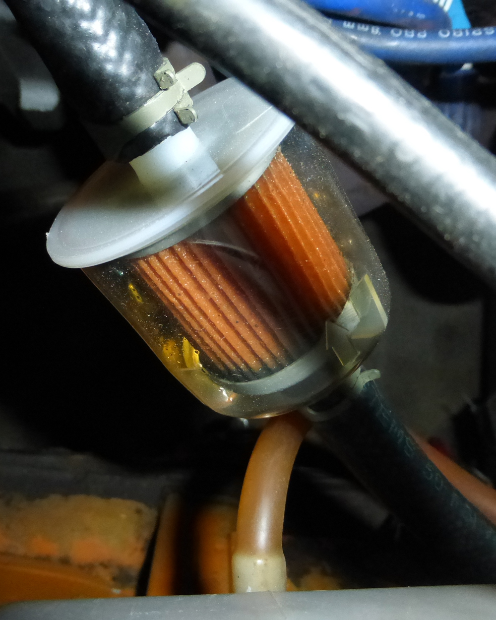

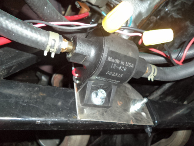

I kept finding chunks of what appears to be rubber in my gas line to carb, most between tank and pump. started to think pump (edelbrock 1791) was clogged up with rubber bits, so I flushed it out as bets I could but pressure still dropped from 3.5 to 2.5, so I replaced the edelbrock with a freaking MR GASKET electric fuel pump s12. which seems to be putting a better amount of furl in my filter between carb and pump, than my edelbrock was.

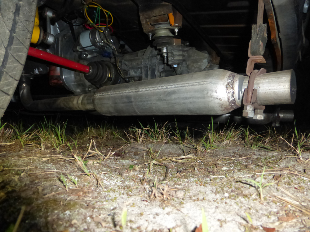

while car is not that loud, I think I want an almost silent exhaust? summit have mandrel U bends and short muffler. current muffler 24" long, tip to tip.

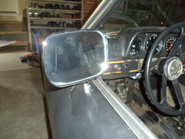

took car to dmv yesterday, passed for everything except I had no door glass, did not think they would check.
installed a cheap plastic autozone door mirror, $10, works well.
new mr gasket fuel filter seems to be helping keep a good amount of gas in my filter.

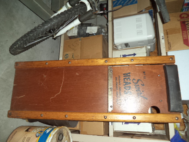

got me a nice vintage creeper the other day.

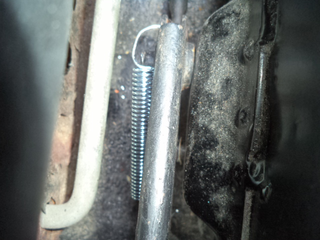

added a spring to my mostly broken emergency brake handle to make it function.

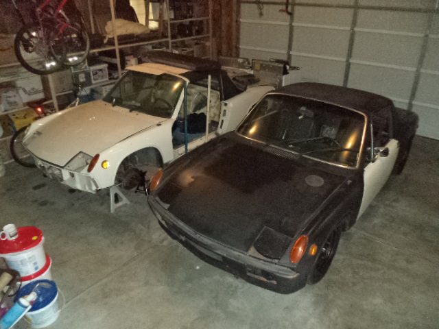

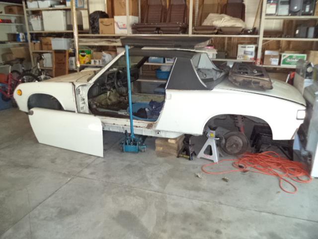

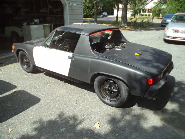

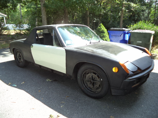

today I rob doors from my 1975 for my 1972 so I can pass inspection on Tuesday for door glass being missing.

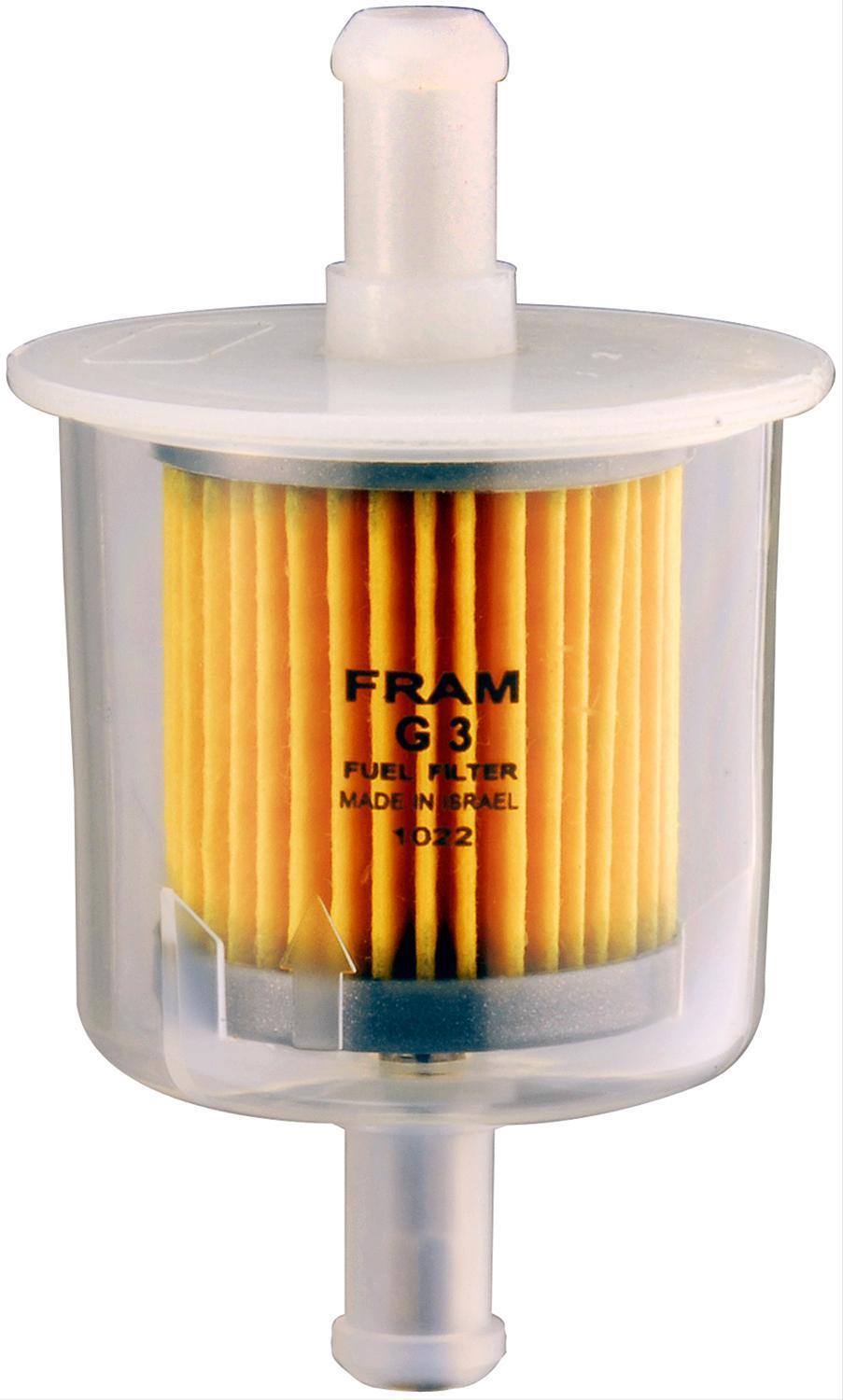

got some more g3 plastic fuel filters, I am still needing to be able to see inside. will switch over to metal filters when I am 100% certain my fuel line is totally clean.

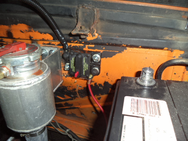

pic of my 100 amp circuit breaker (got it at advance auto) near battery. probably should down grade to 75 or 50 amps?

almost. how nice will it be to have a car that is mild mannered and have a trans that can be shifted like a modern car and have high rpms too. yesterday I found myself wanting to take it easy on the v8 so I started off in 2nd, went to 3rd, then to 5th. don't really need 4th for crusing. 5th at 2500 rpm must be between 55-60, I will check with my gps. speedo cable on its way to me. tires are now 195x65x15 dunlops. v8 is too dang noisey, got to get it quieter, noise in cabin is worse than noise outside by FAR.

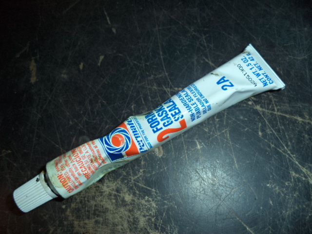

and this permatex is what I have been using on my npt fuel fittings, mostly cause I already had it.

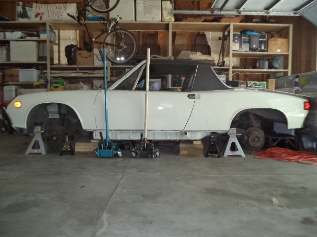

well... my 1975 (to be subaruized at some point in future) has been robbed of its doors.

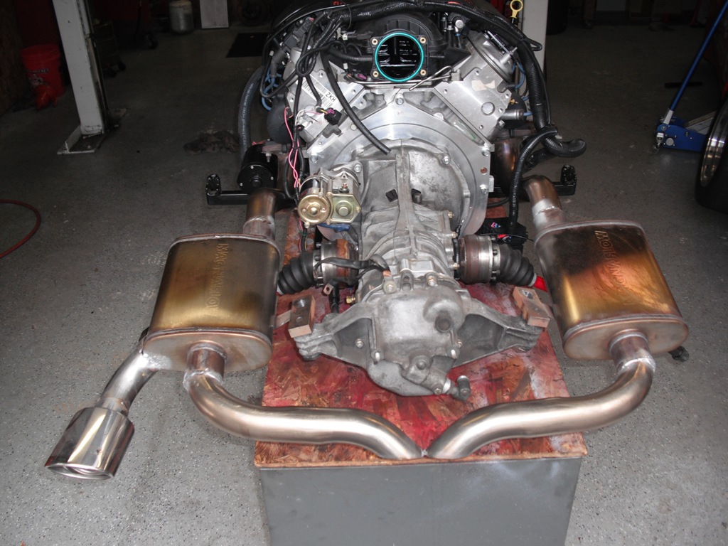

The only way to get rid of V8 drone is to install a crossover tube before the mufflers.

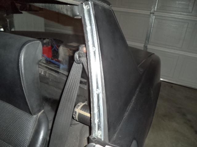

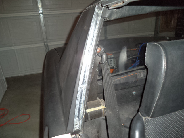

well, since I robbed the doors from my 1975 for my 1972, I figured I better reinstalled the vertical sail seal too, which meant I needed to rob my 75 of its vertical sail trim aluminum.
to make a long story short, I just ordered my first seals my 914rubber.
http://shop.914rubber.com/914-Vertical-Tar...f-2-914VTSS.htm

I will look into where I may have space to add a crossover. the DRONE is killing me.

QUOTE(jimkelly @ Sep 6 2015, 07:33 AM) *
QUOTE(Mike Bellis @ Sep 5 2015, 07:10 PM) *

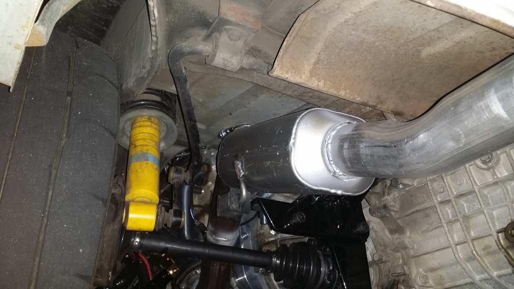

I just got 2 MagnaFlow no cross over installed on my ls conversion.
I really like them.There not strait through, they have cone inside.

i've been thinking of this style too. I do prefer to have two individual pipes but realize it is hard to conquer drone doing so.

Allot of people do add a cross over pipe...I NEVER (300hp - 525hp) have had "drone" in any of teener conversions. I've also NEVER have had a cross over pipe too. My engines have all been LS based power-plants. I've seen it also being a function of your exhaust itself - the chassis and engine (and exhaust) are all operating individually based upon their own frequency range. Production cars have the chassis tuned to allow all of these to work together or to limit the effect. Best of luck - drone sucks and is unlivable in my book. For what its worth, I've always used magnaflow Stainless mufflers...the bigger the better for reducing the volume.

as for exhaust, maybe my glasspacks are just too poor a match for my car, and maybe any other muffler would reduce or eliminate drone, and of course, loudness overall. maybe I will go with walker sound fx, they are $25 a piece at summit.

I also have never had a drone with my V8 cars using Magnaflow and Borla mufflers. I've also never used a cross over pipe.
I had some Flowmaster 40 series and these were drone city. I ran them for less than a mile and took them off the same day I installed them.

+10 on the Magnaflows. No drone, no crossover. Sound mint! (IMG:style_emoticons/default/aktion035.gif)

I did a little looking and I believe this is the part I used on my old car...great sound but definitely not to loud (in my book). In fact, I used to be disappointed I couldn't heat the exhaust cruising down the road. (IMG:style_emoticons/default/blink.gif)
PART # 14148
MagnaFlow Product #14148
CONFIGURATION CENTER/CENTER
LENGTH 6 IN
OVERALL LGTH 12 IN
IN/OUT DIA 2.5/2.5 IN

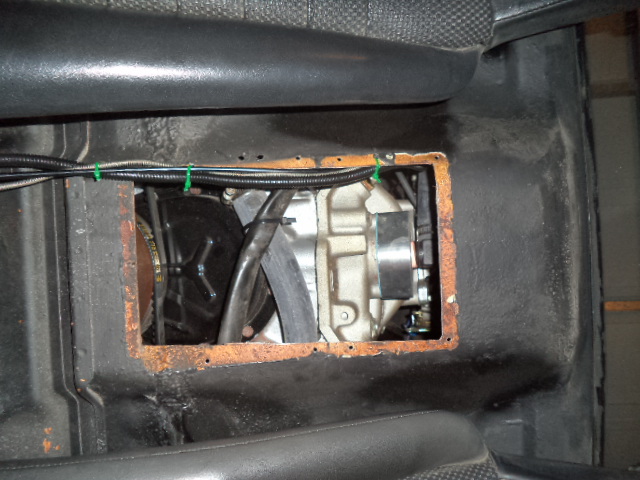

*cover firewall hole

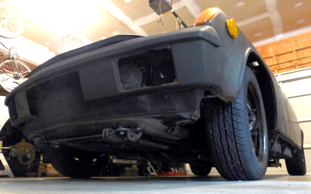

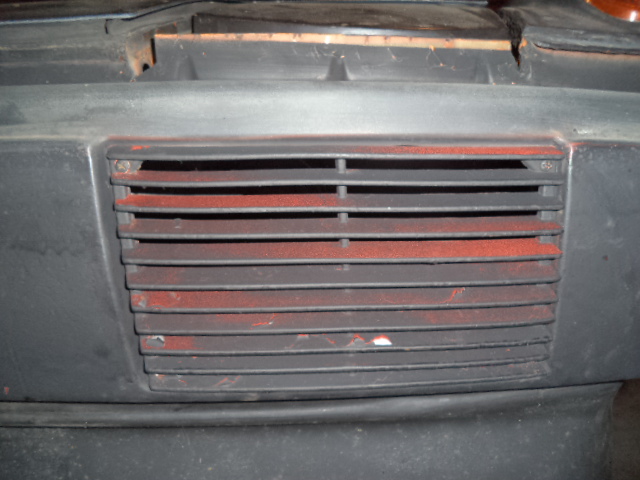

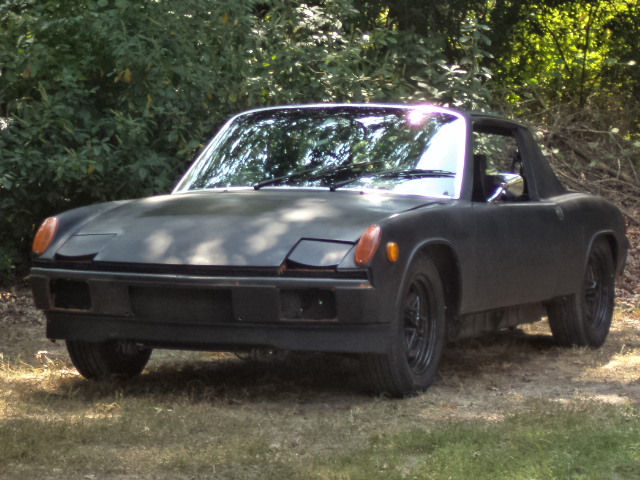

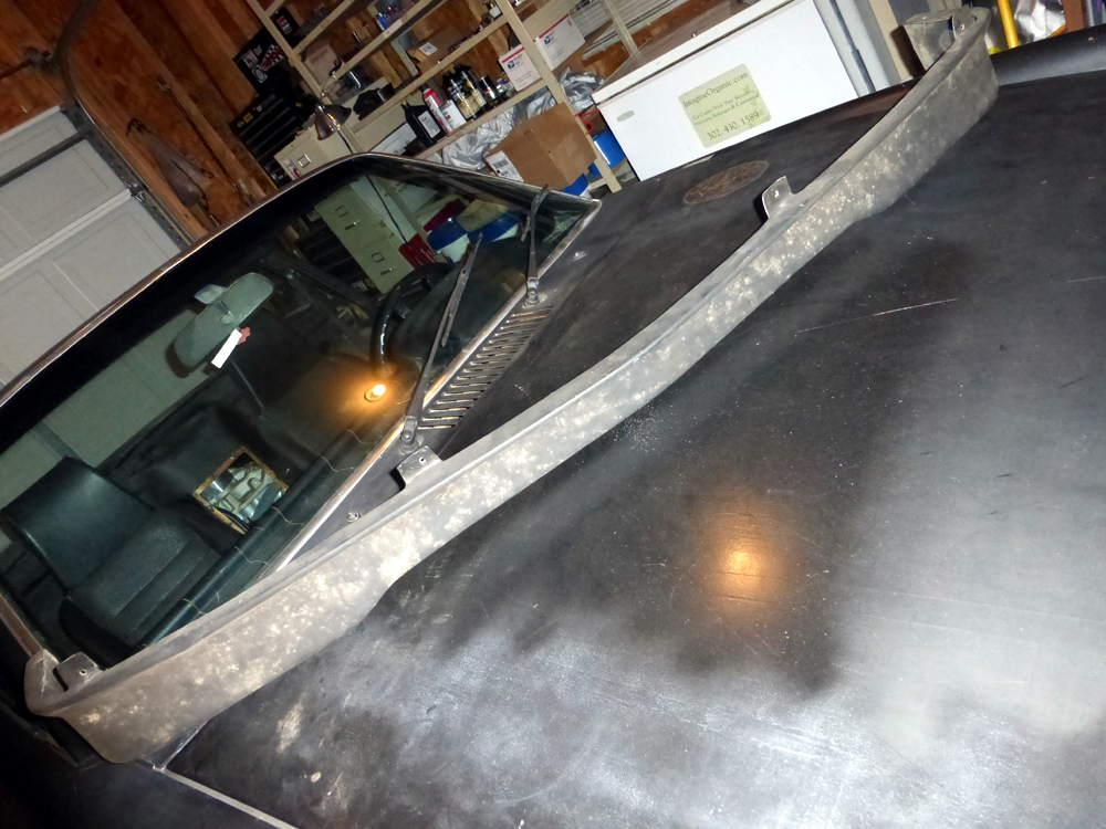

also got a passenger side front bumper grill coming. pic of drivers side.

I need a firewall piece, a late hand brake with cable (working), and 16 lug bolts (can be ugly - so i can roll whitey around my garage). thanks.

I have the firewall piece you can have for free. Best case senerio is next time your in Newark you drop by my shop. If you need me to ship I can but I would first have to trim the part since it's still most of the firewall.
