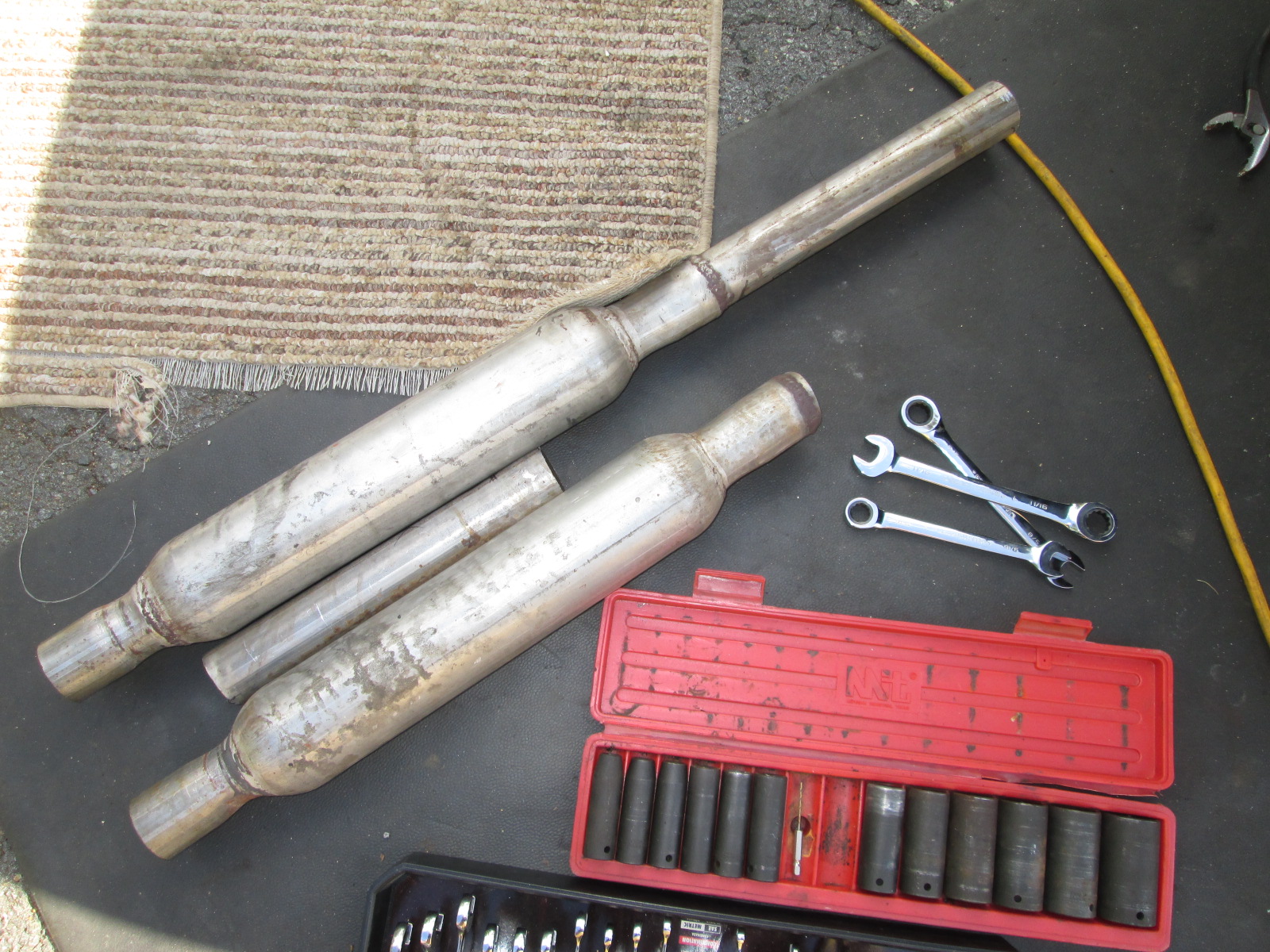

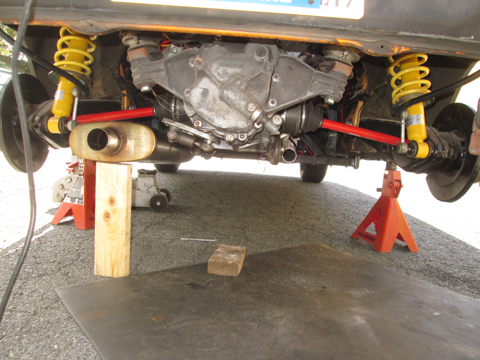

glasspacks coming out and magnaflows going in. kinda nice having a car that i can call a hot rod, or a rat rod, or a sports car, at will (IMG:style_emoticons/default/biggrin.gif)
jimkelly
post Sep 22 2015, 07:32 PM
Post #304
Delaware USA
Posts: 4,969
Joined: 5-August 04
From: Delaware, USA
Member No.: 2,460

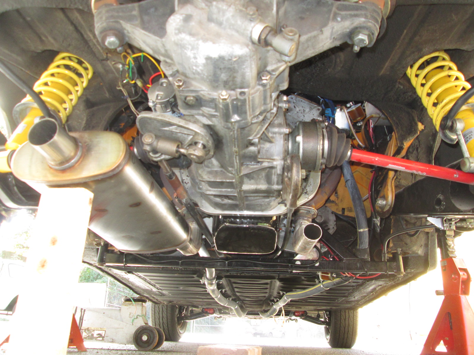

magnaflows are in and NO MORE DRONE. you guys were right to guide to toward magnaflows, i almost bought walkers. exhaust is a lot quieter and the rear section is higher off ground. tomorrow i will decide how to fab up a hanger. i just got it on ground and wheels back on and took it for a drive, so much more pleasant to drive, almost civilized (IMG:style_emoticons/default/biggrin.gif) but now i can hear more squeaks and rattles (IMG:style_emoticons/default/sad.gif)

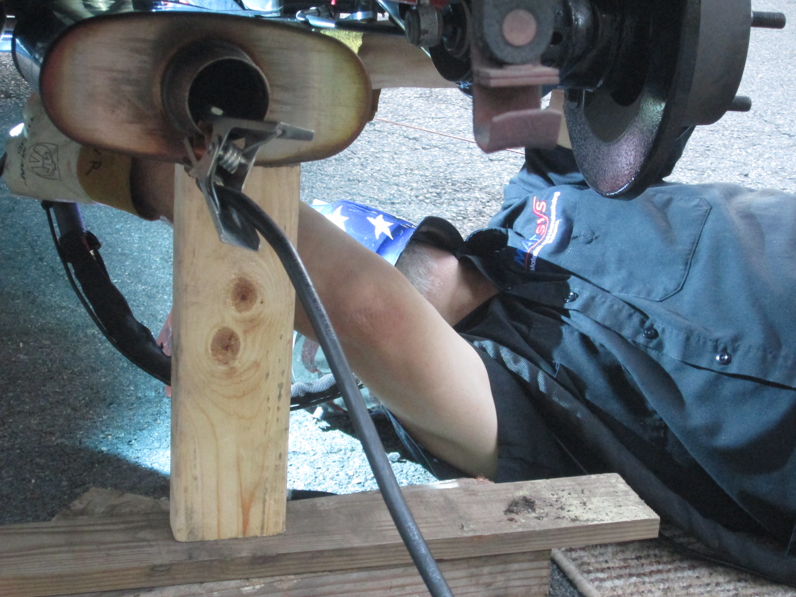

Who is this Masked Man? (IMG:style_emoticons/default/welder.gif)

rod, aka: root. he can tig like a madman these days (IMG:style_emoticons/default/welder.gif)

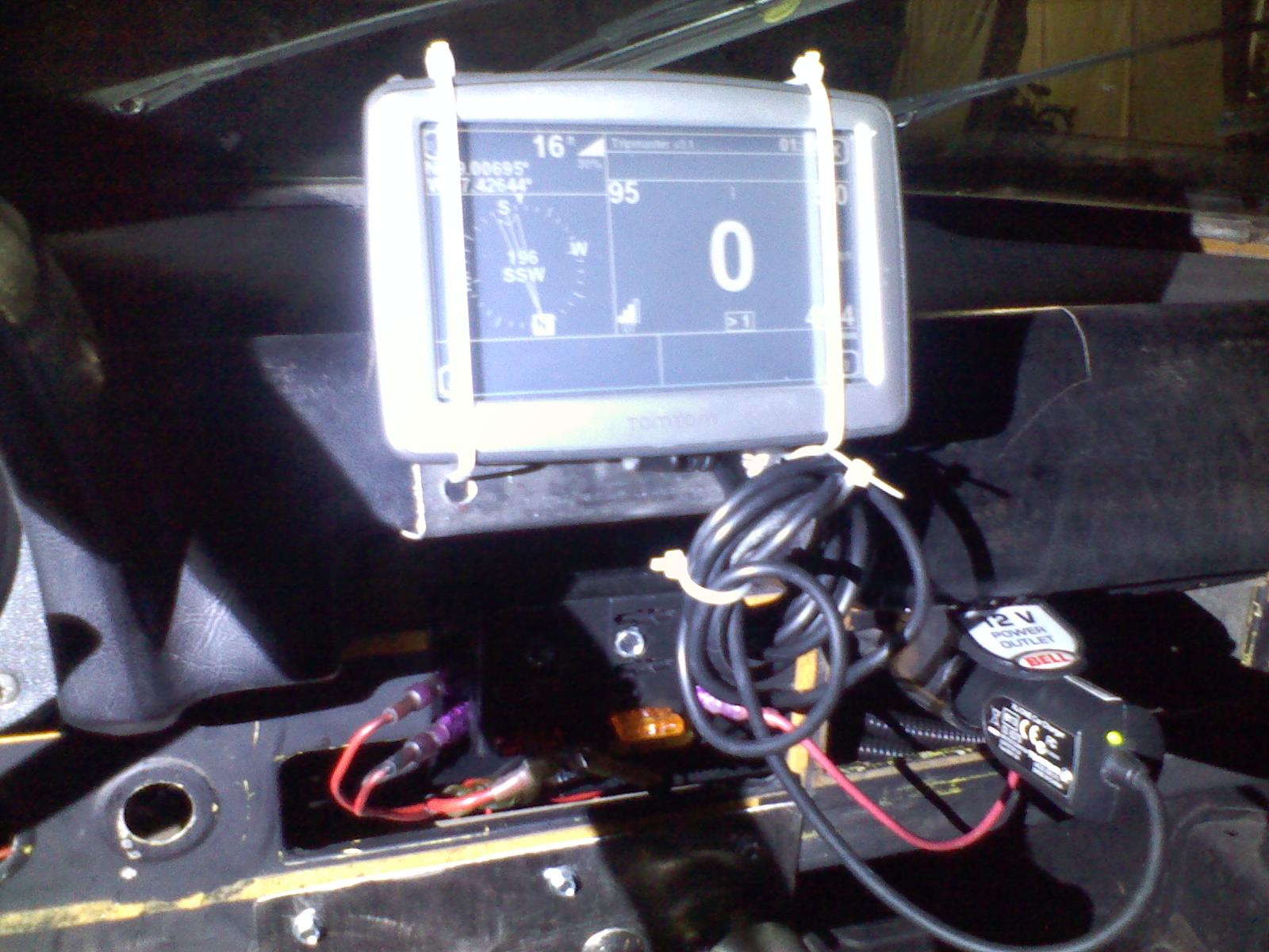

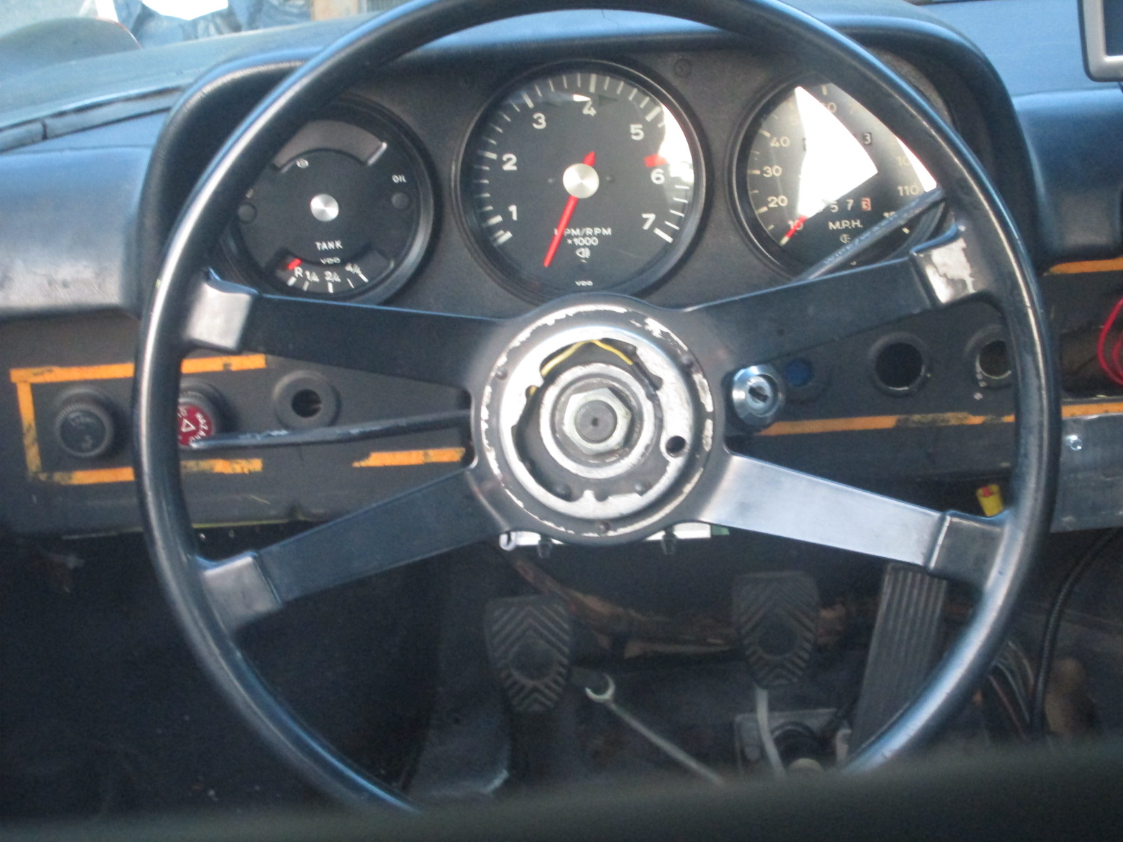

today got steering wheel straight and tightened my ebrake cables a bit.
i expected steering wheel to resist removal but she jumped right off and said "thank you " (IMG:style_emoticons/default/biggrin.gif)
rigged up my GPS using some holes where my ashtray used to be. could not take the gooseneck holder i had before that bounced all over the place like and erection in an earthquake (IMG:style_emoticons/default/wacko.gif)

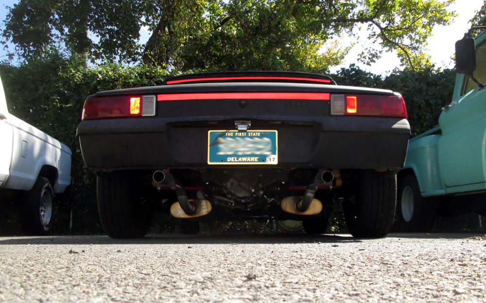

hard to hear much improvement but believe me there is a big improvement over glasspacks using magnaflows.
old exhaust
https://www.youtube.com/watch?v=VdXDxG2QvaY
new exhaust
https://www.youtube.com/watch?v=_N0-a52Csdc

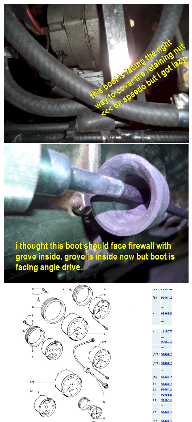

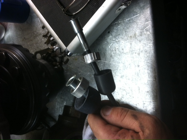

speedo installed (IMG:style_emoticons/default/smile.gif) but I got a boots question. I thought big boot should be facing firewall? not angle drive? if this boot covers angle drive, what covers the hole in the firewall, the small boot? makes sense to me now. it is just when I rcvd it, the speedo nut was lodged in the smaller boot. my sbc 307 seems to hum all the way to ALMOST 5000 rpms. though I keep it around <3k most of the time. still trying to get used to driving a stick again.

found this. now I have to reread it a few times.
http://www.914world.com/bbs2/index.php?sho...=241571&hl=
mine is like this. I will probably just put some silicone in the firewall hole and not try to slide the smaller boot all the way to the speedo gage.

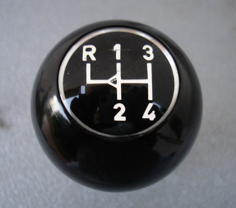

pic of knob I need to get.

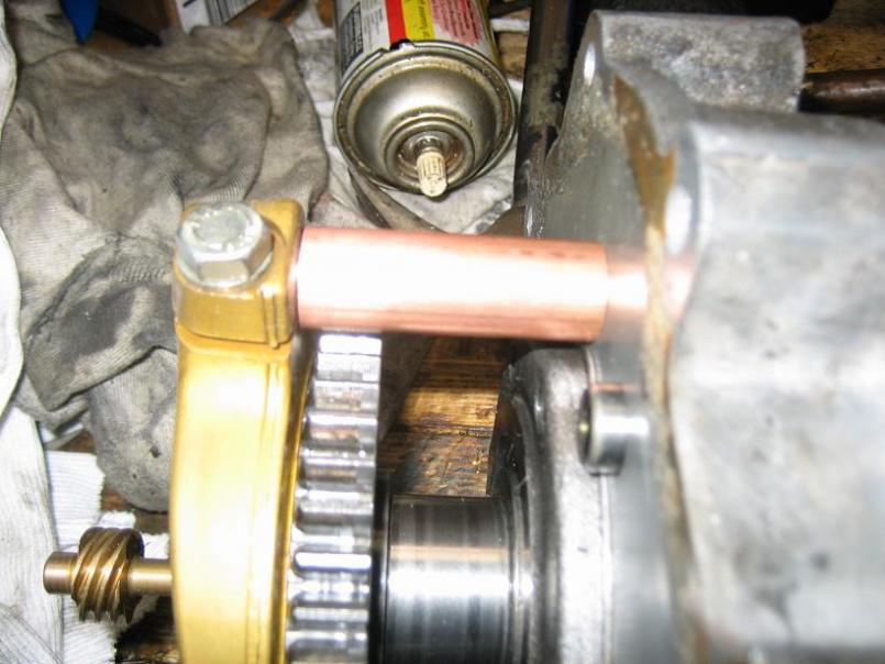

would like to add this sleeve at some point.
http://www.914world.com/bbs2/index.php?sho...l=first++sleeve

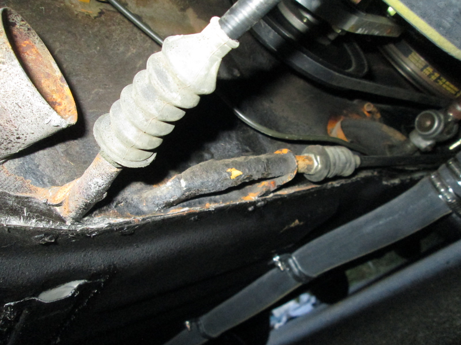

turns out my shift linkage at firewall is loose. I assumed it was the ID of the bushing, BUT it turns out that it is the OD of the bushing OR the ID of the hole in firewall?

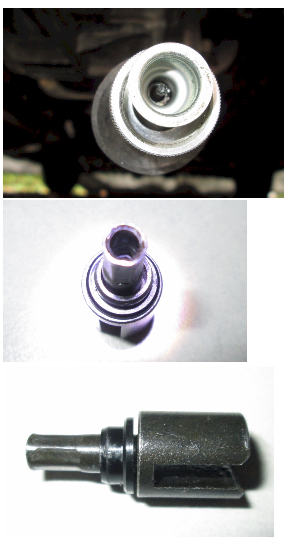

put a speedo cable in and guage seemed to work fine aftyer initial testing but then on a long drive it started making noise, then guage stopped working. put a drill on end of cable and guage did not move, pulled on fitting on trans end of cable and it cam off easily in my hand. seems it got hogged out during my drive. i think i did not have cable routed smoothly (least curves) enough? i'll try again with an old cable this time.

Get foleys firewall bushing and the ujoint that is right outside the firewall.
For the sleeve, use bronze not copper.

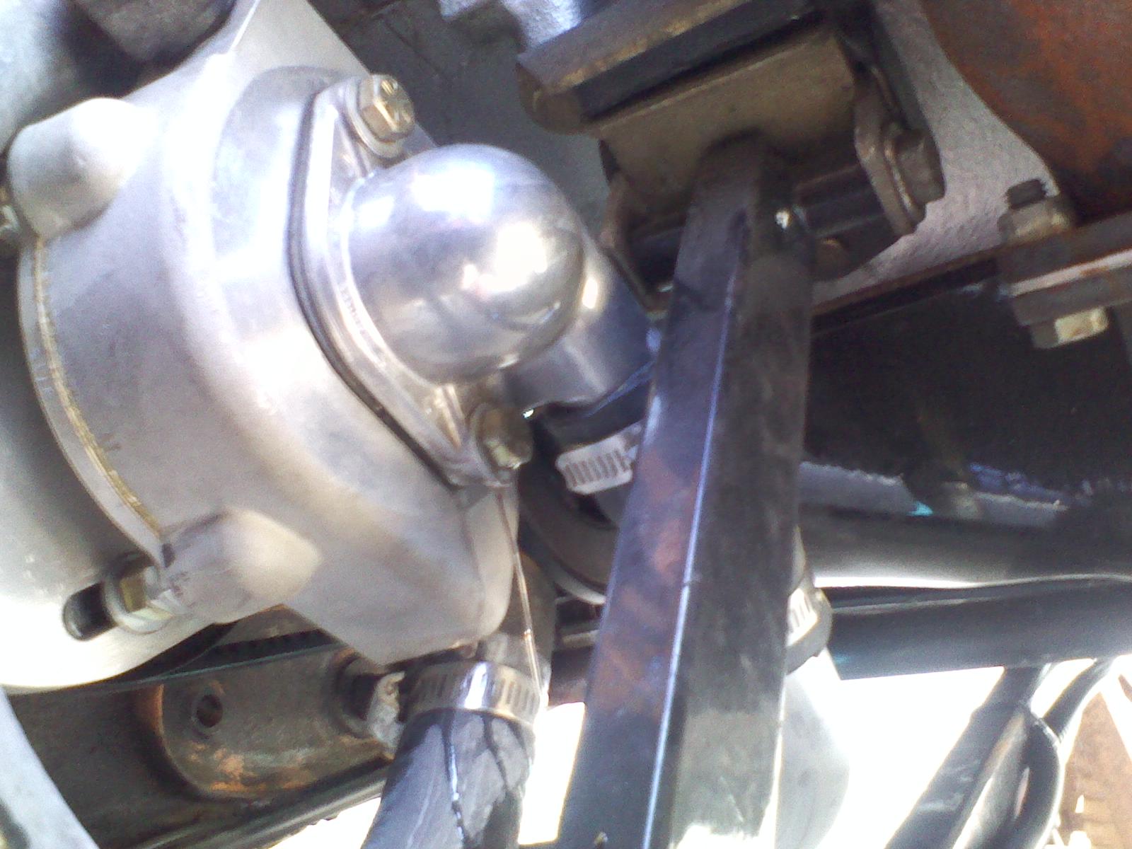

i know that not many are doing sbc v8 conversions anymore AND that renegade is making only LS conversion kits BUT if these things were not the case, it would be far better if the water cooler belt was the rearward belt and the alt belt were the forward belt BECAUSE to remove the alt belt requires the coolant to be drained from car cause the neck on the water pump touches the motor mount and stops it from sliding lose thus requires the neck to be removed : ( at least this seems to be the case for me.
my alt belt won't stop fluttering, not matter how tight or loose i set it. seems like i need a tensioner?
i need to source a neck (made in china also) that comes down the other side i think.
note the leak, i was already removing neck.
