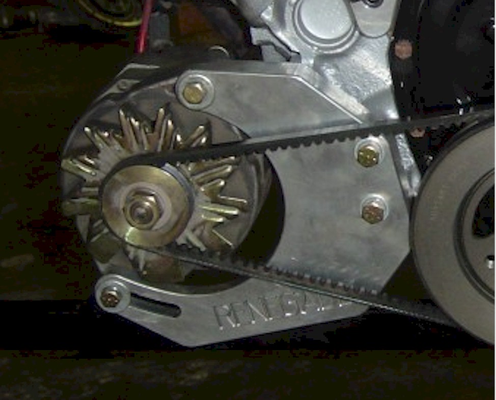

Hi Jim. Cool seeing an old school sbc build, don't see them often anymore. I have one also and love it. I just crawled under mine to look at the belts for you. Maybe check your belt numbers? Both are Gates belts 7410 for water pump and 7355 for alternator. My alt belt flutters a little, not more than any other old style belt car.

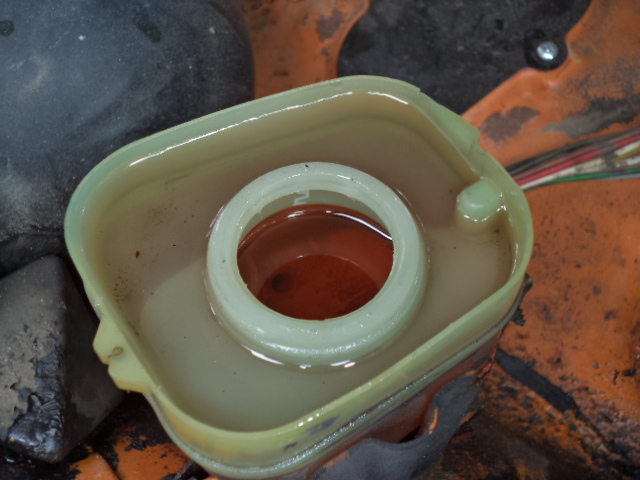

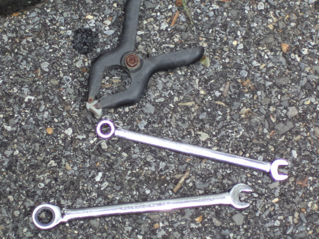

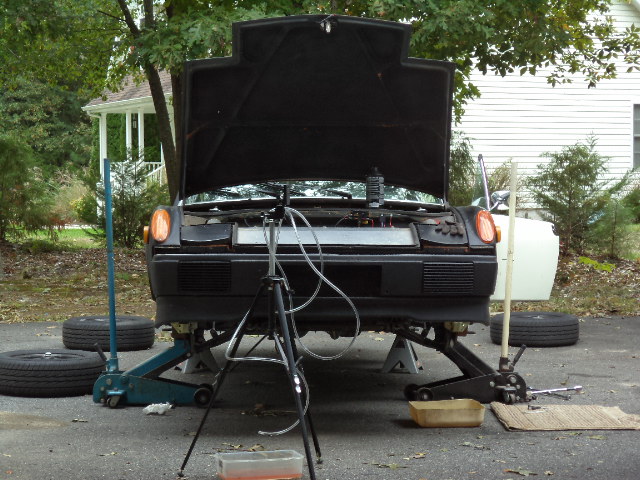

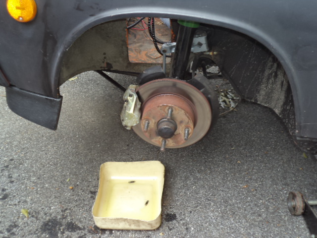

well, I finally know what all the fuss is about SPEED BLEEDERS. they are as awesome as everyone says and they should be on every car. if for no other reason that they have a larger hex on them and they seat in REALLY nice.
I raised the rear when bleeding the rear and front vice versa. and as per rtowle I added 2 drops of food color red to fluid to be sure I bled my lines completely. I found it took about 20-30 pumps of the peddle to fully clear out all old fluid. thus you can see pinkish fluid in my reservoir. I used only one qt to do the entire car BUT bought 3 expecting to need more (DOT4).
I just bled all 4 calipers and my peddle felt nice and high once done. I think I have a lingering problem in that my pads were never really bedded in properly.

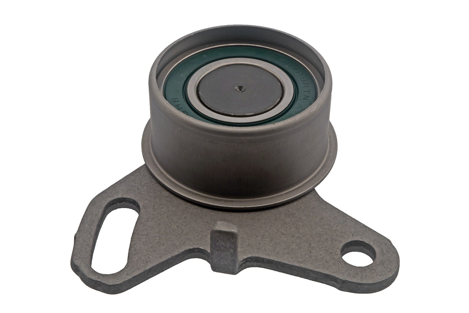

I have the store covers for those belts and think I still have a 7410 on my car but my alt belt was too long to tighten down fully so I got one a bit shorter at advance auto the other day. but i still can't tighten it down enough to eliminate flutter, so I ordered a belt tensioner from ebay yesterday with hopes I can incorporate it onto mu alt bracket. thanks for checking on this for me (IMG:style_emoticons/default/biggrin.gif)

this is the one I went with, $13.41 shipped.

Nice! Are you going to tension the back side of the belt? That would increase the amount of pulley wrap also.

that is the plan. press on the flat of the lower belt loop upward.

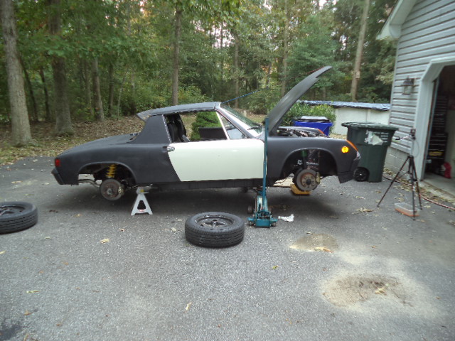

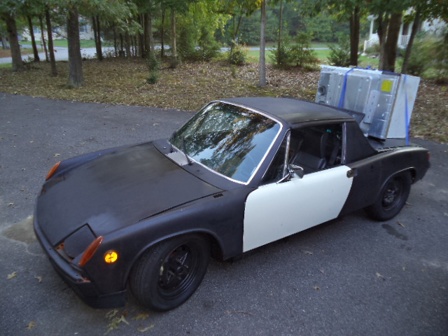

used the pickup today to take a washer, then a dryer, to the dump.
turns out my car weight about 2520, with me 220 in it, so car weighs 2300 lbs. wasn't expecting that.
oh yeah, I drove the car about 3 hrs last night, outside temp must have been 50-55 degrees. car stayed at about 190 degrees, almost rock solid. I do not know if my fans were on all the time. I need to install a light so i can know.

So they didn't have a classification for a 914 so they called it a PICK UP (IMG:style_emoticons/default/blink.gif) Looks like you burned thru 2.5 gal of gas between trips. (IMG:style_emoticons/default/shades.gif)

QUOTE(jimkelly @ Oct 15 2015, 06:38 AM) *
turns out my car weight about 2520, with me 220 in it, so car weighs 230 lbs. wasn't expecting that.
2300 sounds 100% right.
Only 7.50 for a dump? I have to pay $30 each trip.... (However old appliances like that scrappers come and get free)

$7.50 is the minimum, if I had a pickup truck with more capacity, I could have dumped both for $7.50 (IMG:style_emoticons/default/mad.gif)
I think the machines on the back of my car fucked with my aerodynamics a bit (IMG:style_emoticons/default/sad.gif)

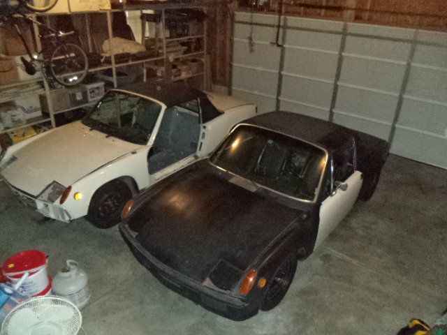

my garage, free of broken washer and dryer, much better (IMG:style_emoticons/default/biggrin.gif)
