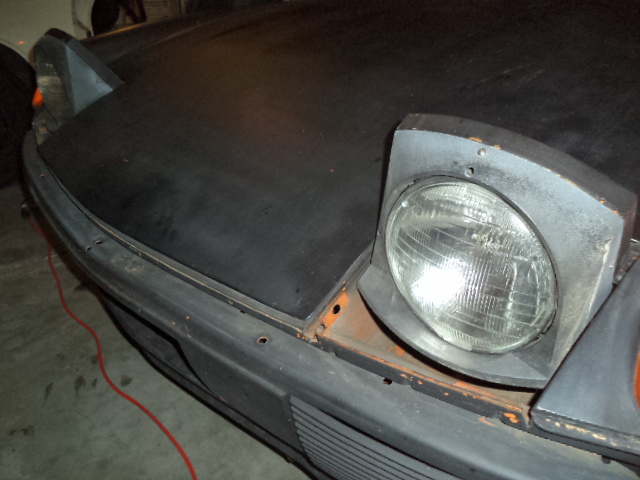

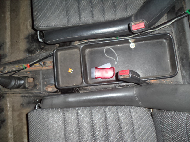

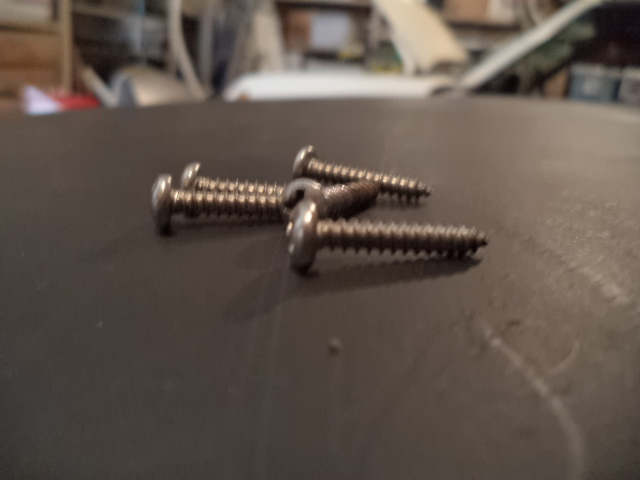

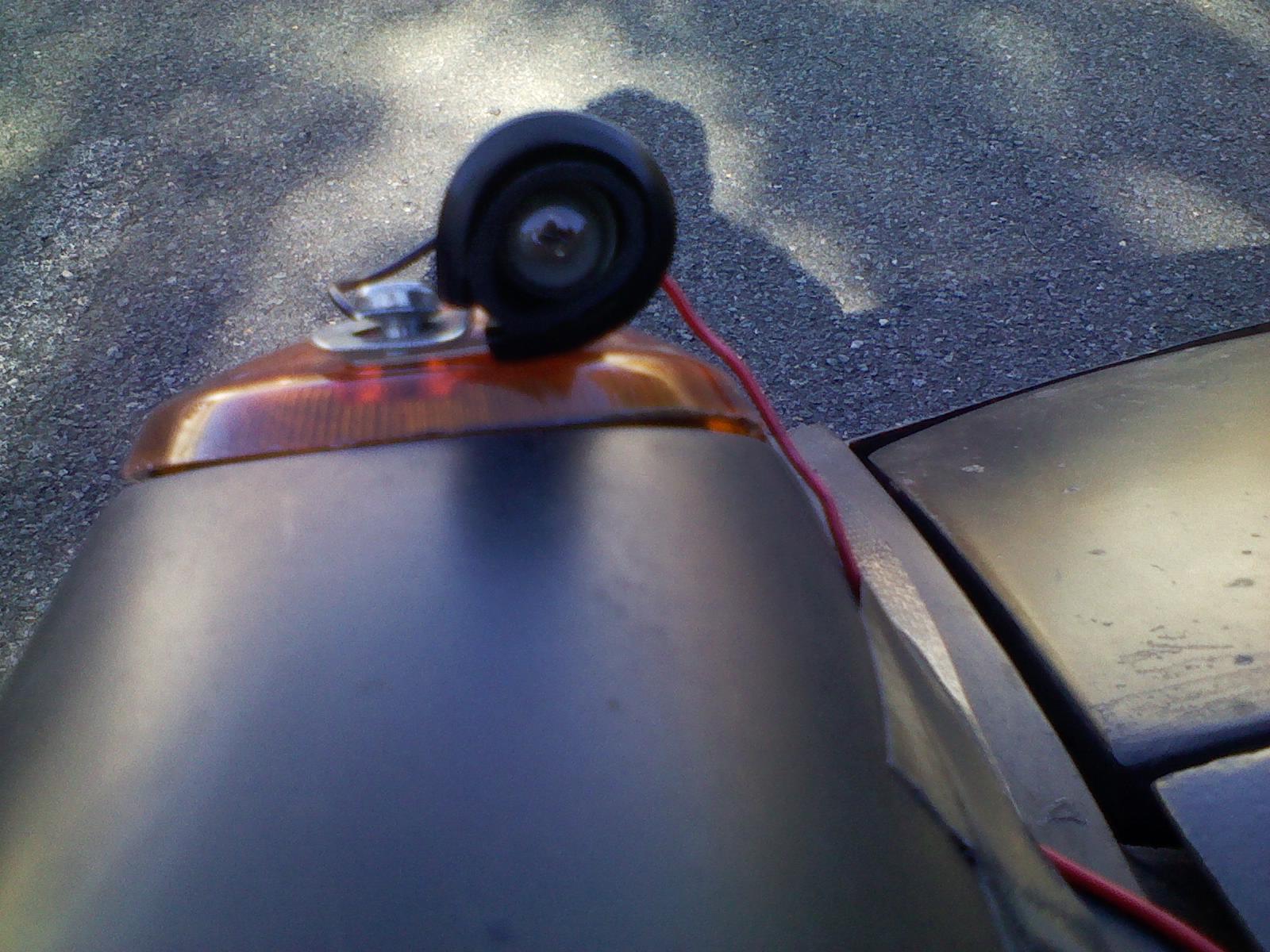

went to ace hardware to get some screws so i can attached my headlight surrounds. seems it helps to remove the front amber lenses when installing the surrounds, makes getting to the outer screws easier.
also popped my console tray in.
as you can see, my definition of INSTALLED, is quite different than most. in most cases I should probably say RIGGED (IMG:style_emoticons/default/unsure.gif)

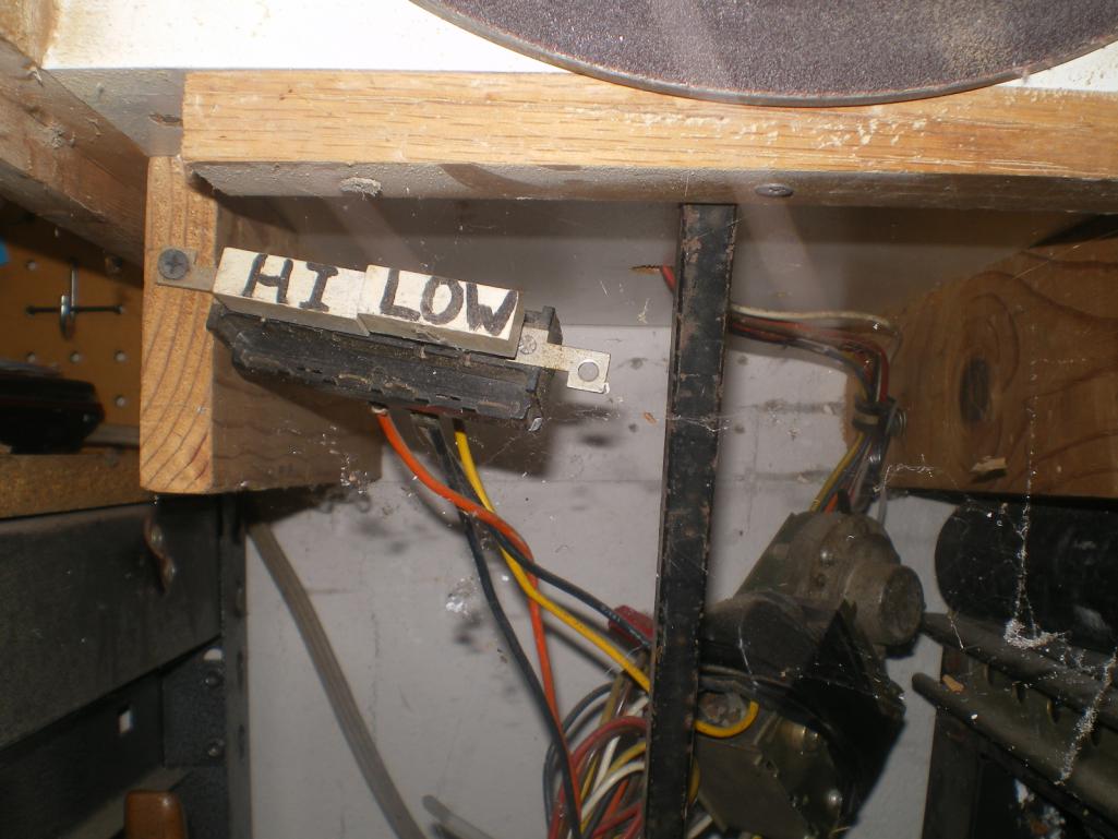

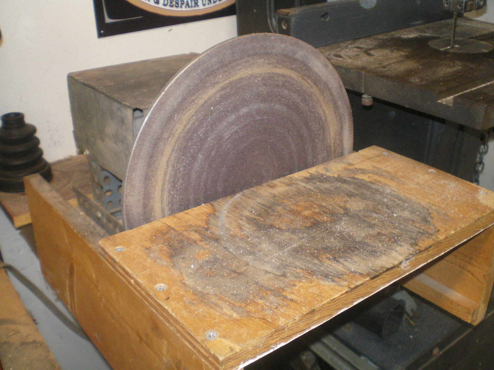

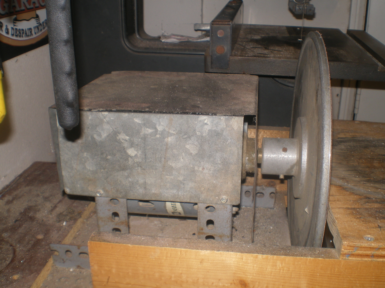

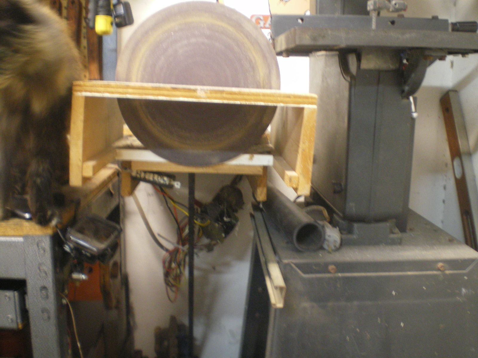

Washing machine motors can be used to make a nice 12" sander for< $50 in parts. (IMG:style_emoticons/default/rolleyes.gif)
That would be interesting to see...any picts?
Dave

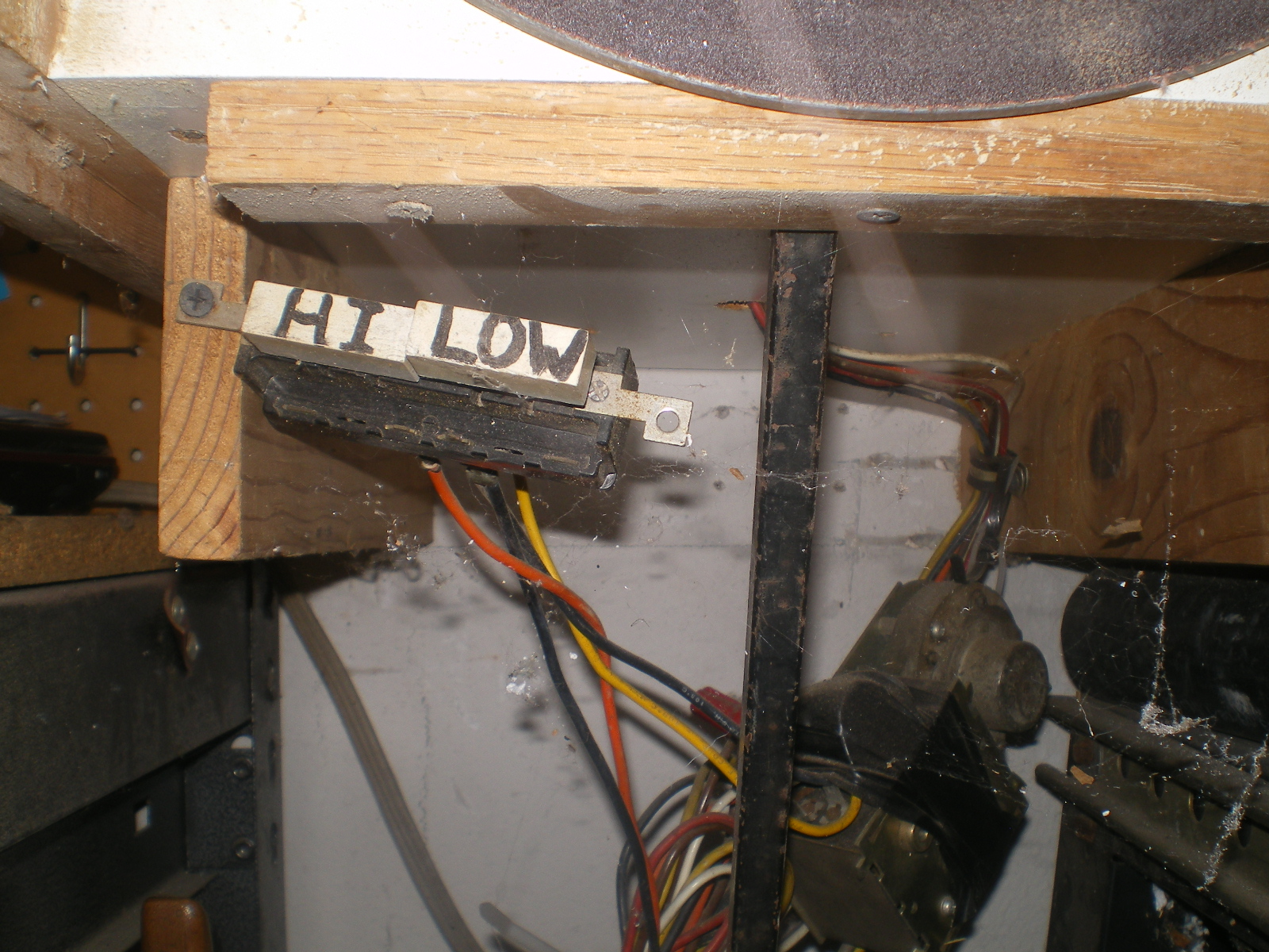

Sure. Excuse the brief hijack, Jim. It even has 2 speeds as seen in one pic. (IMG:style_emoticons/default/lol-2.gif) I burned up the first motor when I tried to use just 3 wires so the second time I keep the complete WM harness. That is the gob of wires beneath it. IIRC, I bought the disc from some company that makes large sanders. Just wrote them to say I had gouged mine and wanted a replacement. Just be sure the motor shaft size matches the disc. Hijack over. (IMG:style_emoticons/default/beerchug.gif)

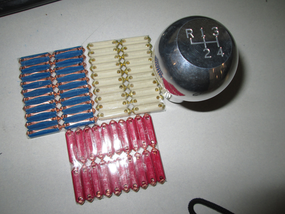

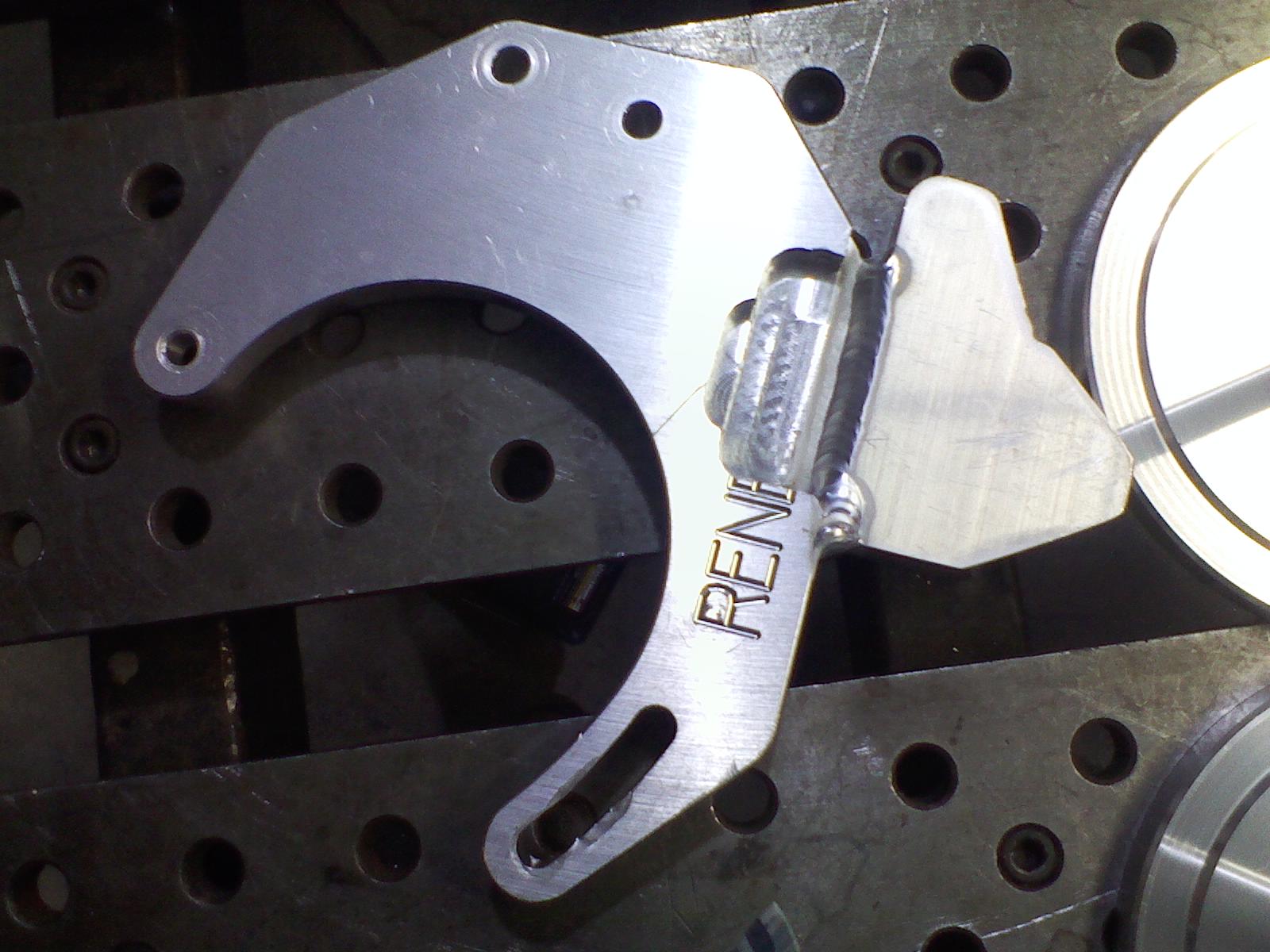

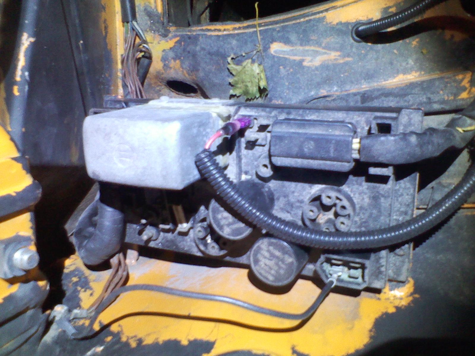

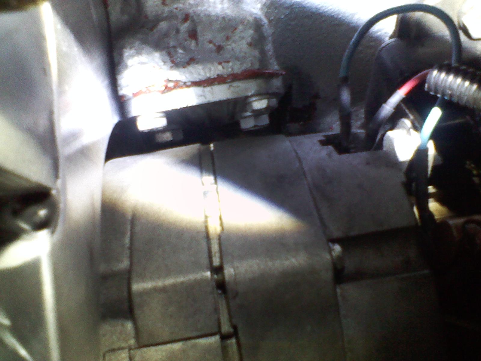

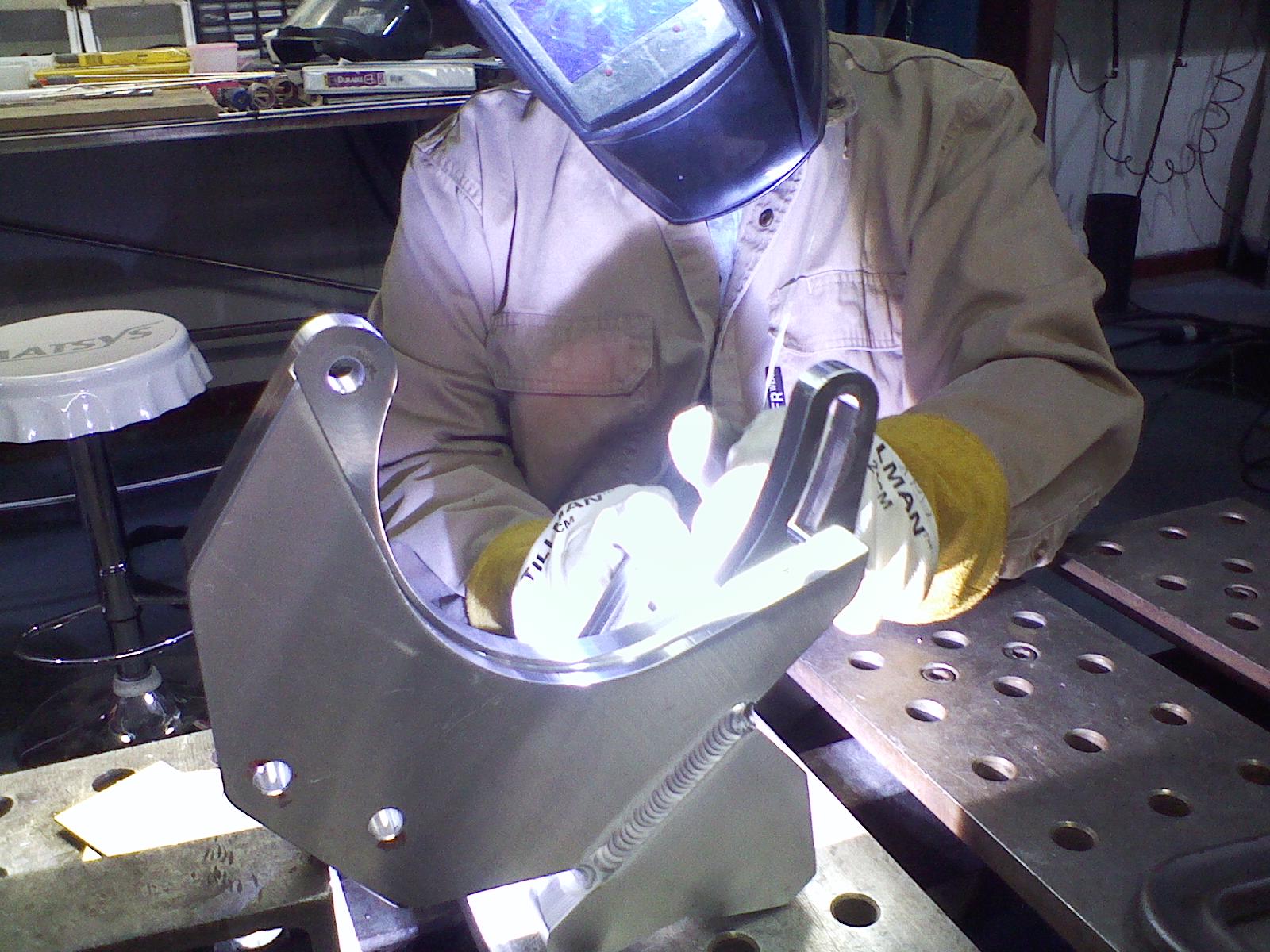

added a temporary light so i can see when my fans are running. i think i need to replace the 180 degree switch on the radiator with a 190 degree switch. fans did not run all the time but ran for long periods despite outside temps being in the 30s. and got me a new shift knob for my V8 and some fuses for my suby build.
pulley in, sounds like i have a turbo, some bearing whine on tension roller i think.
buy shift knob inn 5spd or 4spd

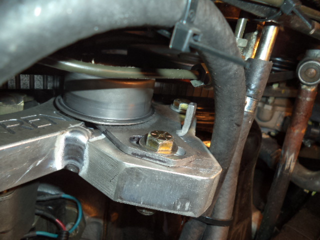

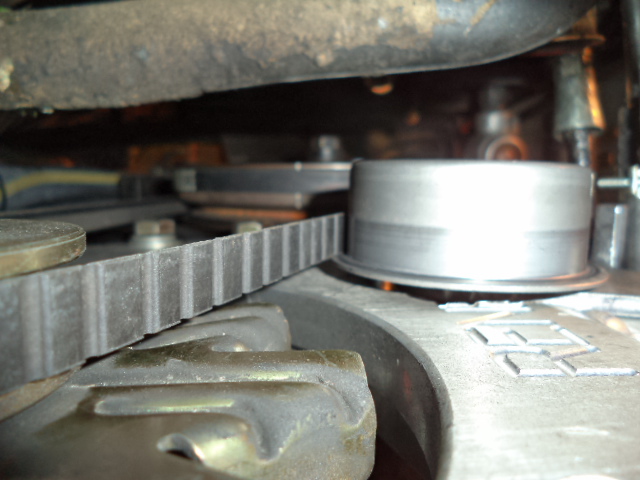

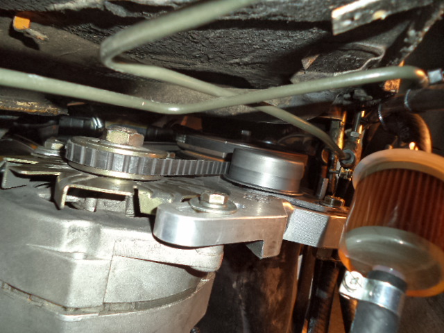

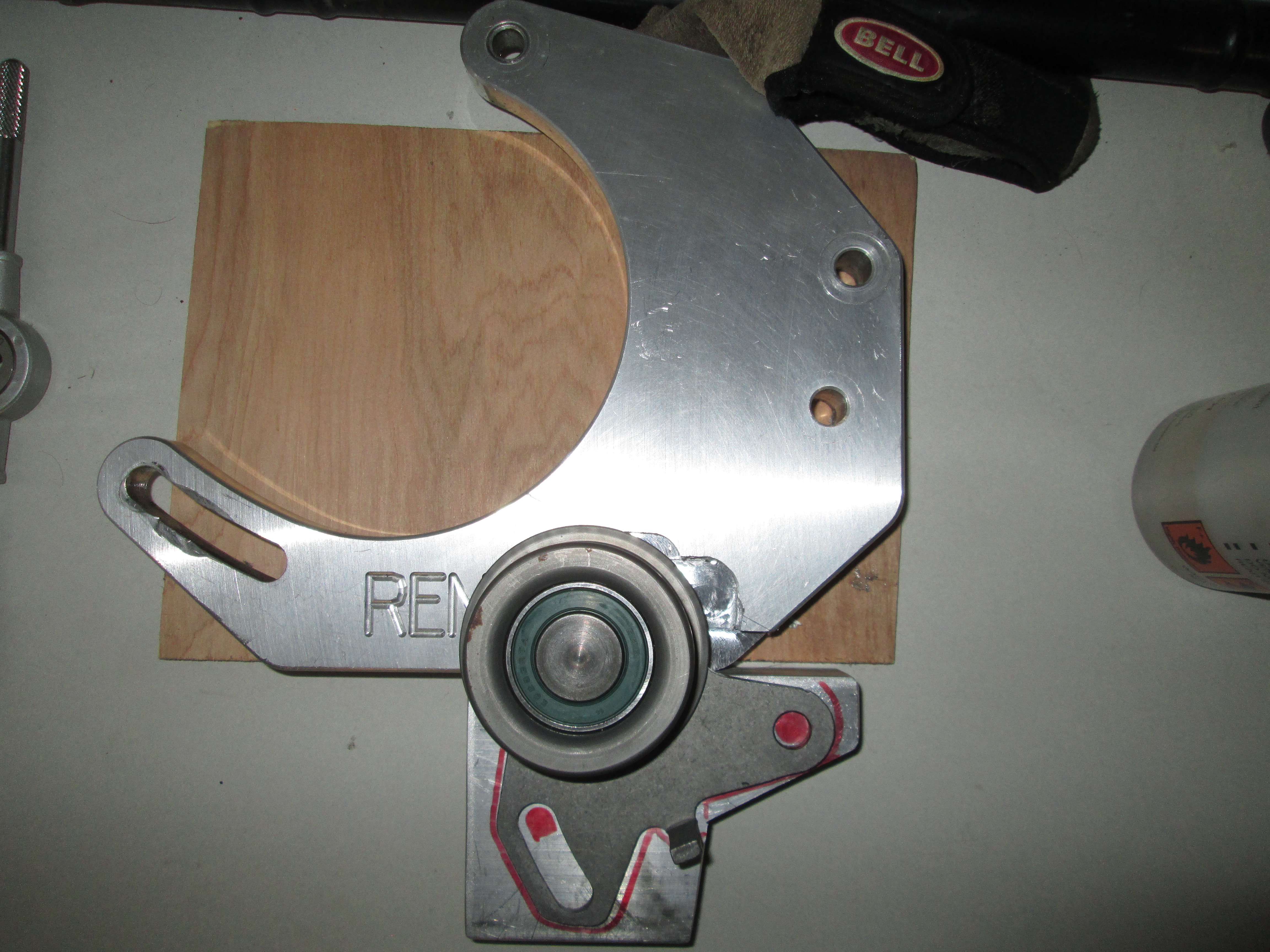

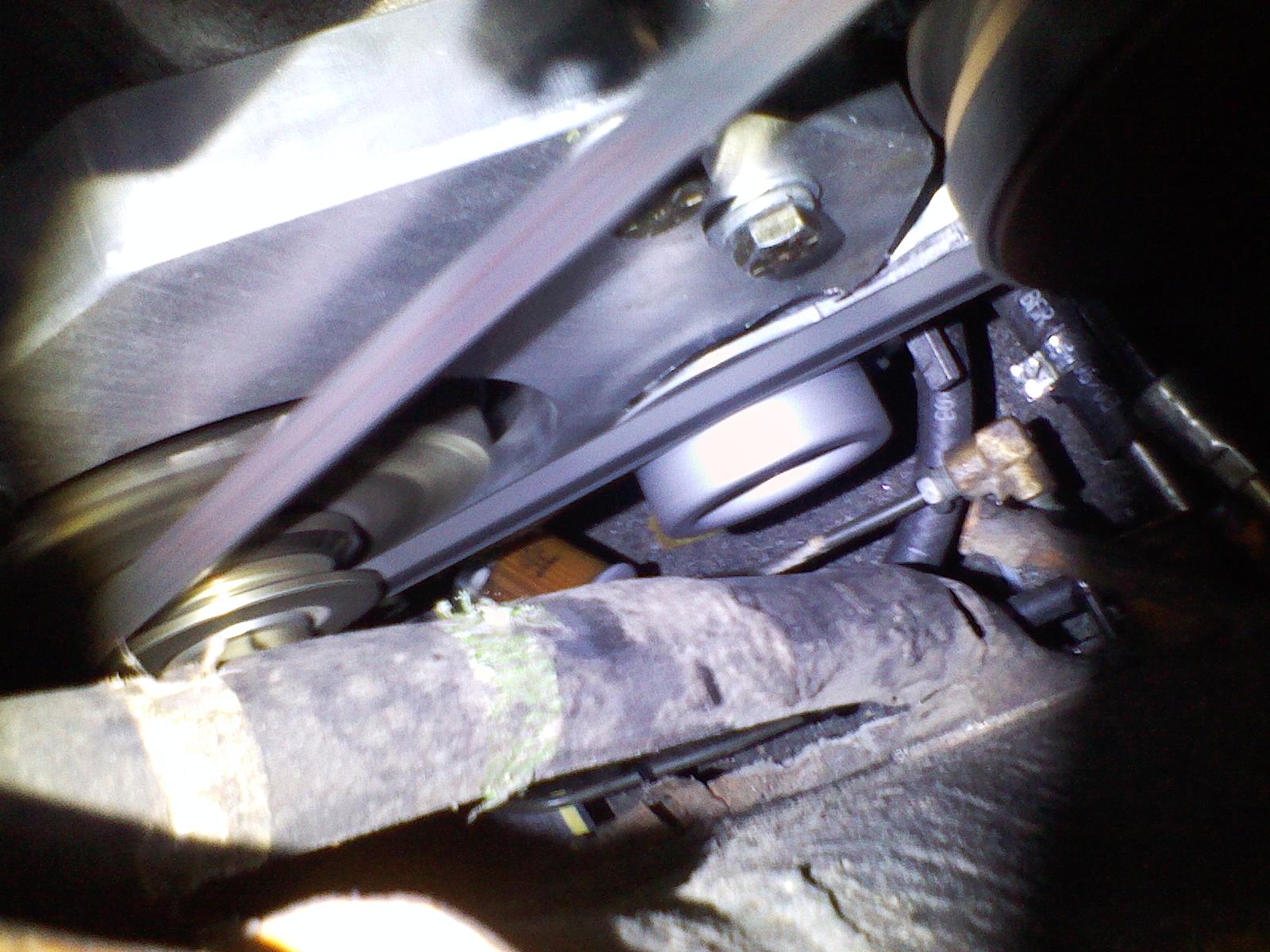

well, just took it for a test drive with the new tension roller instally, and NO FLUTTER (IMG:style_emoticons/default/biggrin.gif)
i do have a while from either the new roller or the alternator, so maybe tomorrow i will lessen the tension on the belt, though i don;t think i went too tight (IMG:style_emoticons/default/idea.gif)
nice to be able to drive at any speed and not get bad noises from the belt that forced me to adjust my gas peddle pressure for my entire drive.

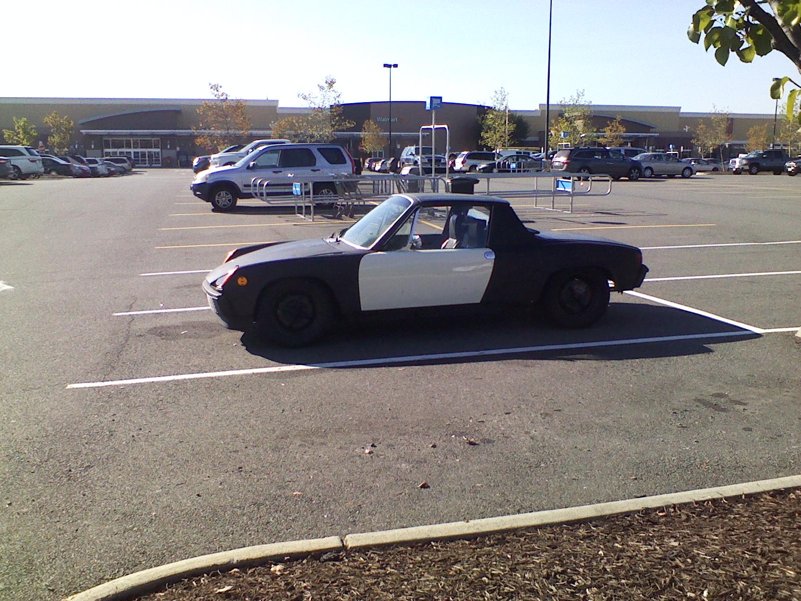

ran to walmart, love those low wages, oops, i mean prices.

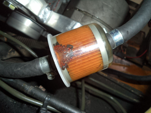

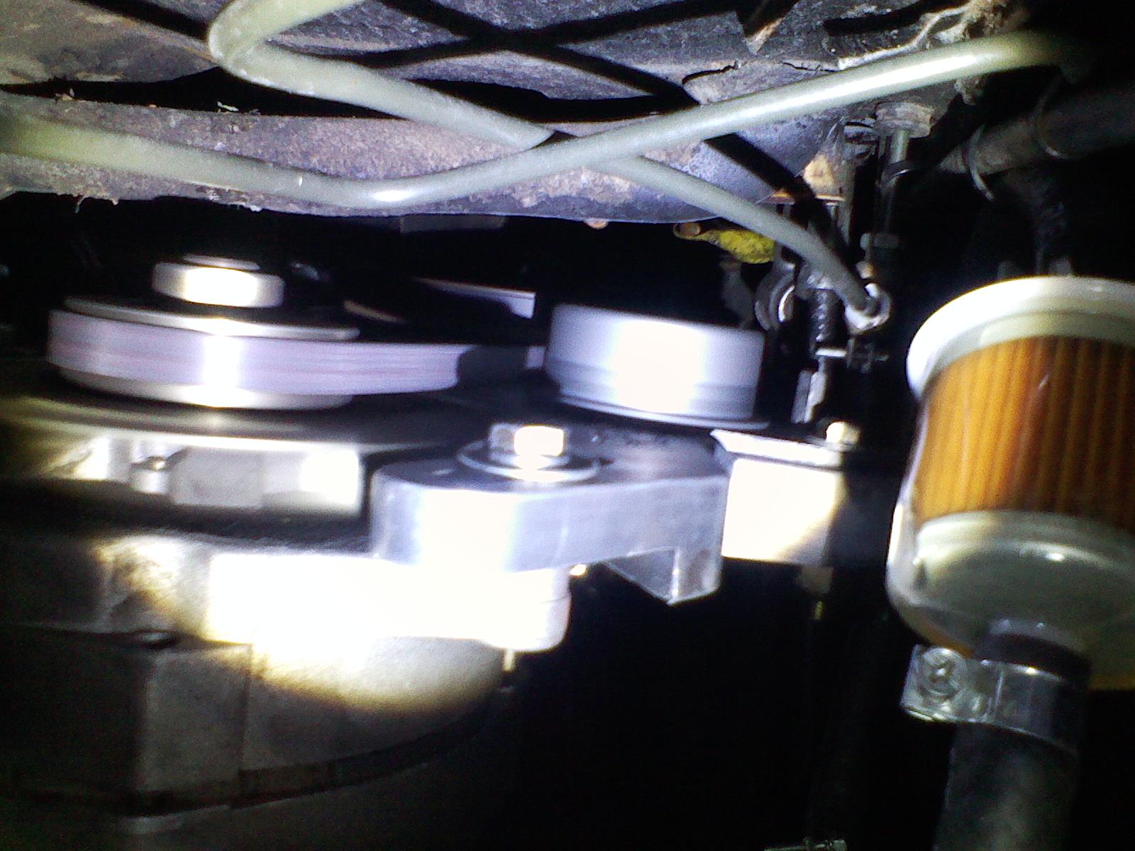

I now have a whining noise from belt. far better than having flutter. I think it is from the belt riding on the lip that keeps belt from riding off of pulley? might recess pulley a bit more into bracket. and another dirty fuel filter. I have plenty of metal ones but need more plastic ones that I can see thru.

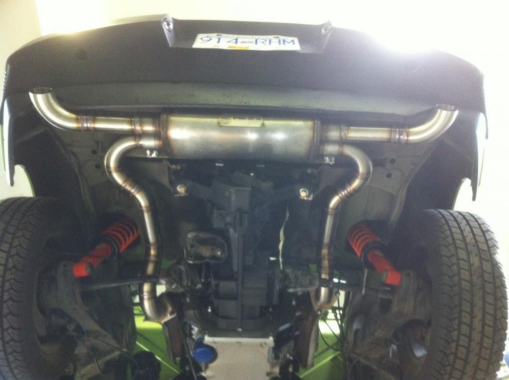

Speed Metal installed this single dualin/dual out magnaflow. Going this route.
(IMG:http://www.914world.com/bbs2/uploads/post-12137-1348117013_thumb.jpg)
jimkelly
post Oct 21 2015, 10:58 AM
Post #351
Delaware USA
Posts: 4,969
Joined: 5-August 04
From: Delaware, USA
Member No.: 2,460
that is real pretty. pls report back on quietness. video pls. i assume it can be removed with axles in? what is nice about one muffler in back is that it acts as a crossover too.

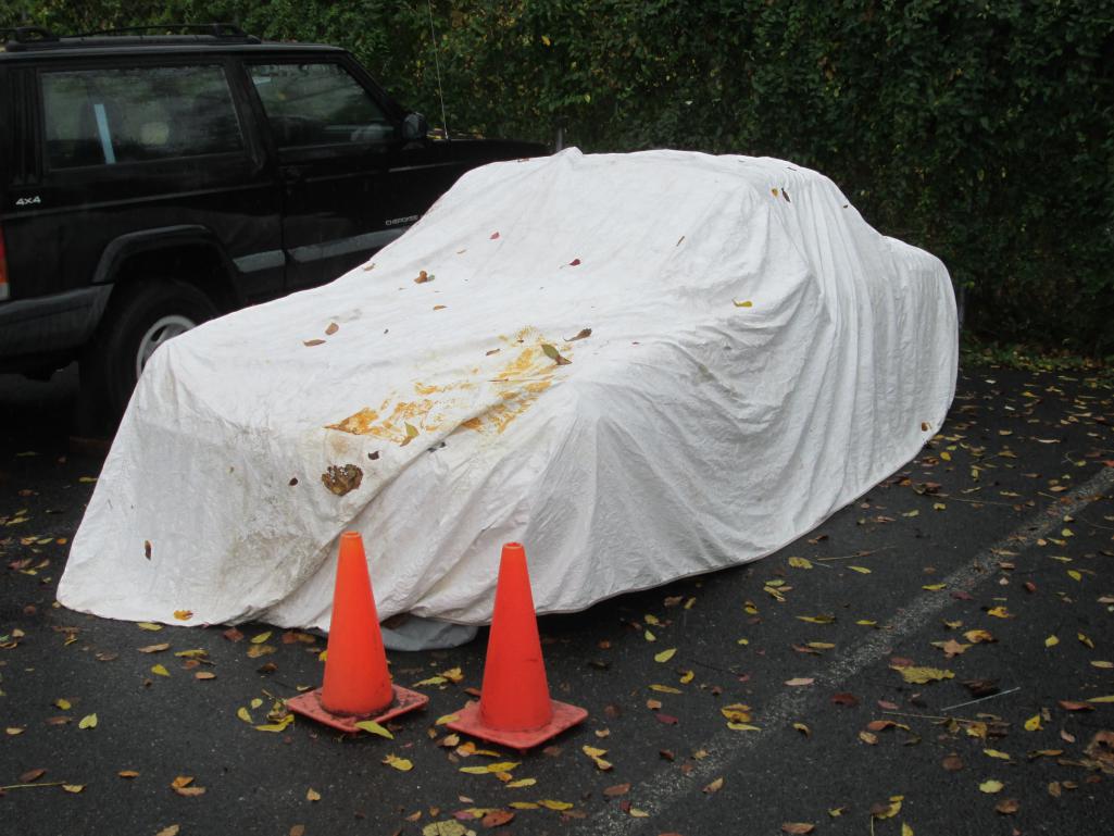

i hate nature (IMG:style_emoticons/default/sad.gif)

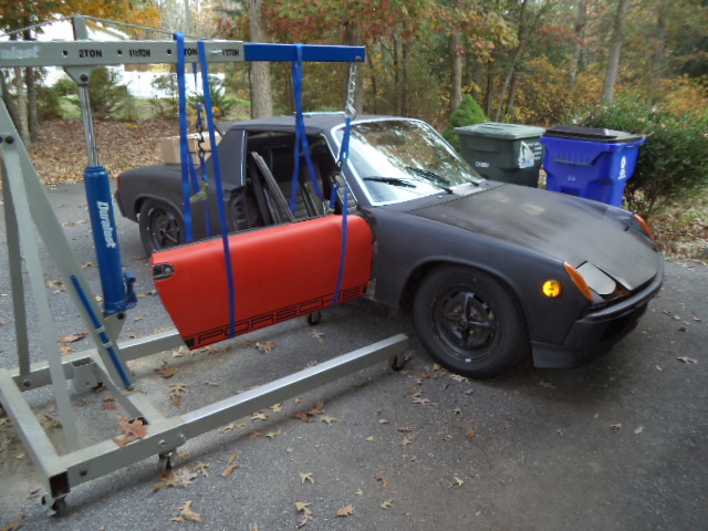

white doors off, red doors on.
Andyrew
post Nov 1 2015, 09:22 AM
Post #355
Spooling.... Please wait
Posts: 13,381
Joined: 20-January 03
From: Riverbank, Ca
Member No.: 172
Awesome technique BTW (IMG:style_emoticons/default/smile.gif)

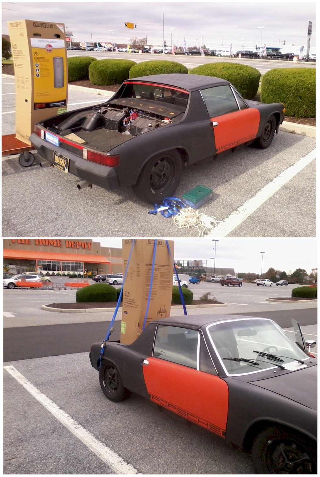

this is getting ridiculous. I really need a pickup truck. my hot water heater broke and I needed to replace it today. Porsche 914 to the rescue. even had to remove the trunk lid to pull this off.
Andyrew
post Nov 1 2015, 05:37 PM
Post #357
Posts: 13,381
From: Riverbank, Ca
Member No.: 172
That is nuts! I think I would have laid it on the roof myself... as in on the roof and in the trunk.

QUOTE(jimkelly @ Nov 1 2015, 04:43 PM) *
I'm curious if it made it home safely without falling out.
Around here in Dallas for $20 you can rent one of their trucks for a little over an hour.
I have done this many times over the years.
--- bill

drove 45 in a 55 all the way home. got it into place and installed, but no heat (IMG:style_emoticons/default/mad.gif) this is my 3rd water heater install, never had any trouble before. (IMG:style_emoticons/default/headbang.gif) just called a neighbor plumber.

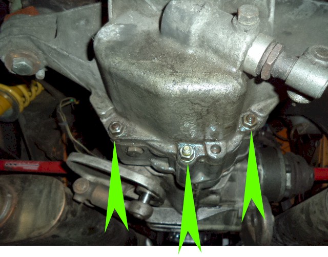

today: 15 nov 2015, found 3 trans nuts loose.

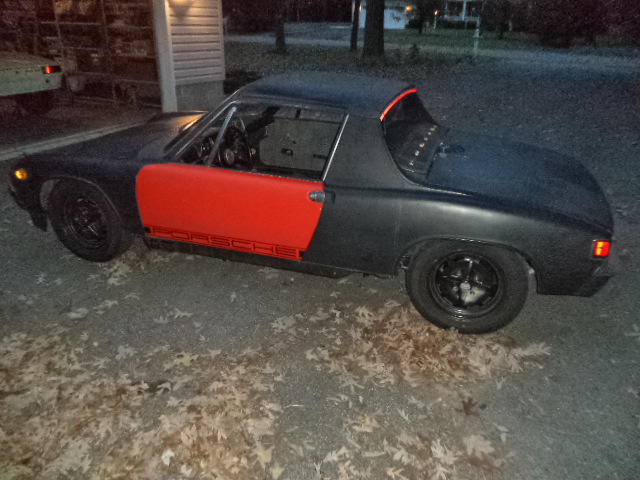

too dang cold for my baby (IMG:style_emoticons/default/smile.gif)
