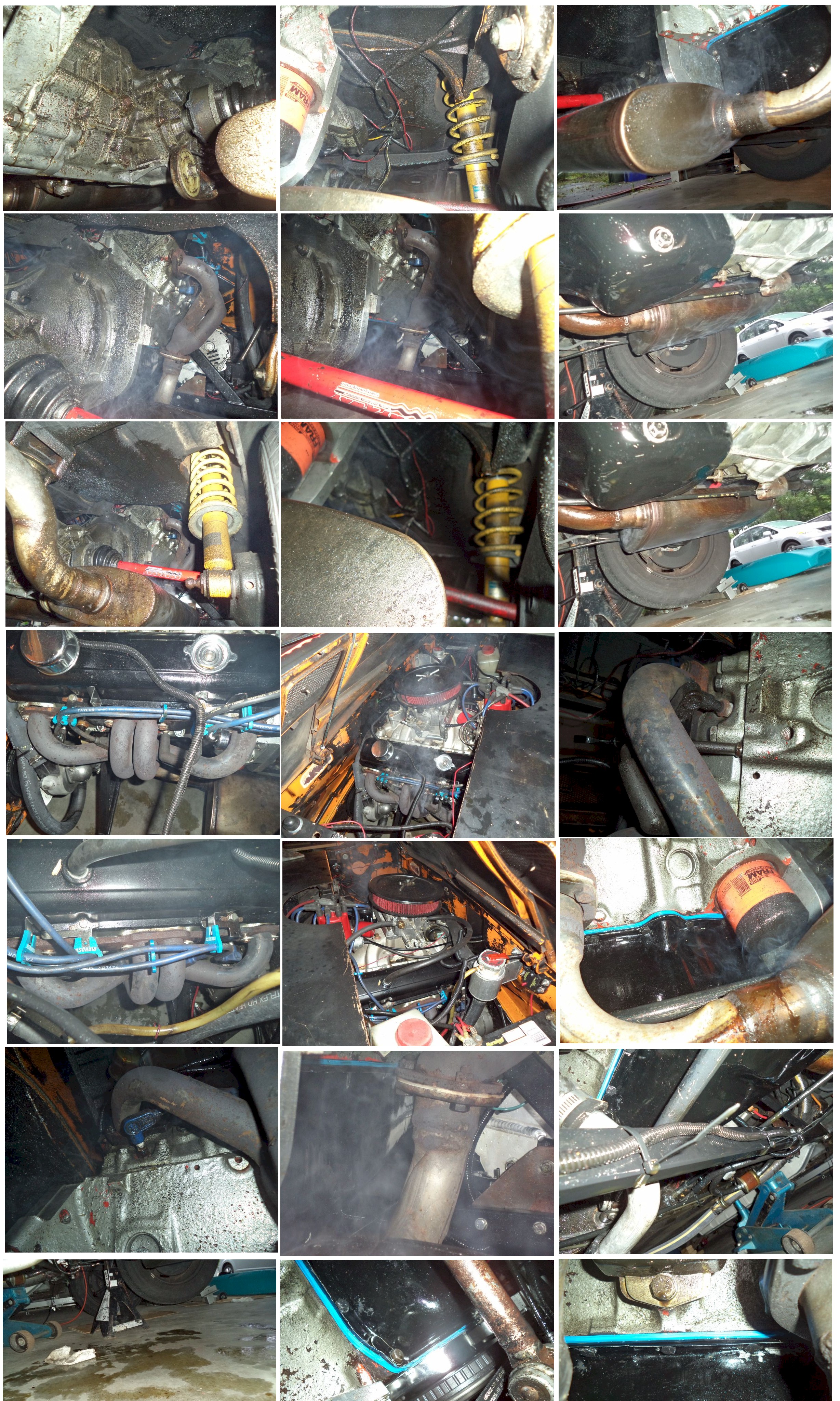

turns out that despite best efforts, it is not very easy to uninstall and reinstall a timing cover and oil pan, and completely seal them both, with engine in car. my engine still leaks, more than before, thus i am now looking at removing engine from car, so i can repair this with engine upside down on engine stand. just wish i had my hoist here at work : (
watching steve do it has given me the confidence to give it a shot myself, along with a few youtube videos. we put a one piece felpro got at his local advanceauto on it and they are reusable, is that is good.
while i am in there i will check the teeth on my starter and flywheel to make sure non are missing as i have a weird sound when i start my engine.

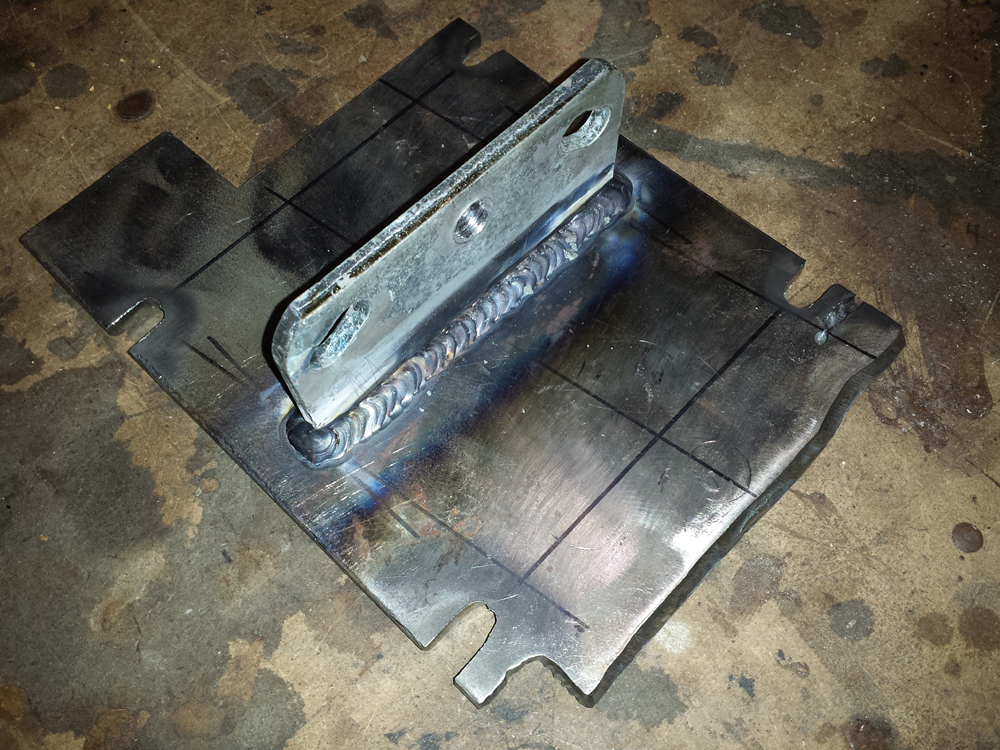

decided to tackle this over the weekend at home in the comfort of my garage and closeness of my tools. bringing home an engine stand and made this lift bracket from some scrap laying around the shop.

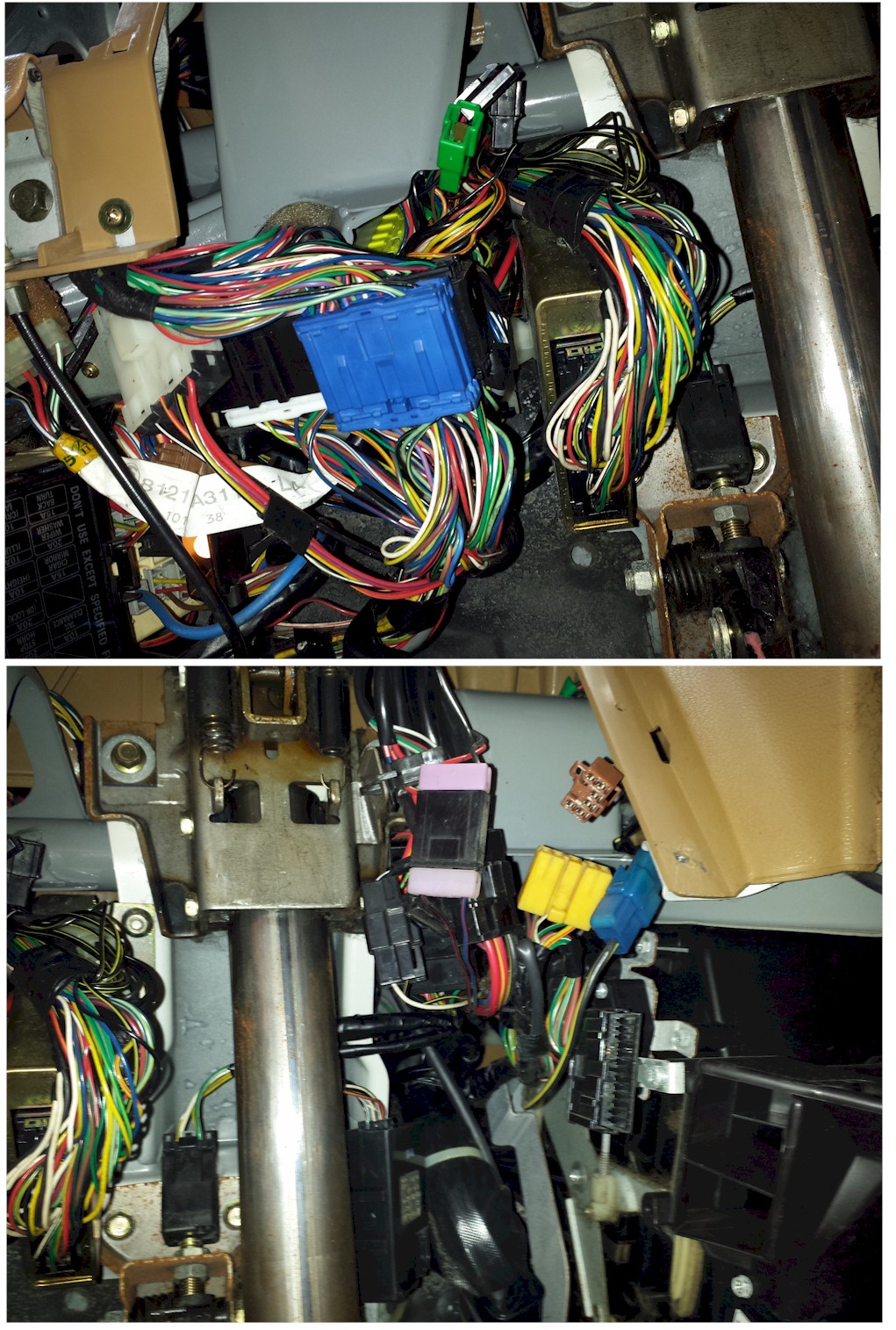

and the removed for cleaning iacv from my 1990 legacy, could be causing my stalling issues?

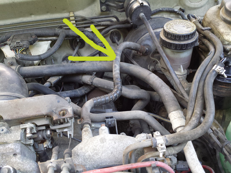

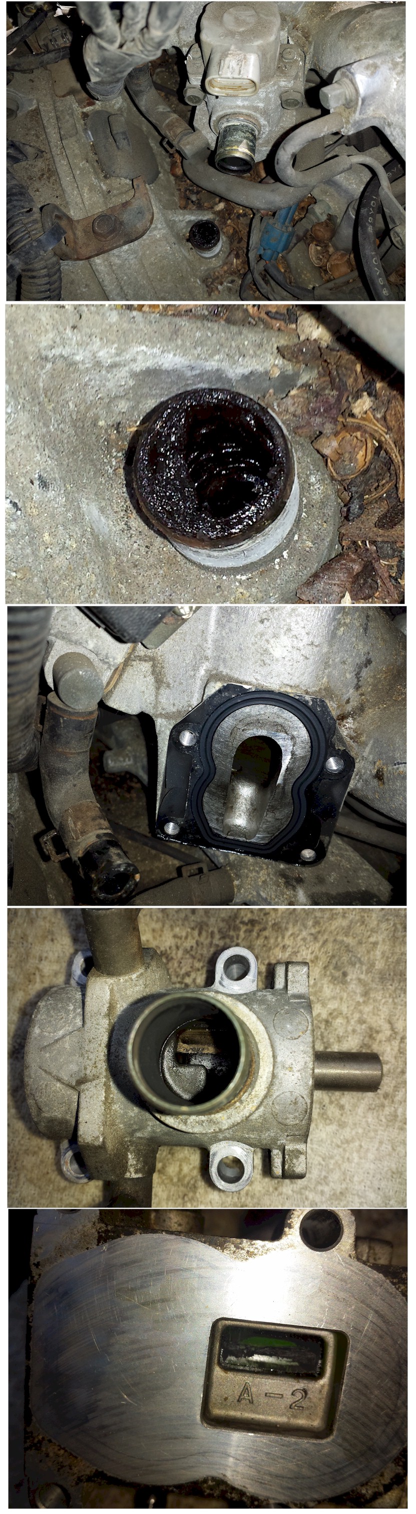

the weather is rainy and overcast here in DE this weekend. I jacked car up yesterday in an attempt to actually see the source of the leak BUT holy shit, my car looks like it was deep fried, southern style, oil every where. add to this I just started wearing progressives, vision sucks, and being in the dim light does NOT help.
though I was fucked with suby and 914 not being driveable. checked some online threads for suby stalling (at idle and while driving) and found a few, one suggest fuel filter, and being the easiest, I bought a new one an popped it in.
http://www.ultimatesubaru.org/forum/topic/...alling-at-idle/
http://legacygt.com/forums/showthread.php/...ing-138323.html
well, first for the oil pics.

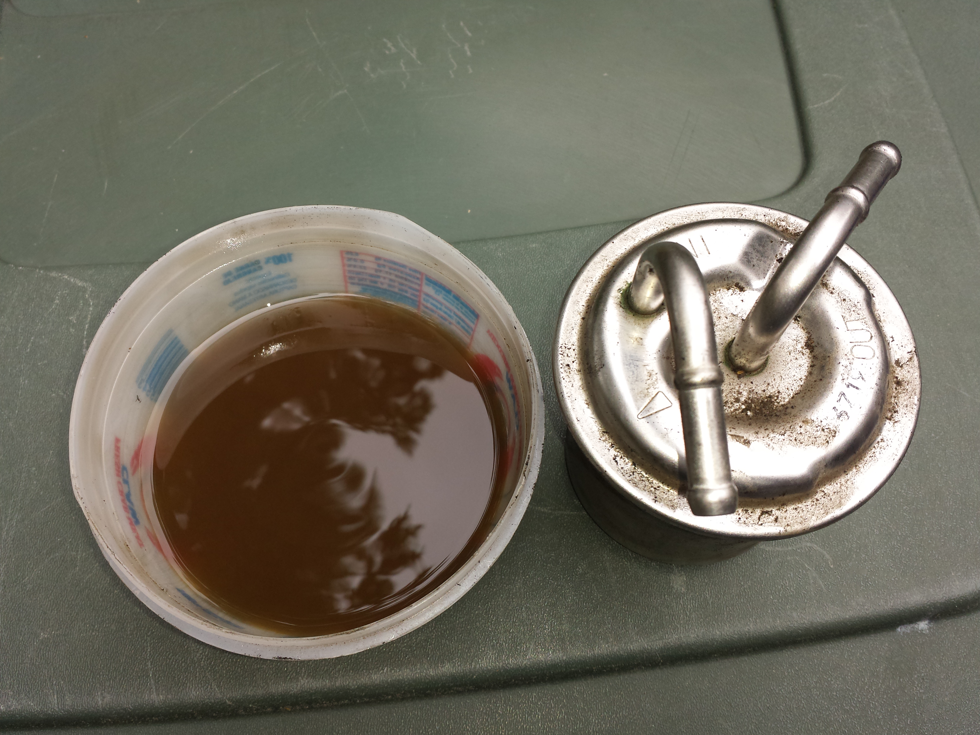

and now for the dirty gas in the OLD suby fuel filter. $47 for new filter at advancedauto, the only one they had in stock. I have suby running right now in driveway, idleing and no stall so far. drove it up street and all seemed smooth. looks like I have a car to drive to work this week, and more time to deal with 914. I did later in day drive it to gas station to fill up and on way home it did act up. and then again when idleing in driveway. not nearly as bad as last week, before filter change. may have to try a bottle of water remover in tank and injector cleaner in tank too??
I realized that I do miss driving my 914 v8. can't wait to get it buttoned up and driving it everyday again.

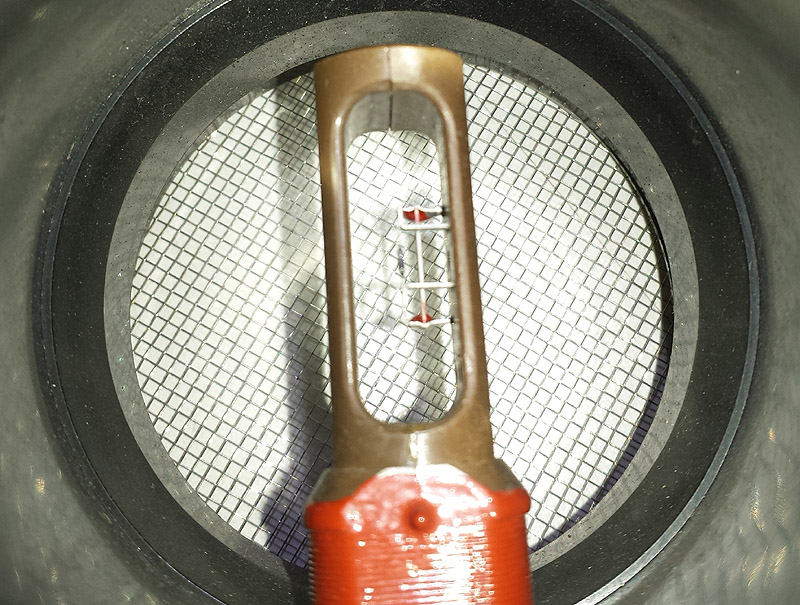

saga continues thus the plethera of suby pics. even with new fue3l filter, car still acted up. so i did a seafoam thru idle air control valve proceedure which seems to have helped some too. but then i discovered that my car was throwing a code 23, which is manifold air flow valve, so i ordered one from ebay, threw it in and car ran FAR WORSE, so i reinstalled orig MAF. i tried a swap of my cam sensor, but no change. i will do a maf sensor cleaning next, and may install a fuel pressure guage to be certain i have the expected 36 psi. lastly, the tranny is doing the suby binding thing again. hate simultaneous issues : (

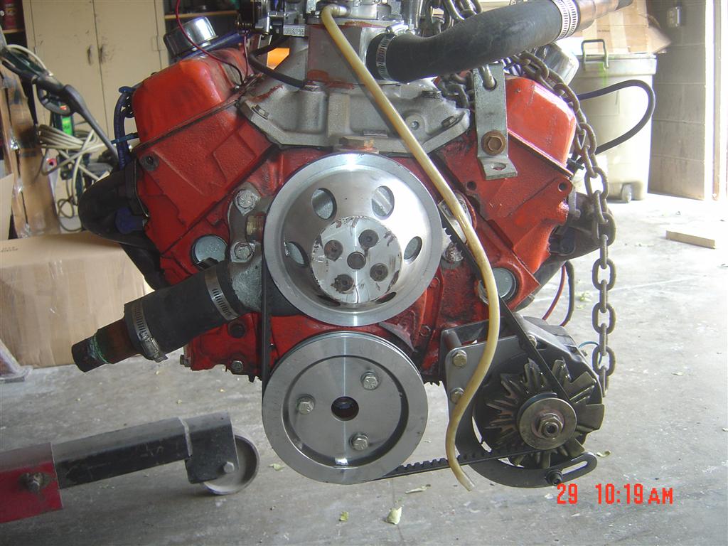

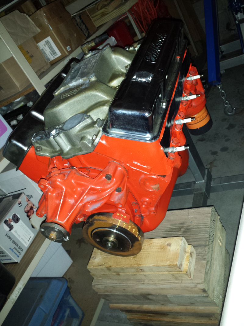

my 1967 283 arrives. seller tore it down and basically rebuilt and ran it. gonna replace my 307.
still need to pull my oil covered 307 out and then swap all needed parts over, trans, renegade trans conversion parts, carbs, etc etc etc.

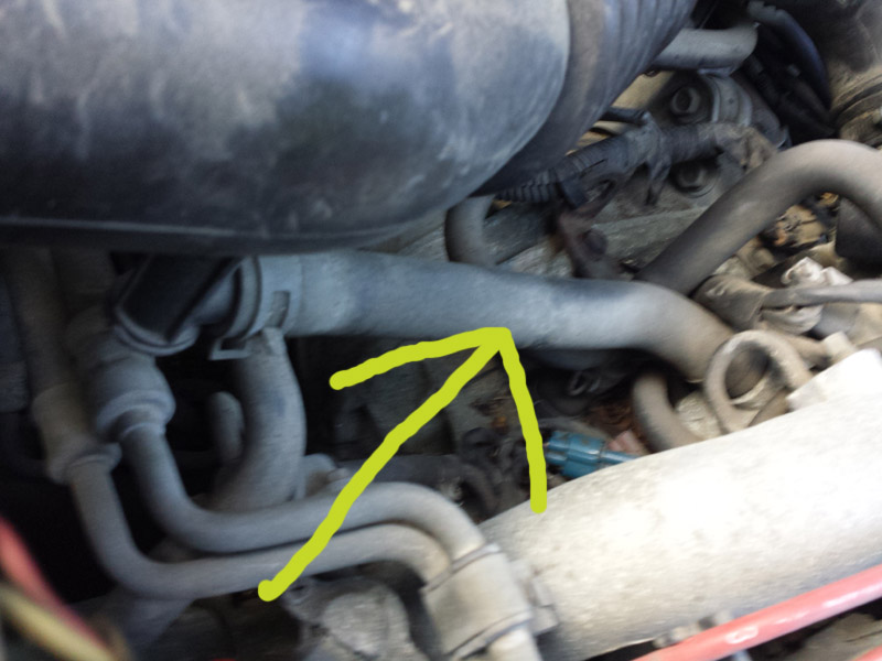

and update on my 1990 Subaru, my SUPPOSED daily driver till me 914 gets back on the road. started stumbling again, so I have iacv out and will clean it and the maf. hoses so hard that they cracked, and I cracked a tee as well (IMG:style_emoticons/default/dry.gif)

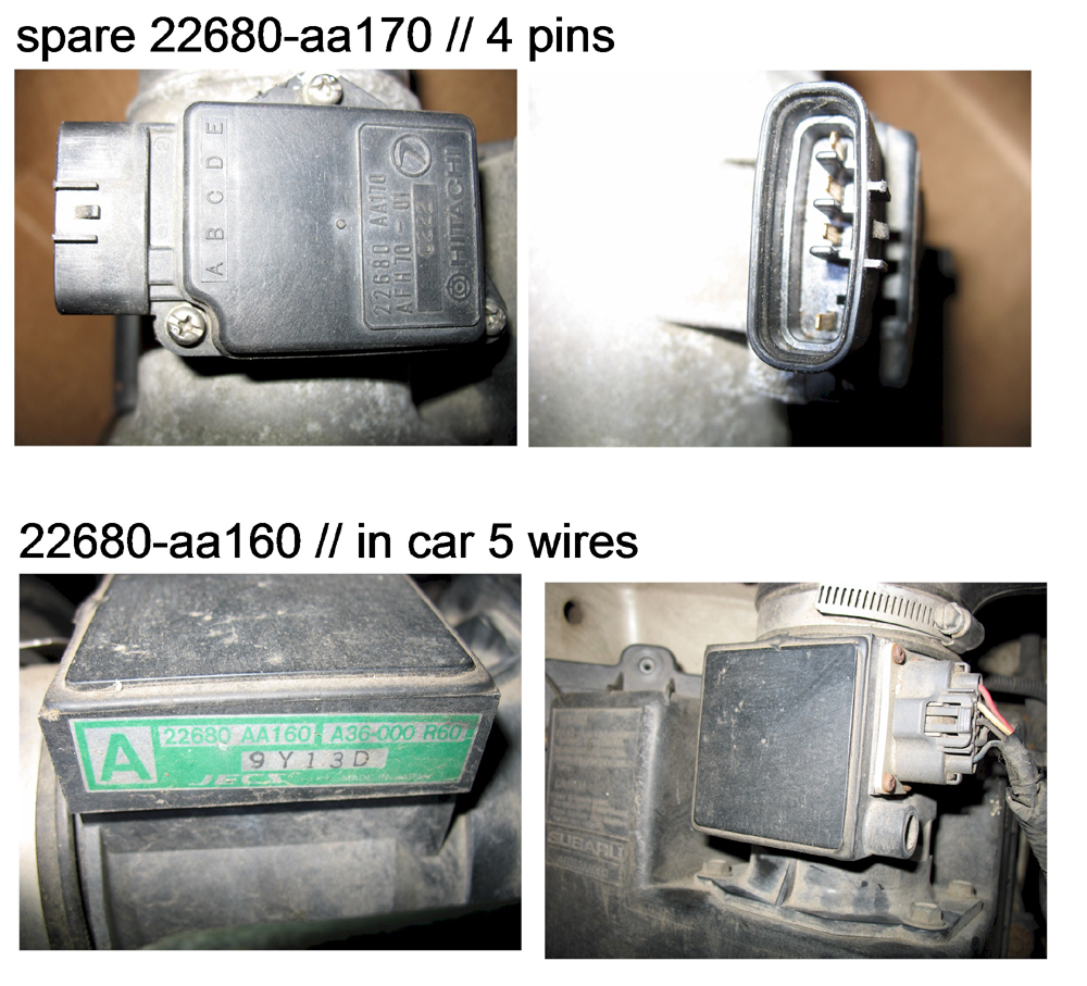

I do have the factory manuals but until last week I thought my suby was missing one of its two green diagnostic plugs. turns out someone removed the tcu in the past, I could tell cause one of the two nuts holding it in place was missing, when I removed it, I discovered that the other green diagnostic plug had been pushed up and buried where it could not been seen normally. so I will do the green plug testing one I have the iacv back in. got to replace a bunch of heat brittled hoses to do this. thanks : )

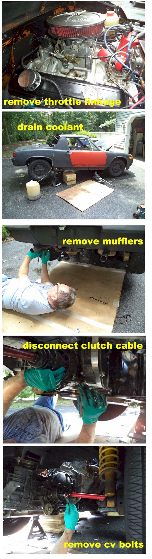

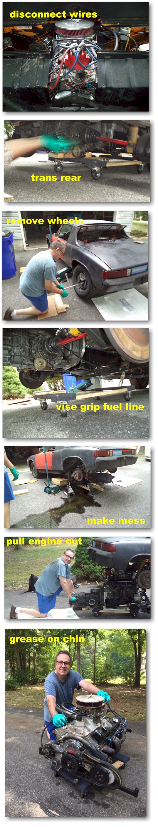

finally getting around to removing oily v8.
might convert both my cars to suby engine/trans?
starting with this one cause it already has a radiator in it?

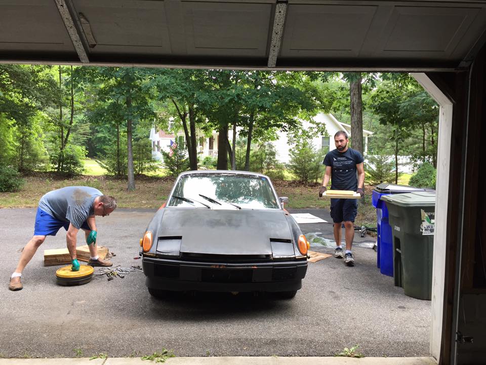

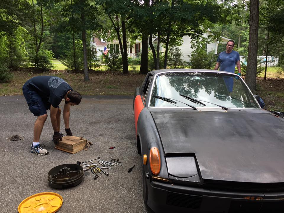

my son being home for the summer helped me out. the two of us being about equally unmechanically inclined worked pretty hard in tandem getting the mufflers off using wrenches and big pipe (IMG:style_emoticons/default/smile.gif)
if my wife didn't have somewhere to be, we would have had engine out in about one more hour. will do tomorrow.

engine out.

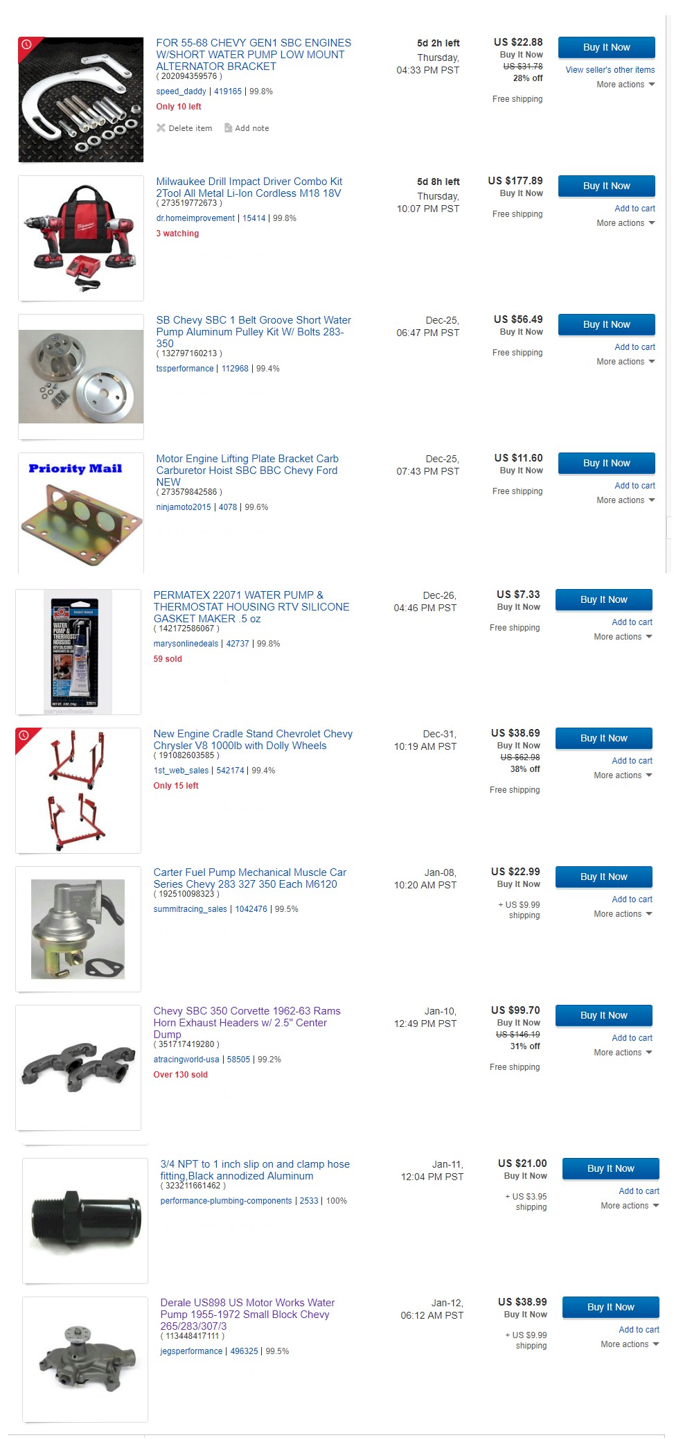

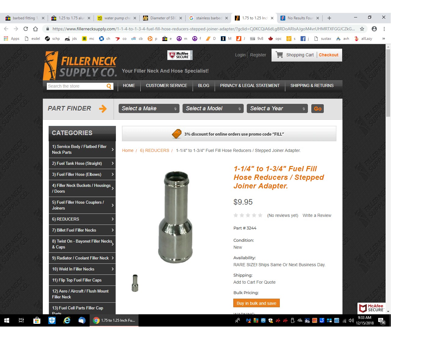

heads >> http://www.competitionproducts.com/World-P...A/#.XB7j71xKjcs

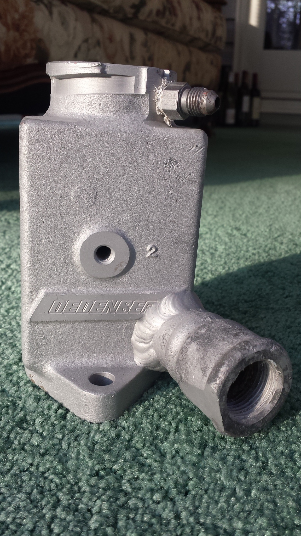

decided to lose some of the renegade stuff, and not do dedenbear components after all, to minimize cost and the number of components and hose connections on the front of my engine. going back to heavy stock water pump as i had it before, since i already have a hole in my firewall. gonna go with mechanical fuel pump too, to limit how many things that need 12v also. and plan to get rid of the headers which makes access to spark plugs less pleasant, and replace with iron exhaust manifolds. mostly i want reliability and i plan to make exhaust real quiet.
nice little rams horns discussion.
https://www.jalopyjournal.com/forum/threads...huggers.825134/
i'm willing to give up some performance for simplicity.
i did pick up cheap, a modified dedenbear expansion tank which i hope to be able to use.
http://www.dedenbear.com/Cool_cat.htm
https://www.fillernecksupply.com/search.php...section=product
