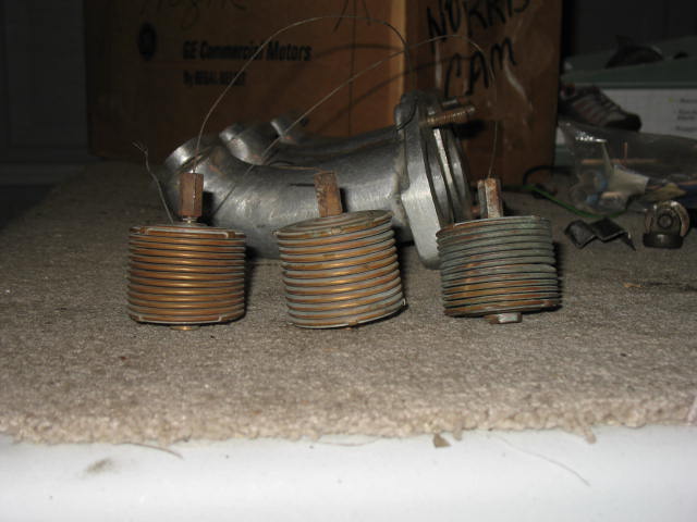

so what do i have 3 (apparently) bad or 3 (apparently) good?

One on right in pic may be OK. Not perfect, but I have seen worse that still work the air vanes correctly.
The middle one is definitely shot.
John

Oops!
I mean the left one. No coffee yet!
John
QUOTE(avidfanjpl @ Oct 8 2011, 07:48 AM) *
John
