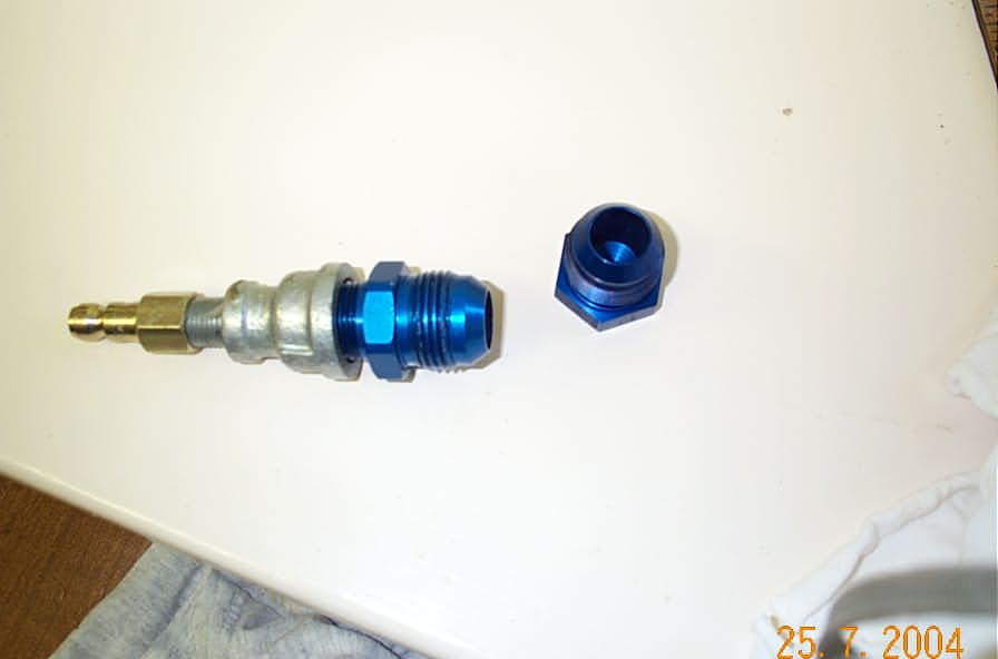

J P Stein
post Jul 25 2004, 05:46 PM
Irrelevant old fart
Posts: 8,797
From: Vancouver, WA
Member No.: 45
I use a die grinder (pneumatic) & cut off wheel. Wrap the line with tape and have at it.....but don't forget to clean the shittage out of it. If you can, pack the line with cloth of paper towels right where you're gonna cut & cut thru the whole works. Needlenose pliers will pull the stuff out.....clean anyhow....no matter how you cut it. I've done lots of em and have a zillion pinpricks to proove it. (IMG:style_emoticons/default/biggrin.gif)
Then make up a test rig to pressure test em. I use 120 lbs of air and spray with a water/soap mix. Bubbles are bad. (IMG:style_emoticons/default/rolleyes.gif)

machina
post Jul 25 2004, 06:03 PM
Posts: 2,030
Joined: 21-June 03
From: Miami Beach, FL
Member No.: 848
QUOTE(J P Stein @ Jul 25 2004, 07:46 PM)
did you make a fitting to attach to your air compressor? How?
dr
J P Stein
post Jul 25 2004, 07:26 PM
Irrelevant old fart
Posts: 8,797
From: Vancouver, WA
Member No.: 45
Ayup.
Damned if I know (IMG:style_emoticons/default/biggrin.gif)
I'll dig it out and take a pic.

J P Stein
post Jul 25 2004, 07:38 PM
Irrelevant old fart
Posts: 8,797
From: Vancouver, WA
Member No.: 45
OK, this is for an AN (oops, a double an)12 line.
IIRC, you can get a 1/4 pipe to AN6 fitting and skip the reducer. This one is 1/4 pipe to 1/2 pipe, AN12 to 1/2 pipe, and a AN 12 plug.
