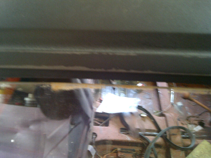

This is exactly the issue that I was dealing with last weekend. I was told that it was a non-matching year targa top. I had one late top, replaced it and I have the same issue. I noticed that the seal was somehow leaning towards the interior of the car<, if I have someone sit inside with the door close and push it out it looks ok. I had the same idea of raise the seal holder with something, I have not figured that out yet. here is a pic

If it is leaning towards the interior, the seals are on the wrong side. Swap them. It doesn't look like they will still match, but you should then be able to adjust the window up some more using the adjustment screw in the door.

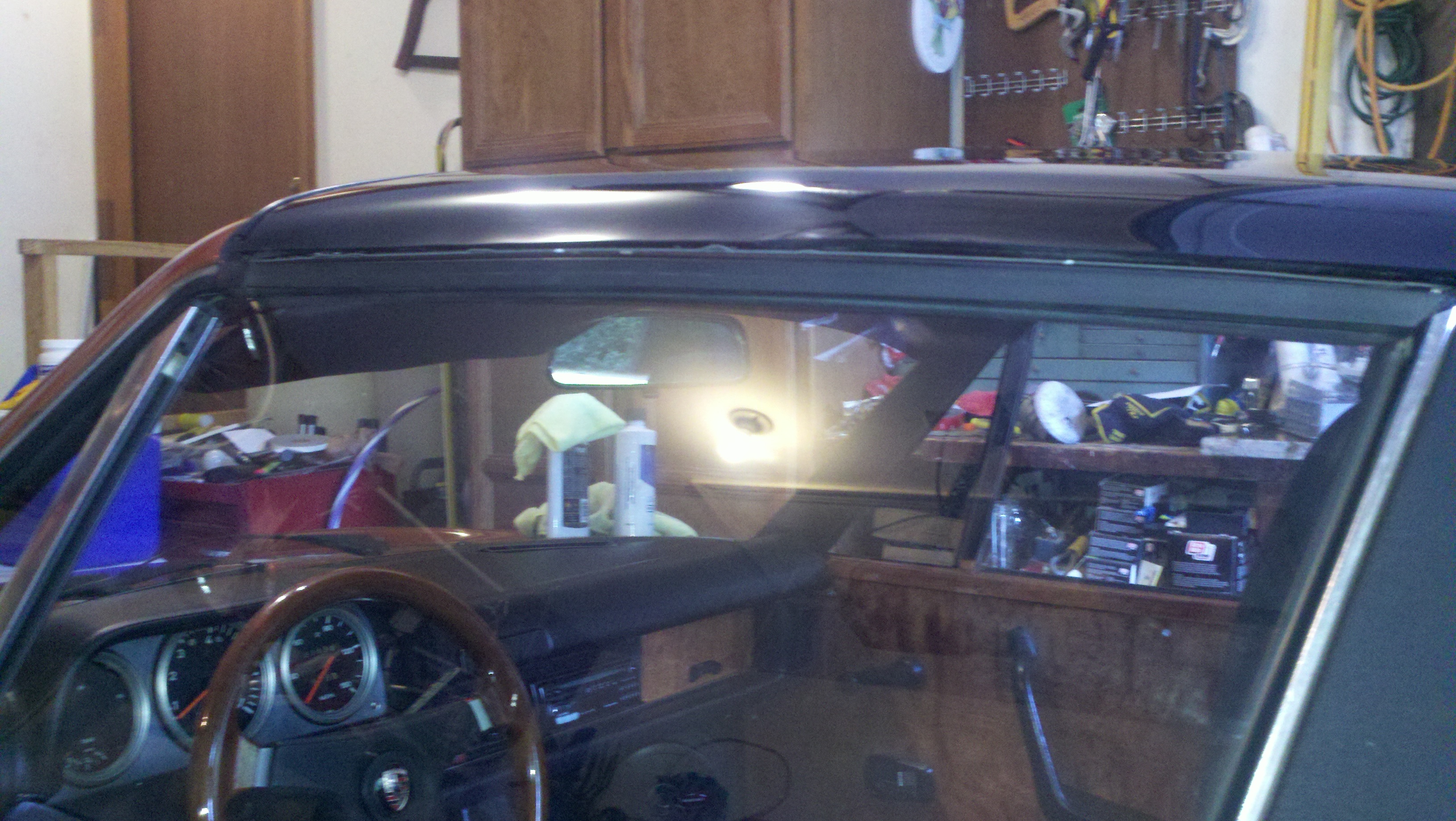

I had s similar issue while putting my new seals on the new WAS top. Check the tracks... they are curved, and if you have them on the wrong side they will not fit right. I also used 3M double stick tape rather than screw them in. And put the tracks out just a little bit so on my 75jack car I now have a perfect fit. I'm going to do the same with my other tops, which have issues, as they are earlier tops so fit has not been good on those. Also these seals are much better with the flap, a little softer too making a better seal. I took a drive last night and no wind noise! Thanks 914rnubber.

Here is a picture of my was top seal drivers side.
