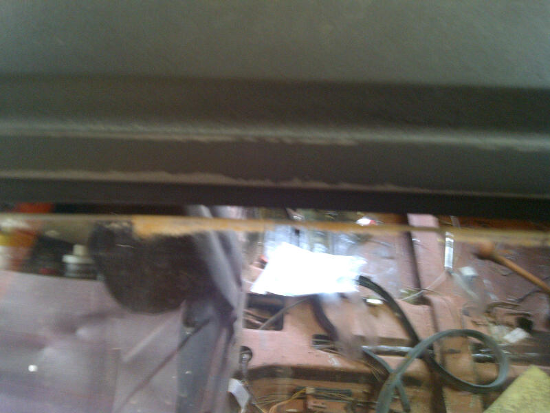

This is exactly the issue that I was dealing with last weekend. I was told that it was a non-matching year targa top. I had one late top, replaced it and I have the same issue. I noticed that the seal was somehow leaning towards the interior of the car<, if I have someone sit inside with the door close and push it out it looks ok. I had the same idea of raise the seal holder with something, I have not figured that out yet. here is a pic
ellisor3
If it is leaning towards the interior, the seals are on the wrong side. Swap them. It doesn't look like they will still match, but you should then be able to adjust the window up some more using the adjustment screw in the door.

Here is a picture of my was top seal drivers side.
