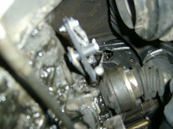

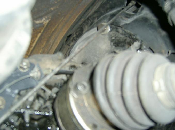

Bummer, I didn't bring the left side heater tube picture with me. (IMG:http://www.914world.com/bbs2/html/emoticons/wacko.gif) Oh well, here is a couple of shots of the bell crank throttle linkage installed, the hole in the rear tin etc...

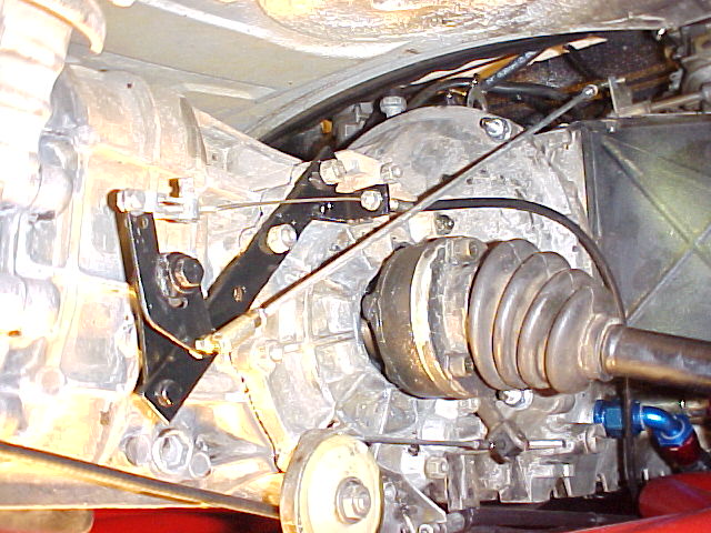

Last one I brought with me today.

Here's my Root Bell Crank install...
Thanks Dan! (IMG:http://www.914world.com/bbs2/html/emoticons/clap.gif)

(IMG:http://www.914world.com/bbs2/html/emoticons/smilie_pokal.gif) Sweet! can't wait to see more pics of the install!
Yep, trekkor has my prototype bell crank. I just got lucky with the angles and dimensions. They work really good, very smooth and linear in travel. I have sold like 15 now. Easy install/adjustment. (IMG:http://www.914world.com/bbs2/html/emoticons/biggrin.gif)

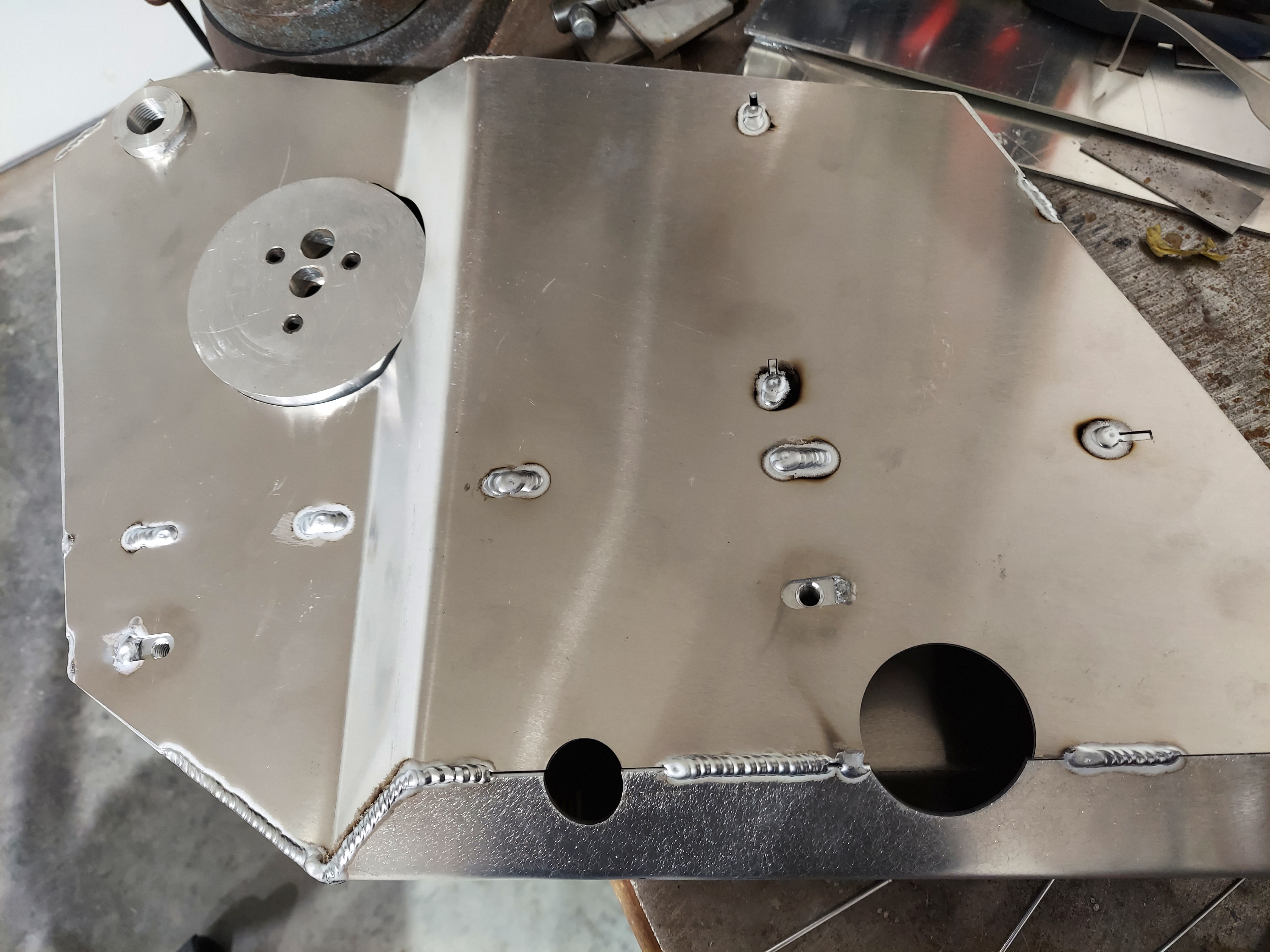

Here is a tank I was working on last night.. I make almost everything needed for a conversion. Attached Image

914-6 aftermarket tanks have come a long way. I would use Ben's tank.
Very nice looking work. I am seeing a 2.7 fitting into our 914 rustout as a more and more viable option in place of building a 4 cyl. My trigger finger is almost ready to strike. How long will you be holding the "spring special" pricing for the RD metal and tank combo?

I only have 6 sets left of sheet metal and not sure the cost on my next batch will be..
