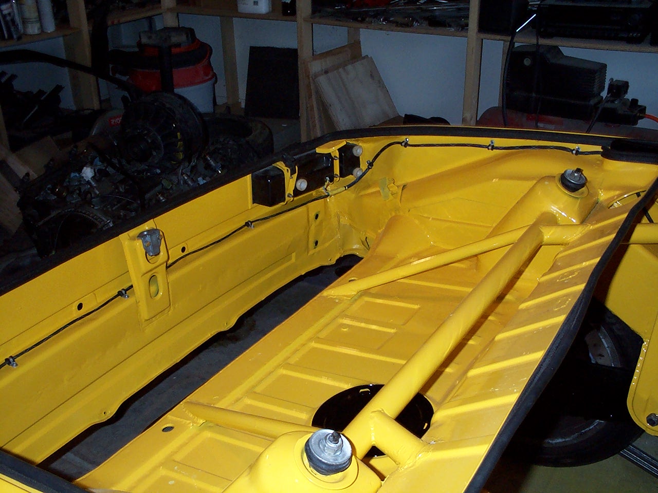

Didn't get to work on the 914 as much as I hoped over my vacation, but still made some good progress over the last couple of days...
Frame rails in the engine comp. are stripped naked
They still need some minor detailing here and there and the "hell holes" still need to be cleaned, but most of the hard work is done
Tonight I welded the rear shock towers to the frame rails
Quite a gap to fill...
