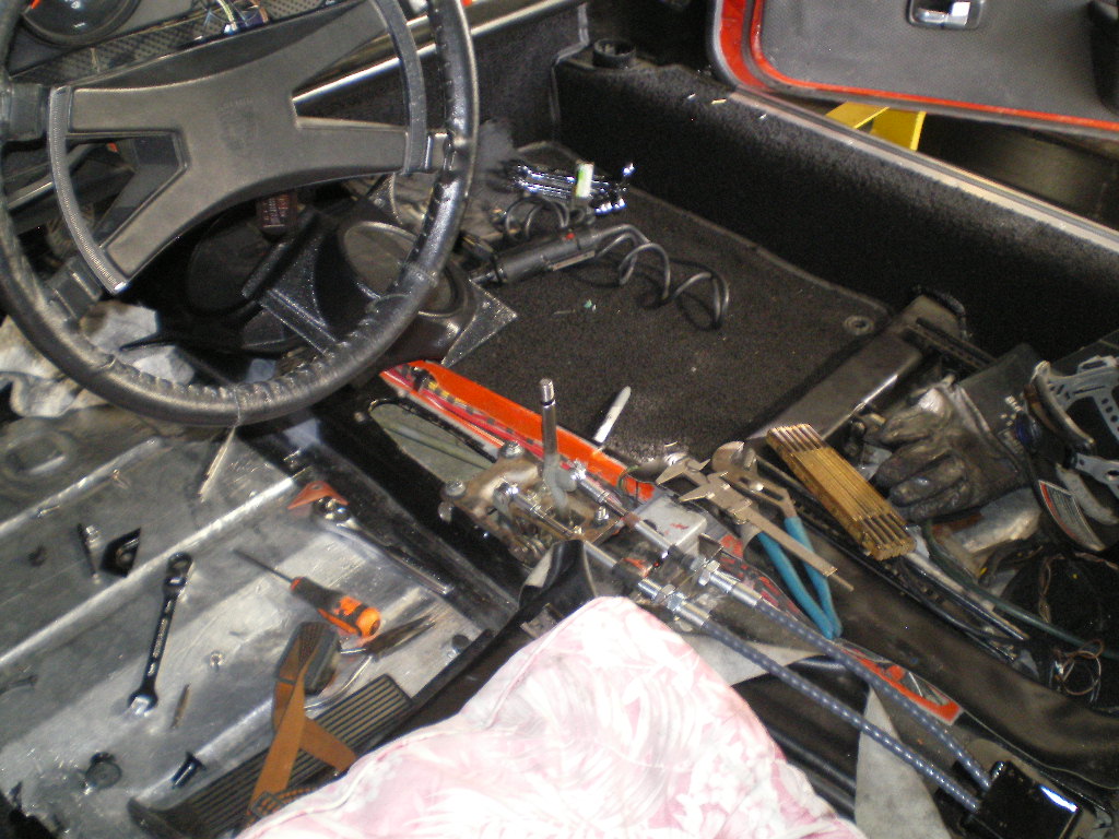

I finally figured out how to connect my lap top to my AEM ecu after several calls to AEM. Then I went to my buddies shop and saw this that took my breath away.Attached Image

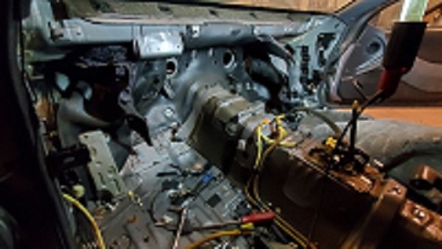

mgp4591
post Nov 19 2020, 09:30 PM
Post #13725
Posts: 6,031
Joined: 1-August 12
From: Salt Lake City Ut
Member No.: 14,748

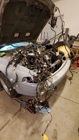

Not specifically TO my 914 but absolutely FOR my 914....donor cars are so much fun... (IMG:style_emoticons/default/dry.gif) But in the end, mission accomplished. (IMG:style_emoticons/default/biggrin.gif)

QUOTE(mgp4591 @ Nov 19 2020, 07:30 PM) *
Attached ImageAttached ImageAttached Image
wiring harness?

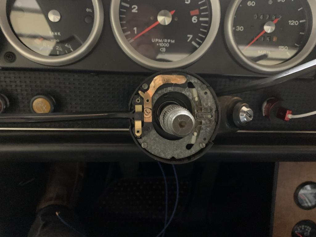

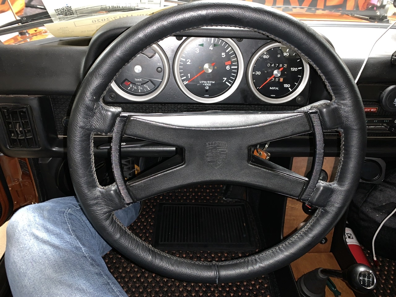

pulled my steering wheel to replace it with a newly recovered one AND
2. install the new signal switch from @914sixer , AND
3. while in there, retrofit the new washer pump switch from carmagic AND
then i can hook up the new NOS 911 washer pump from @914sixer too!!! so far the swith and lever and new wheel is in place- selling the old wheel check out the F/S ad in classifieds----
Attached Image Attached Image Attached Image Attached Image Attached Image Attached Image

QUOTE(Cairo94507 @ Nov 20 2020, 09:39 AM) *
@Cairo94507
thanks! interesting difference between the new lever and original one , on the back side the copper contact goes only 1/4 of the way not 1/2 way around. seems to work fine, though, now i need to figure out wiring of the new switch and pump. no more leaking water line . and will actually have wipers. I should have done this when everything was out for body and paint but i didnt have much time putting back together in less than 2 months to get to Okteenerfest in time. better late than never. now where to mount the pump??
Cairo94507
post Nov 20 2020, 02:55 PM
Post #13730
Michael
Posts: 10,767
Joined: 1-November 08
From: Auburn, CA
Member No.: 9,712
Hi Drphil914- Is it possible to mount it sort of behind the bottle like they did on the Sixes?

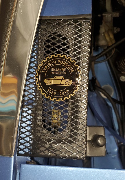

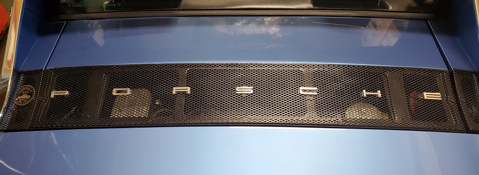

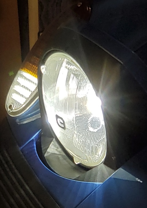

Big chore for the evening was to replace the old headlight switch for a replacement.
Now the old Cibies light up when I pull the switch, instead of hoping they do and then wiggle the switch until they do. Thanks Bruce
@bdstone914
and add a medallion
And then I decided to replace the manufacturer's label.
Cairo94507
post Nov 21 2020, 06:26 AM
Post #13733
Michael
Posts: 10,767
From: Auburn, CA
Member No.: 9,712
Your engine grill looks very nice. (IMG:style_emoticons/default/beerchug.gif)

QUOTE(76-914 @ Nov 19 2020, 10:32 PM) *
wiring harness?
Yes sir... with no cutting. Complete. Pain in the ass but necessary because my 914 has no wiring harness of its own.

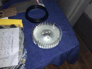

Just received our California car cover...
Also got the plating back and somehow got the fan mixed up... Silver CAD

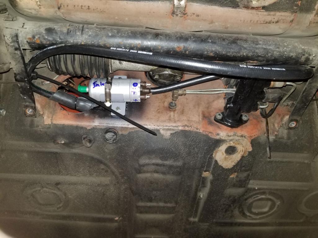

post Nov 22 2020, 11:04 AM
Post #13740
Posts: 451
Joined: 13-June 16
From: spokane wa
Member No.: 20,100
Made some progress on the SS fuel line and two port pump install. I need to get my tank treated and then put everything back together. The PO had a hack mechanic move the 3 port pump to the front at some point in the past and it was zip tied to the steering rack. I bought the pump mount from Chris and welded it. I suck at welding but it will work. During the previous install the hold was butchered a bit and I sort of fixed that as well. Liberal use of a dirt bike tube on the fuel lines will not win me a medal at any concours but hopefully will help keep things from moving around too much. Still working on how to best route the lines at the tank end to avoid a kink.
