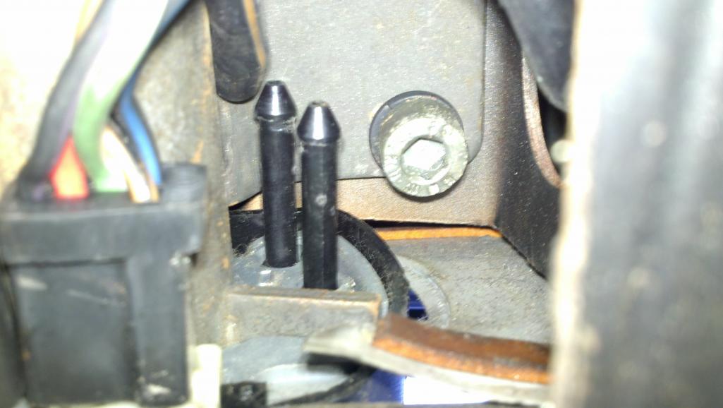

Maybe you can get to them without taking the steering column apart ....
(IMG:http://www.914world.com/bbs2/uploads_offsite/i239.photobucket.com-1696-1324666529.1.jpg)
(IMG:http://www.914world.com/bbs2/uploads_offsite/i239.photobucket.com-1696-1324666530.2.jpg)
(IMG:http://www.914world.com/bbs2/uploads_offsite/i239.photobucket.com-1696-1324666530.3.jpg)
Knock yerself out ............

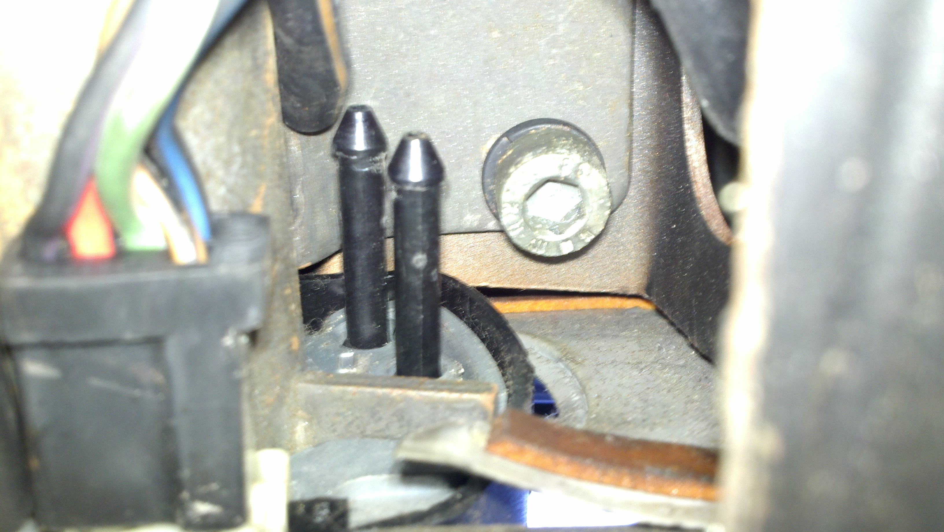

DRPHIL914
post Dec 30 2011, 10:13 PM
Dr. Phil
Posts: 5,971
Joined: 9-December 09
From: Kennesaw, GA
Member No.: 11,106
QUOTE(SLITS @ Dec 23 2011, 01:55 PM) *
Hwy slits, I got a better look at this today. , had my tank pulled and replaced the air box and got that working., the took a look at the back of the column from under the dash. I see the 2car plastic barbed connectors. One should be an in, the other an out, right? Which is which. I have no hose hooked to either. I k ow where the incoming hose os, it was squirting the floor. But I don't see the hose that should be going out to the squirter. Does anyone have a diagram of hog this all connects?
Phil.
