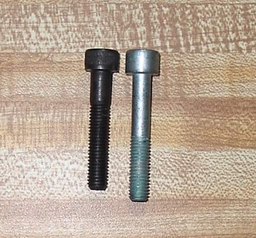

has anyone else found that the greenish CV bolts are soft???
I've had a few break while I was installing them and they snapped well under 20 lb's of torque (I tighten them using a torque wrench, I start off with a lower setting and work my way up to the proper setting)
I've never had a problem with the darker black colored CV bolts which I am guessing are factory spec and not just the generic VW bug replacment units?????
(picture "borrowed" from another thread (IMG:style_emoticons/default/smile.gif) )

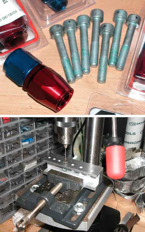

Got these from EBS, (engine builders supply)
Says they are factory part #893 407 237 as per the parts catalog.
They did seem kind of soft though.
Think I should use the old black ones after all this drilling?

Didnt someone recently post about flywheel bolts that he bought from mittlemotor, that turned out to be cheap 3rd worlds knock offs? Those greenish bolts look suspect to me... look at the pic posted above, the black oxide bolt looks well machined with nice tolerances, the other bolt looks cheap..
They can both be equaly as strong though, and 20 ft/lbs doesnt make alot of tension in a bolt..
TimT

the on on the left has nice radii where the shank on the bolt meets the head, and the root of the thread appears to be rolled no cut...

The bolt on the right looks like a cheesy knock off... cut threads, no radius from the shank to the head..
