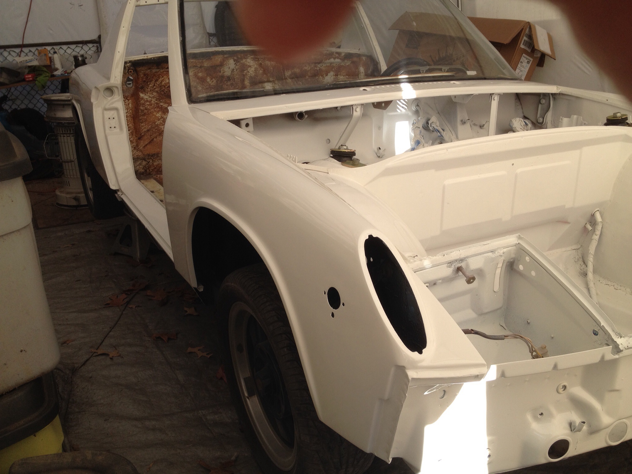

All painted Light Ivory!
fresh paint always looks so good, yours is no exception! cant wait to see what it looks like when its all back together

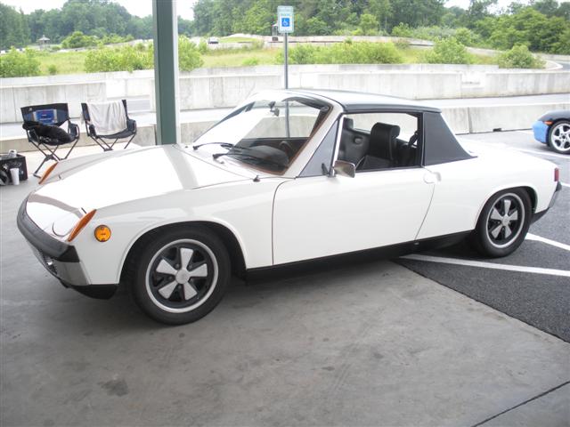

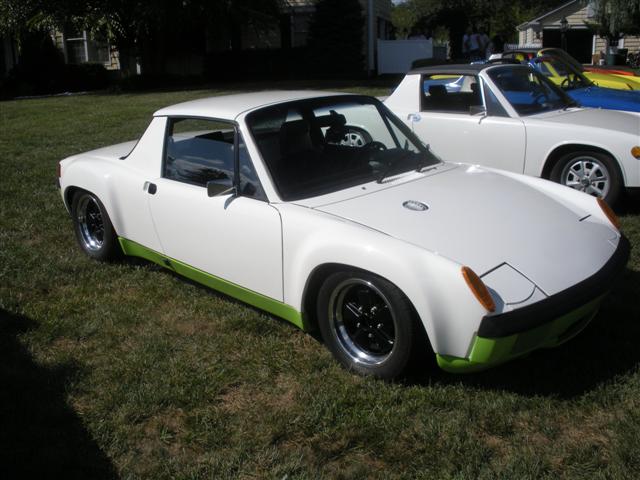

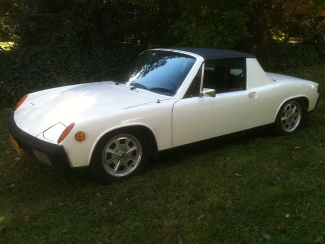

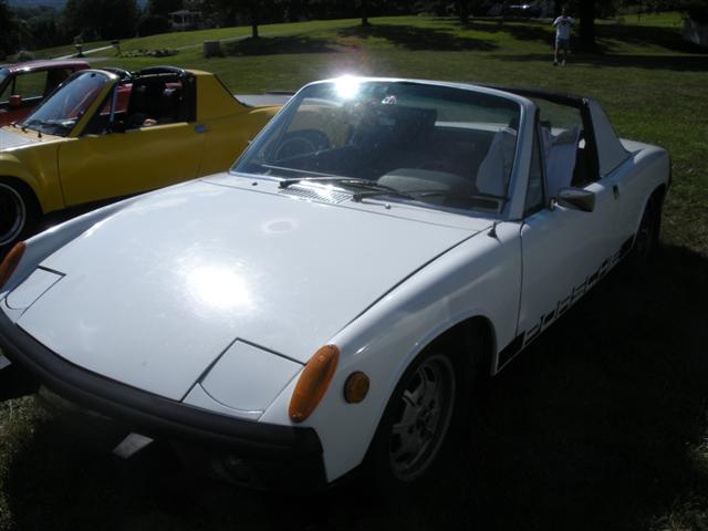

some light ivory cars

Got her back in the tent Christmas eve but I had to travel for the holidays.

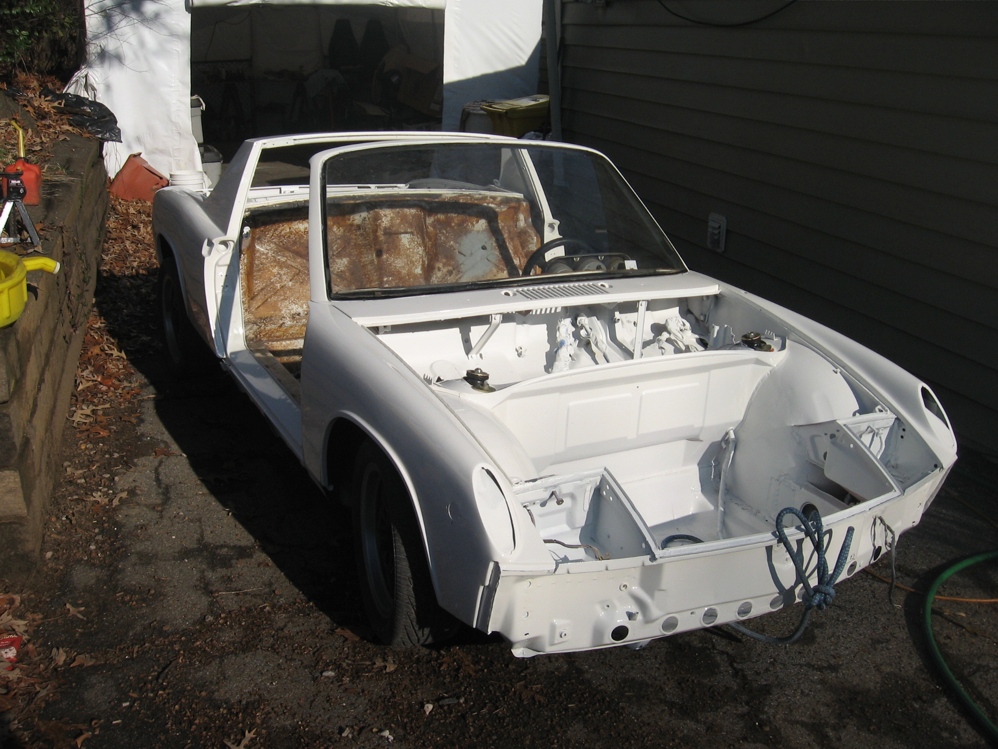

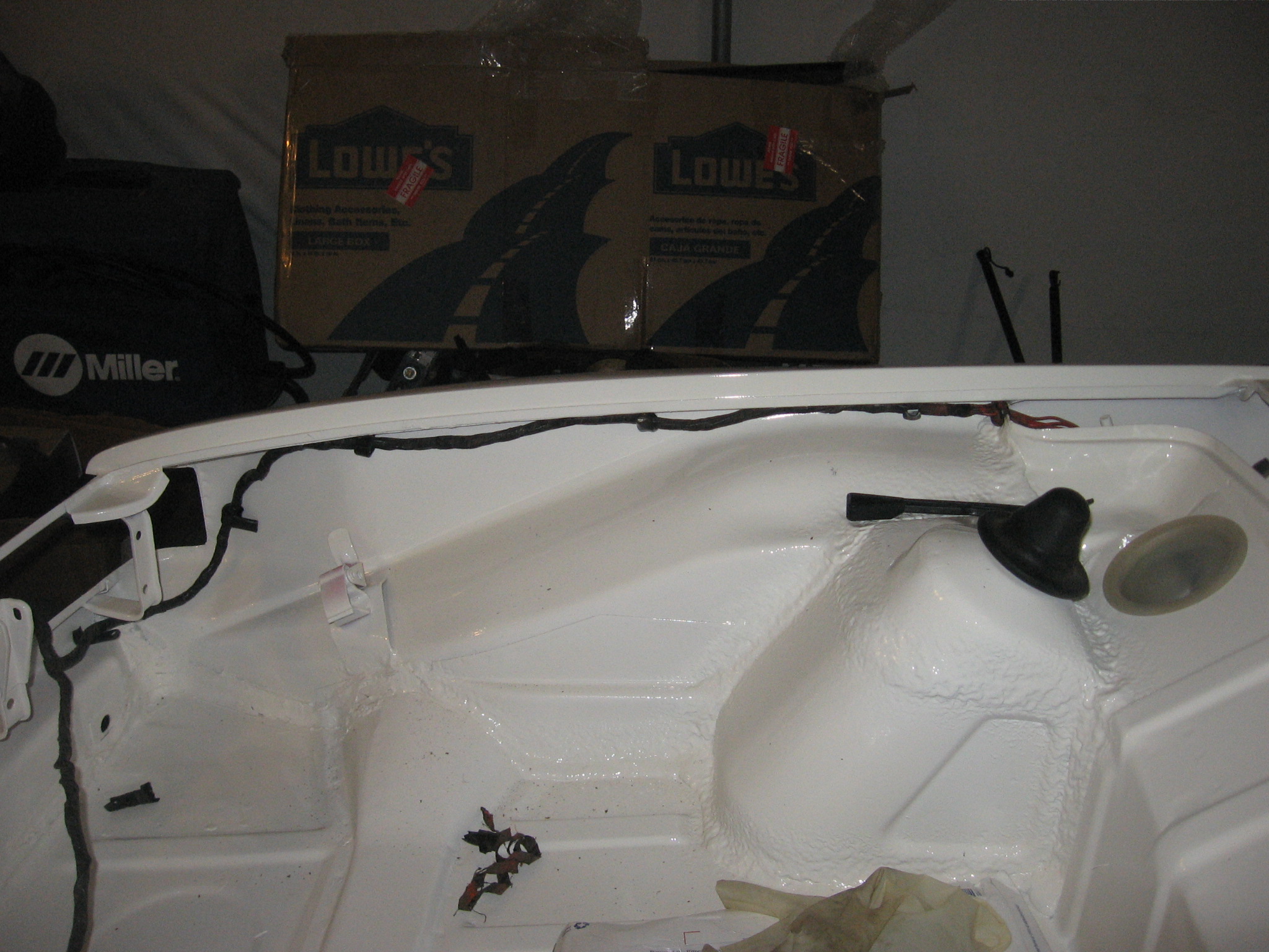

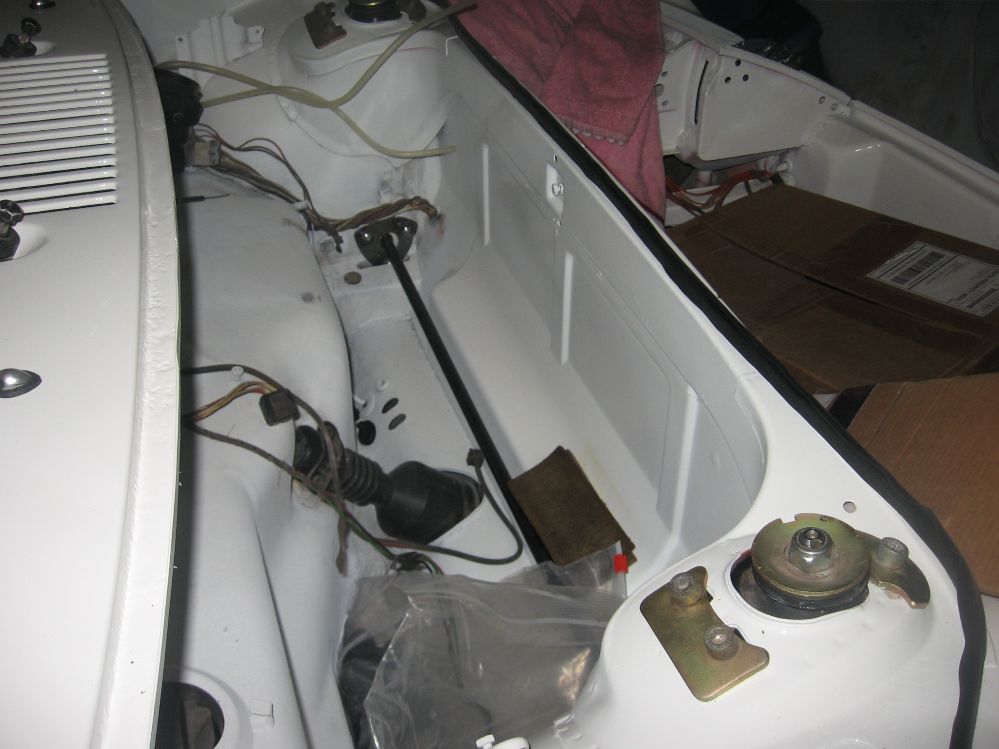

Spent Saturday pulling out parts and doing jobs I had materials for. It all seems daunting until I start one small task and just work through it one step at a time. A little extra time equates to better details.....

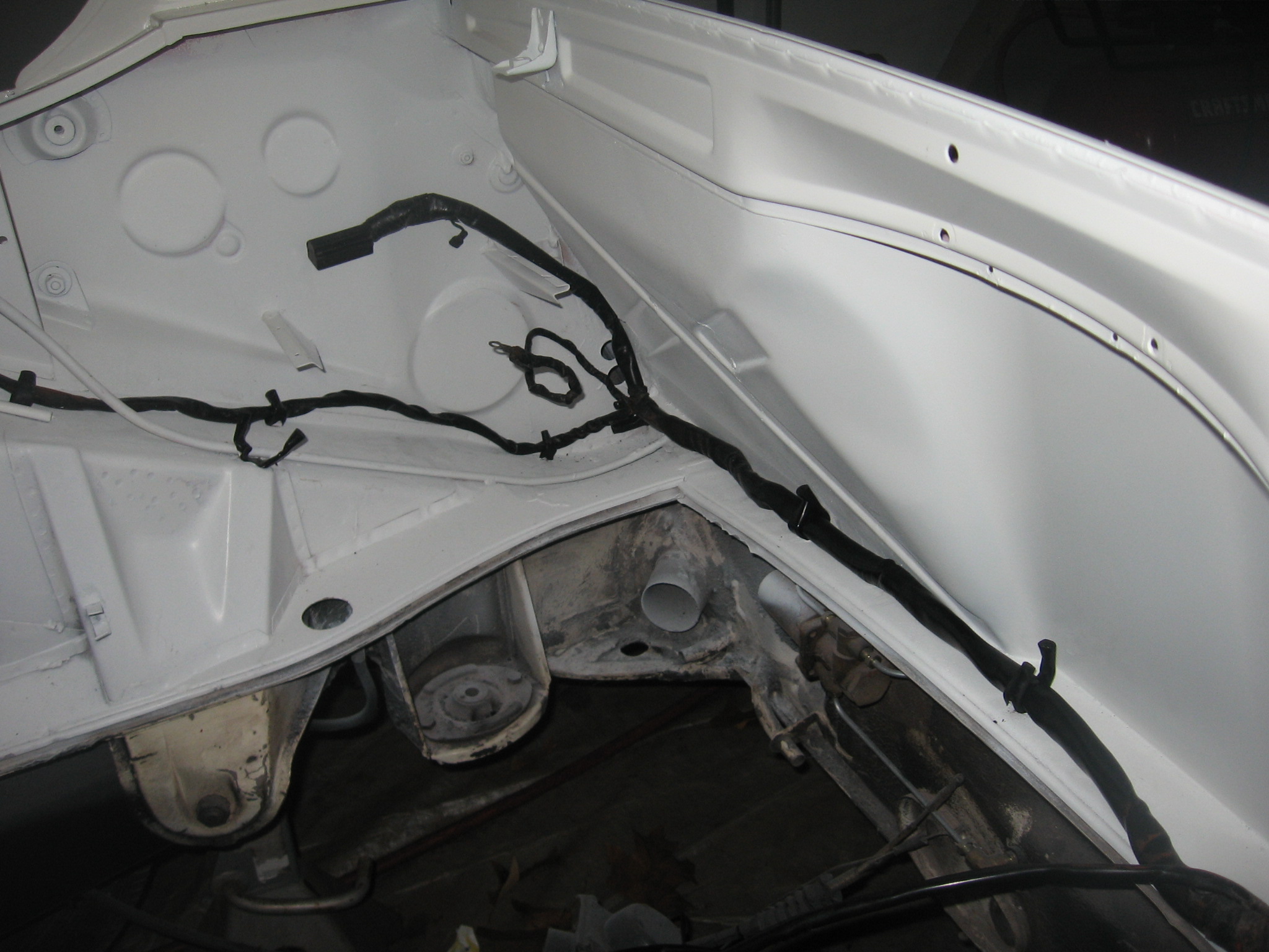

Engine bay wiring and hold down clips cleaned up and installed. I cleaned each one and coated it with protectant. I then heated them over my heater for a few minutes to make them pliable for install.
Sway bar restored and installed (mostly). I scored some restored suspension mounts from Bruce here too. Everything he sells is uber top notch!
Wiper assembly refreshed and installed. I read a post on different wiring on early vs late cars so I swapped my original and working motor out on the clean assembly I bought here. Wiper jets were in the stash of NOS bits my friend Eric Wills gave me.

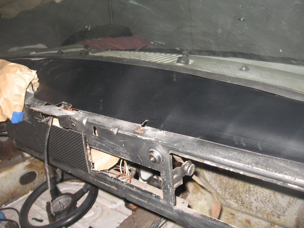

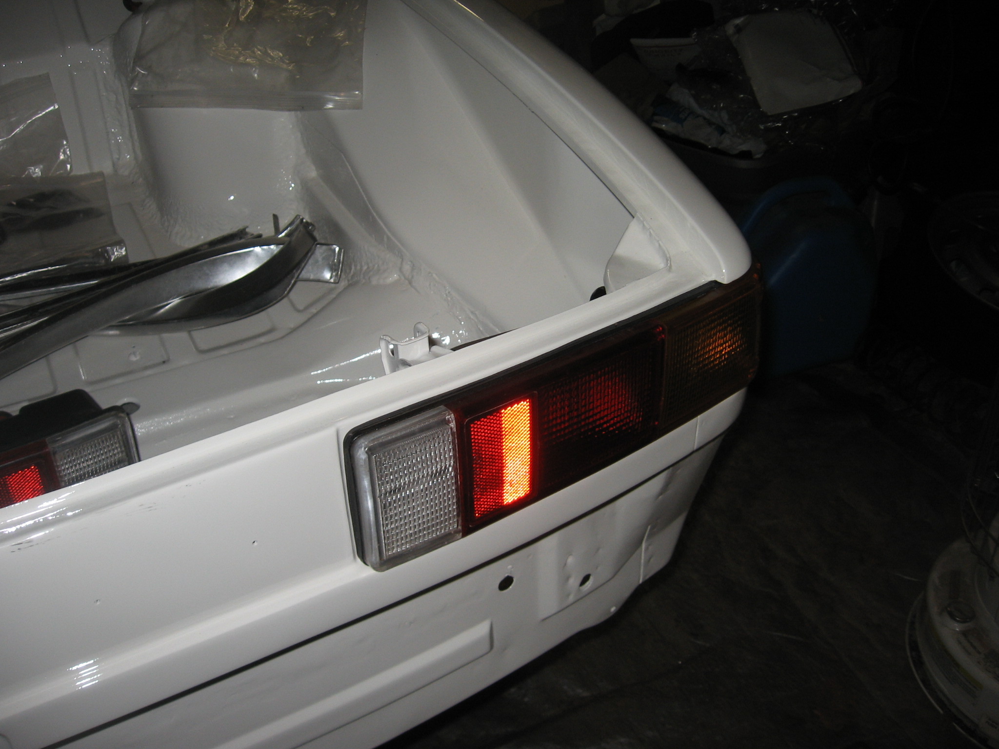

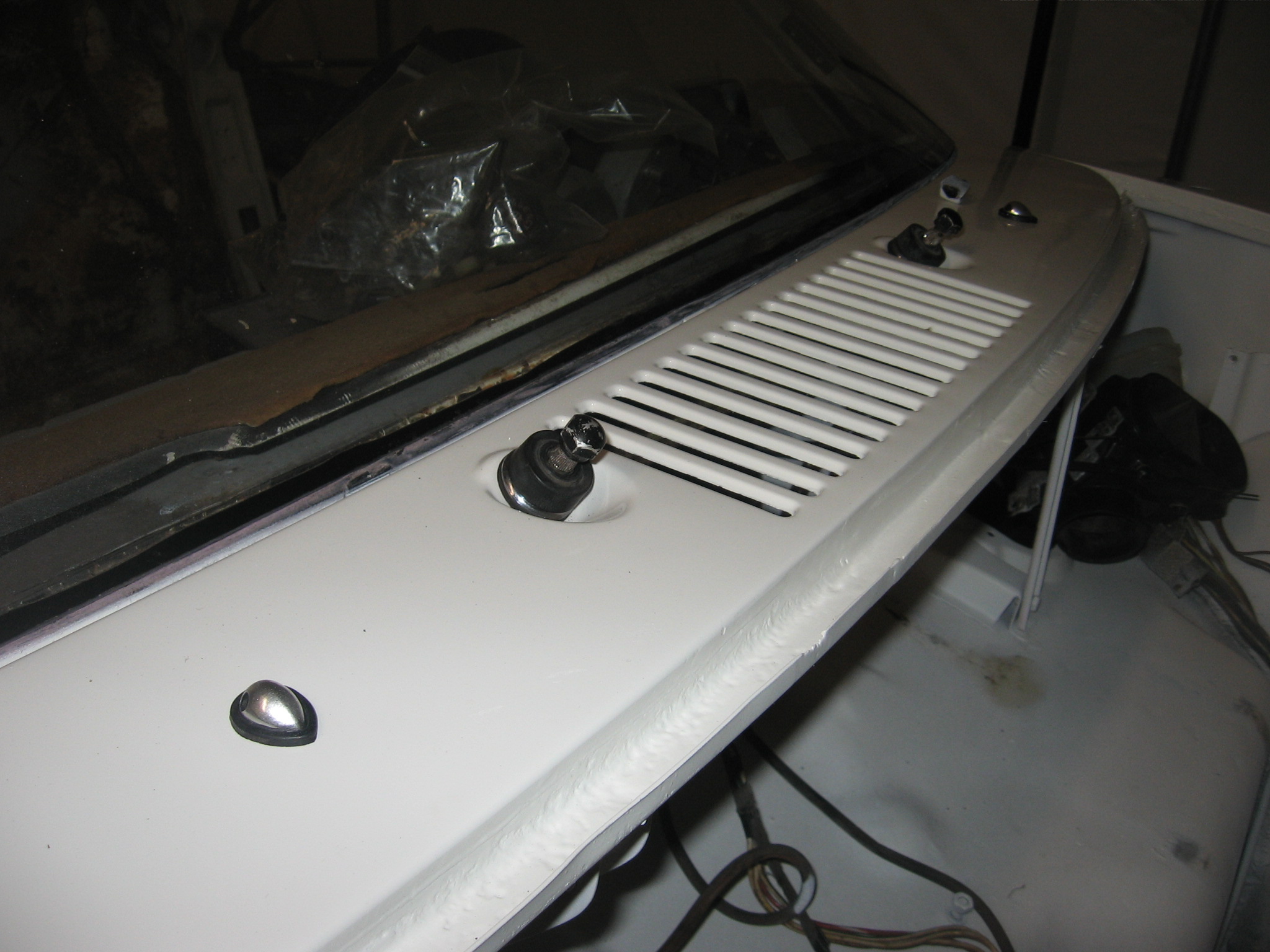

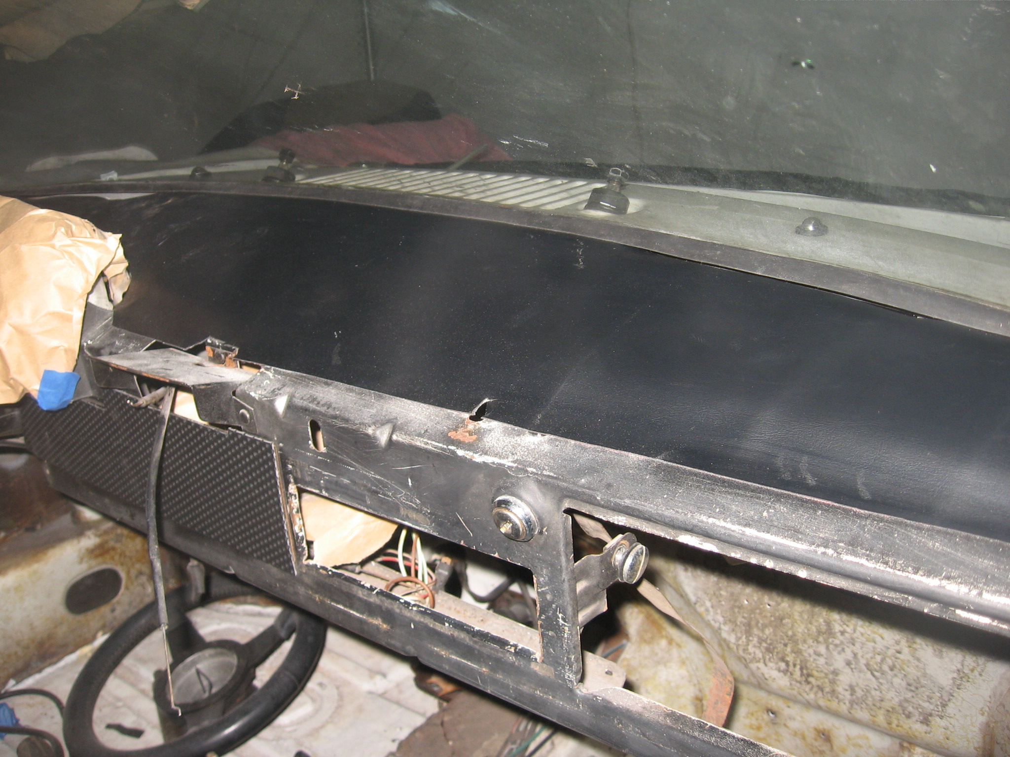

Installed my upper dash and secured the dash itself. a little heat should tighten up the vinyl. 914 Rubber dash to window seal went in easier than expected.
Rear trunk wiring going in. I have a few connections that I need to refresh. The PO had painted all this orange so I took the easy rout and just wrapped it back up after inspection
I had to mount one of my Euro tail lights to check it out. New seals fit well

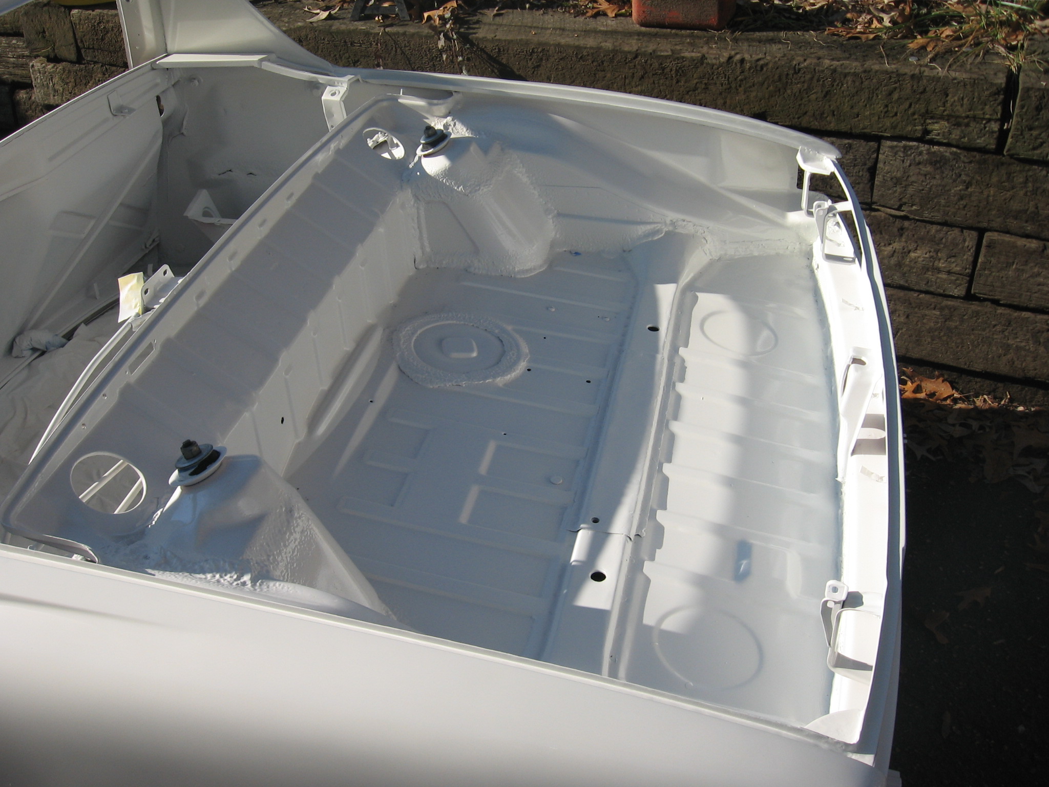

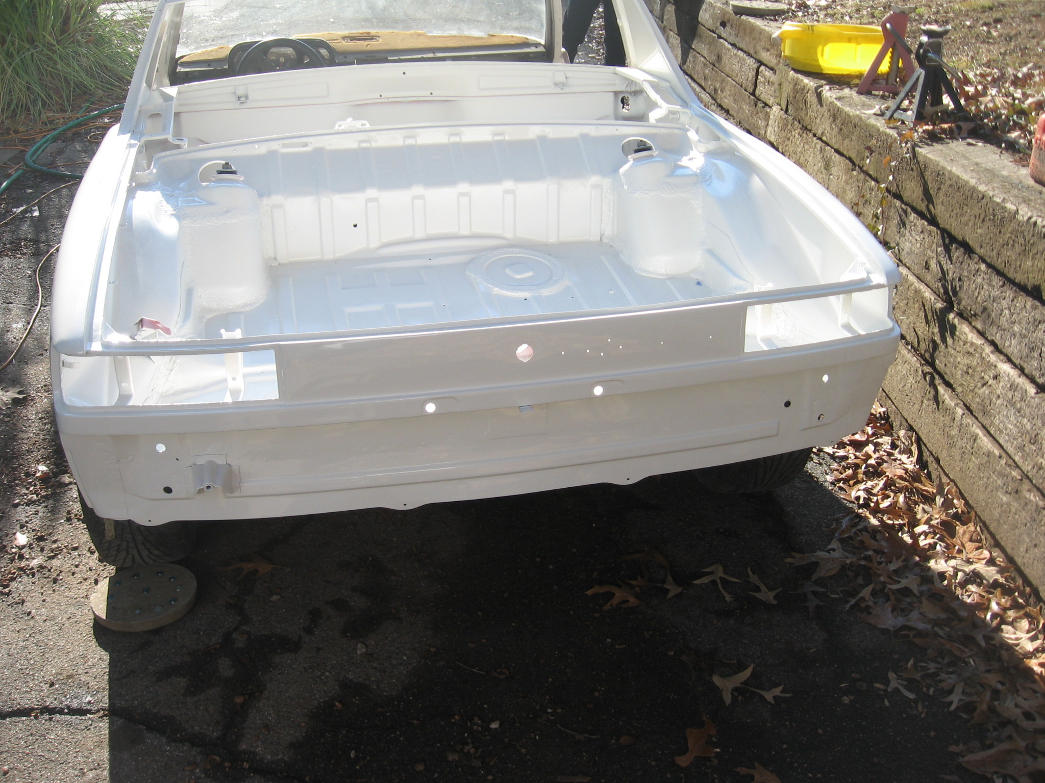

I'm pretty happy with my handy work on the rear trunk repair. It's not super perfect but it's pretty good for a first timer.
My work is nothing compared to Scotty B's. Scotty got busy with better paying projects so I had a local shop do the final paint. I think the body paint is a 9.5 but the details are lacking a bit. Trunks and engine bay could have been better but I'm happy.

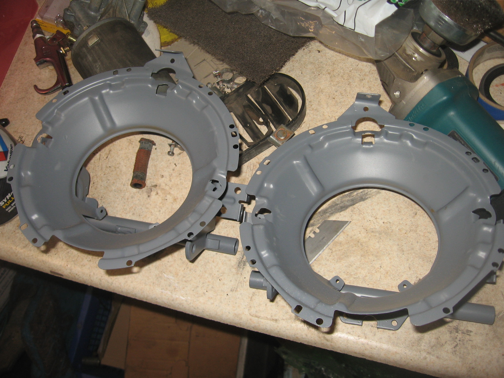

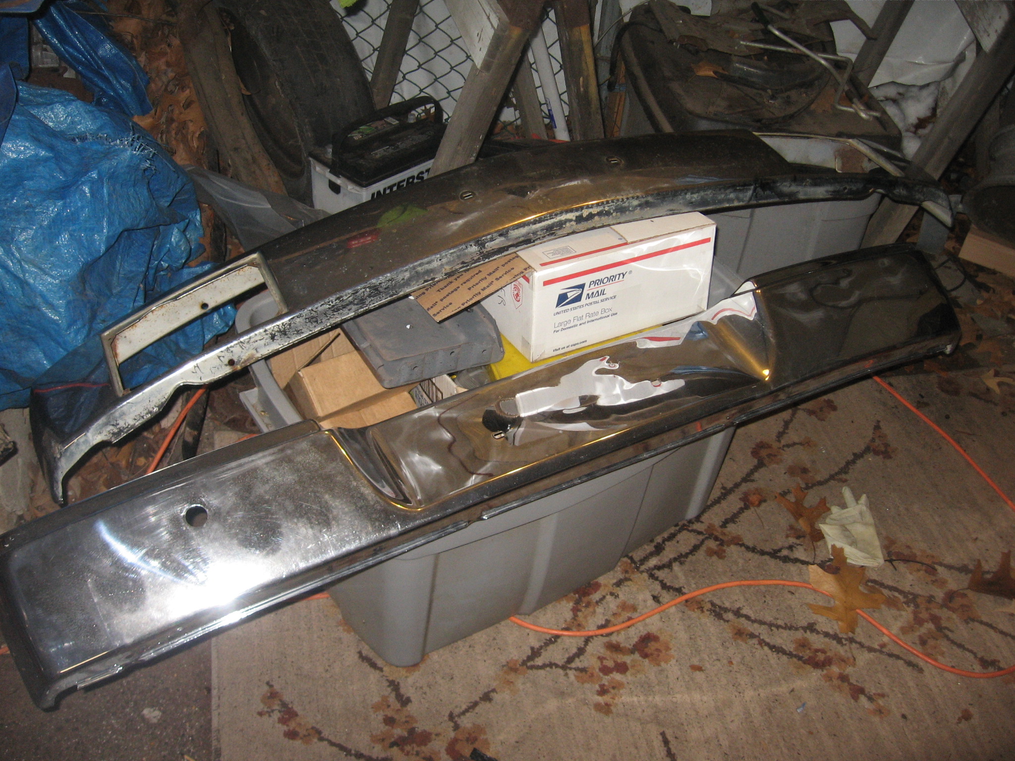

Finally unpacked the bumpers I bought three years ago. Rear is great but the front will need some polishing.

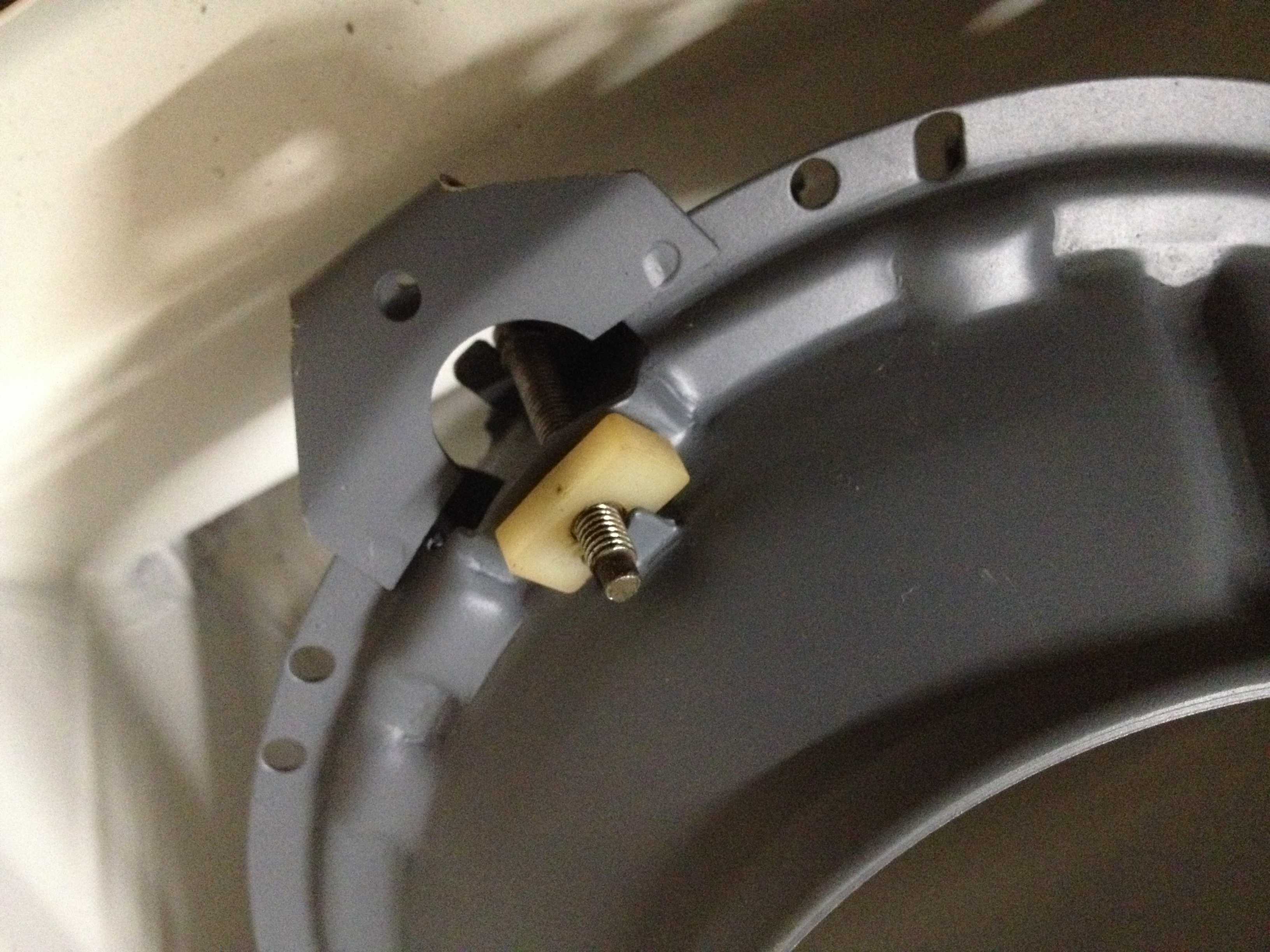

Shea restored headlight carriers. Like allot of stuff I've bought from Eric, the quality is beyond compare. But I need allot of fasteners (IMG:style_emoticons/default/biggrin.gif)

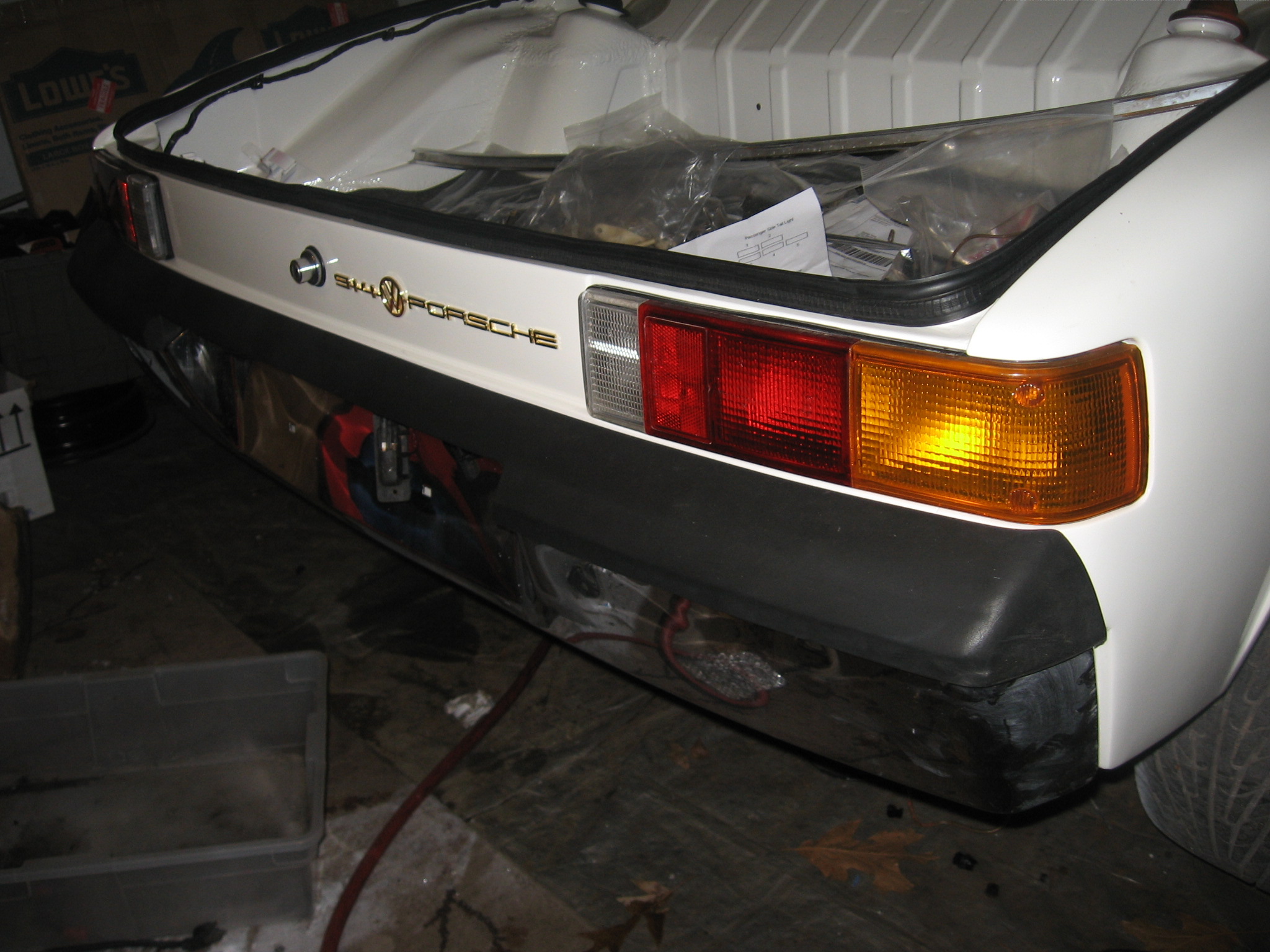

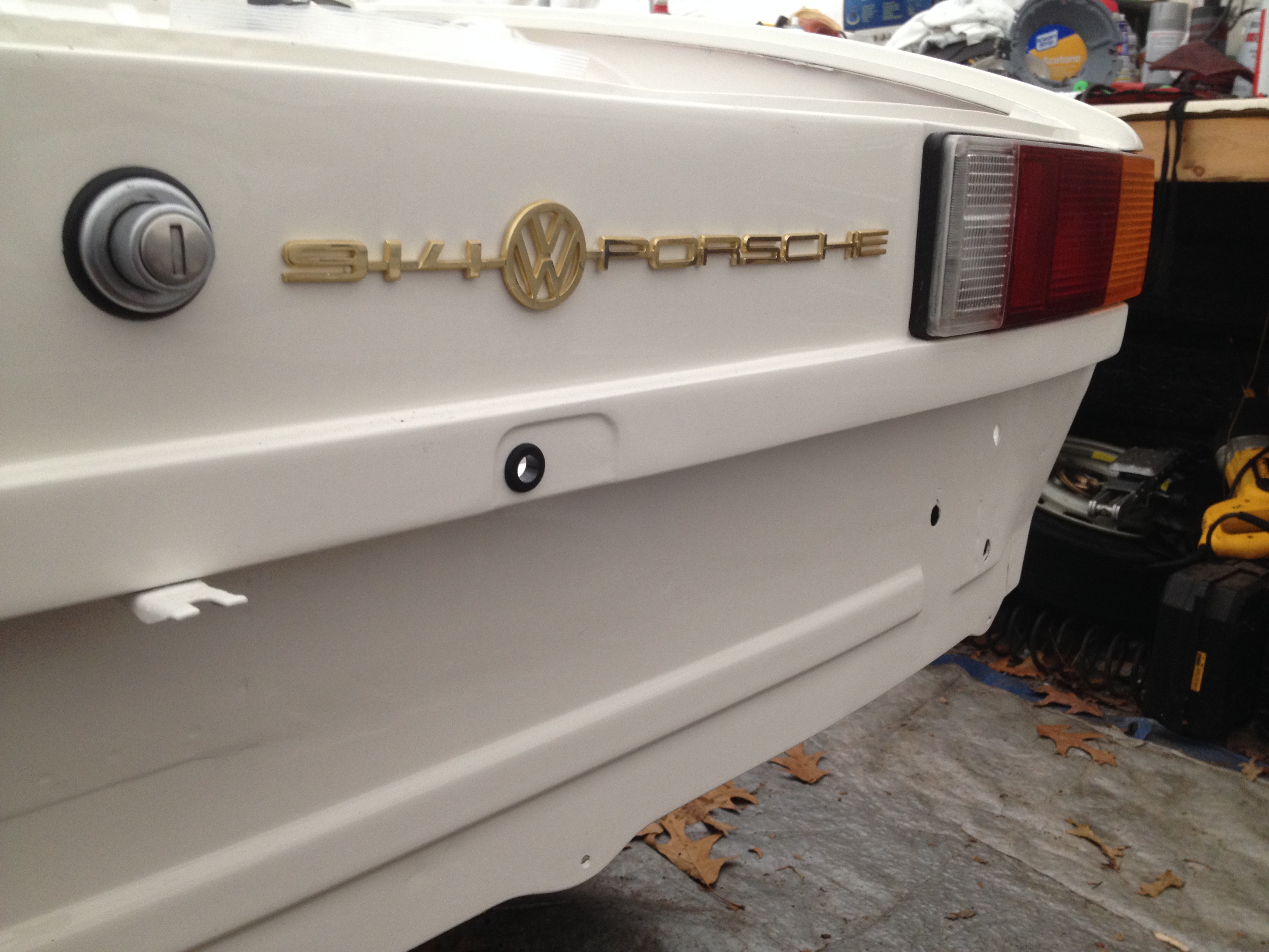

Good times in the g-rage. I sanded and polished my trim, washed allot of the original rubber so I could salvage the outer door seals and front hood seal. Installed rear trunk seals and stuck the logo on the back. It's straighter than it looks (IMG:style_emoticons/default/dry.gif)

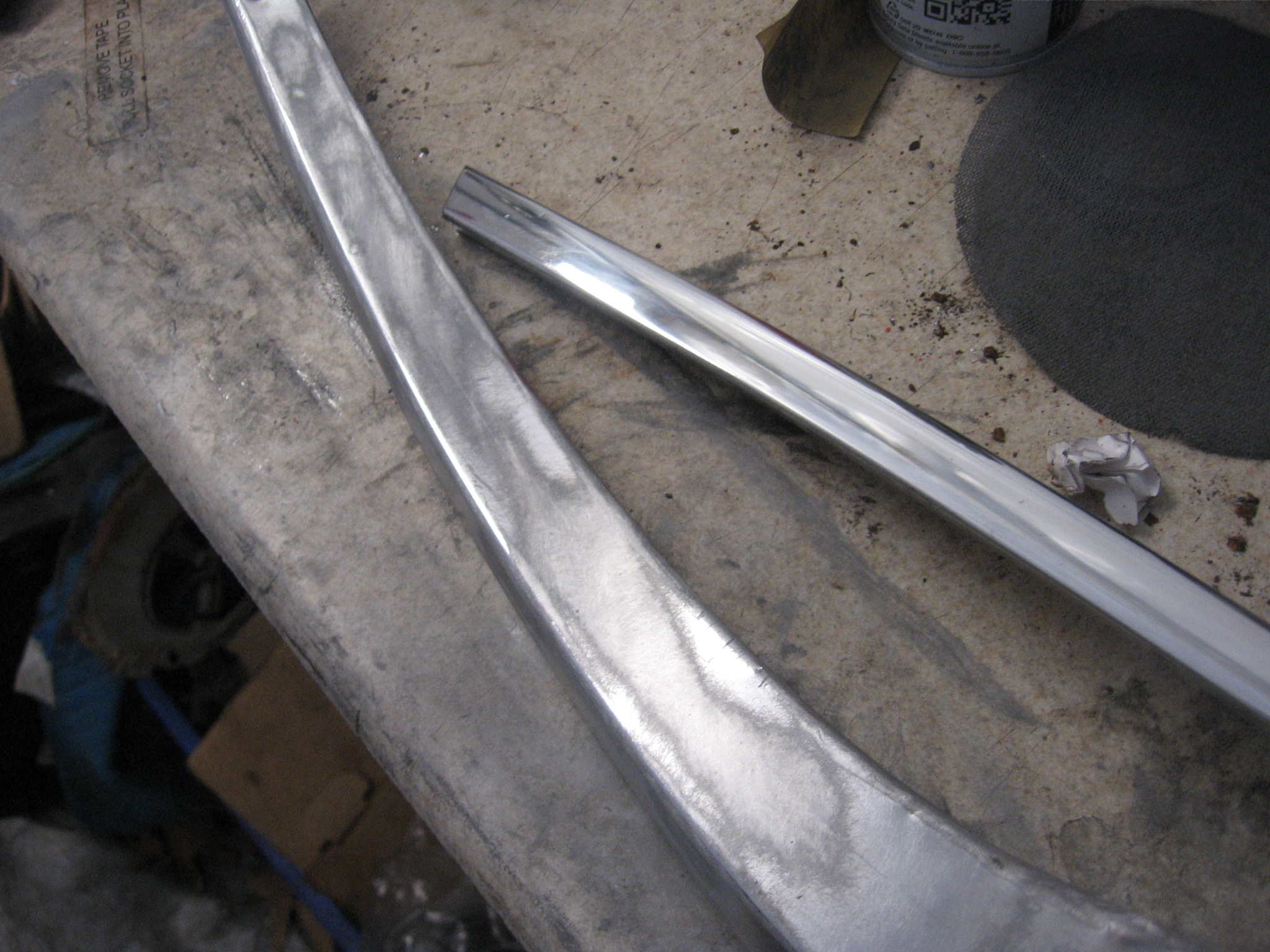

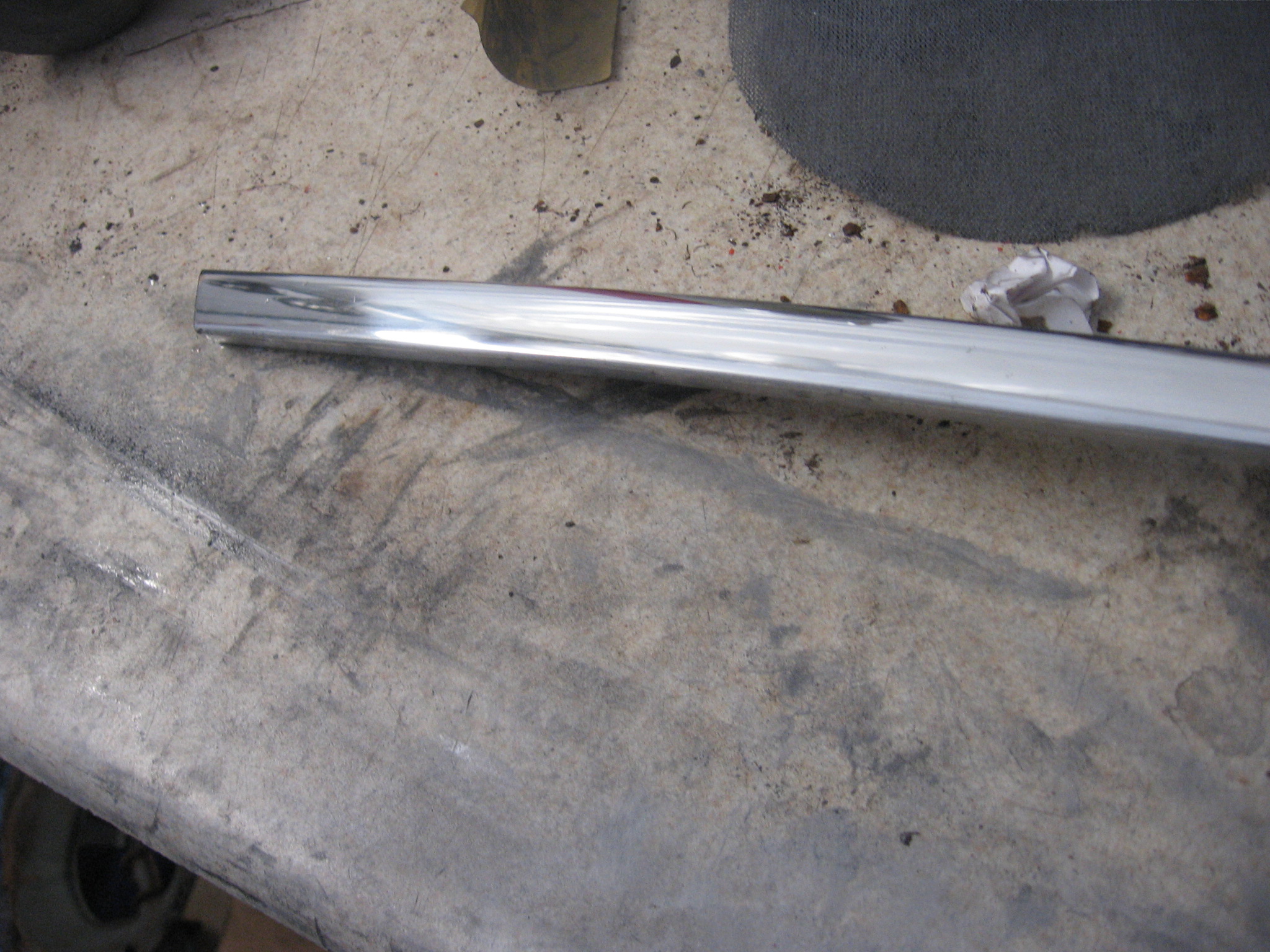

I worked on my trim last week. It all looked pretty tired
So I sanded it with 400, then 600, then 1000. Then I used a buffing wheel and some metal polishing compound followed by a little mother's aluminum mag polish. The toughest part was getting past all the old anodizing and getting the surfaces flat enough to sand.....
Voila (IMG:style_emoticons/default/biggrin.gif)
Installed the rear bumper and top along with the signals and trunk electrical
