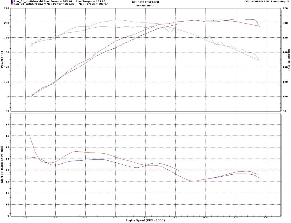

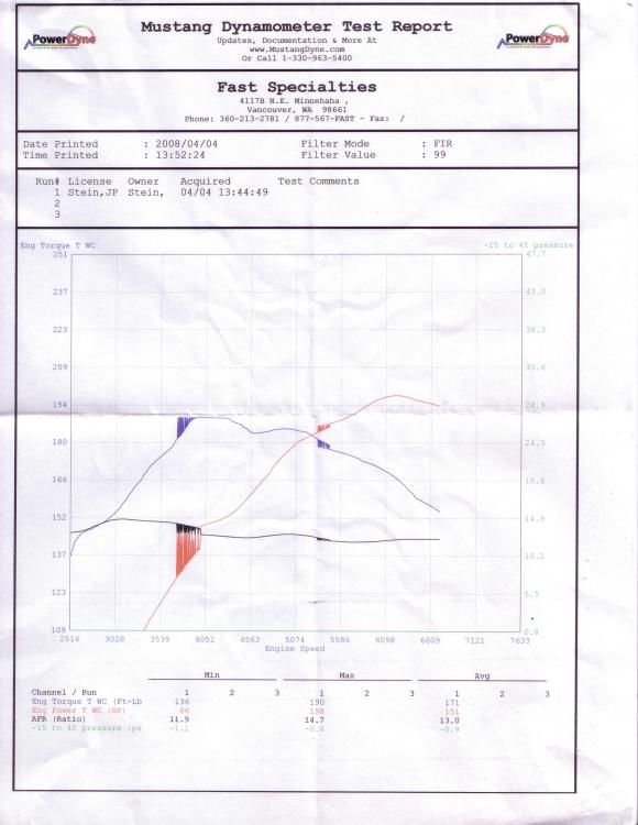

J P Stein   Let's throw this challenge up to the big 4 afi...   Apr 1 2012, 07:41 PM

J P Stein   The reponse from the T-4 crowd was as I expected....   Apr 3 2012, 09:46 AM
