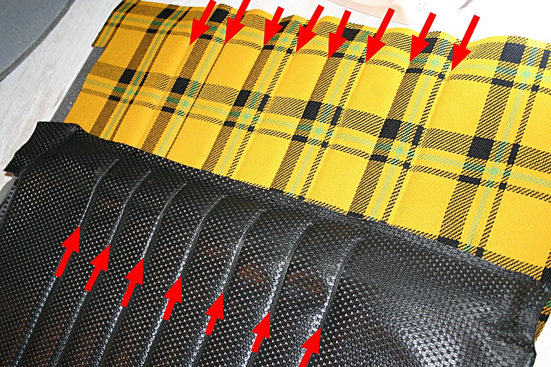

I cut the fabric using the pattern as reference. I used this picture found on this forum as reference. This is one of the few I found from an original seat.
The goal was to have three large stripes visible and centered.

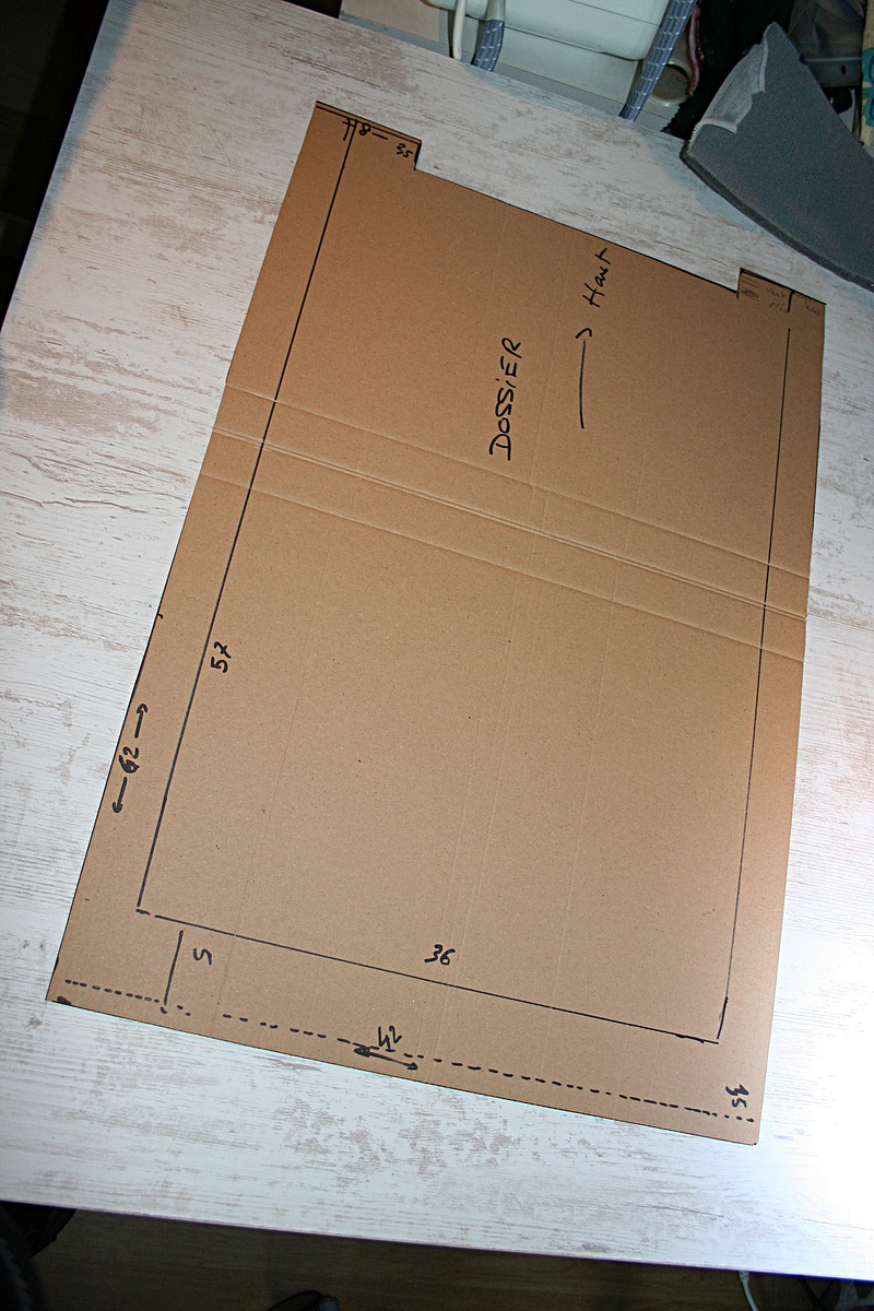

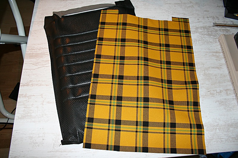

While desassamblig take pictures for future reference.
Use the desassembled parts as reference and draw the shapes on a cardboard that will be your template.

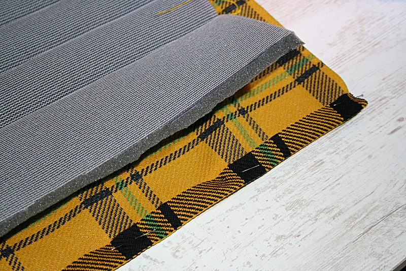

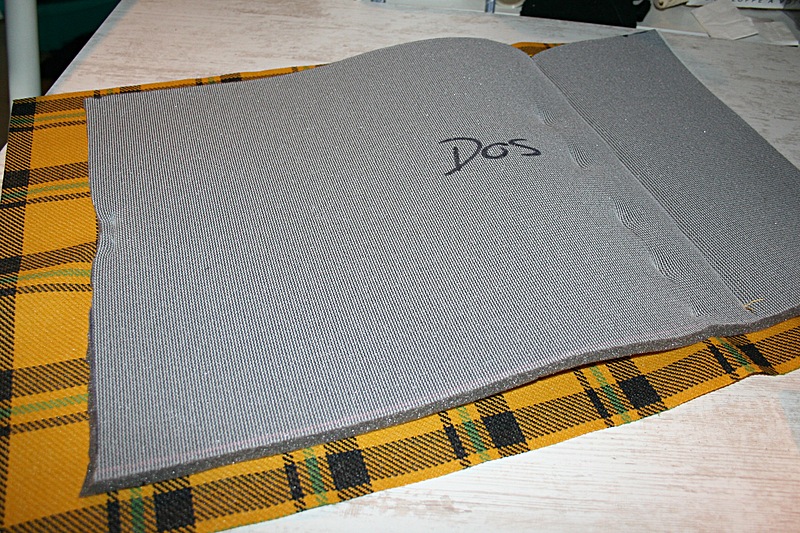

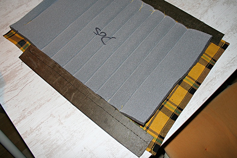

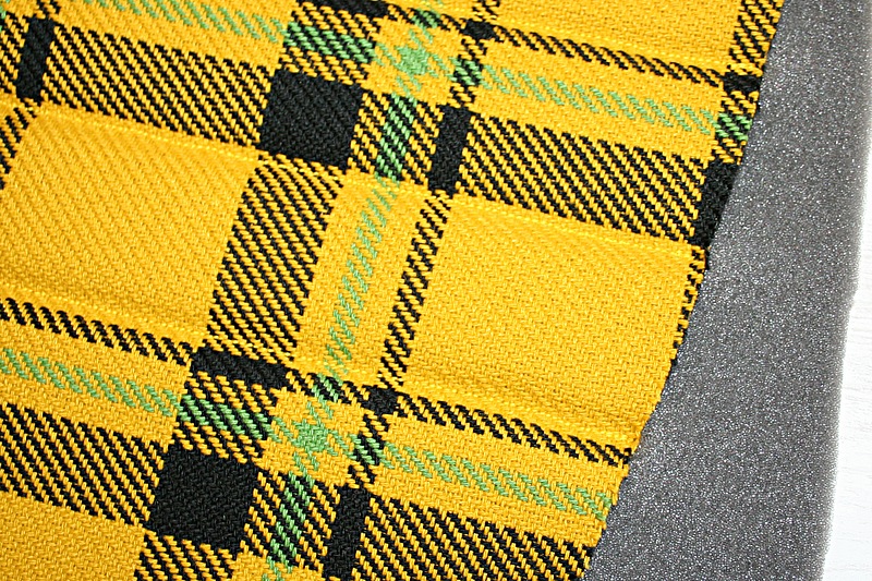

First job is to cut the foam that will be used for quilting.
I bought a foam that has a thin layer of fabric glued on one side. I bought it from an upholstery shop.
I suggest you buy the same kind of foam. Otherwise you will need to ad a layer of fabric over the foam and it will be a nightmare to sew.
(IMG:http://www.914world.com/bbs2/uploads_offsite/johannes.roussel.free.fr-5409-1339236459.1.jpg)

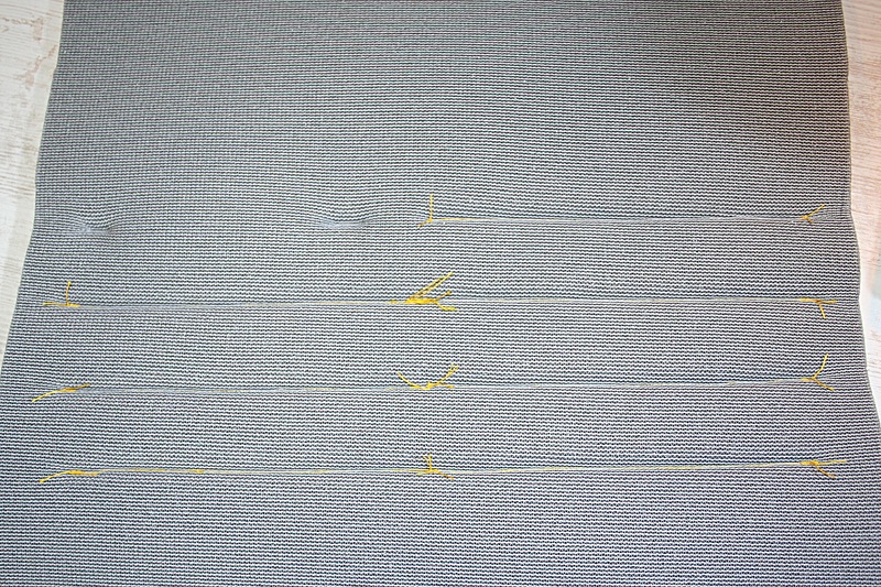

I wanted to have the quilting on the yellow part and used yellow thread. I chose not to follow the original quilting position as it falls randomly on black or yellow parts of the fabric.
I have one more quilting line than the original, but I found it easier to sew following the lines of the fabric.
With this template the first and the last quilting line is almost aligned with the original.
(IMG:http://www.914world.com/bbs2/uploads_offsite/johannes.roussel.free.fr-5409-1339236498.1.jpg)

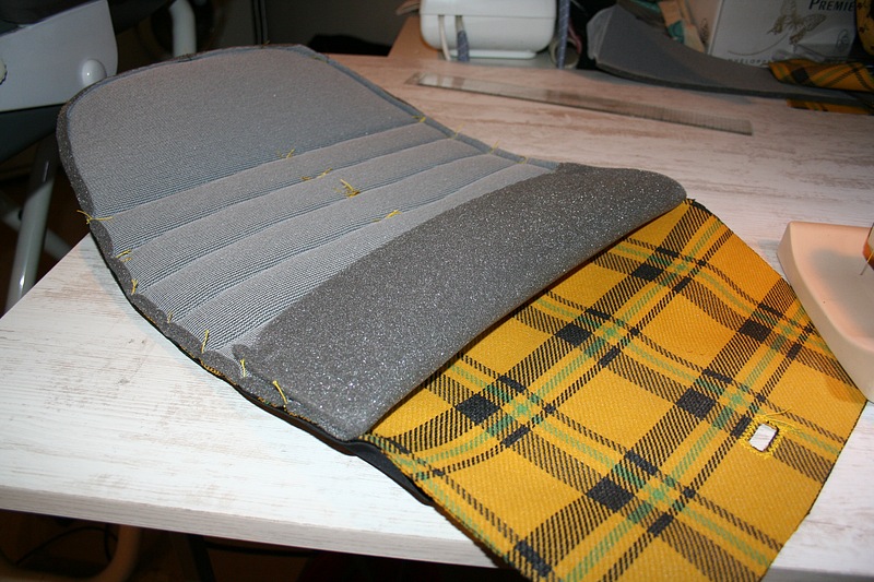

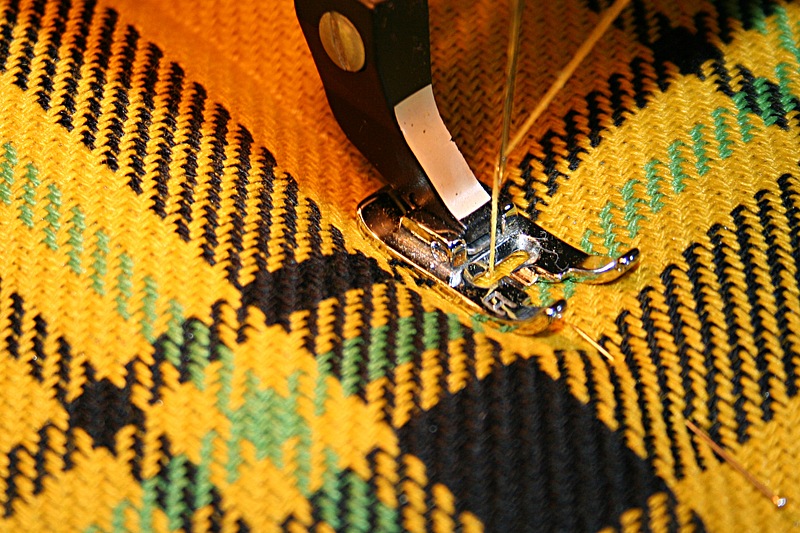

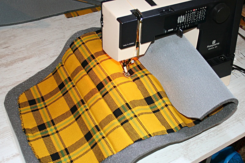

Use needles to first attach the foam with the plaid cloth
As the thread is very thick you will have to set the "thread tension" of the machine next to the max. See instruction book of your sewing machine.
Quilting next to a black line is easier. You can use the pattern as a guide.
(IMG:http://www.914world.com/bbs2/uploads_offsite/johannes.roussel.free.fr-5409-1339236529.1.jpg)

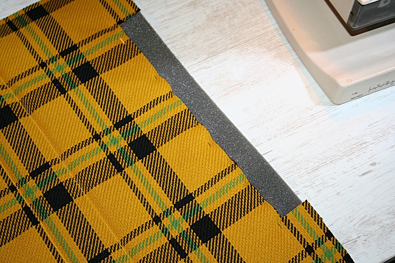

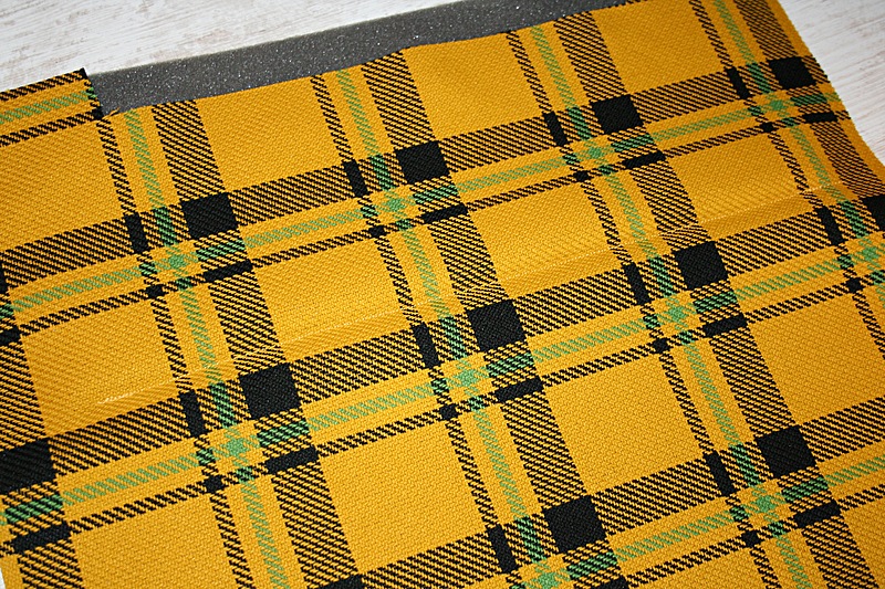

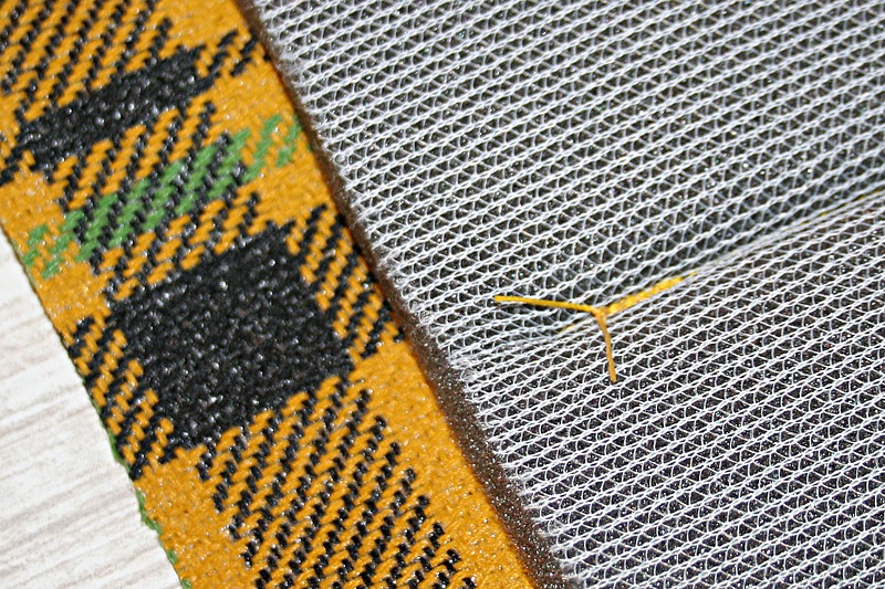

At the end of each sewing, I make a knot to secure the thread. As the plaid cloth will be later wrapped around a thick layer of foam, you can stop the sewing a centimeter from the end of the foam.
On this picture you can se the white weaving that is part of the foam.
(IMG:http://www.914world.com/bbs2/uploads_offsite/johannes.roussel.free.fr-5409-1339236607.1.jpg)

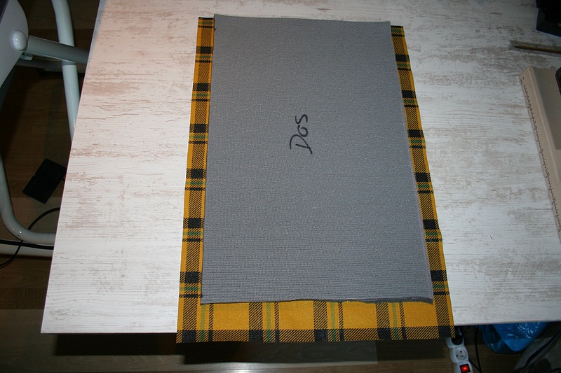

I attached the foam to the fabric at the bottom (here on the left of the picture) so It won't move during the sewing and I gave a bit of tension (see the foam bending).

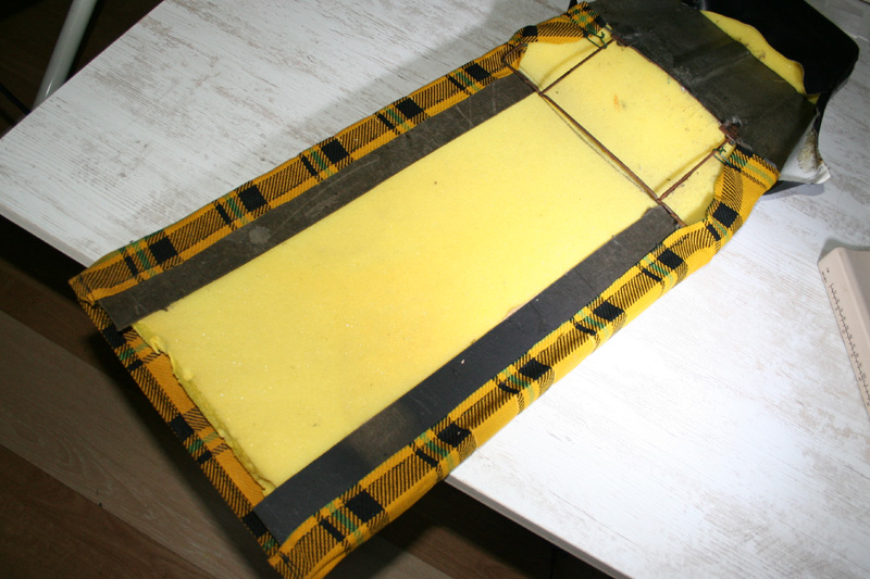

Now sew the headrest a few milimeters lower than the previous sewing.
I glued a stripe of woven tape inside the headrest (grey metallic). As the headrest was previously sewed it is a good idea to strengthen this place.
Put the wire in the hem at the bottom of the backrest.
(IMG:http://www.914world.com/bbs2/uploads_offsite/johannes.roussel.free.fr-5409-1339236807.1.jpg)
Wrap the backrest around the foam and glue the cardboards. Here the foam is yellow. It is a new foam I bought from the upholstery shop as the old foam was in bad shape.
Attach the top of the plaid cloth to the wire.
Your backrest is now ready to install.

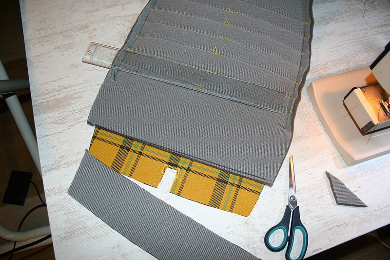

Once quilted you can cut the foam at the front of the cushion.
I used the green line as reference.
I made rectangular hole in the plaid for the metalic hook. I found out later the hole was not at the right place . I suggest you make this hole after you fit the cover on the cushion foam.

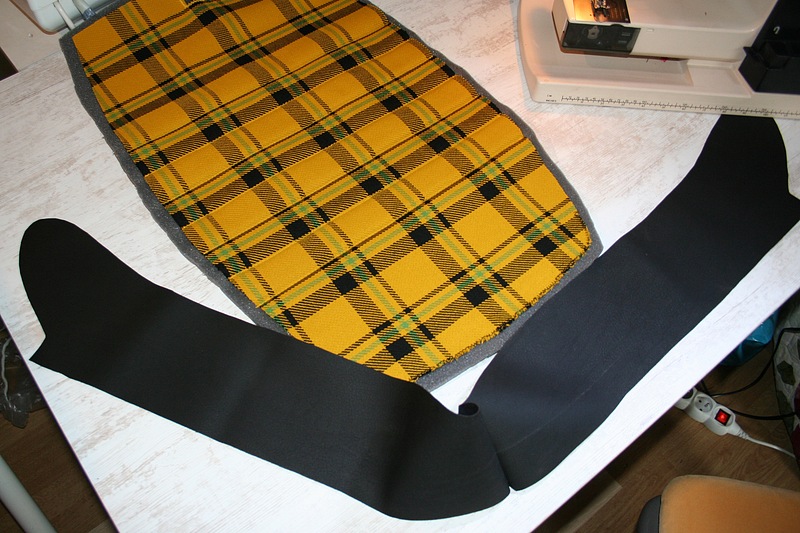

Now it is time to fit the vinyl to the cushion. I cut the vinyl using the old cover as reference.
I reported the shape on a cardboad, then used the cardboard as a reference to cut the vinyl.
(IMG:http://www.914world.com/bbs2/uploads_offsite/johannes.roussel.free.fr-5409-1339237021.1.jpg)

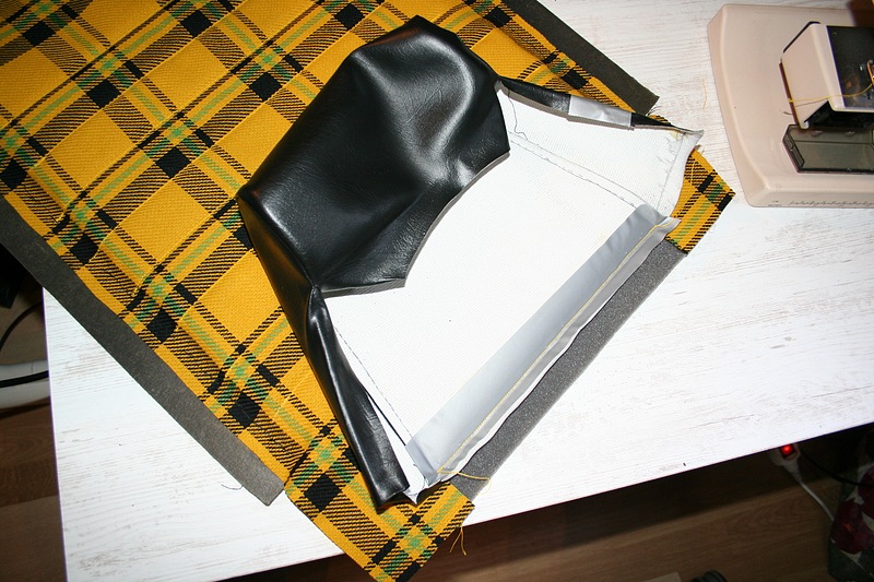

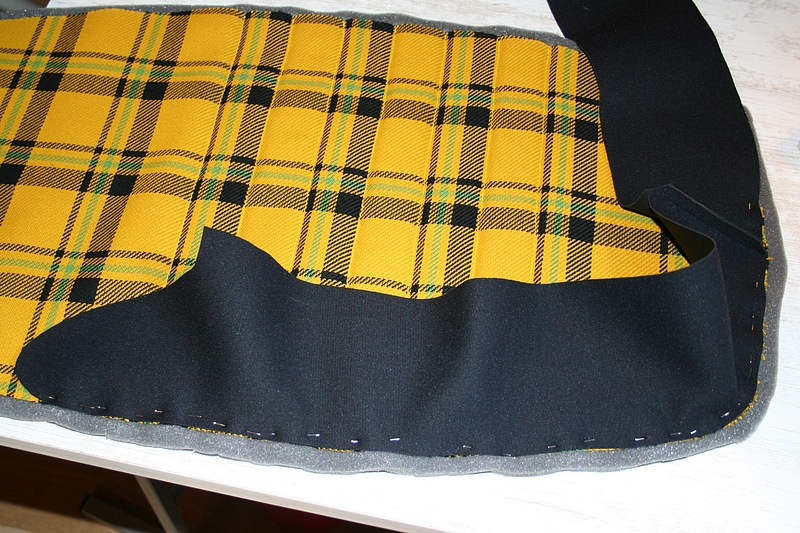

First assemble with needles.
This is the tricky part because you will have three layers to sew togeter: Vinyl, plaid cloth and foam.
IMPORTANT !!!
You wont be able to sew the foam in the tight curve at the front of the cushion.
This is how I did:
I sewed the three layers from the back of the cushion to the beginning of the curve.
Then, from the curve I only sew the plaid to the vinyl. The foam is not attached from the curve.
(IMG:http://www.914world.com/bbs2/uploads_offsite/johannes.roussel.free.fr-5409-1339237068.1.jpg)

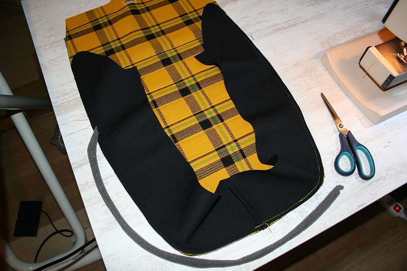

once the straight line is sewed, you can cut the foam.

Wrap the foam so it won't be in the way when you will sew the tight curve...
(IMG:http://www.914world.com/bbs2/uploads_offsite/johannes.roussel.free.fr-5409-1339237145.1.jpg)
