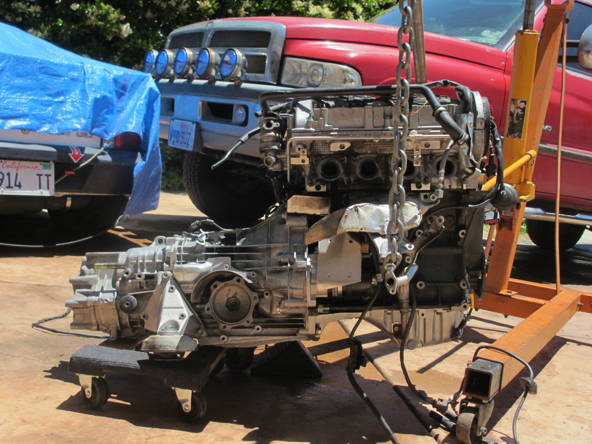

I stumbled on a steal of a deal for a 2001 Passat 1.8t, Audi ATW engine and 5 speed transaxle. Long story short and here you go. New engine cleaned and ready for fab time. The exhaust and turbo have been removed before power washing.
Here is a link to Part I
http://www.914world.com/bbs2/index.php?act...=0#entry1396734
Part II
http://www.914world.com/bbs2/index.php?showtopic=172455

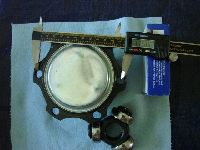

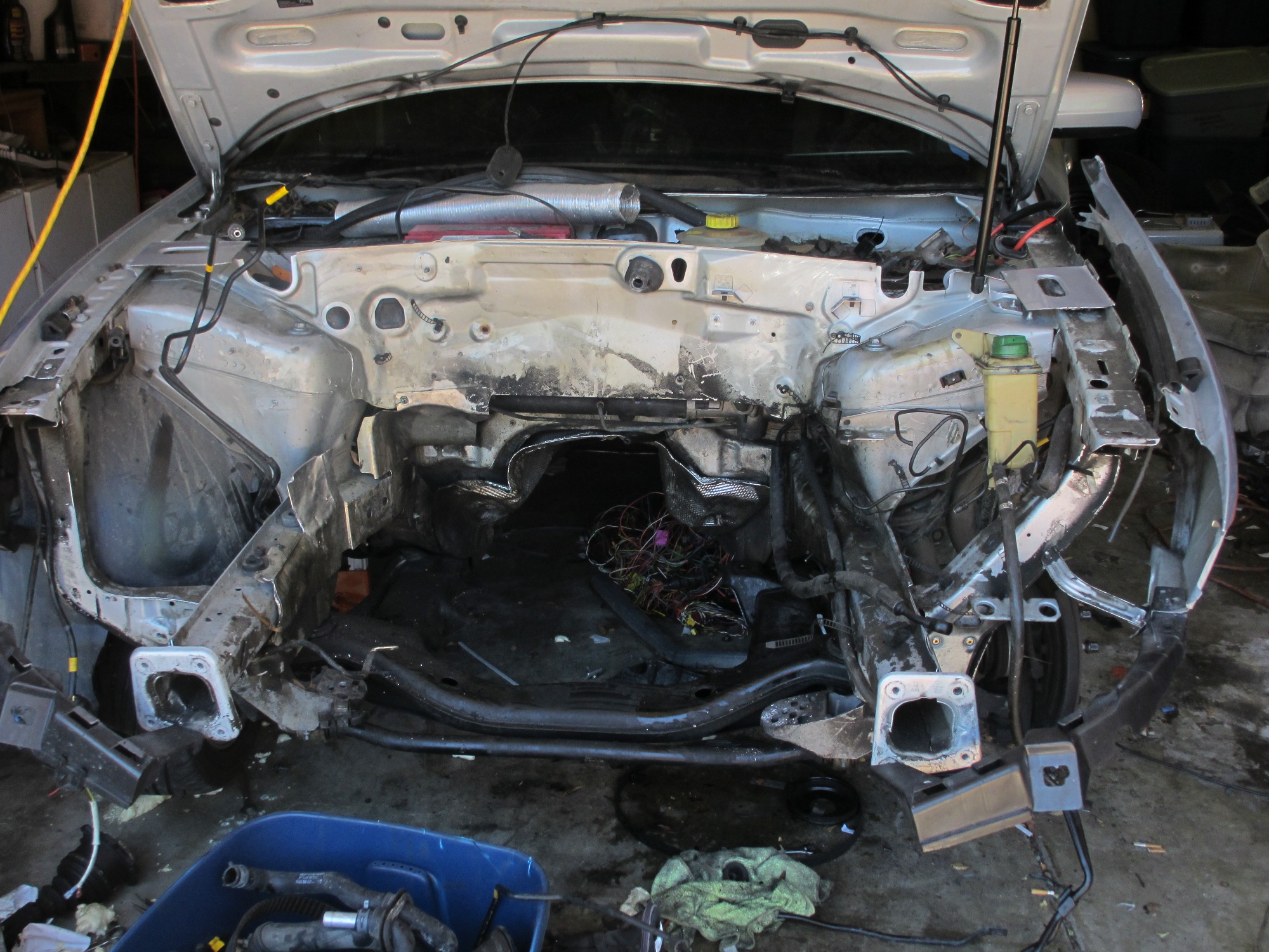

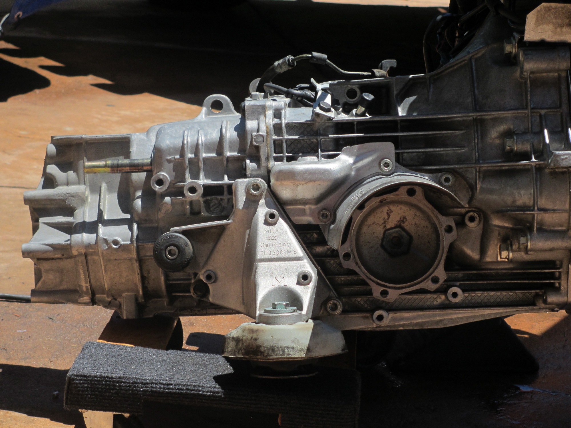

Here is the challenge. The transaxle. Either I fab an adapter, Fab an axle to take 1 Porsche CV and 1 Audi/VW CV or Replace with Boxster tranny, that will: Bolt right on, Shifter is cheap and available and requires less fab time. I'm leaning to the Boxster due to the 100mm Porsche CV flange. The Audi is 114mm.

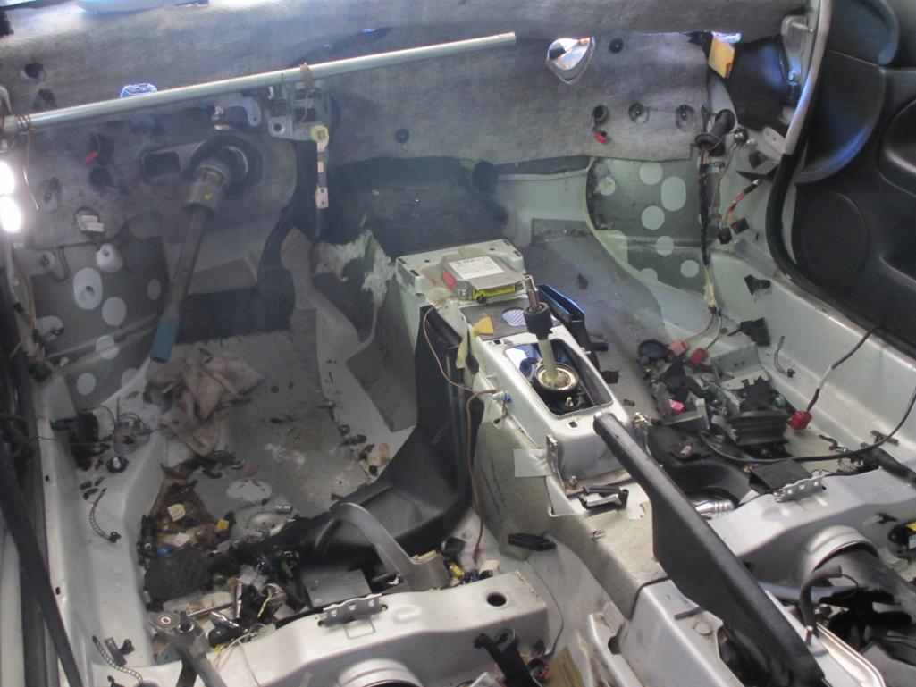

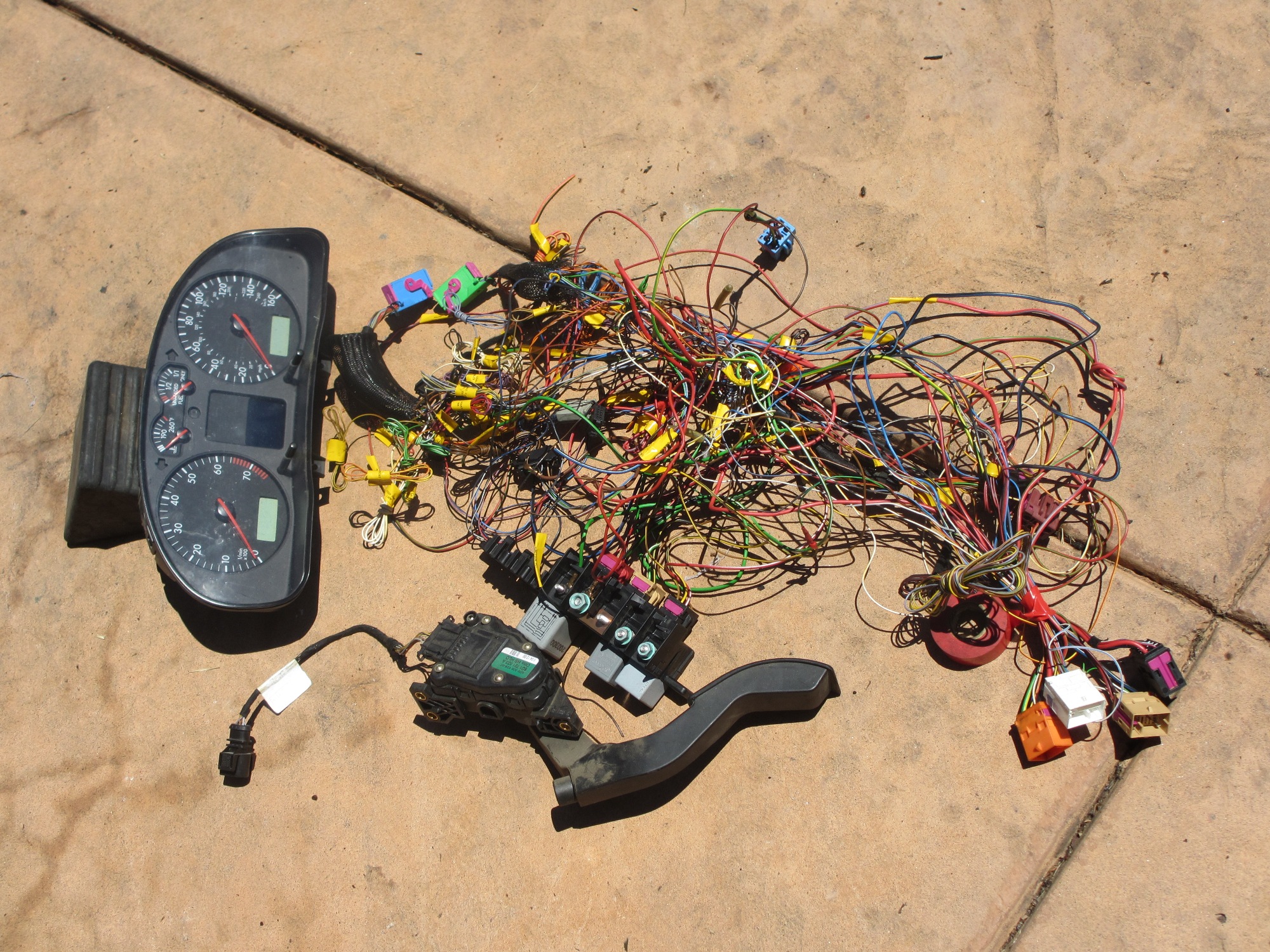

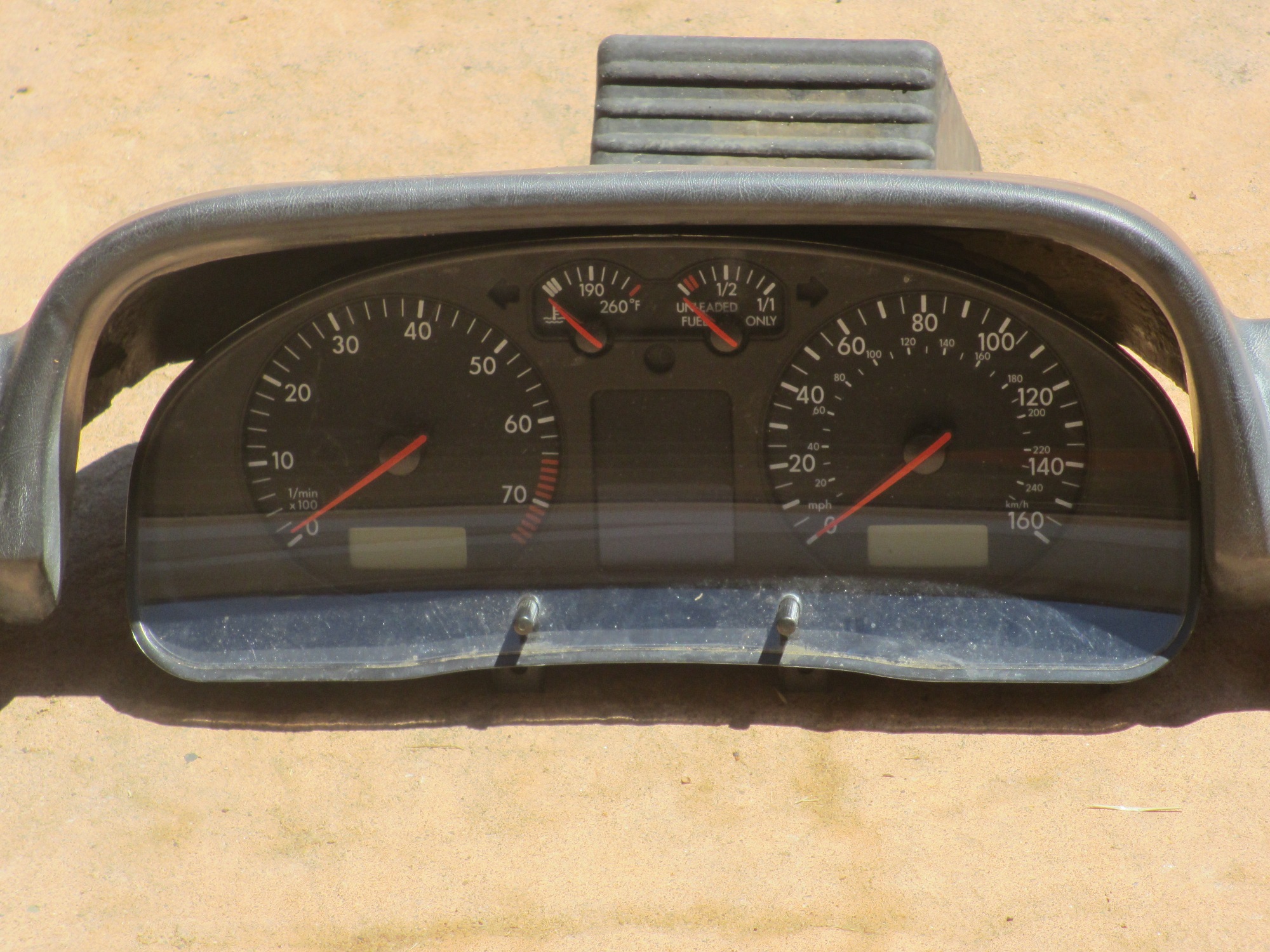

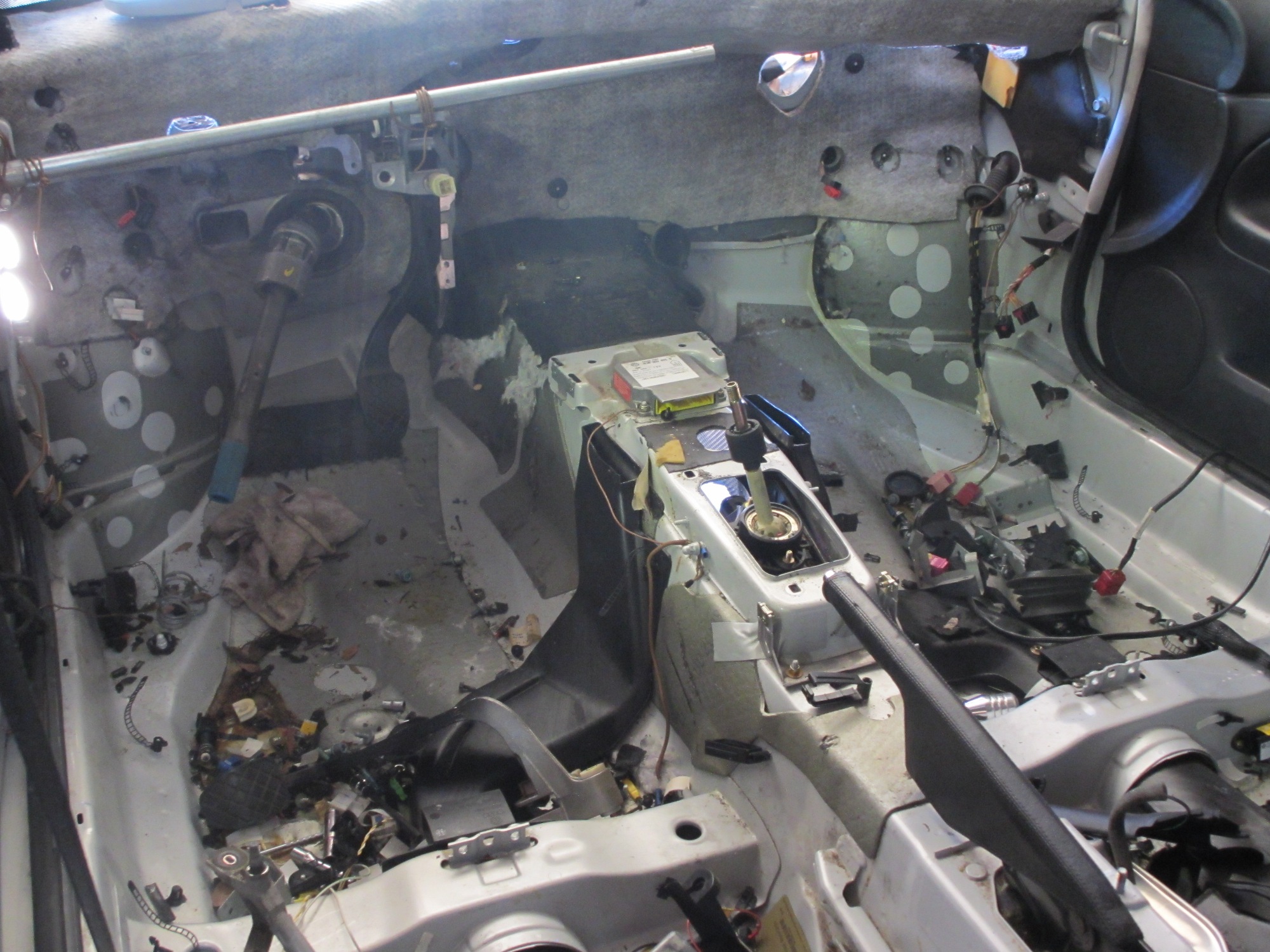

This is whats left of the wiring after the car gets gutted. The ECU and gauge cluster have a symbiotic relationship. They work together and have to stay together to run. It looks like it will fit nicely into the stock location. I may have to adjust the column lower and build an trim ring around the cluster.

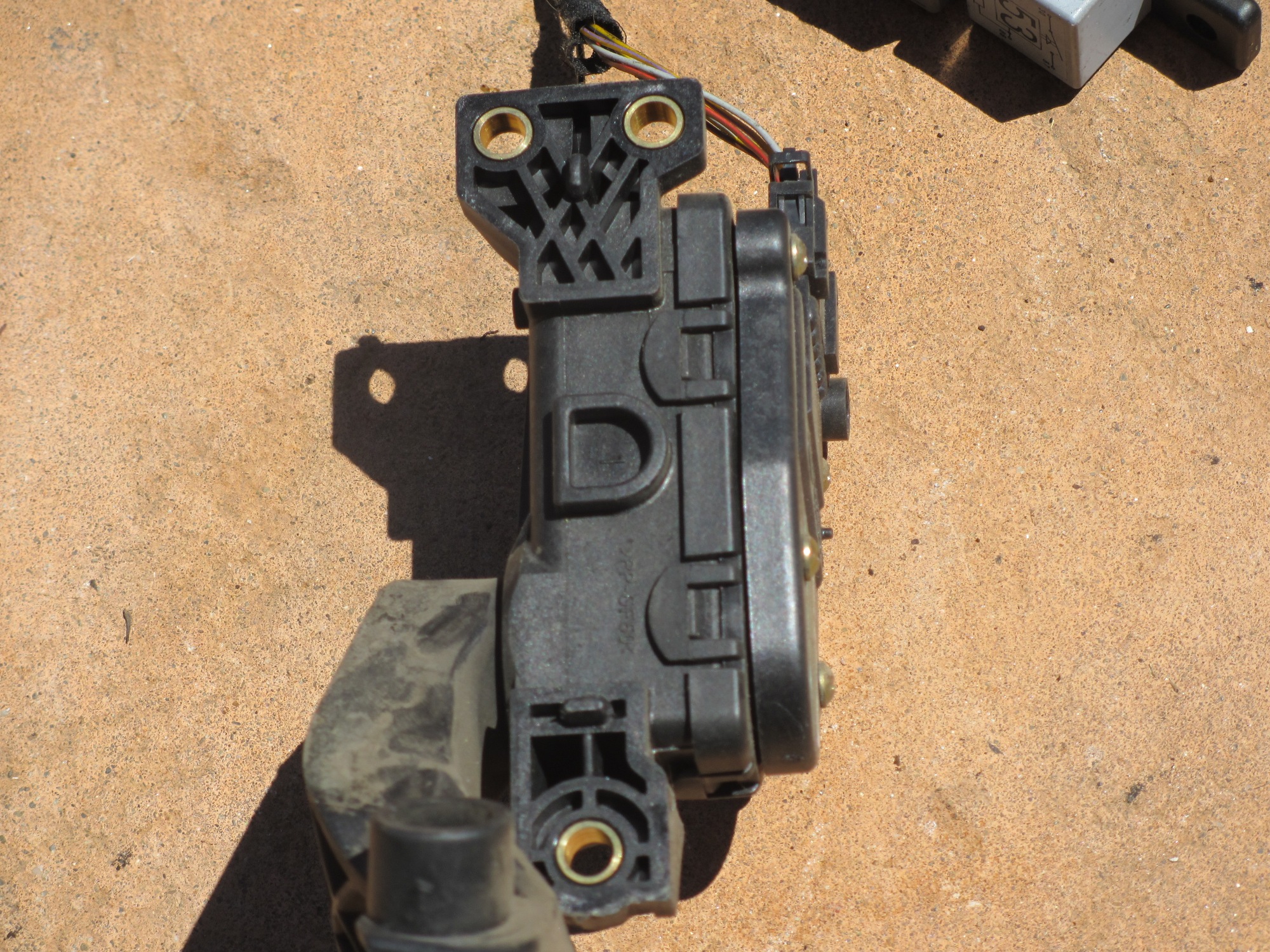

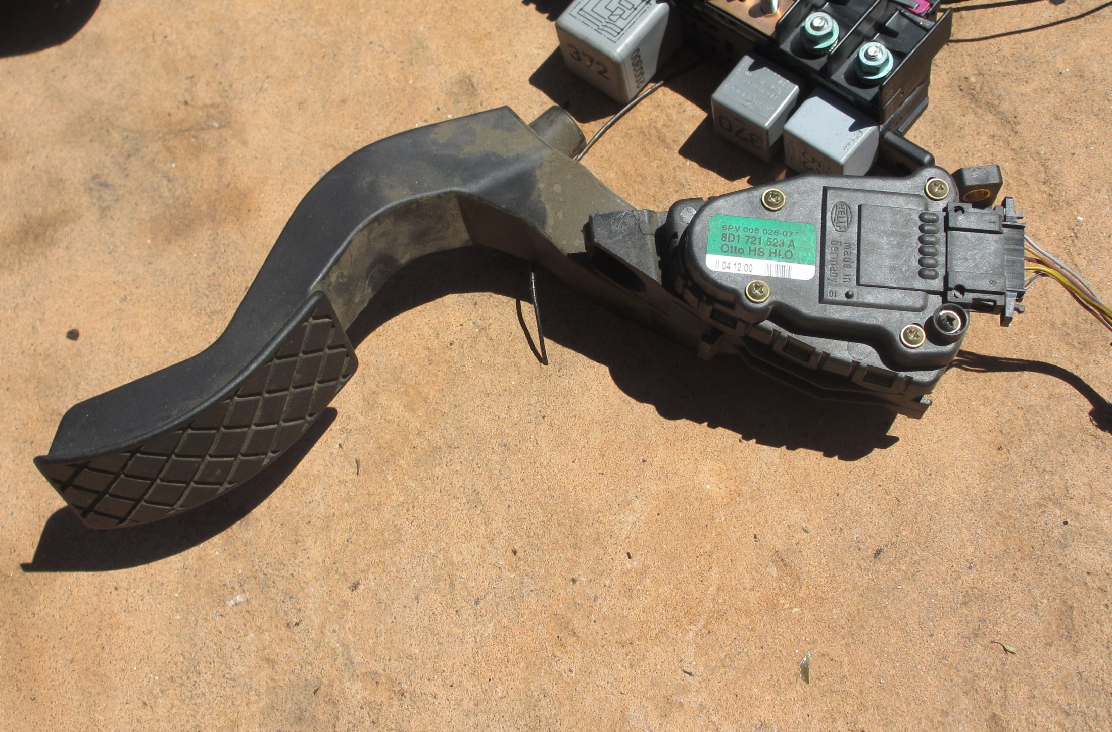

Here is the Electronic Gas Pedal... Pretty cool. Should be pretty easy to build a bracket for it...

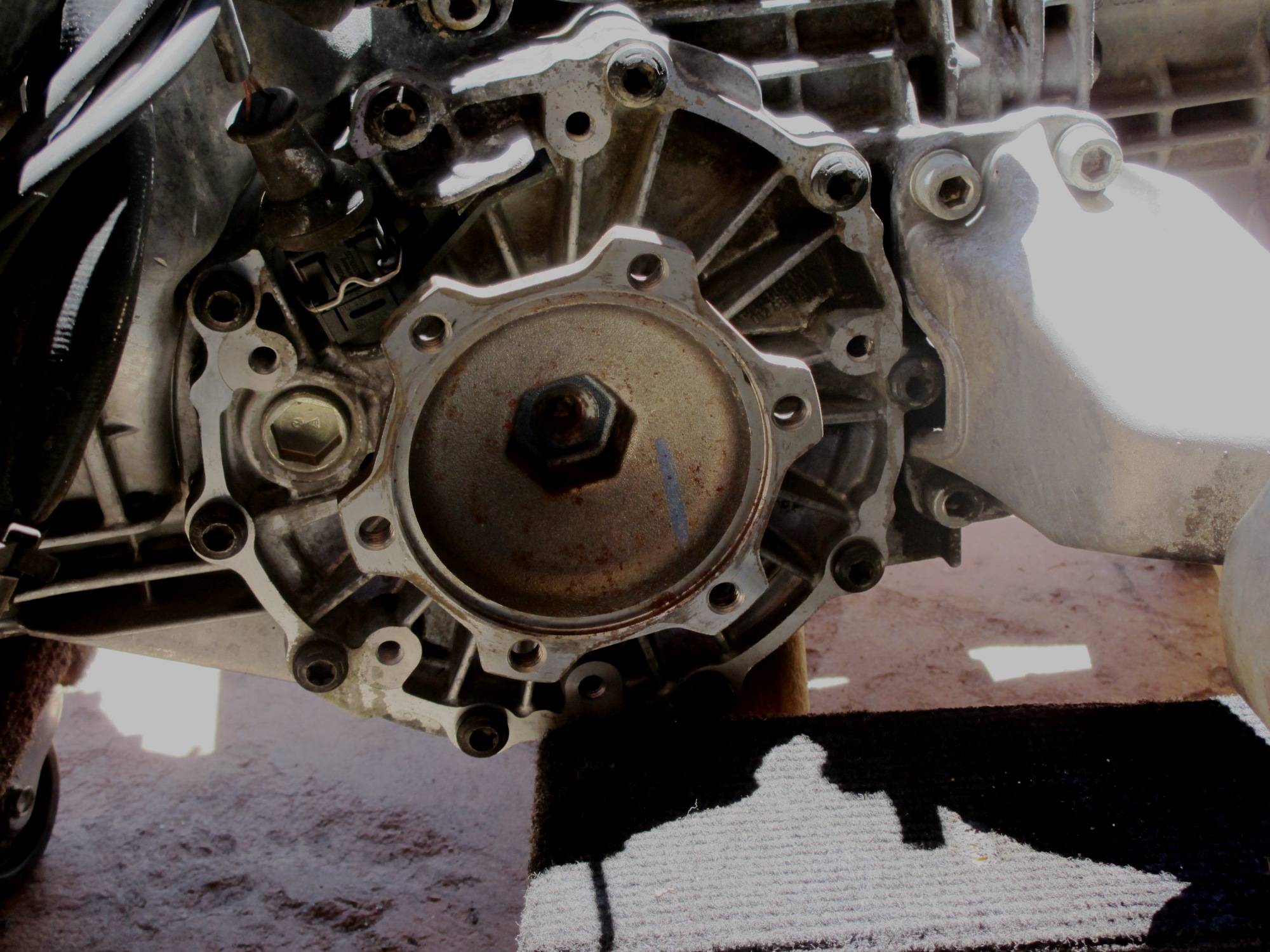

Close up of the tranny flange. The Audi CV looks like it has a thicker shaft too.

I believe you can swap out the tripoid transaxle flages for the ones that are compatible with the Porsche CV. I used to know this stuff from memory, but......... On mine I went from tripoid to Porsche by machining my own adapters, but I also widened the bearing hubs. Keep in mind, the flanges on that 012 trans may not be symmetrical about the centerline of the trans; they weren't on my 01e. Inseted of goofing with axles, etc, I simply mounted the engine/trans off center by about 3/4".

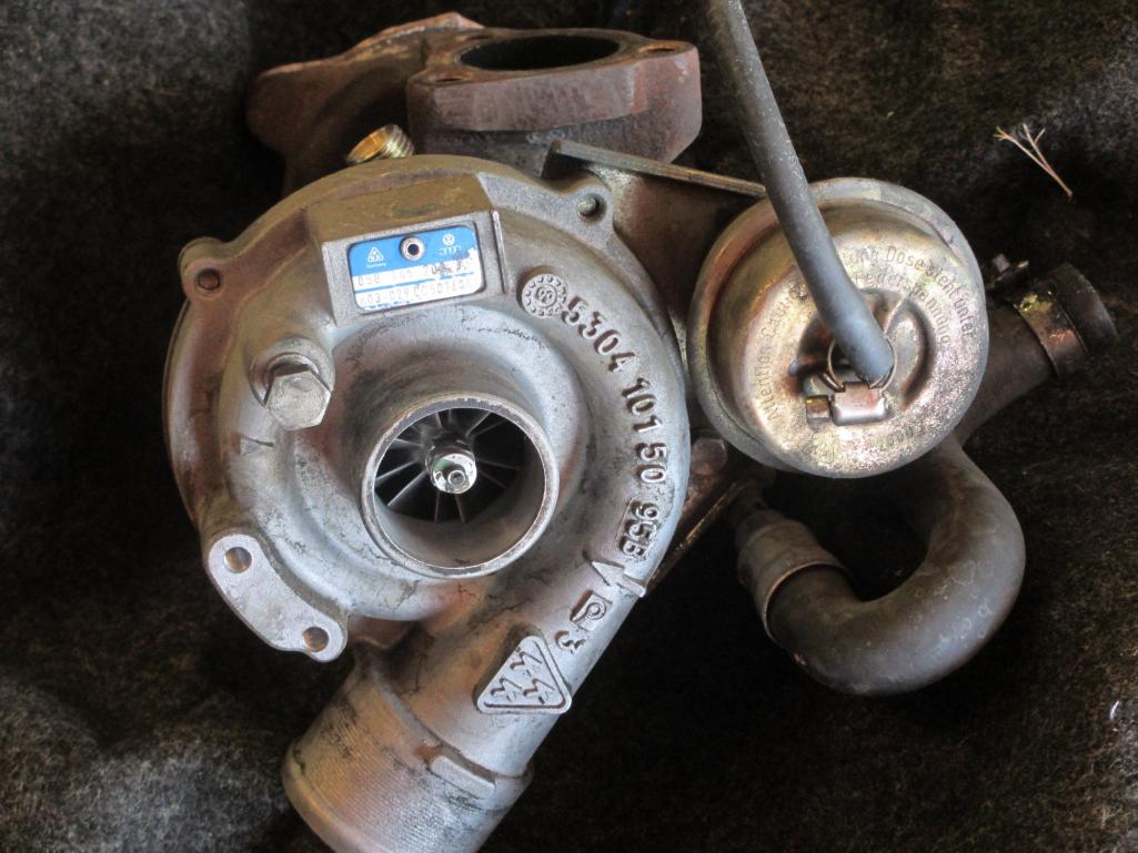

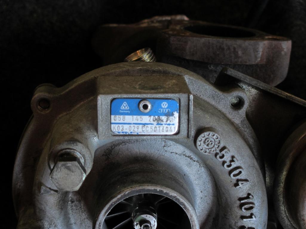

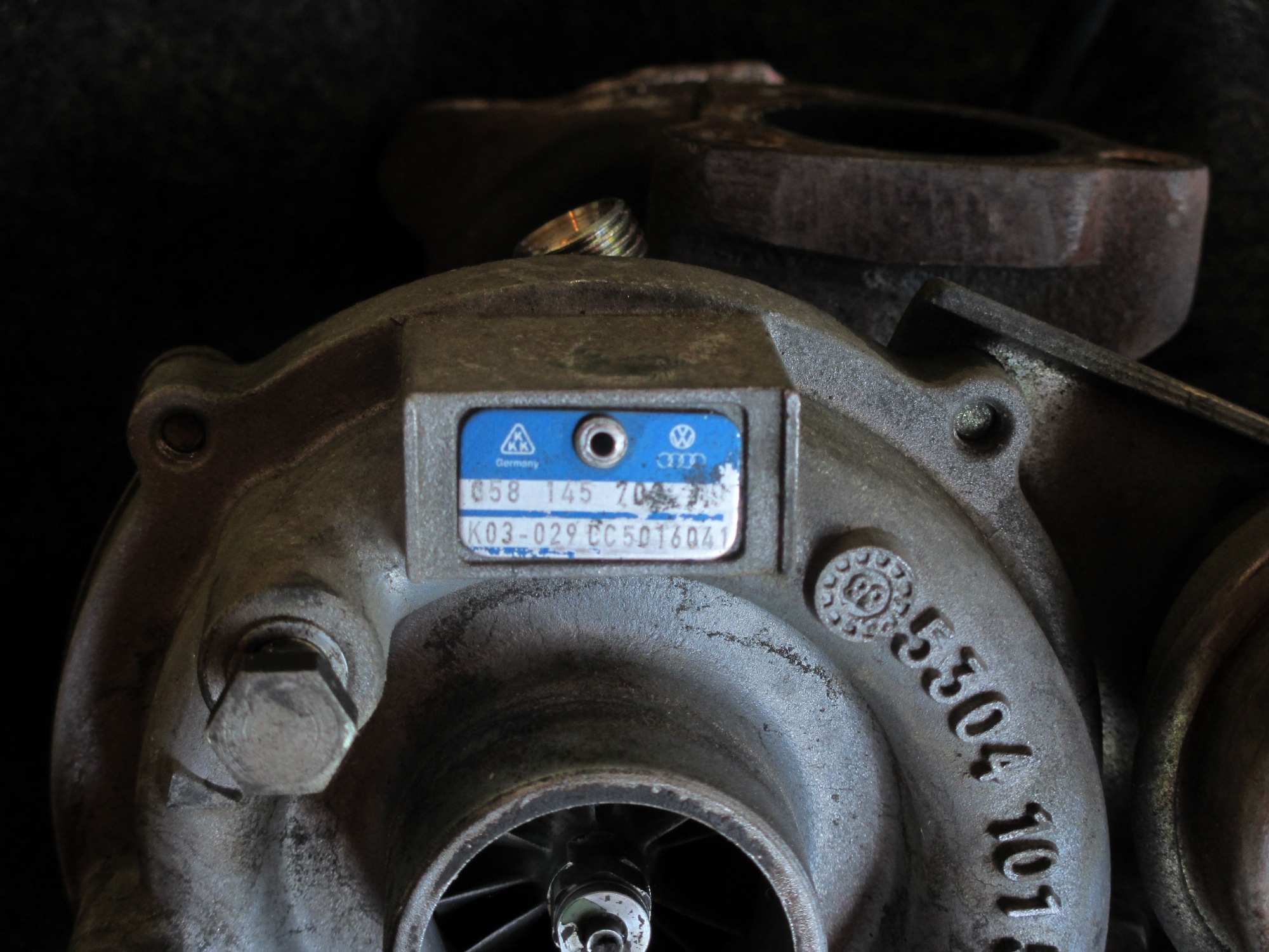

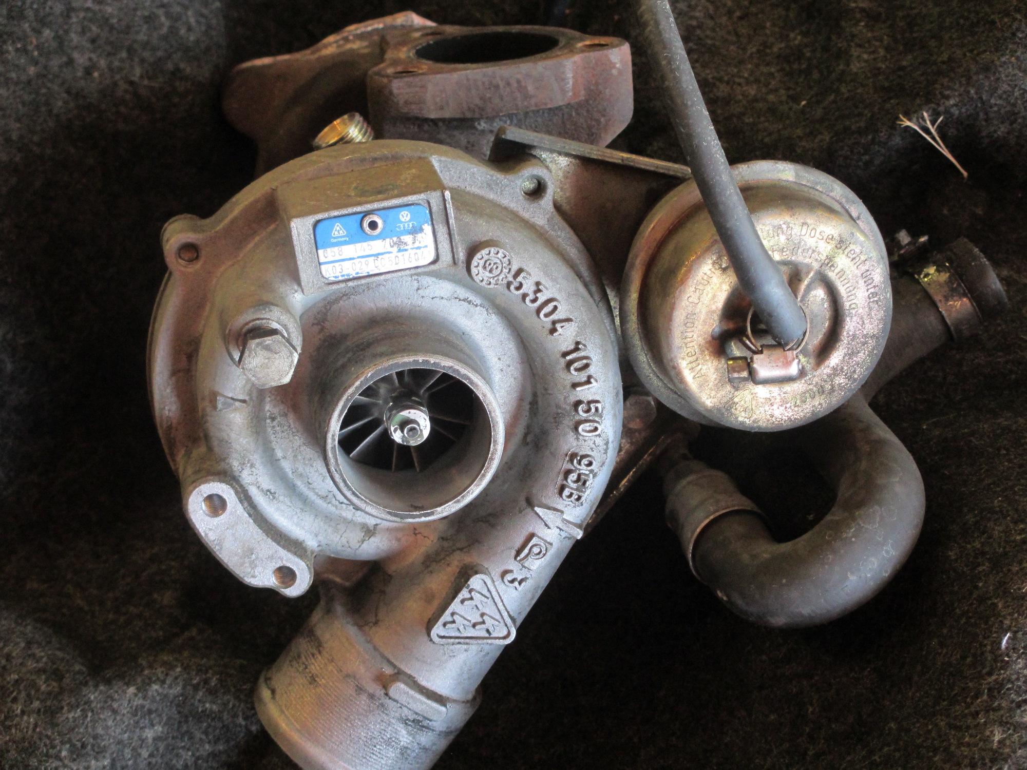

Here is the stock K03 turbo. It hangs from a chincy looking cast iron manifold. There are high flow cast replacement manifolds cheap. A K04 is a bolt on upgrade for this turbo. Bigger I guess... More better power (IMG:style_emoticons/default/biggrin.gif)

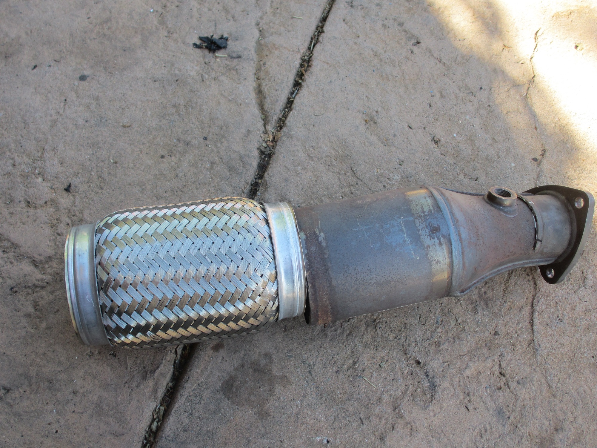

The stock dump/CAT pipe is 4" OD. Looks like connecting to my 4" exhaust is easy. I picked up this 4" flex too. A V band on one side and done. I will gut the CAT and shorten the chamber after I get to engine in the car.

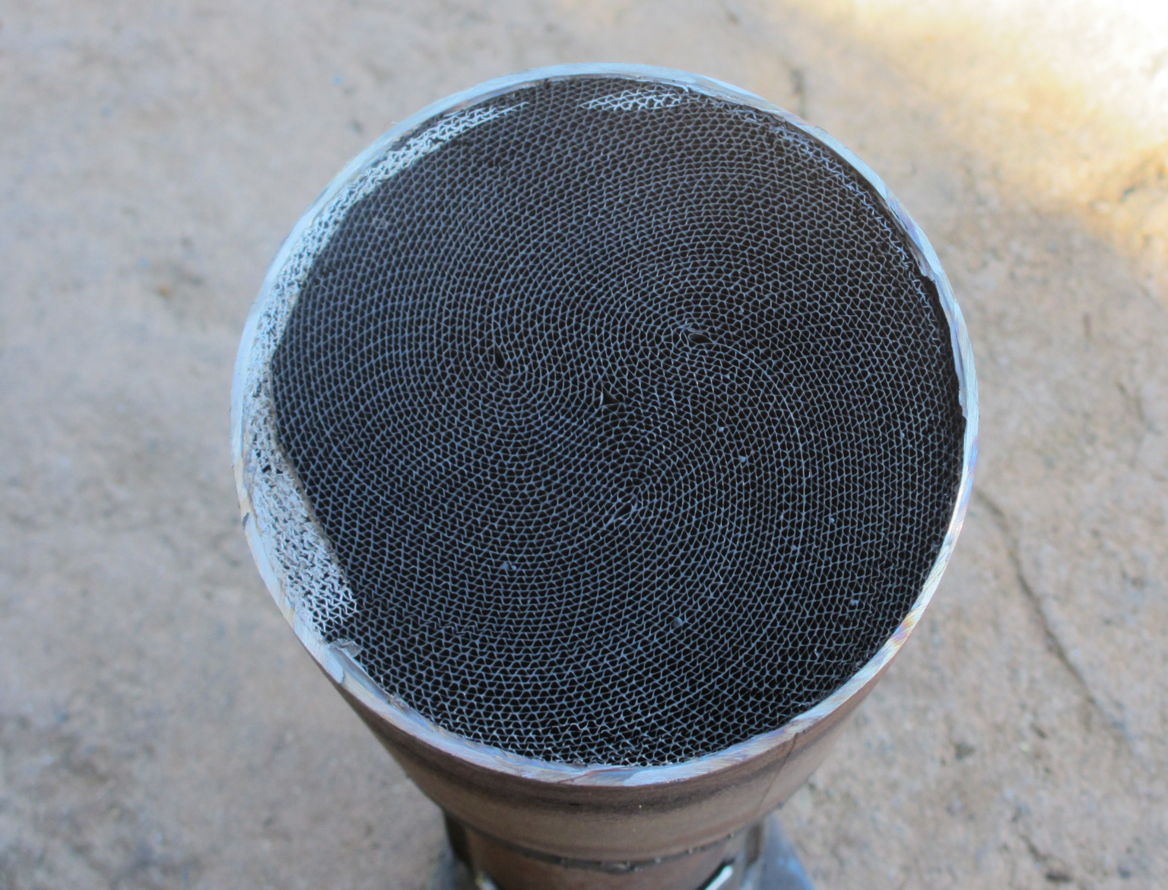

Ever wondered what was inside? Is this platinum? Should I recycle it?

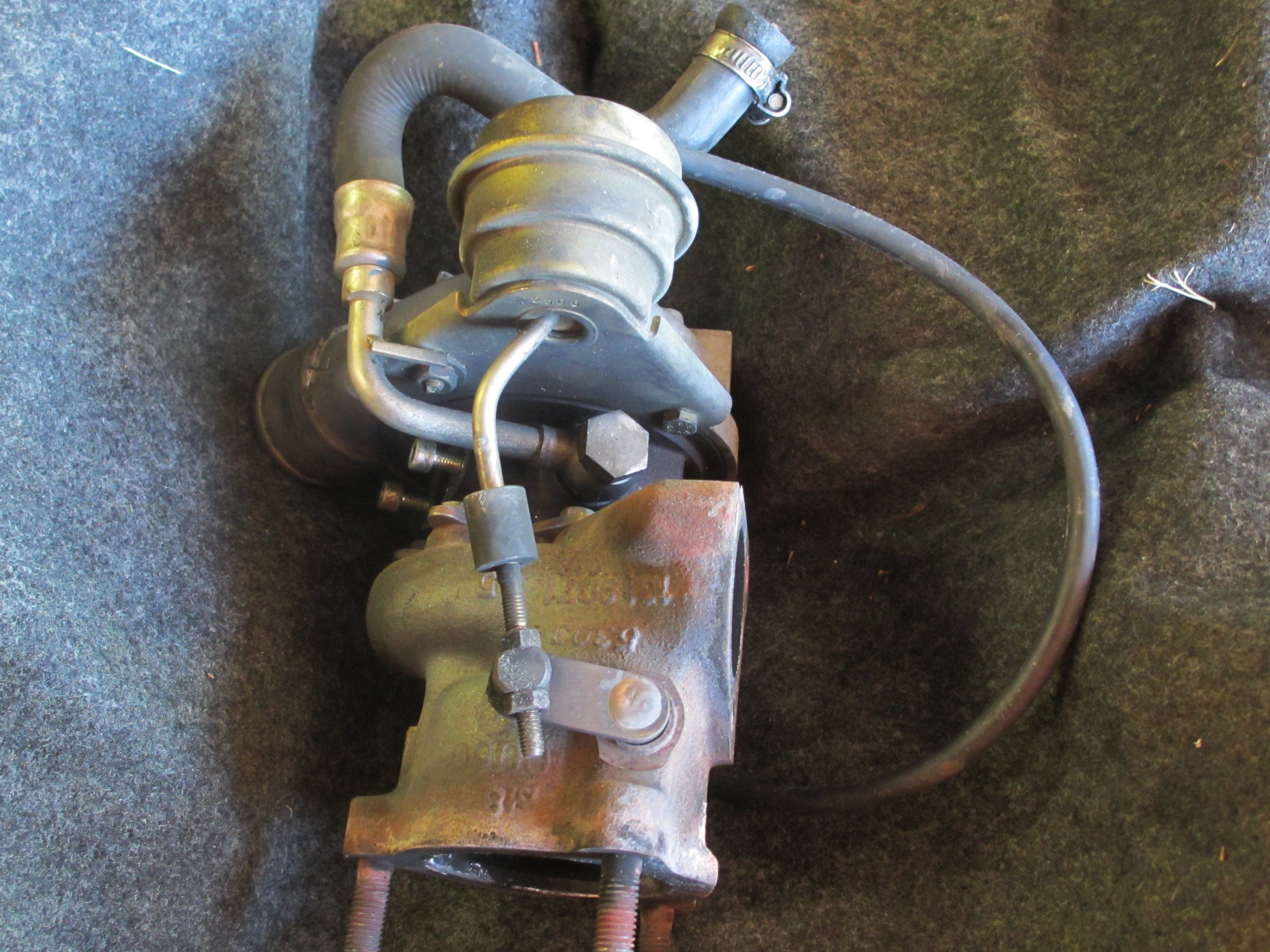

Here is a DAPO mod to boost spring pressure. You shorten the rod by bending a "Z" into the rod. This one is a "V" and bound on the edge of the canister. This boost dump would be lees predictable and may suffer from boost creep or slow dump. Do it right or don't do it...

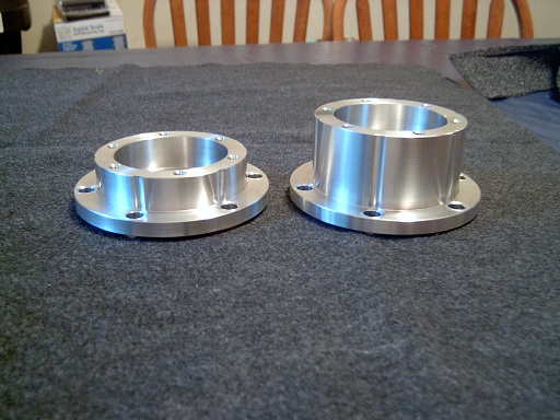

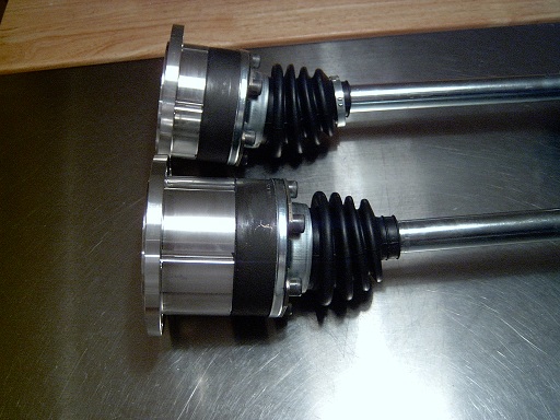

Years ago I had REVO flash the ecu to eliminate the cluster and a few emission control points. When I first converted to the 012, I had custom axles with the tripoid inners. When they started to wear, I had flange adapters made that equalized the output offset and allow me to use 944 joints.
That's exactly what I would need. Got any drawings?

I have loved the Sasquatch build btw... I actually wanted to comment on the K04 upgrade... If I can talk you out of it, I will try. The turbo is not a good add on for this engine stock. The efficiency is all at the wrong points and often blows these engines. If you want a good upgrade there is an outfit called frankenturbo that builds a hybrid for the 1.8t that is a perfect match. I drive an 02 GTI as my DD and spend a lot of time with these engines. I have thought about this same swap and I am glad to see someone doing it. Can't wait to see the progress!

Nice ill be watching. Cat converter guts arnt worth much. the recyclers like to see the whole cat so they know what theyre getting. Since all cats have different metal content prices are all over the map

QUOTE(tscrihfield @ Jun 10 2012, 07:03 PM) *
I am having 034 Motorsport re-flash the ECU. They will remove the extras (ABS, Smog, etc...). They can put in a K04 tune. This will require injectors and stuff. No big deal. Price is the same. These guys know their shit too. When running, I can have them throw it on the dyno to fine tune it to my exhaust and intercooler.
You are correct about just throwing on a K04 to a stock motor. Heck I may go with an even bigger turbo. At this point it's pennies on the dollar to go bigger. The tune is the same price and the turbo is only a couple hundred more.

Check to see about poping out the drive flanges from the trans and put in the boxster ones. When we were trying to decide what to do for axels someone told me to put the 6speed boxster drive flanges in so we could get larger cvs. They were wrong but I had to pop out the flanges to verify this info and it was very easy to do.
