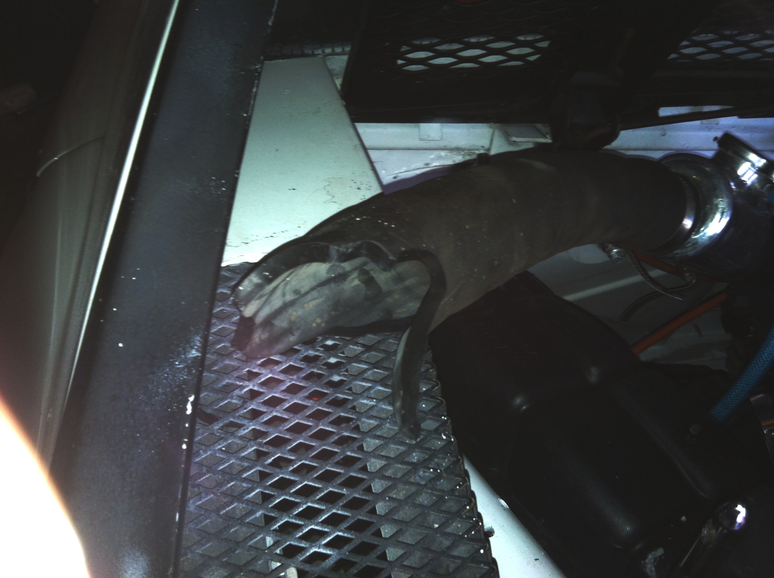

And then this happened... (IMG:style_emoticons/default/dry.gif)
I changed out the water temp sender today. Yes, little coolant came out. 1-2 cups of fluid escaped. I decided to take it on a test drive. No, I did not top it off. I made it 7 miles when the radiator hose let go with a violent bang! Steam spewed from my GT style engine lid and coolant was everywhere. The moment the check engine light came on I was turning off the ignition...
Towed it home (See trailer thread) and parked it.
Lesson learned. Always pull the air out of the system. (IMG:style_emoticons/default/chair.gif)

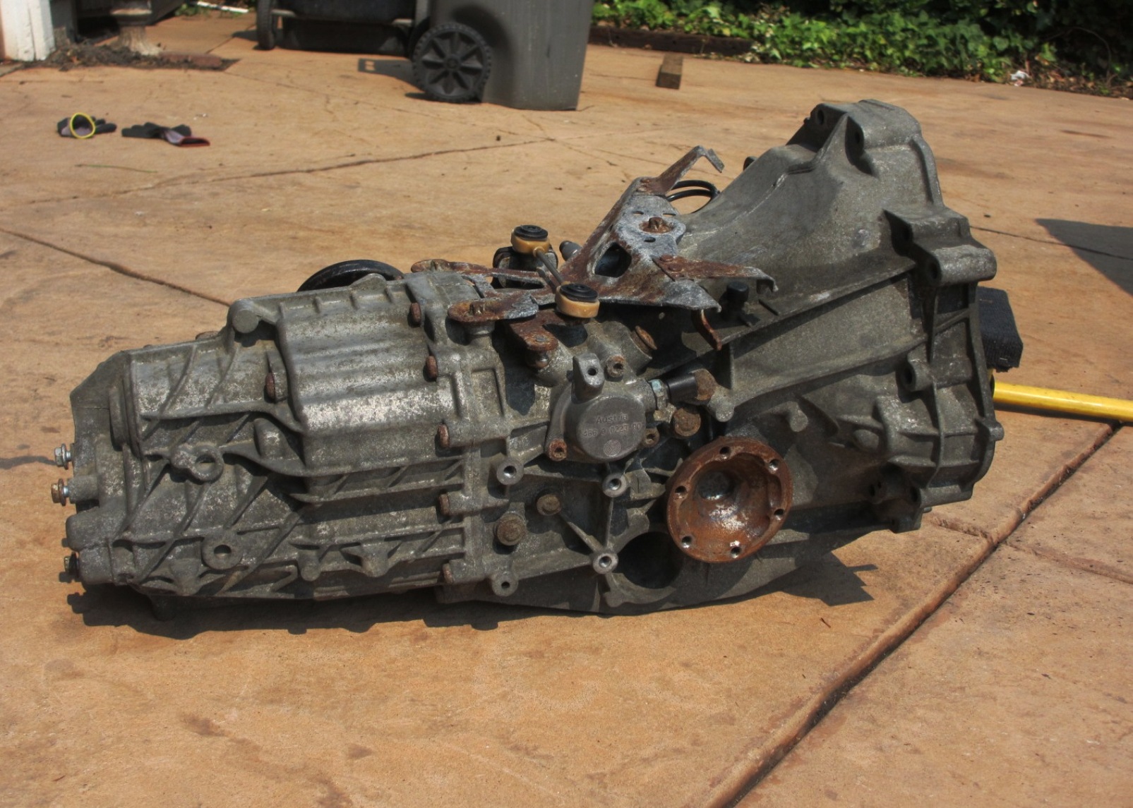

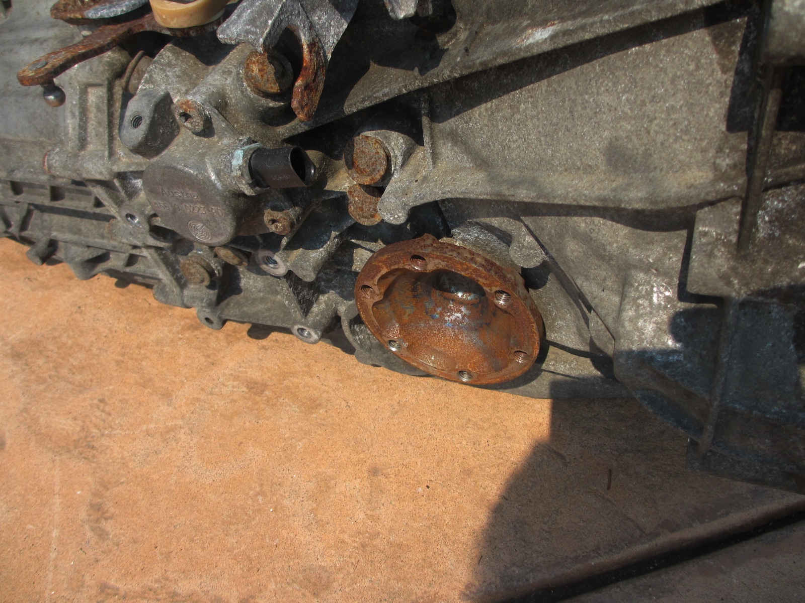

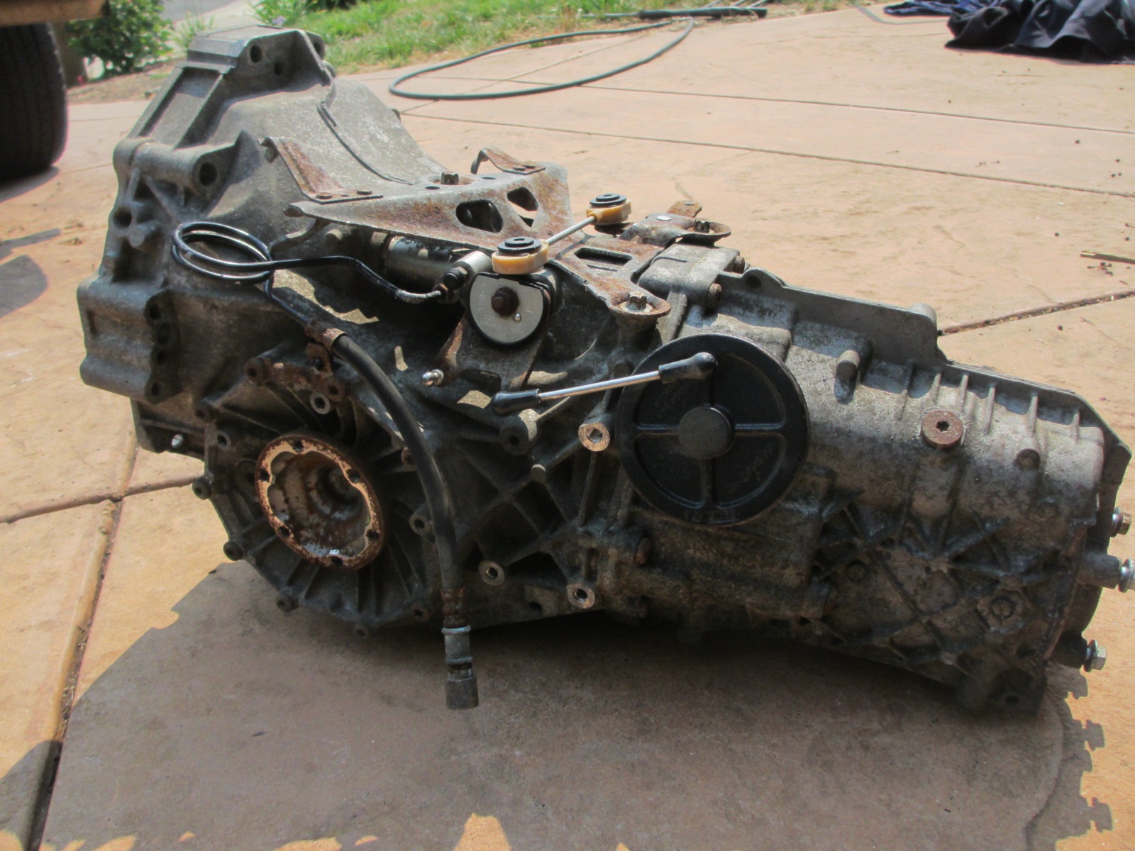

My new transmission showed up today! (IMG:style_emoticons/default/piratenanner.gif) I'm going to clean it up and paint the crusty bits. This is a 2005 Boxster S unit. Other than being ugly, It seems in good shape and I can shift all 6 forward and reverse gears. Everything spins (IMG:style_emoticons/default/smile.gif)
Same Bell housing as my Audi... (IMG:style_emoticons/default/evilgrin.gif)
The 130mm flanges, (Only on the S transmission) work with my 930 CV's but they require 6 bolts... (IMG:style_emoticons/default/smile.gif)

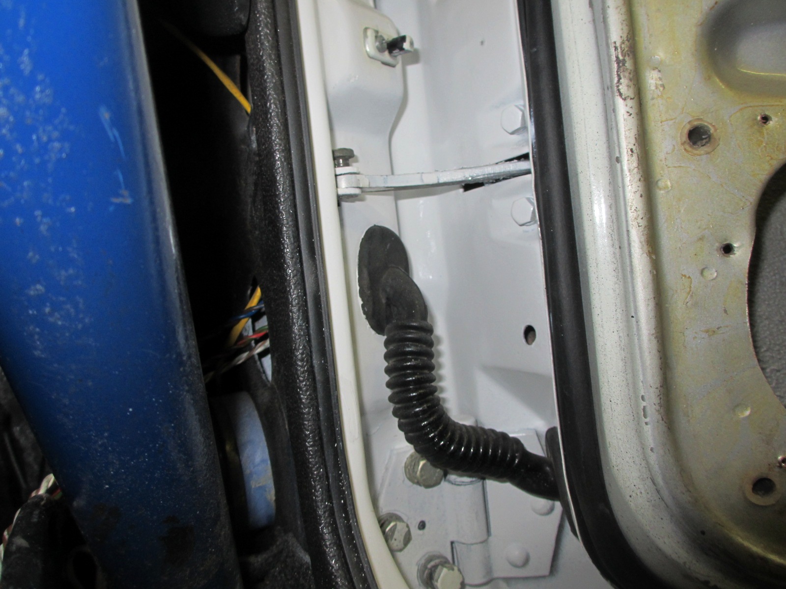

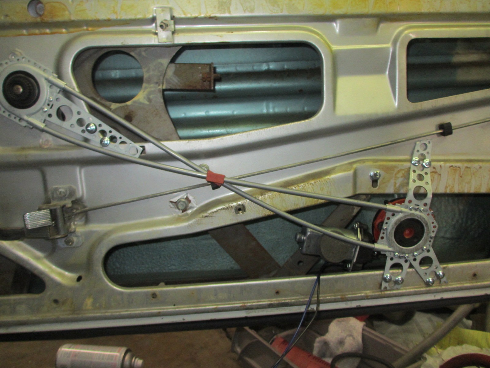

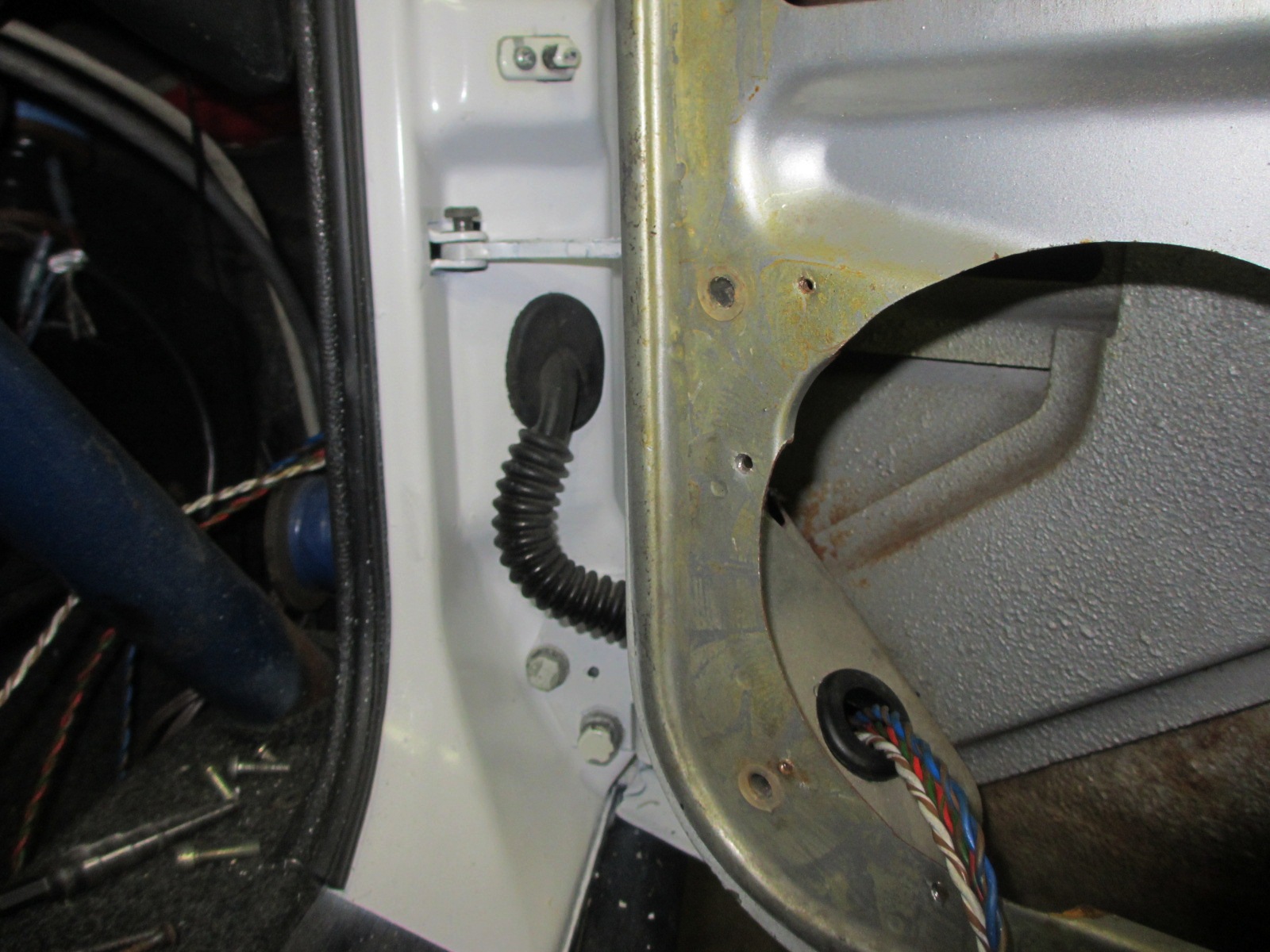

I'm old and lazy so I decided to install a SPAL power window kit. I used to install these regularly and the design hasn't changed. I did have to offset the motor slightly to clear the regulator. Once the panel is in you will never see it. It was always a PITA to use the handle since the roll bar arm bracket is in the way.
So I also decided to do proper door grommets. These are the rear hatch grommets from the donor 2001 Passat Wagon.

I'm doing power windows too Mike! Good call. I ordered door panels and vinyl from 914rubber a while back and asked Mark NOT to cut a hole for the window winder. Can't wait to get them in. How do the SPAL's work? Pretty well?
The SPAL kit is cool for a universal kit. Very easy to install on just about anything.
As for no holes in the panel. It might be possible. I tried to space the regulator back a little. Right at the crank the clearance is very tight between the glass and regulator. Less than a finger width. When I spaced it, the mechanism started the drag and bang as the window went up/down. I ended up just spacing the horizontal track right above the motor. I have late style regulators.
You may need a power regulator from Electro-life http://electric-life.com/ I'm not sure if they have a specific 914 kit but I'm sure something could be modified. Then you would not have a crank at all to worry about.

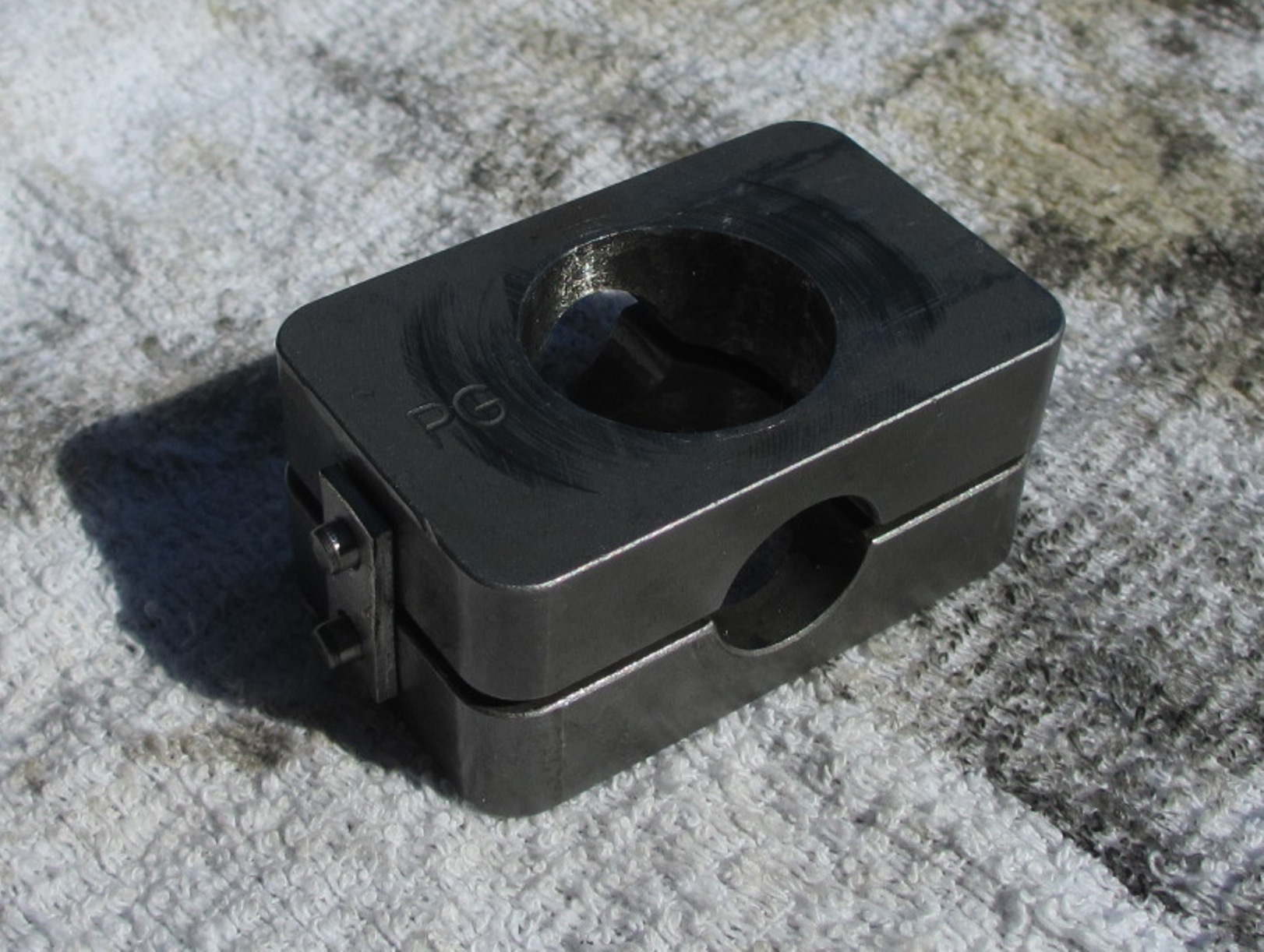

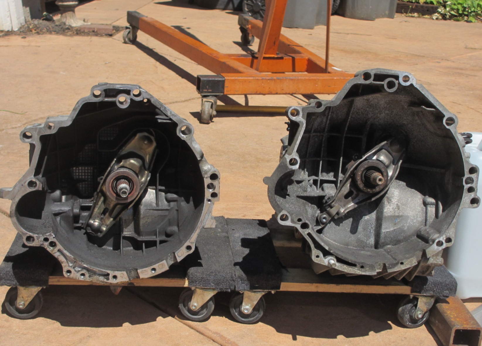

I pulled my 5 speed today. It came out pretty easy without the engine and cradle. I also pulled the Phantom Grip LSD and planted it int the 6 speed. The spider gears are a direct swap, although the 3rd member is bigger in the 6 speed. The whole tranny is a little bigger. I do have to fab rear mounts but that's no big deal.
The bad news: The Boxster tranny does not have the electric speedo drive. I need to rig/fab something to work.

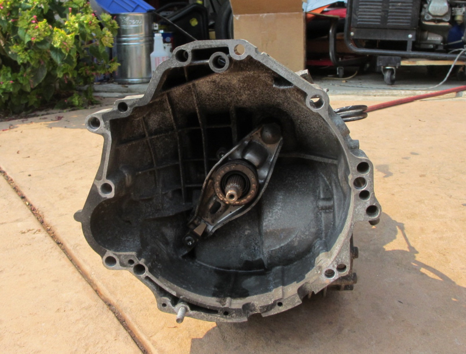

Here is a look at the bell housing area. 5 on left, 6 on right. Notice the 6 has more clearance for a bigger flywheel. Bolt pattern is almost identical. The Audi engine does not use all the bolt holes on the 5 speed. But all the hole I need match up on the 6 speed. BTW, this is a GETRAG Audi 466 transmission.

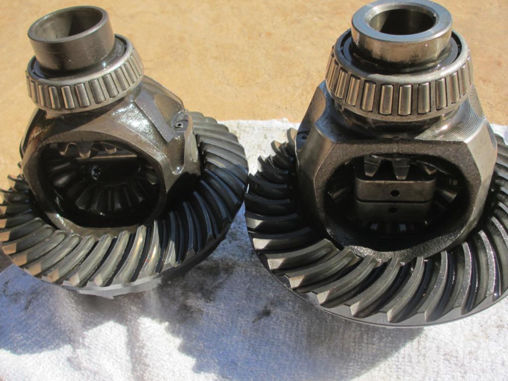

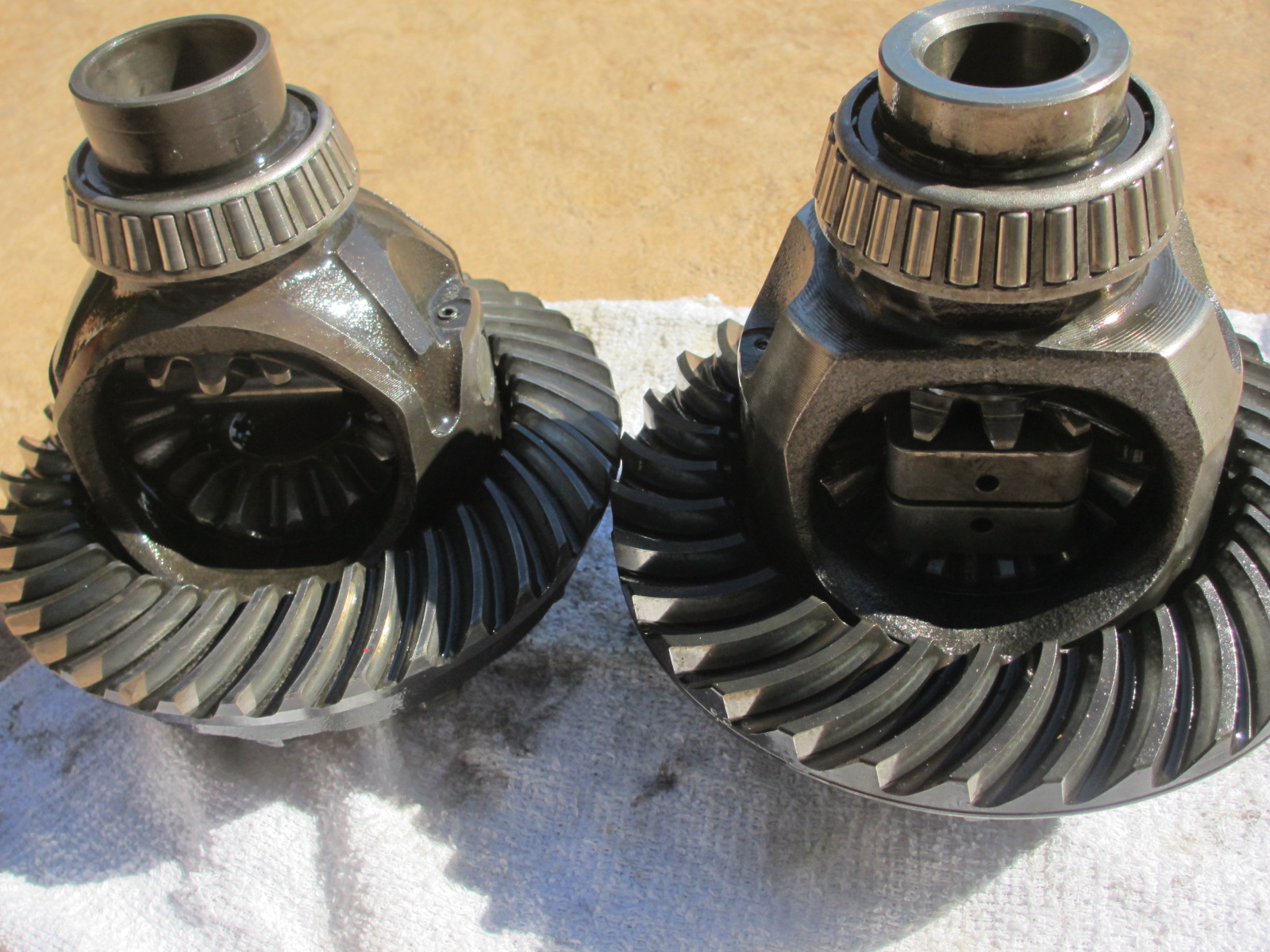

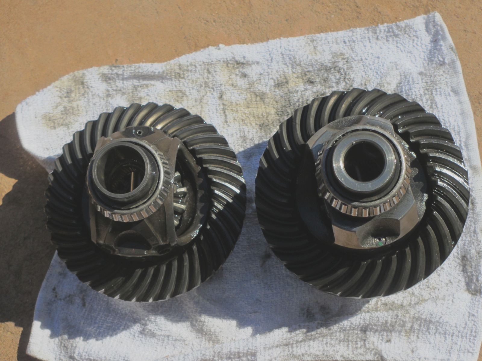

Here are the 2 diffs. 5 on left, 6 on right. The 6 is clearly bigger. I was surprised to see the spiders were interchangeable. So no new machining required.
The PG LSD shows minimal wear. You can see wear marks but you can't feel them.

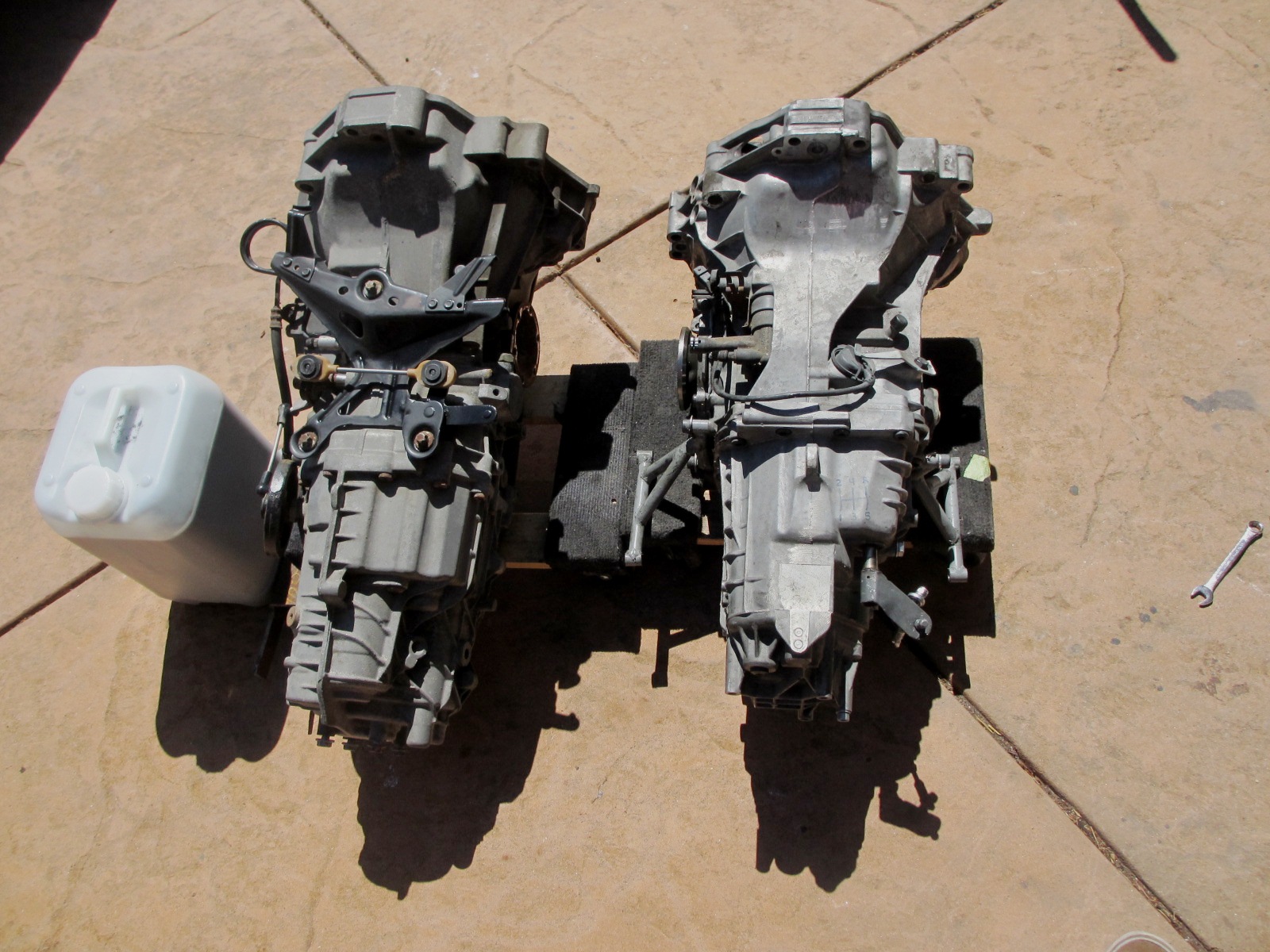

I muscled the tranny into position today. What a PITA! It is longer than the 5 speed and it hits the muffler bracket. I did a quick chop of the bracket to get it mounted. I noticed a small difference with the starter opening. The bolt pattern is the same but it is made for a slightly smaller starter. I need to machine 1/8" from the bell housing. So that means the tranny comes back out. While it's out I will modify the muffler bracket. A couple of the mounting holes I need to use need to be drilled out. I guess the Boxster uses the other holes. Once I get all this dealt with, I will fab mounting brackets for the new tranny.
So It is almost a bolt in swap. I figured it would go like this. At least the thing bolts up to the engine!
