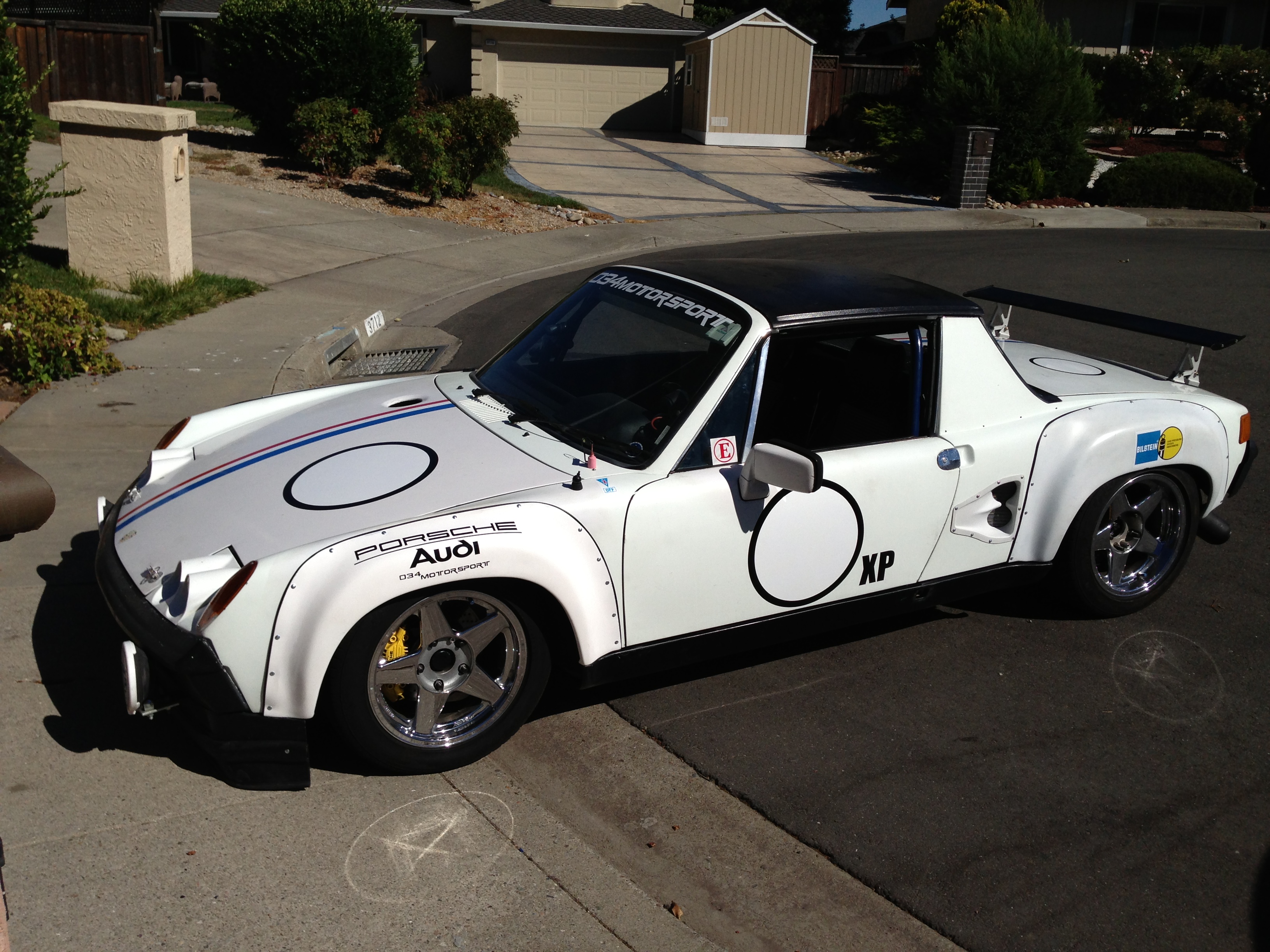

Here is the latest picture of the car. Looks ready for the 9-14 Autocross...

QUOTE(kg6dxn @ Aug 30 2013, 07:26 PM) *
Car looks awesome! Do you know if the wing helps? Have you drove it with it on and off?

QUOTE(tscrihfield @ Aug 30 2013, 09:32 PM) *
I can feel it above 80mph. There is a difference with/without it. But, it's a high speed device. I was passing some cars on the freeway today and suddenly I was doing over 100mph. (IMG:style_emoticons/default/evilgrin.gif) Whoops, I slowed it down. It was the car, not me... (IMG:style_emoticons/default/biggrin.gif)

QUOTE(76-914 @ Aug 31 2013, 04:00 PM) *
Really looks nice. Good job Mike. (IMG:style_emoticons/default/beerchug.gif)
Thank You!
Found my fuel leak. 1/8" NPT fitting on the pressure regulator. It was soooo loose. I can't believe I didn't find it sooner. I can't believe it wasn't leaking sooner. It is a plug where a gauge could be installed.

QUOTE(Cairo94507 @ Sep 1 2013, 06:29 AM) *
Hi Mike- Looking good; I do not recall seeing the GT flares on your car the last time I saw it. Car looks nice and I bet it screams too. Nice work.
Last time you saw it, there were 930 steel flares on the car. As I found out when removing them, they were a shoddy installation on a race car. 3 layers of lap welds and bondo lifting.
I picked up 2 sets of fiberglass flares. One from Brad @ 914ltd with rockers and one set from AIR. I ended up using 3 of Brad's and 1 of AIR (front left) along with Brad's flared rockers. The welting is some 1950's style ebay fender welting product.

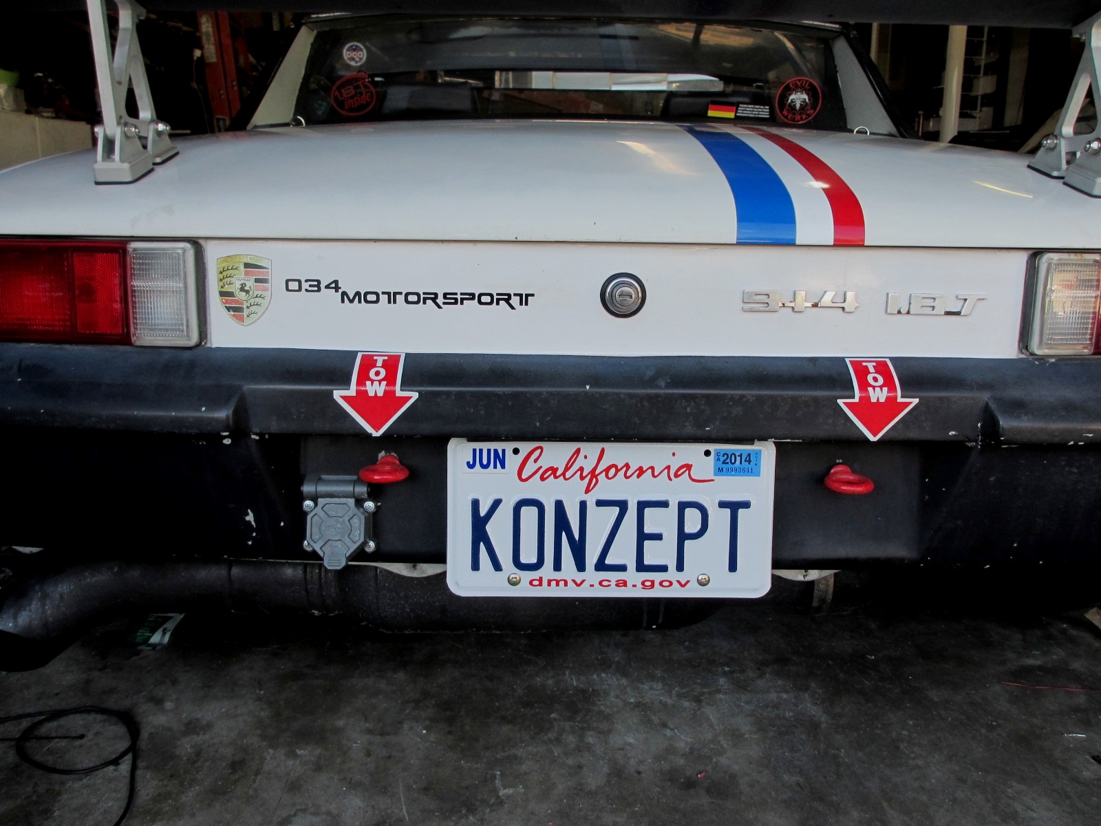

Got my new plate today. I got the idea from a Mercedes Konzept car.
I have released "914 TT" go reserve it now on the CA DMV website... (IMG:style_emoticons/default/smile.gif)
Car is running good but not great. It stumbles rich at WOT. I need to get it in for final dyno tuning at some point. I'm driving it to the 9-14 PCA auto-x (to observe) tomorrow. Got to take it somewhere on 9-14 right? (IMG:style_emoticons/default/beer.gif)
