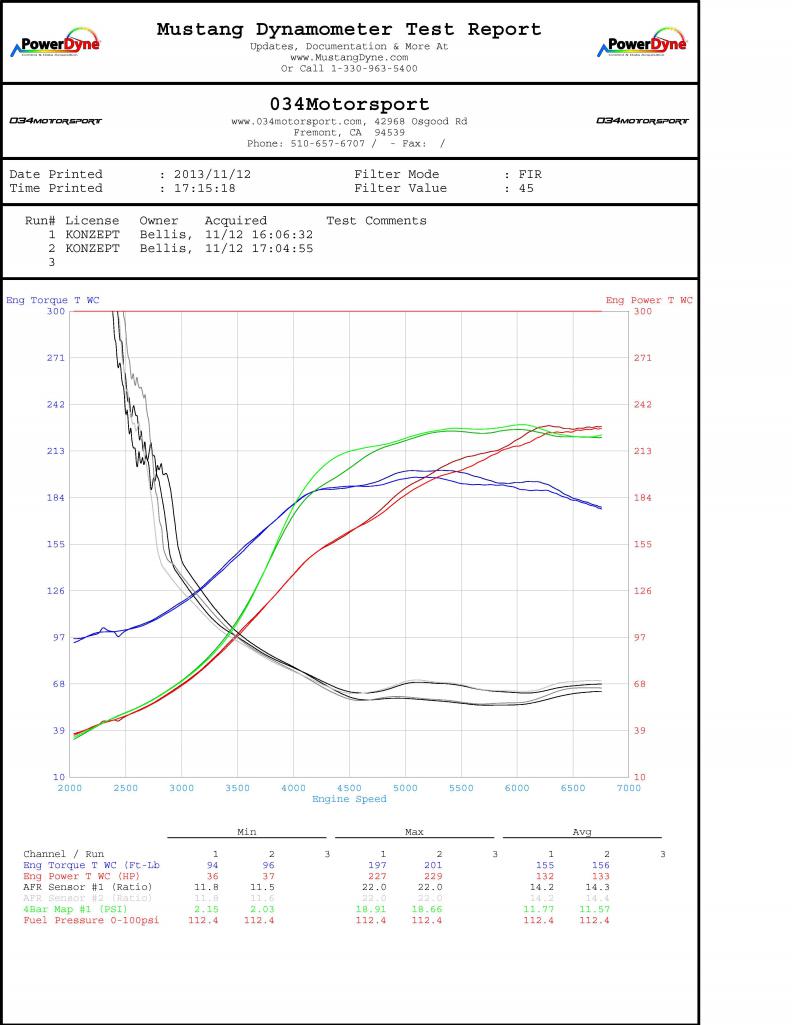

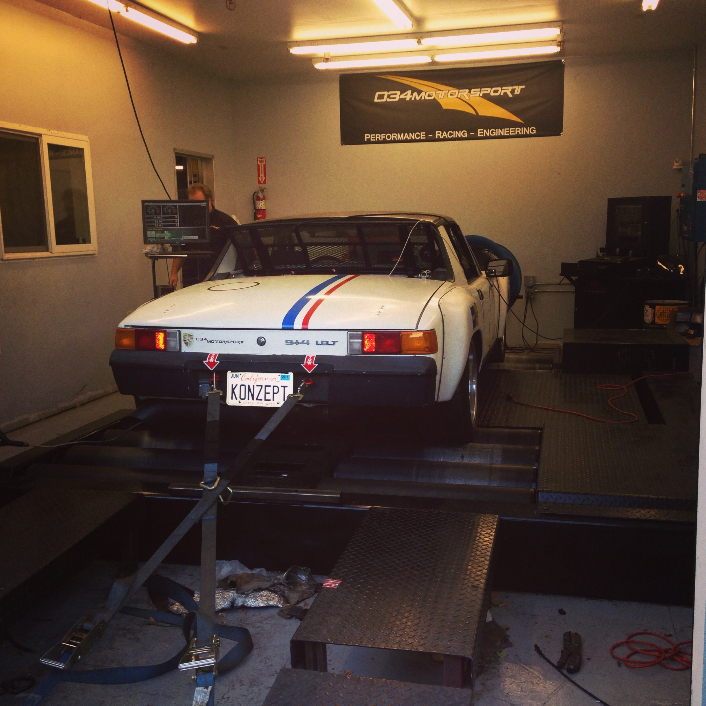

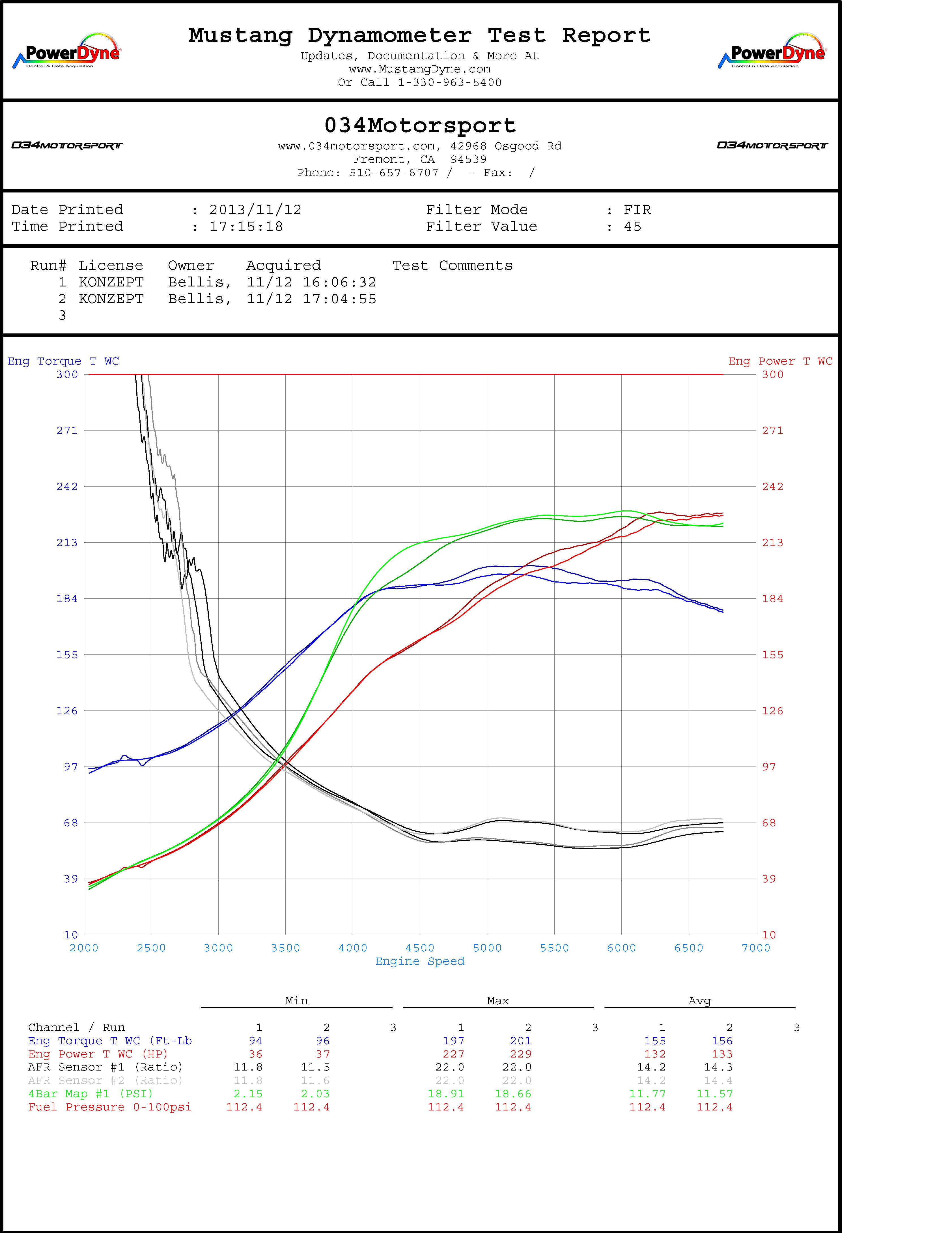

I got there and they said my turbo was falling off so they couldn't tune anymore until it was fixed. So I drove it home with an exhaust leak that got worse and worse. 5 miles into the trip, the Wastegate FELL OFF! (IMG:style_emoticons/default/WTF.gif) 2 bolts backed out and that's why it was load and would not boost higher than 16psi. Duh. Oh well, easy fix. The tuner said he thought is was 90% done before the exhaust leak started. The WG was dragging on the ground after it fell off. Hopefully it's not too damaged.
At 16psi it did 229HP on a 4 wheel drive mustang dyno. Add 15% and that equates to 263HP at the flywheel. Probably more drive line loss since it was turning the front wheels too; maybe 20% or 275HP.
Either way, before the WG fell off... Holy shit! with a major boost leak this car moves!

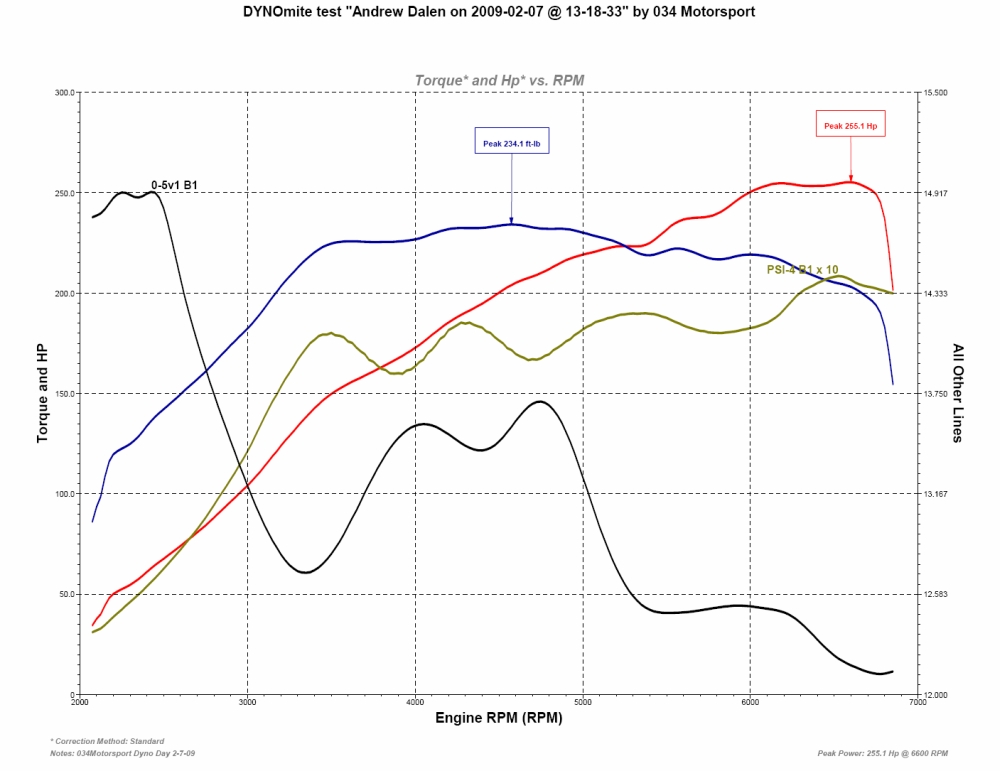

Dyno looks great! For a comparison this is my dyno. I believe the boost controller was set to 19psi and I had 91 + 3 gal of 100 as I was going to crank up the boost but didnt due to my AFR being high.
(IMG:http://www.914world.com/bbs2/uploads_offsite/www.audizine.com-172-1384380811.1.jpg)

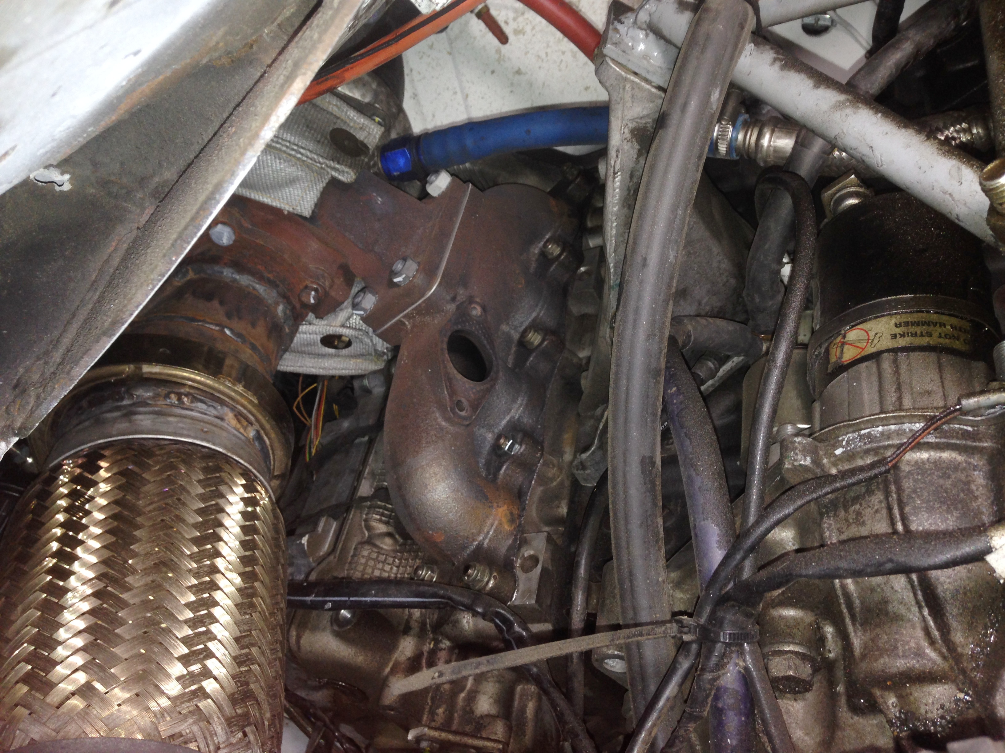

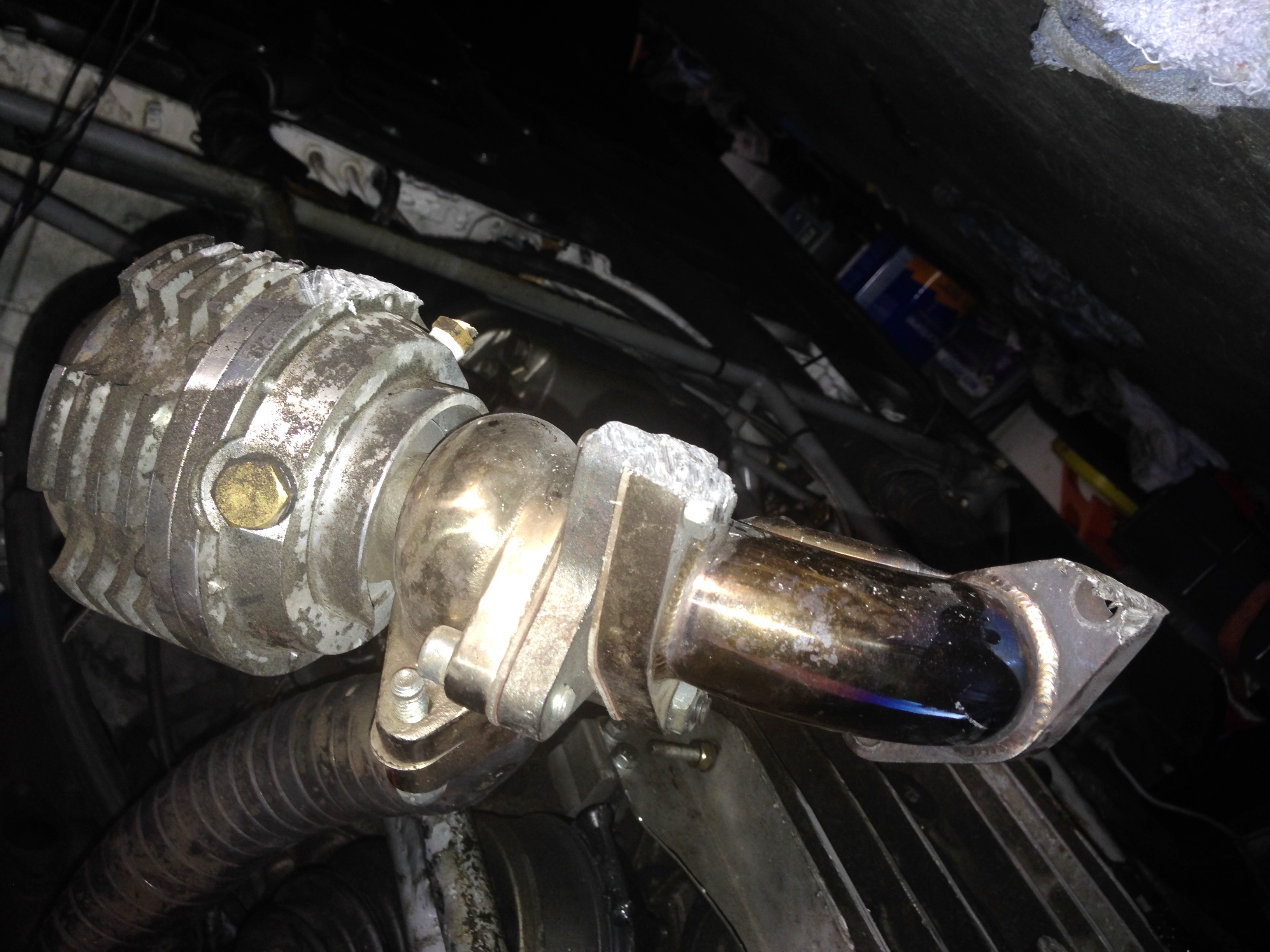

Well there's your problem... There's a hole in the exhaust manifold... No wonder it was loud and not making boost!
Looks like the bolts just backed out. Then it fell and dragged on the roadway. Look at the pic of the wastegate and you can see the self machining that happened. I ordered a new 90° adapter, it took the brunt of the damage. The WG has a little grinding on it so I may replace it too. So far the repair is $29 for the 90° and a couple bolts. Not too bad. I should have it running this weekend!
For the rest of you bean counters, the dyno tune with labor and parts cost me $1200, with $400 of it in parts. They only charged me to install spark plugs once. The first set were non resistor and the ECU went haywire. The second set were colder and resistor which made the ECU behave. I also kept all the old parts removed just in case. In CA the law requires mechanics to turn over parts if the customer requests them.
