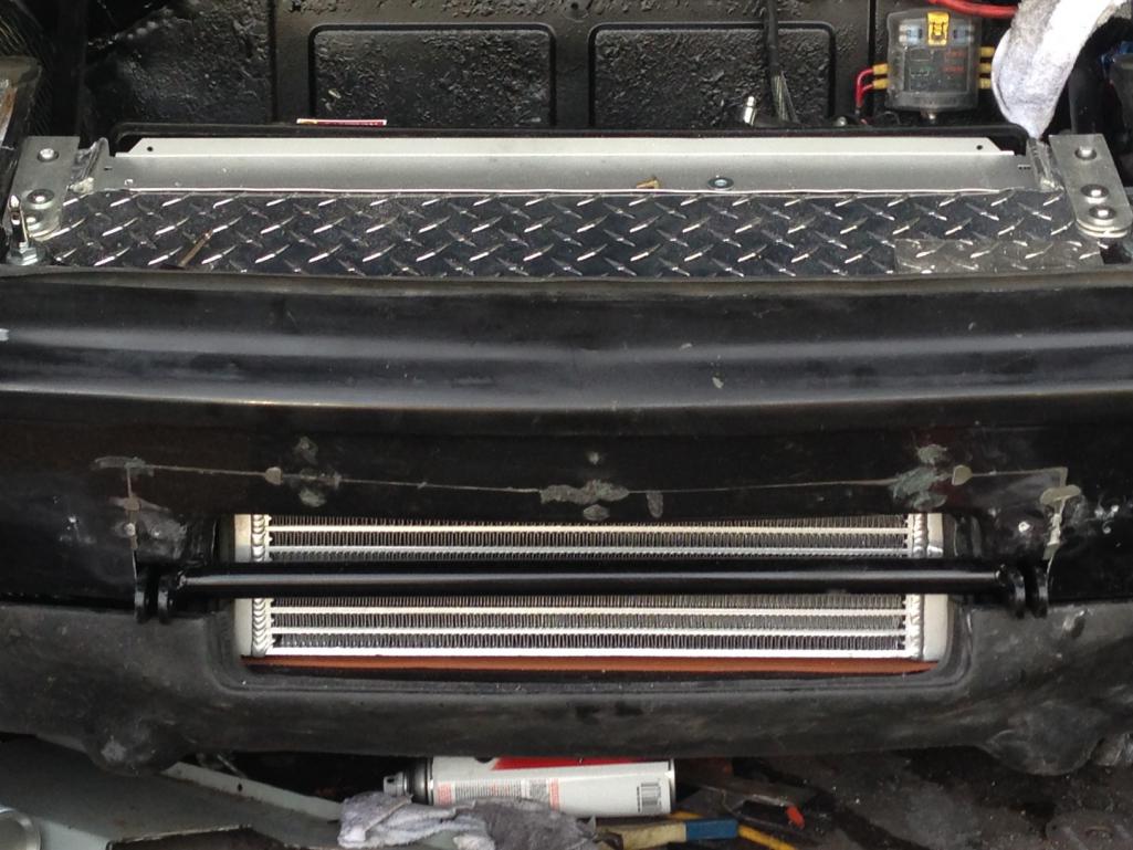

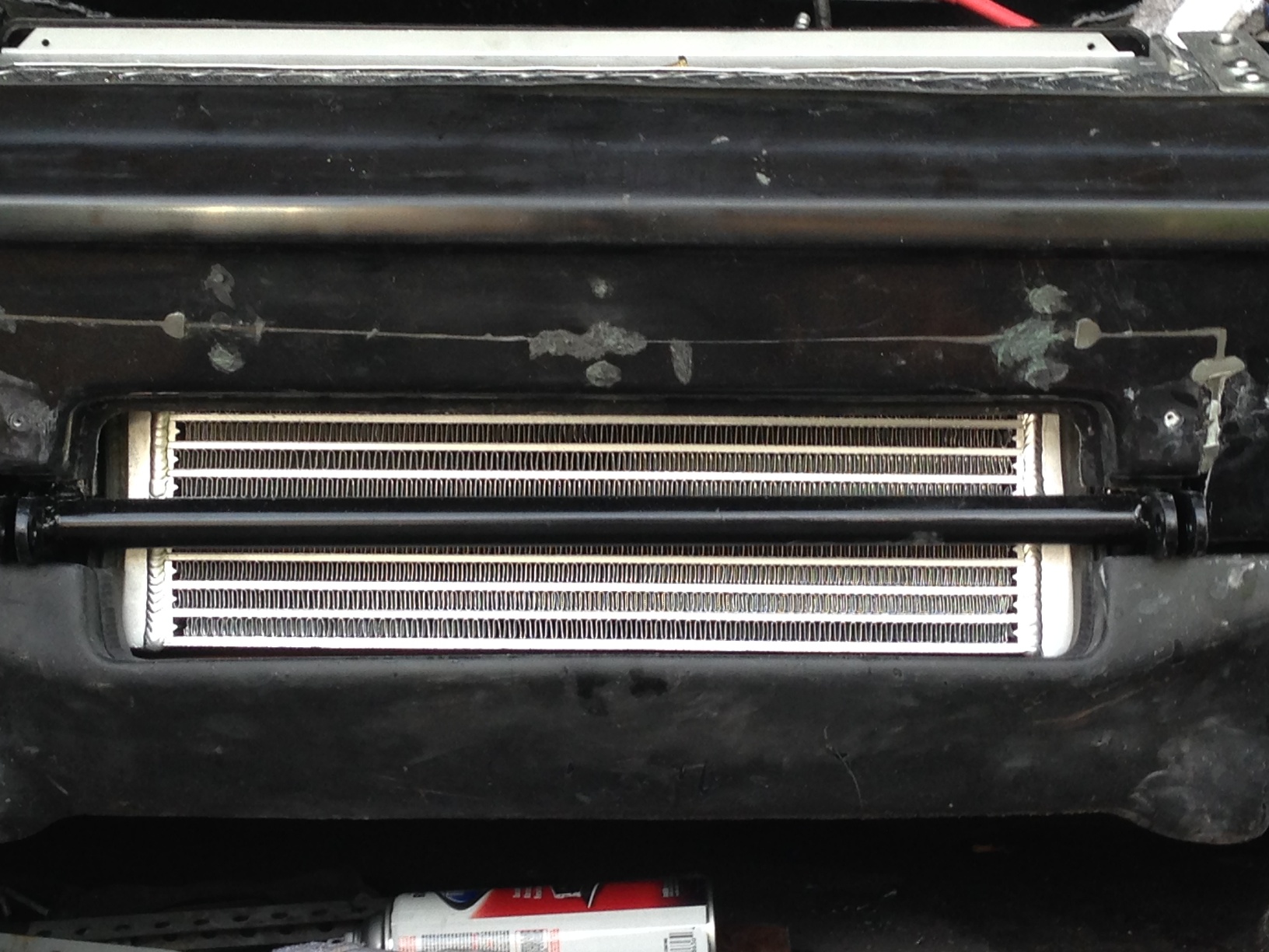

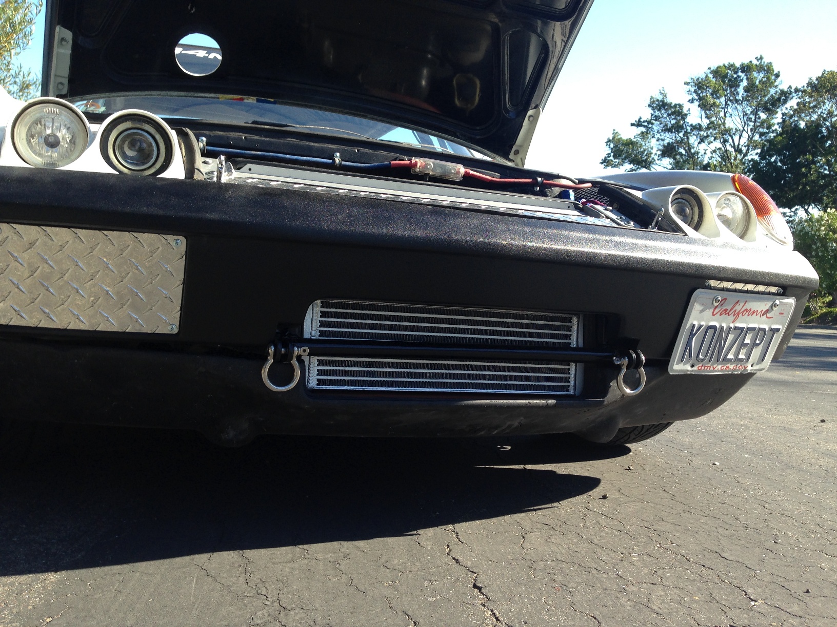

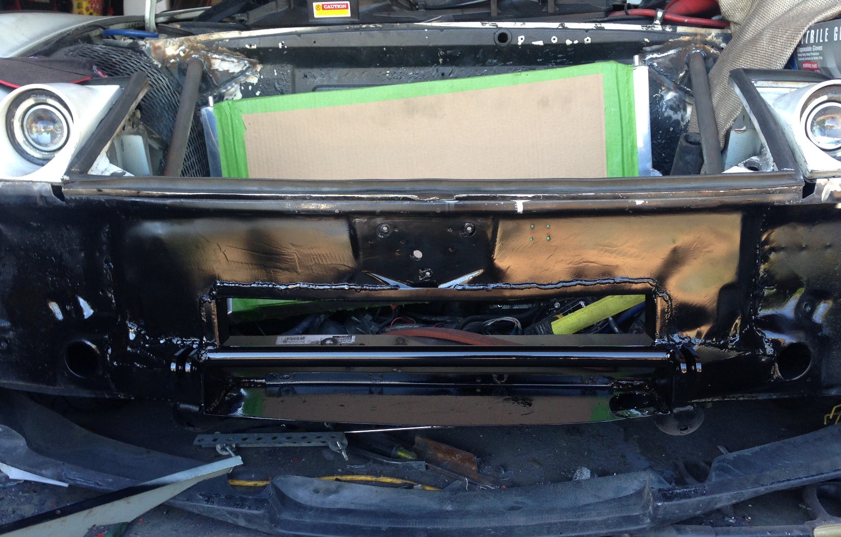

I got the nose finished today. Its hard to see but there is an upper flange to seal the top of the oil cooler. It's setup to use a gasket to seal on the face of the cooler.
I bought a QRS GT bumper today; to cut up. Yes, cut. The GT opening will be raised a little and I need a notch on each side for the tow hitch mounts. I will cut it and re-glass it before painting it black again.
Just finished
After a little satin black

Looks great! Much more clean and civilized than before.
Out of curiosity did you consider eliminating the horizontal bar and just bracing the tabs to the body better?

QUOTE(Andyrew @ Jun 13 2015, 08:52 PM) *
I did. But I wanted to ensure strength. And, I don't trust the body there. It's right about at the bottom of the headlight bucket. Not good structure. Although the DOM tubing from the tower might be enough. At least I now have some structure in front to go with my fiberglass bumper.

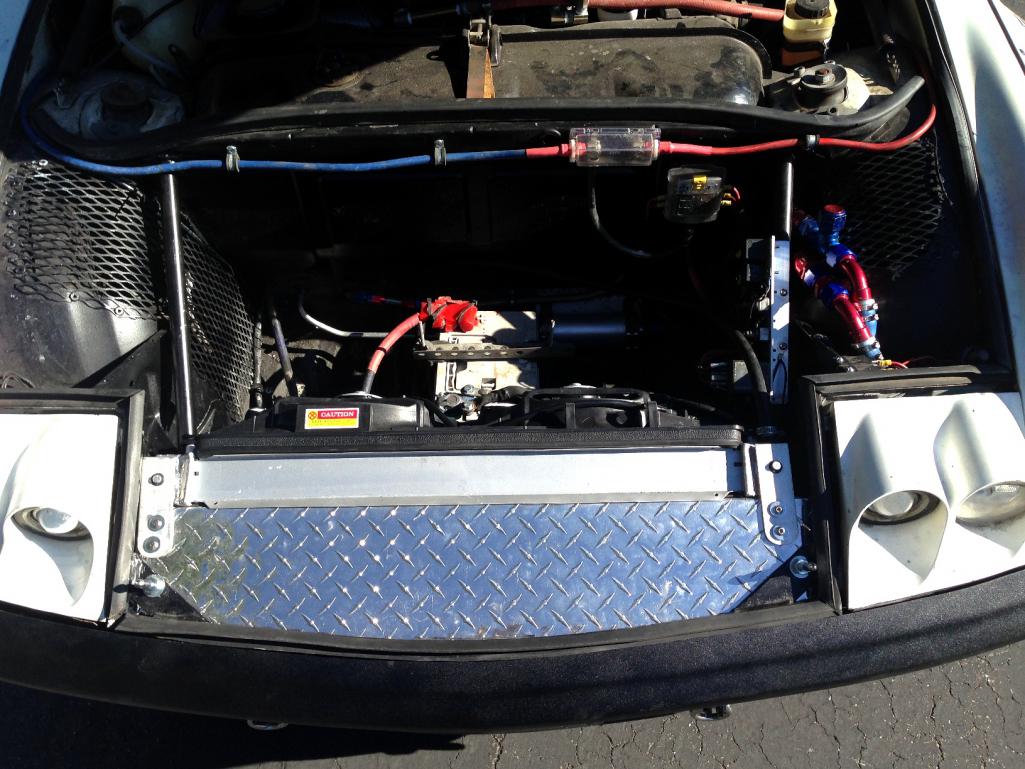

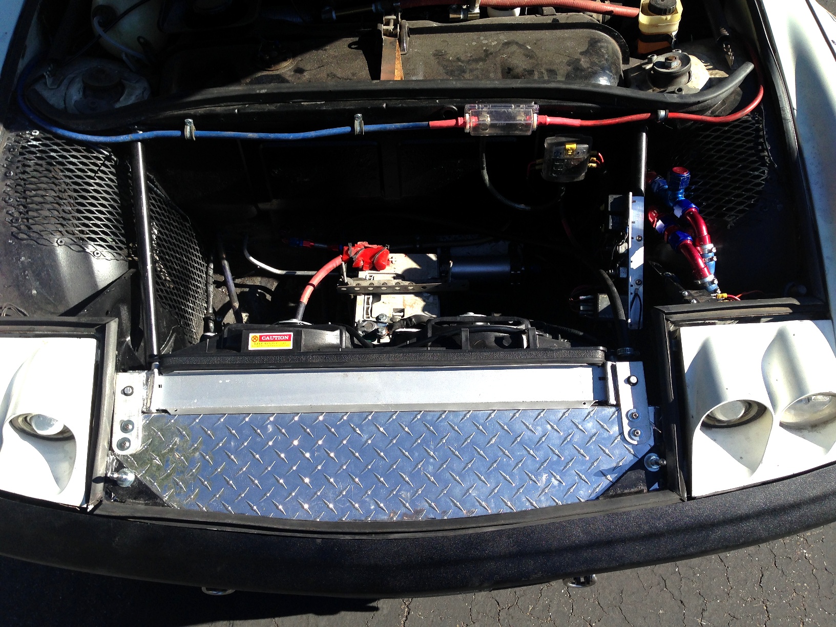

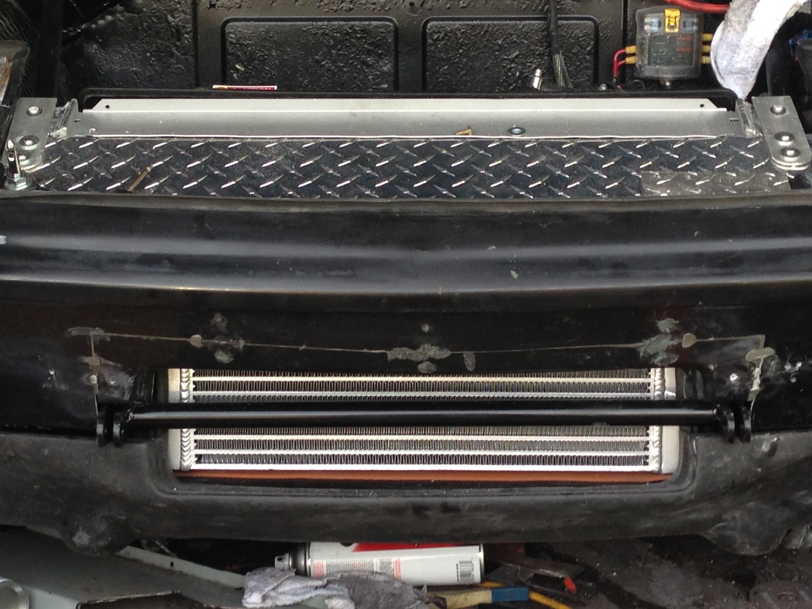

Oil cooler is mounted and plumbed. Radiator is mounted and plumbed. Bumper is cut and modified for a larger cooler size. I used kevlar to glass the section back in. Very solid. Now I need some minor body work and reassembly. I still have to rework some wiring for the fans and thermostatic switch.

Looks great! Fit is very nice to that oil cooler.
I like how you held the radiator in place at the top. Looks like you cut the tabs down as well. How much clearance do you have to the hood?

QUOTE(Andyrew @ Jun 27 2015, 11:20 PM) *
Before I cut them (3/16" or so) the tab would just touch the bottom of the hood rib. Pushing on the hood, I was able to make the smallest mark. I may have been able to leave them long but I was worried about hearing a random tapping noise.
I'll take better pics one I get out of the garage. I'm pretty happy with the overall fit & finish. I need to figure out where I want the fan controls. before it was hidden in the shroud. Now they won't fit there.
The oil cooler lines were a bitch because they are -12. Bend radius sucks. I had to make a little more space between the headlight bucket and the inner fender well. I massaged it for oil line clearance.

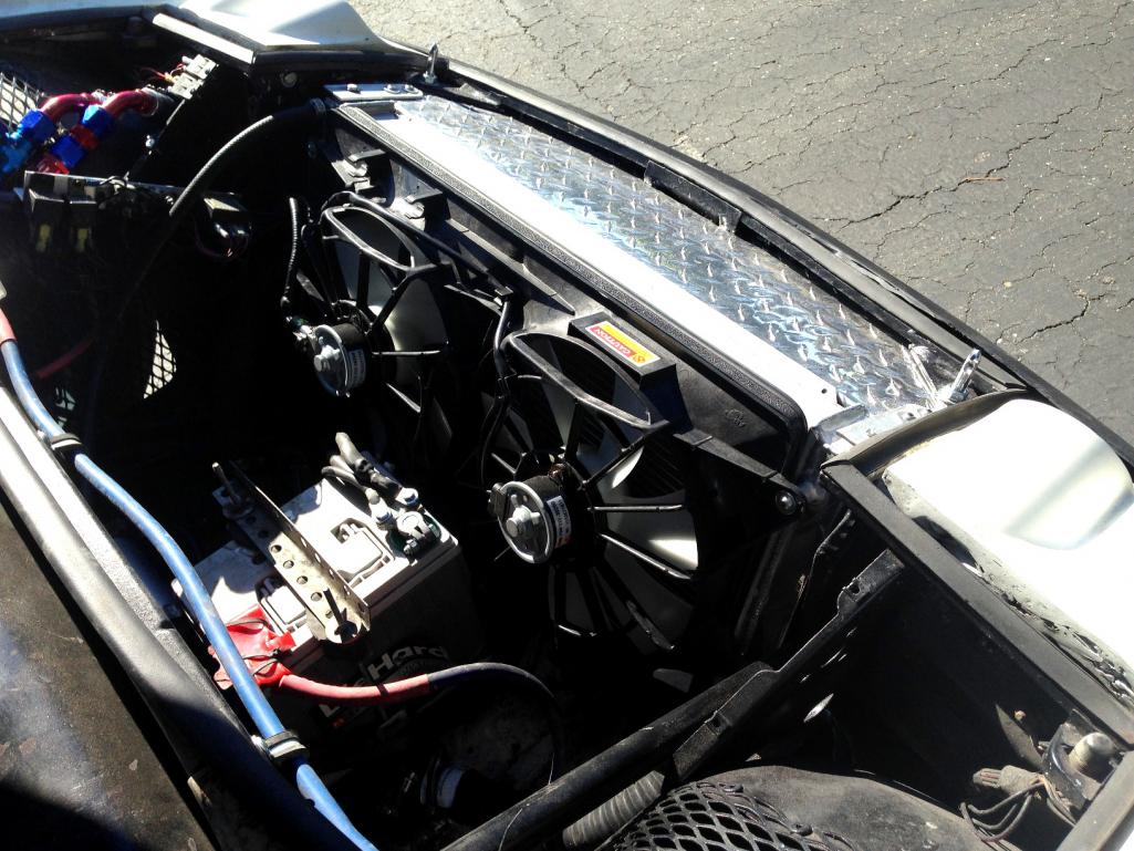

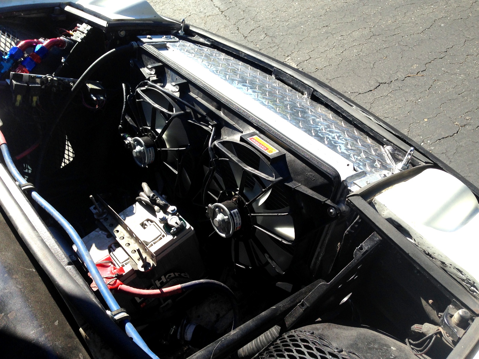

Radiator is done. The factory fan shroud needed a gasket. I borrowed the rear trunk main gasket and it's a perfect fit. I ordered a new replacement from 914 Rubber.
The car runs great! It warms up faster and stays at 190°. The fans pull a ton of air. With the fans running, there is enough air through the oil cooler to hold one of my shop rags from suction. I'm very happy with the outcome.
Here are some pics of the final setup.
Now the bad news... On my third test drive today, I blew the coolant hose at the engine bay, right where it turns up toward the motor. Time to order some green stripe...

Great job on the radiator and cooling fans.
Are you worried about a small rock puncturing the radiator at all? Are you going to put any type of screen over the opening to protect the radiator?

QUOTE(Cairo94507 @ Jul 4 2015, 06:11 AM) *
Given how low our cars are and the amount of stuff on the roads these days......
I've considered it but not sure how I want to execute it.
