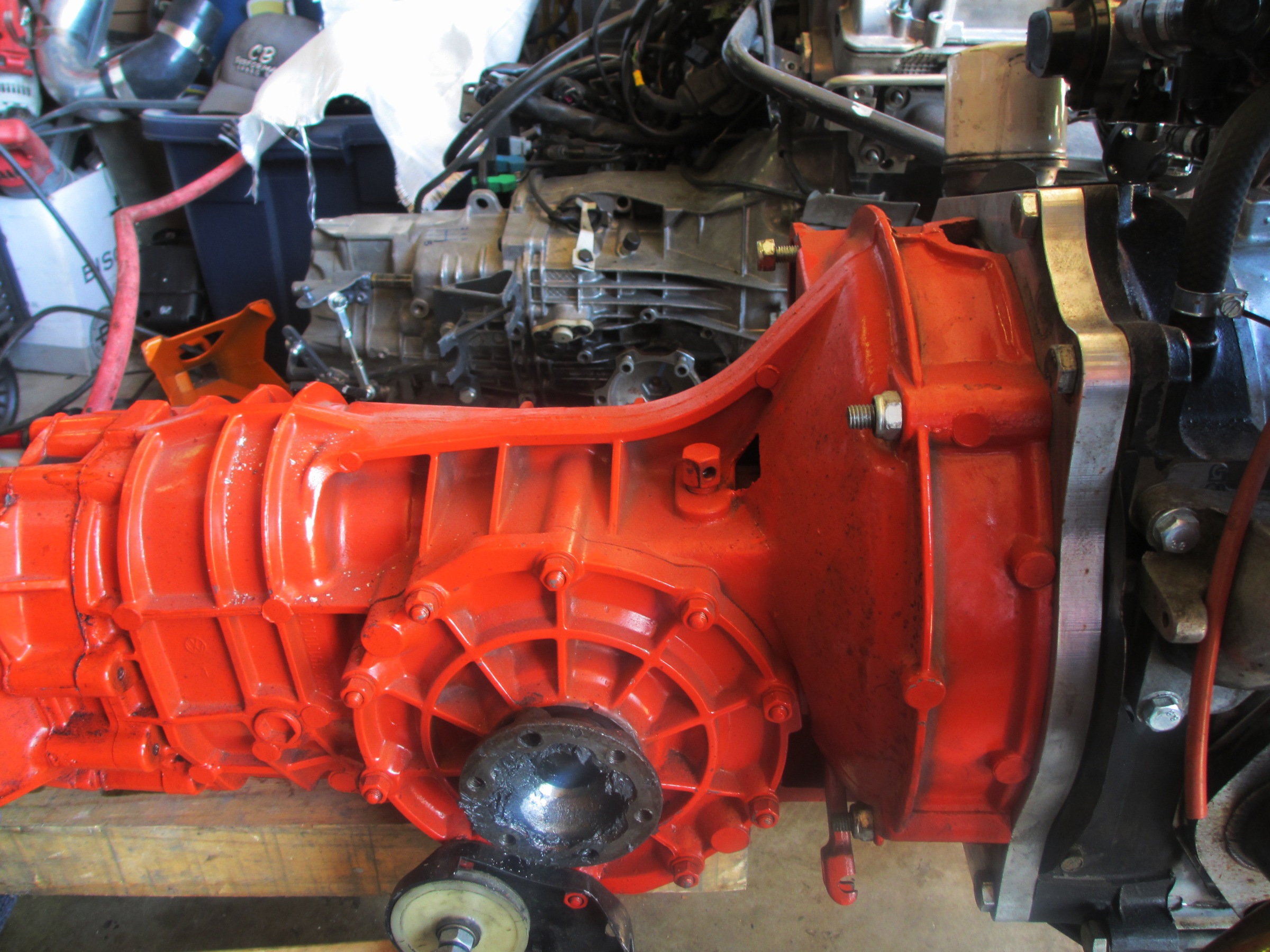

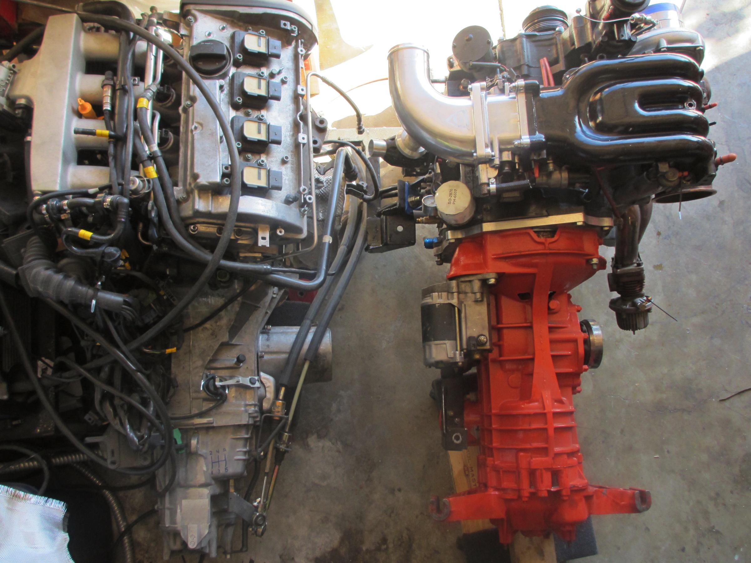

Here is the challenge. The transaxle. Either I fab an adapter, Fab an axle to take 1 Porsche CV and 1 Audi/VW CV or Replace with Boxster tranny, that will: Bolt right on, Shifter is cheap and available and requires less fab time. I'm leaning to the Boxster due to the 100mm Porsche CV flange. The Audi is 114mm.

andys   I believe you can swap out the tripoid transaxle f...   Jun 10 2012, 06:11 PM

Chris Scott   Mike, Check to see about poping out the drive flan...   Jun 10 2012, 11:04 PM

andys   Here's a photo of an 012 trans with the flange...   Jun 11 2012, 11:06 AM
smj   Here's a photo of an 012 trans with the flang...   Jun 11 2012, 12:29 PM
kg6dxn   Here's a photo of an 012 trans with the flan...   Jun 11 2012, 09:26 PM
kg6dxn   If the flanges are held in with a circlip, they lo...   Jun 11 2012, 09:29 PM
Justinp71   Mike you do have ADD, ha! Your 914 is like a d...   Jun 11 2012, 10:58 PM
Chris Scott   Mike, If i remember correctly the drive flanges ju...   Jun 11 2012, 11:15 PM
kg6dxn   Mike, If i remember correctly the drive flanges j...   Jun 11 2012, 11:22 PM
Chris Scott   That is what I remember   Jun 12 2012, 12:03 AM

jcd914   Anybody ever pulled the axle flange on a Boxster ...   Jun 16 2012, 01:36 AM

kg6dxn   Got the flanges out. Just the the VW manual said t...   Jun 16 2012, 07:20 PM
kg6dxn   Been taking it slow on the conversion. Here's ...   Aug 11 2012, 09:17 PM

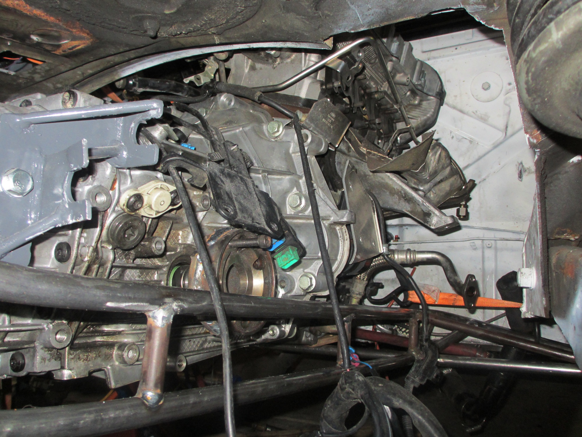

kg6dxn   Pulled the drive train today. Kind of depressing s...   Sep 22 2012, 08:33 PM
Andyrew   Mike, What have you decided for the axle solutio...   Sep 22 2012, 09:00 PM
kg6dxn   Mike, What have you decided for the axle soluti...   Sep 22 2012, 09:02 PM
Andyrew   BTW I see some emission stuff still on your new en...   Sep 22 2012, 09:02 PM
kg6dxn   BTW I see some emission stuff still on your new e...   Sep 22 2012, 09:36 PM
Andyrew   sway away custom axles? So 914 outer cv and boxste...   Sep 22 2012, 09:10 PM

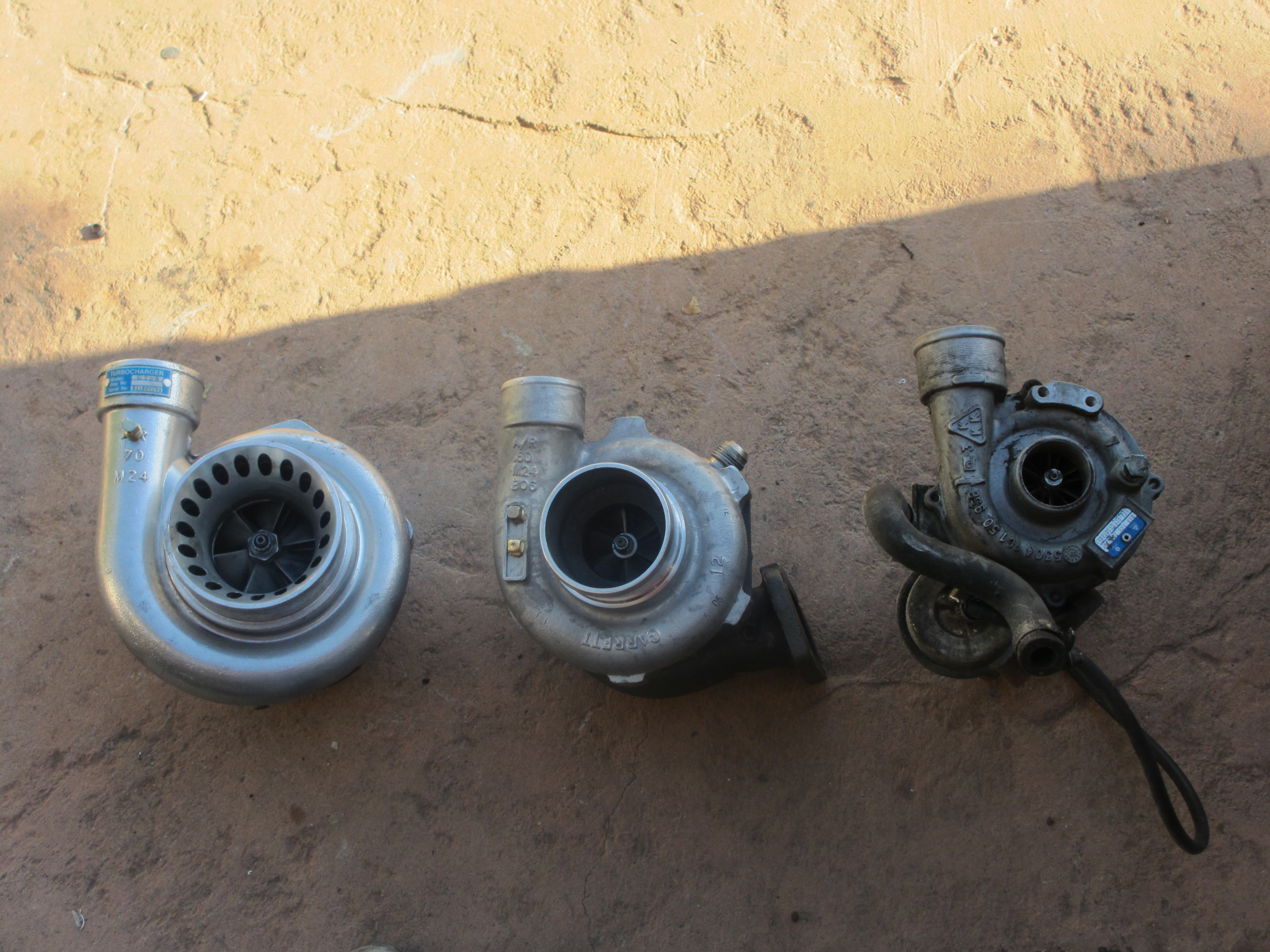

kg6dxn   Just for fun... Picture of my 3 turbos... Big diff...   Sep 23 2012, 07:08 PM

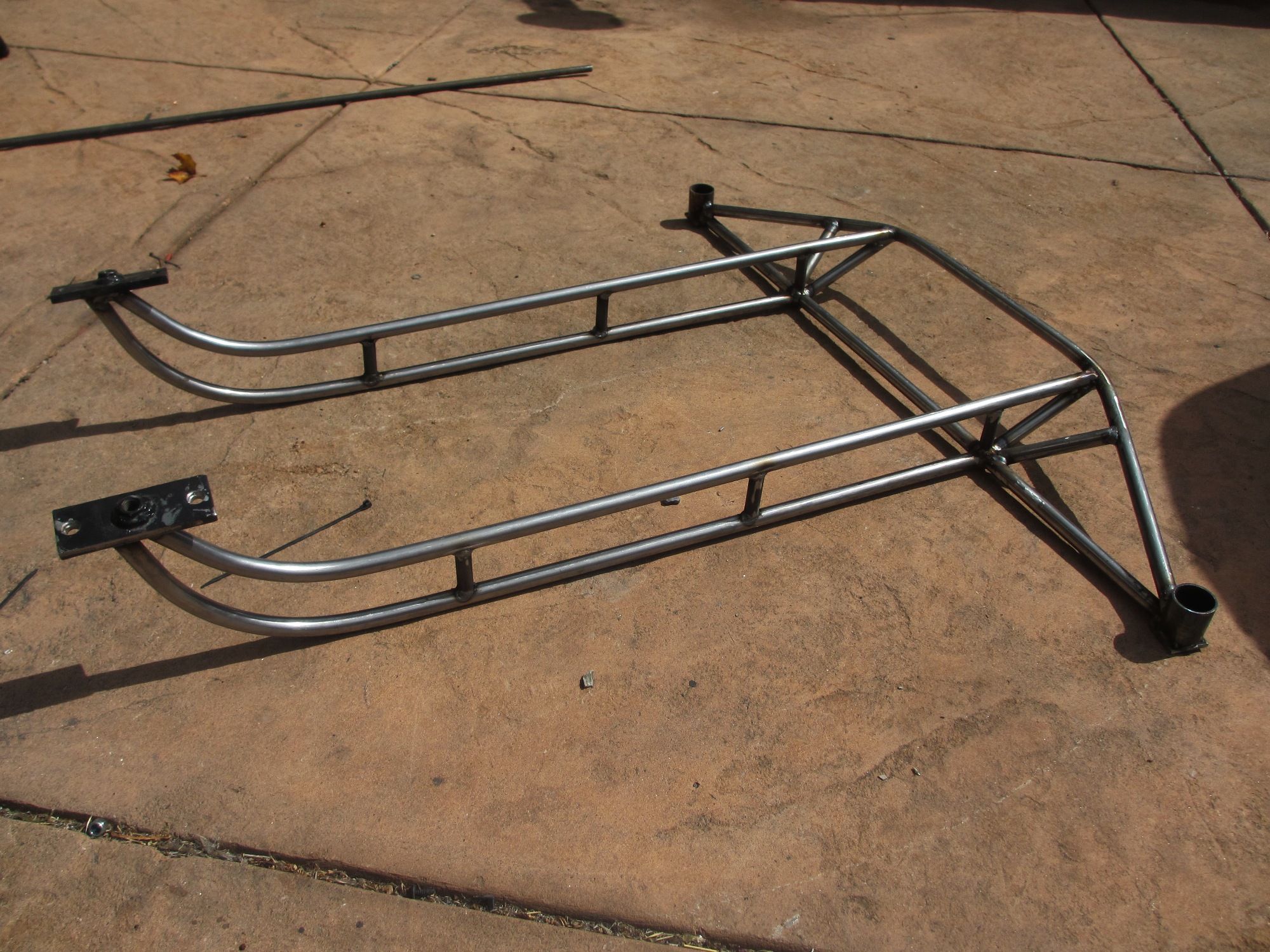

kg6dxn   Got the cradle fabbed up. still needs some bracing...   Oct 6 2012, 09:44 PM

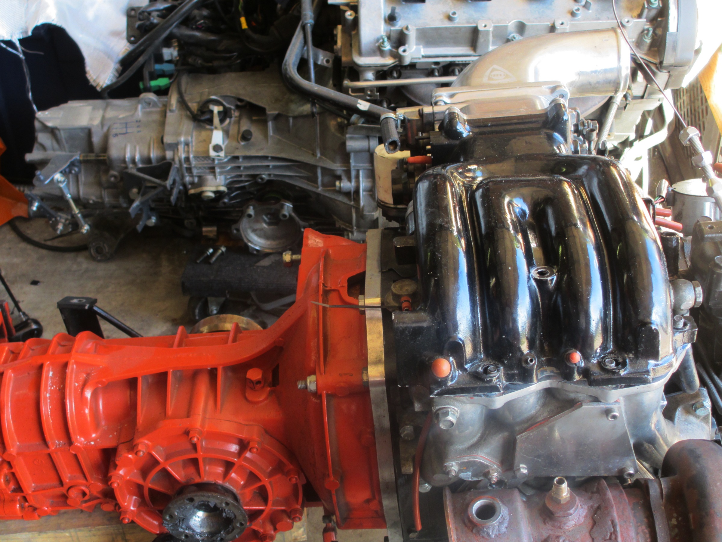

kg6dxn   Here she is in all her glory. Engine mounted to th...   Oct 13 2012, 07:01 PM
kg6dxn   The cool thing about the OBX (don't laugh) int...   Oct 13 2012, 07:10 PM
