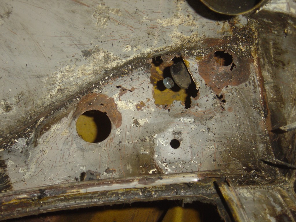

QUOTE(mepstein @ Aug 9 2012, 09:29 AM) *
Cool shots. Did you figure out how the orange got there?
Yeah the rear has definitely been clipped. I will have some reworking to do back there. the job was good, but not great. In addition, 3 of the 4 quarters were also replaced. Both fronts and the left rear. Only the right rear was original. By the looks of things I'm fairly certain this was done a long time ago using factory panels except for the trunk, which interestingly enough was actually a trunk from another 6 (IMG:style_emoticons/default/ohmy.gif)

QUOTE(scotty b @ Aug 9 2012, 01:39 PM) *
Back then cutting up a 6 was probably no big deal. Nice that it matches.

QUOTE(mepstein @ Aug 9 2012, 10:30 AM) *
(IMG:style_emoticons/default/agree.gif) It'd be interesting to know if that other 6 is still out there somewhere (IMG:style_emoticons/default/idea.gif)

A quick update since I am here. I have been cleaning up the last fender well today ( right rear) and have uncoverd orange paint on it, so it would apear this 1/4 panel came from the same car the trunk did. Pics later (IMG:style_emoticons/default/shades.gif)

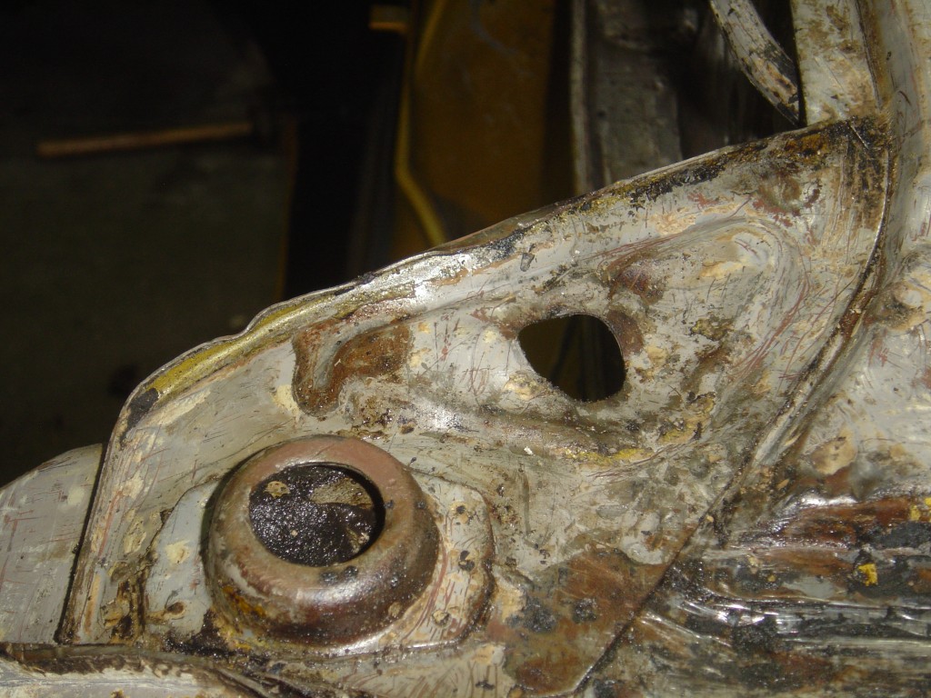

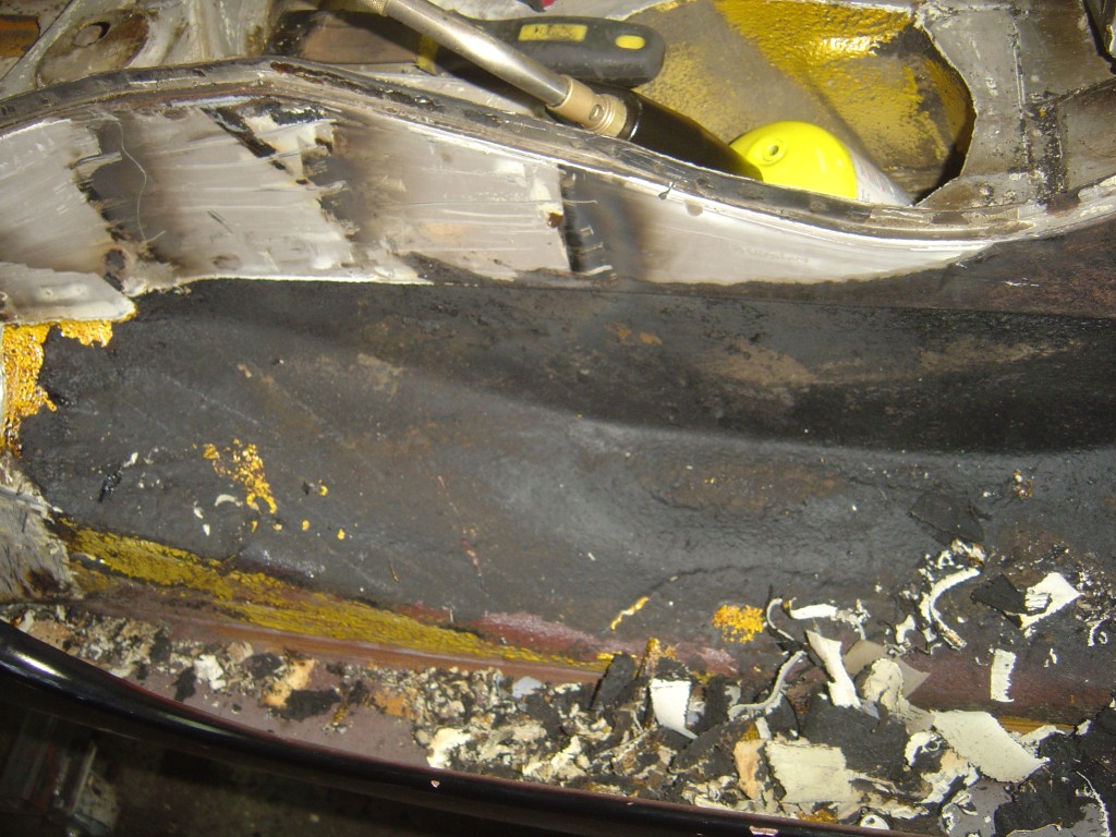

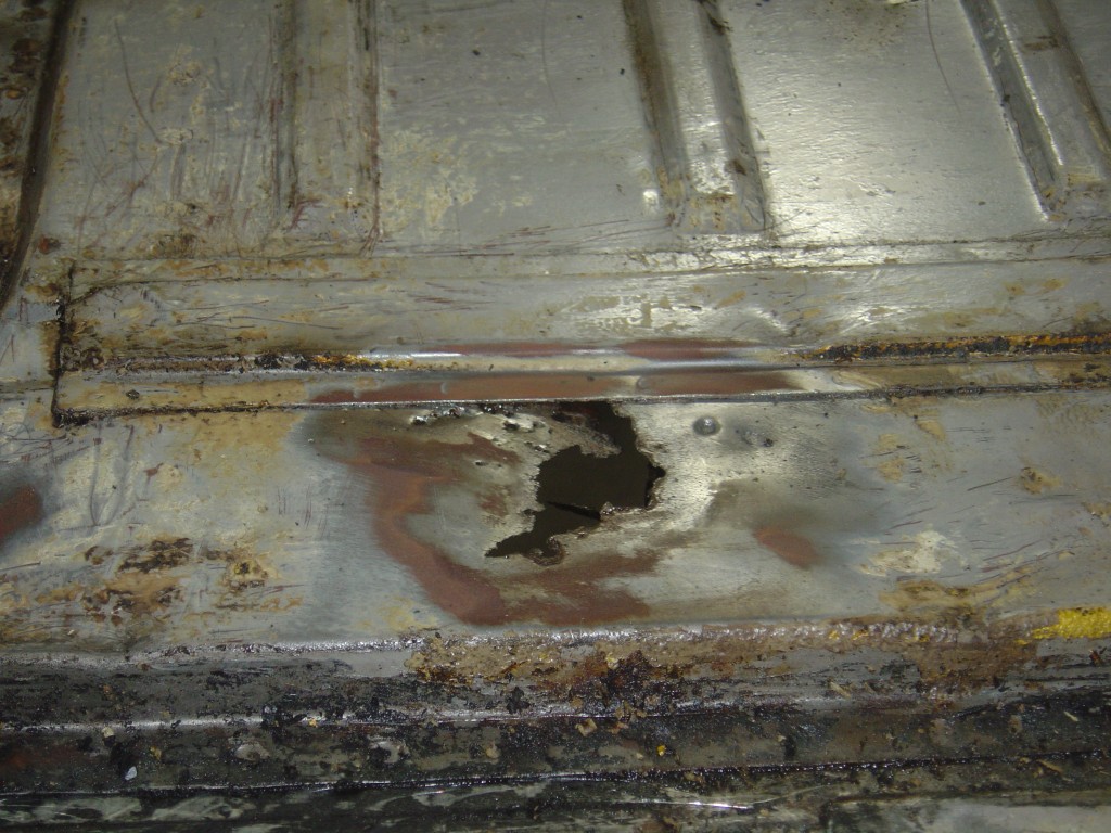

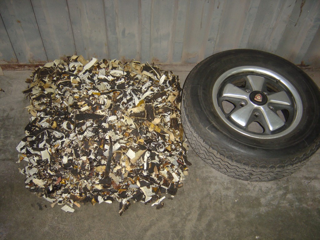

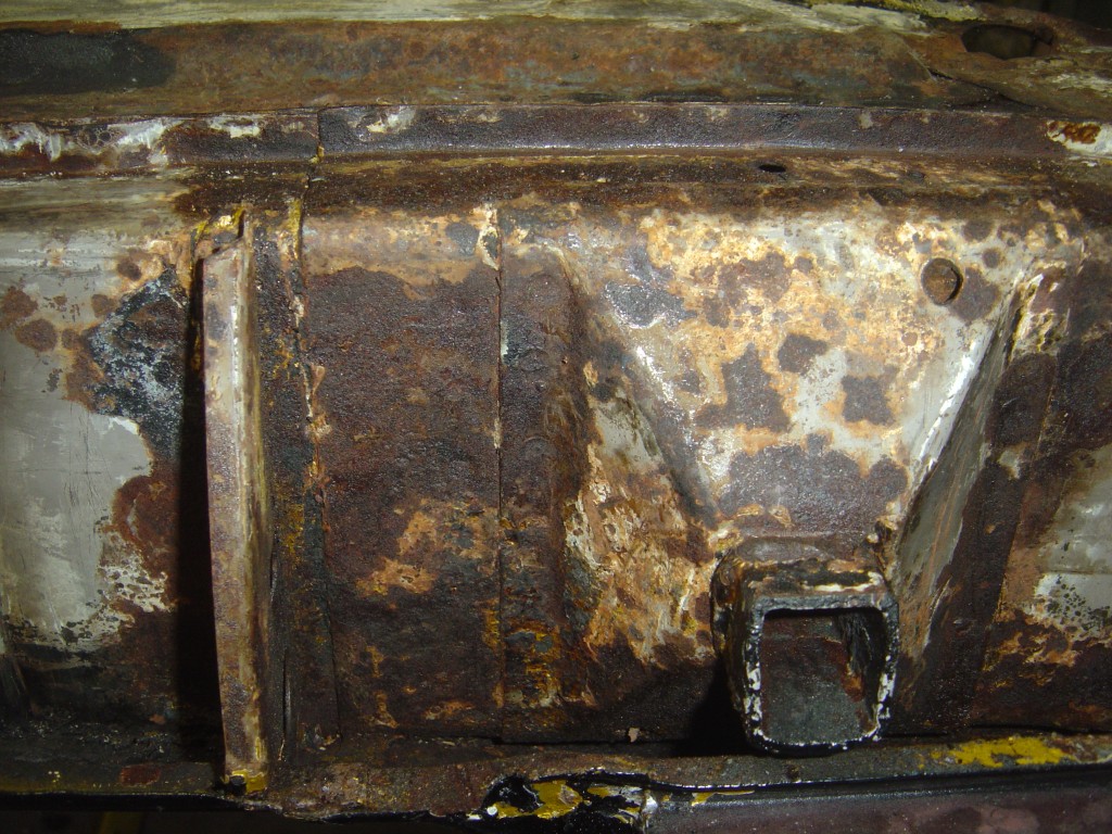

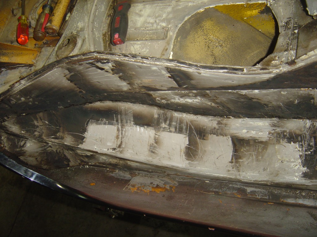

Last wheel well and rockers are done (IMG:style_emoticons/default/smile.gif) I'm going to box up the undercoating and weigh it just for S & giggles (IMG:style_emoticons/default/rolleyes.gif) Jack triangles will be replaced I will probably also cut off the jack point on the pass side as it is prettt crusty and I'd like to make certain the long behind it is o.k. I find it interestign how the rustiest areas on the car so far are where they got soaked with oil from the coolant lines (IMG:style_emoticons/default/confused24.gif)

If the lines were always weaping oil, maybe the PO was always hitting that section with detergent and water to try to keep clean?

25 pounds??????

12?
