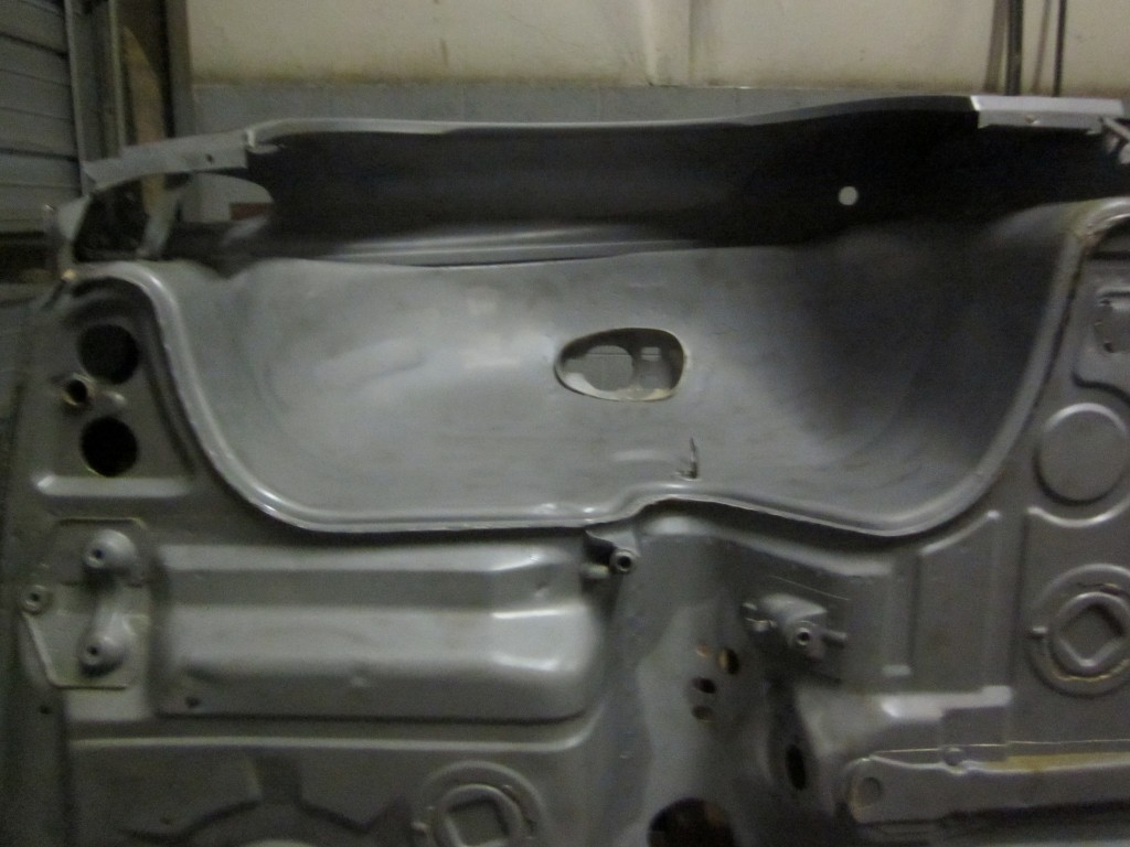

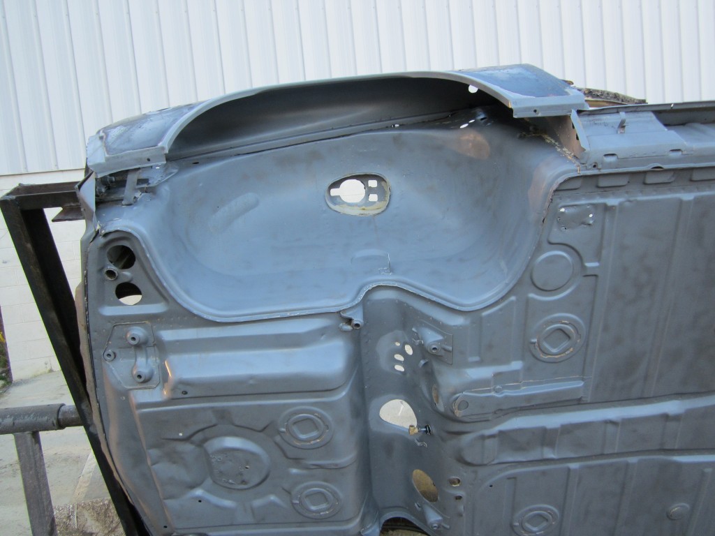

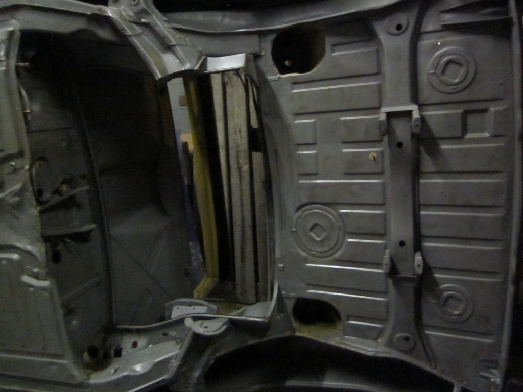

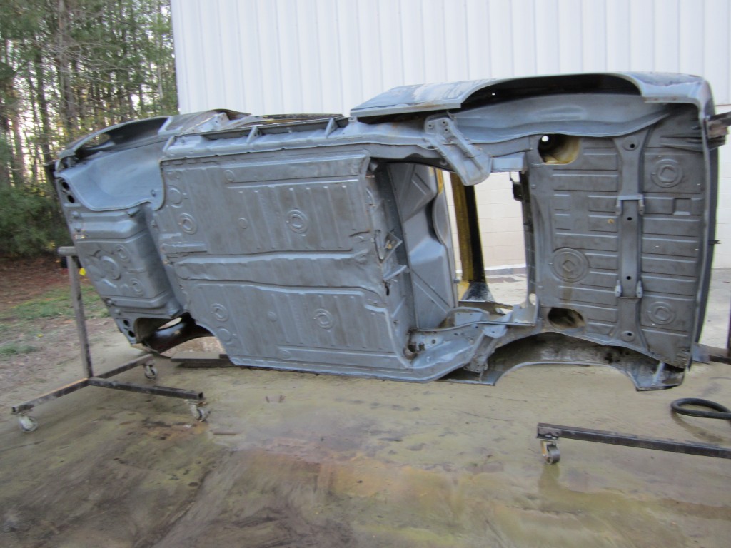

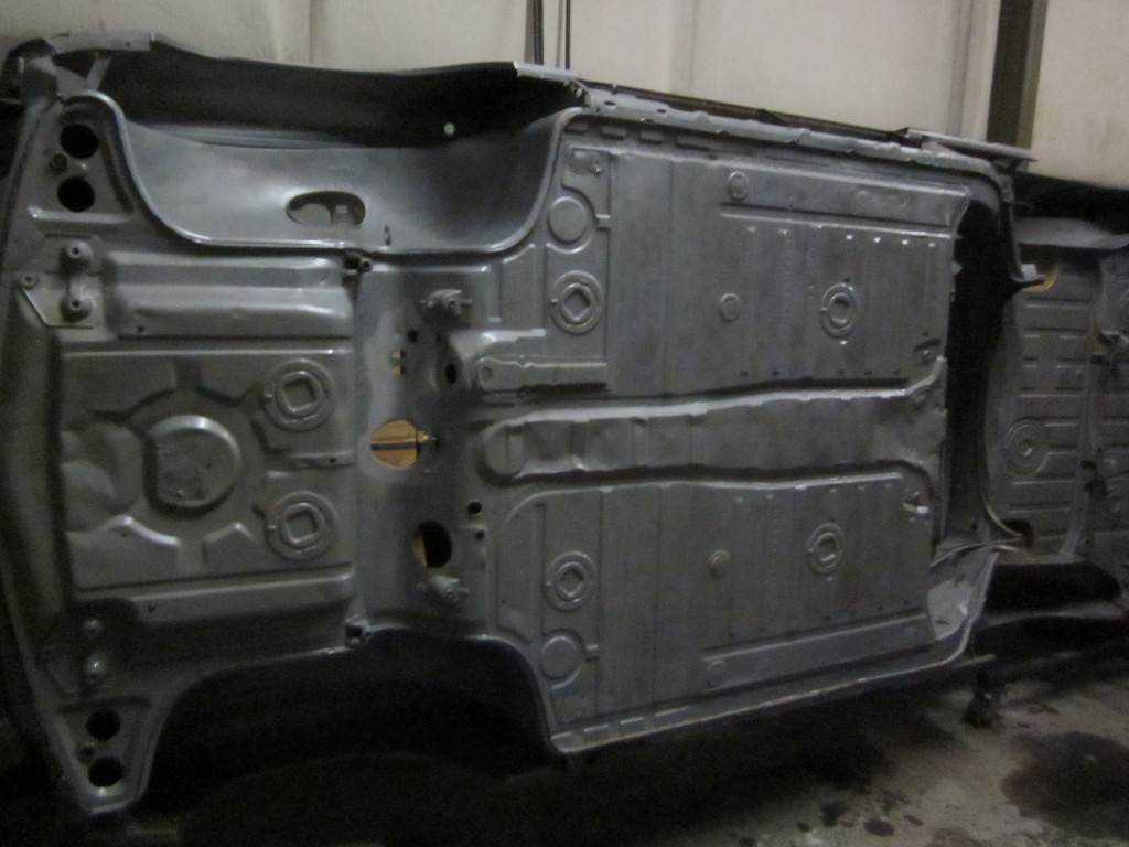

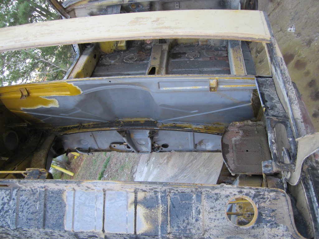

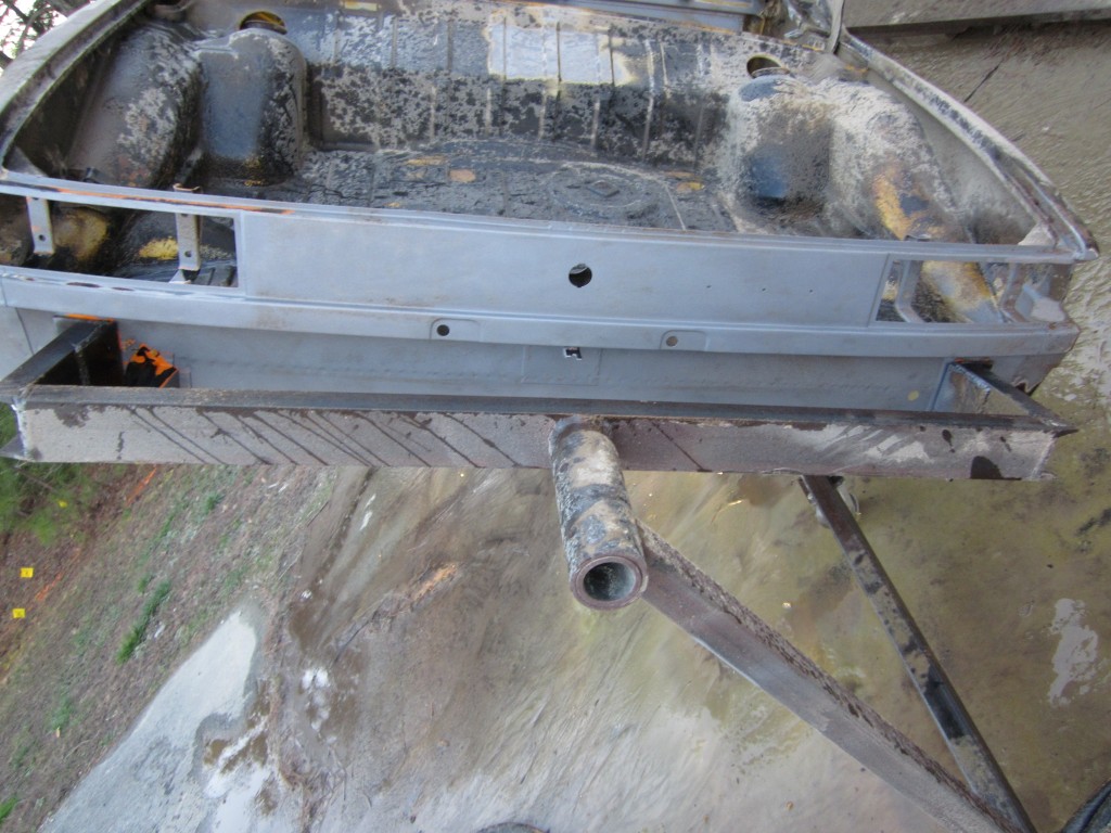

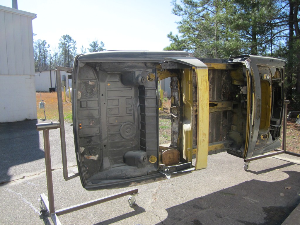

Started blasting yesterday. I've never stripped a whole car before and grossly under-estimated how long it would take. The sections of body panels I hit went quickly, but all the nooks and crannies seemed to take forever, as the media would build up and I had to clean the stuff out to see what I had and hadn't gotten clean. All the little spots of remaining undercoat and seam sealer were a bitch too. Anyway, the whole underside is nude, as is the front and rear panels and part of the engine bay. Forcast for rain tomorrow so hopefuly Tuesday I can get the trunks, pass compartment, remaining engine bay and outer body done. (IMG:style_emoticons/default/smile.gif)

I should add that I didn't uncover anything surprising. A few small holes popped up, and some of the spots we already knew were bad, got little worse. The only thing that may be an issue was how the front panel was replaced. I'll need to dig into it alittle more once it is all clean, but it appears the old piece was not completely removed, as there look to be 3 layers of metal around the edges, like the original flange is still there. The panel may need to be removed cleaned up and properly replaced. More on that later

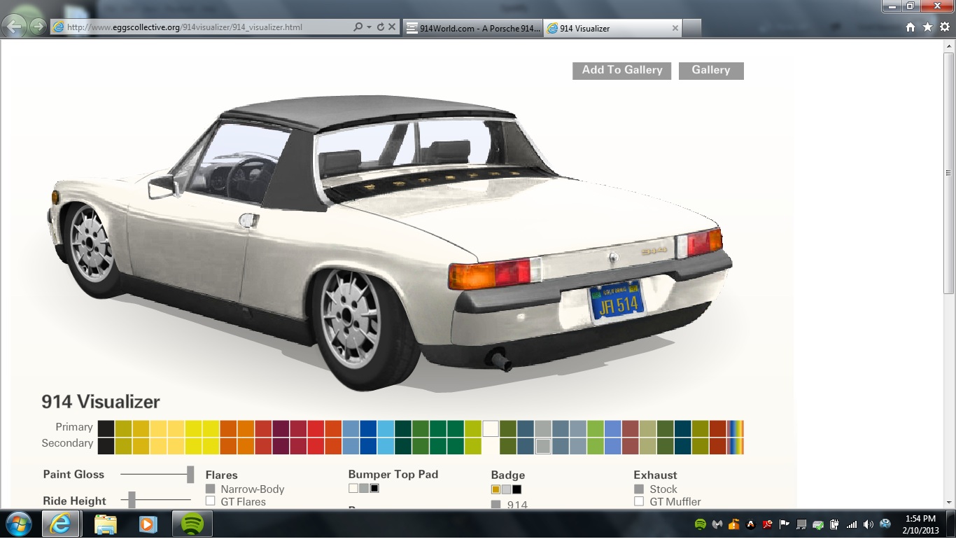

What a waste of gold paint (IMG:style_emoticons/default/barf.gif)
If you need more encouragement, I can send you as many pictures as you want of my white 914 (IMG:style_emoticons/default/smile.gif)

Michaels inspiration (IMG:style_emoticons/default/smile.gif)

Scotty is there a thread on making your rotisserie or do you have dimensions handy?

No I never did a thread on it. This is actualy the second one I built and is much more basic. The other is a lot heavier duty for putting Am cars on and has a bit more adjustments to it. Yuo can see that one in Mark Epstiens thread. I can get measurements this week, but the only ones that are really critical is the length ( height ) of the uprights, and IIRC I have those set at 48", cross leg is 36" and the front leg is 48" Again, these figures are off the top of my head, so I may be remembering wrong (IMG:style_emoticons/default/unsure.gif)

Be careful blasting the back sides of the hood and trunk. Keep in mi d you're "hammering" the metal and you can't reach the sheet metal behind the stringers. Aggressive blasting from the back can leave an imprint of the stringers on the top surface.
