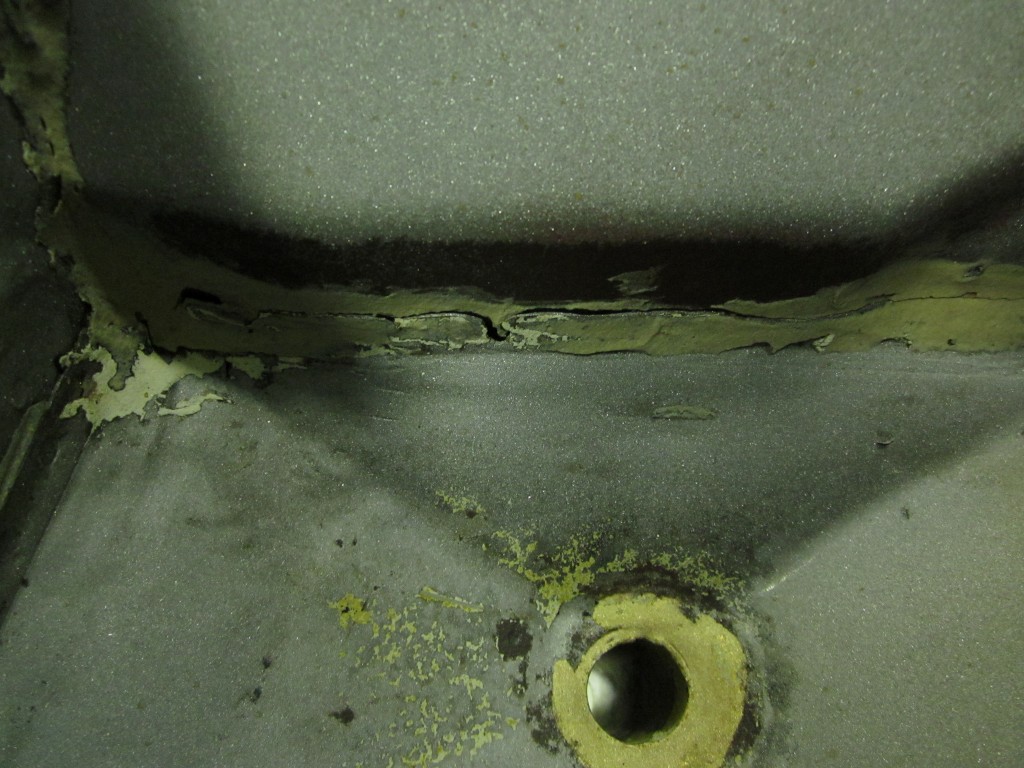

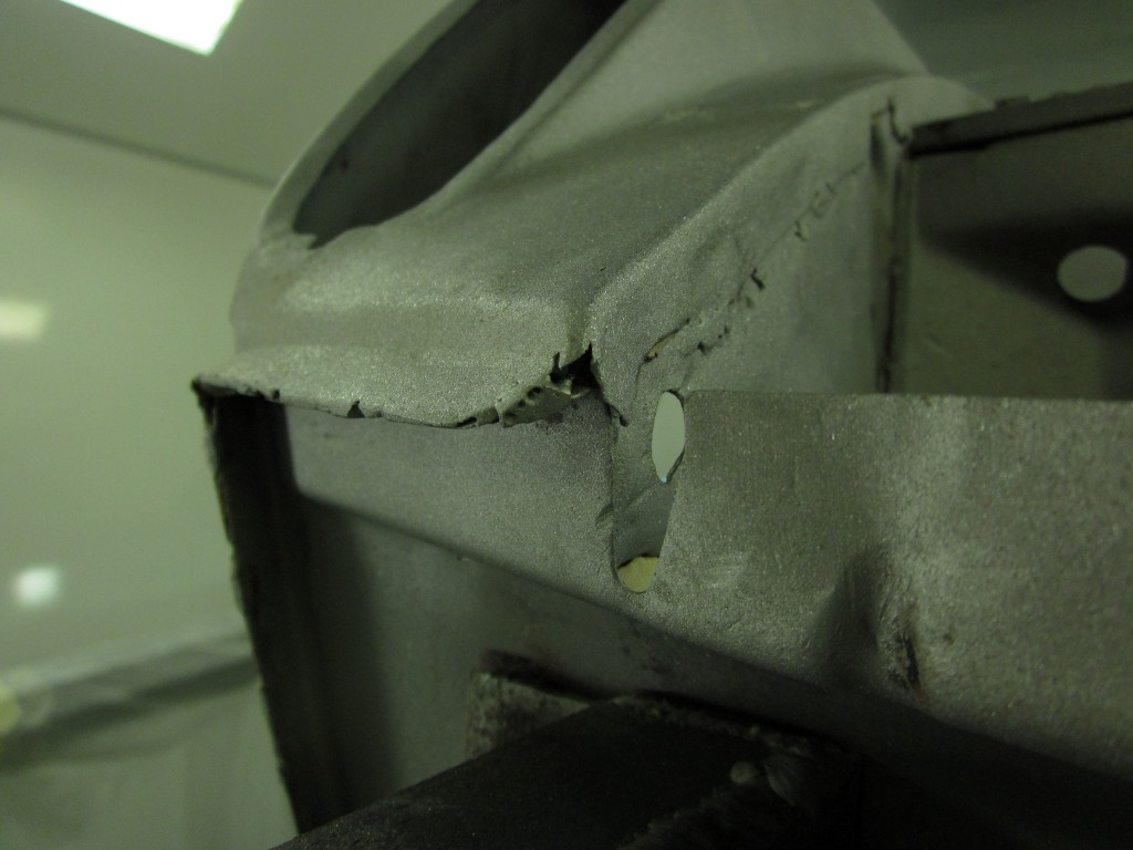

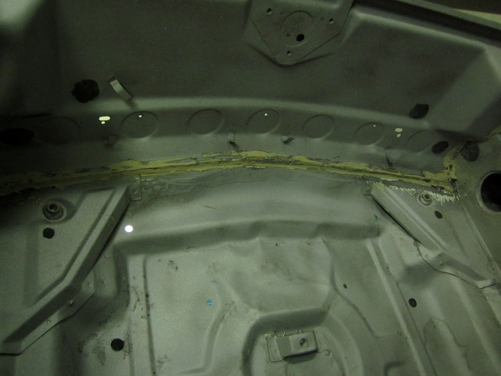

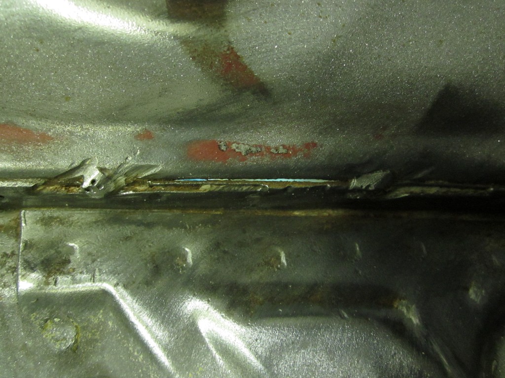

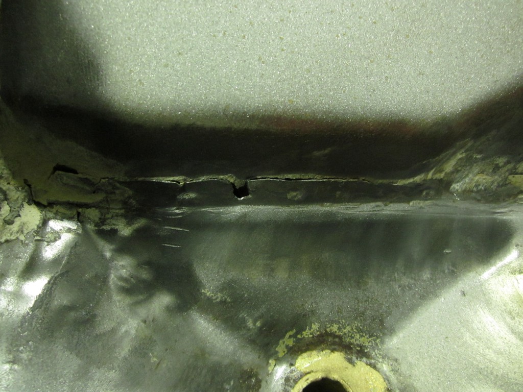

front trunk and one of the headlight buckets. Crappy weld never even got a good grip before it broke loose (IMG:style_emoticons/default/dry.gif) But that's o.k. A gob of seam sealer will hold it together (IMG:style_emoticons/default/slap.gif)
I also stripped most of the seam sealer out of the pass compartment, but fortunately found nothing under it to post. IMHO most of the rust issues here are a result of a 75% repair some time ago. the fit was good looking from the outside, but underneath the seam sealer we see there was a lack of REAL attention put into making things the way they were originally. Couple that with a lack of proper primer, and some half ass seam sealer, and you get uglies (IMG:style_emoticons/default/dry.gif)

Scotty: I noticed in a lot of the pictures the metal looks like it was sand blasted. I know you did not use sand so is it just the pictures? Is the metal smooth or is it pitted all over and porous?

It's just the close up making it look rough Michael. It's no where near as bad as it looks. All in all it is a really solid car, just some previous repair work that needs to be redone. I'm not saying it was crap work, but it was most likely late 70's / early 80's collision shop work. ALMOST right but not quite there.

Clean car by current standards. I noticed the late nose replacement does not have the holes cut out.
