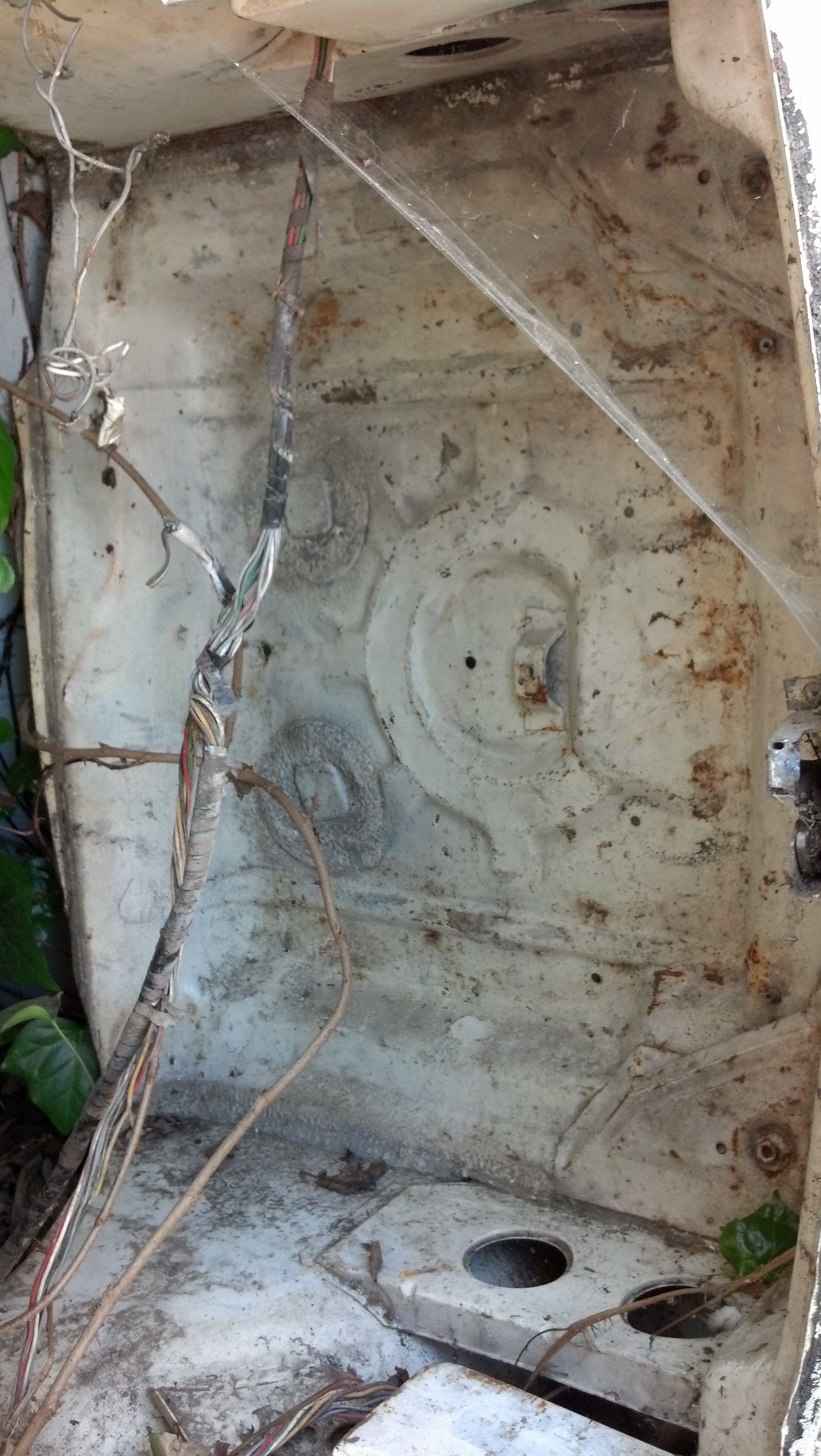

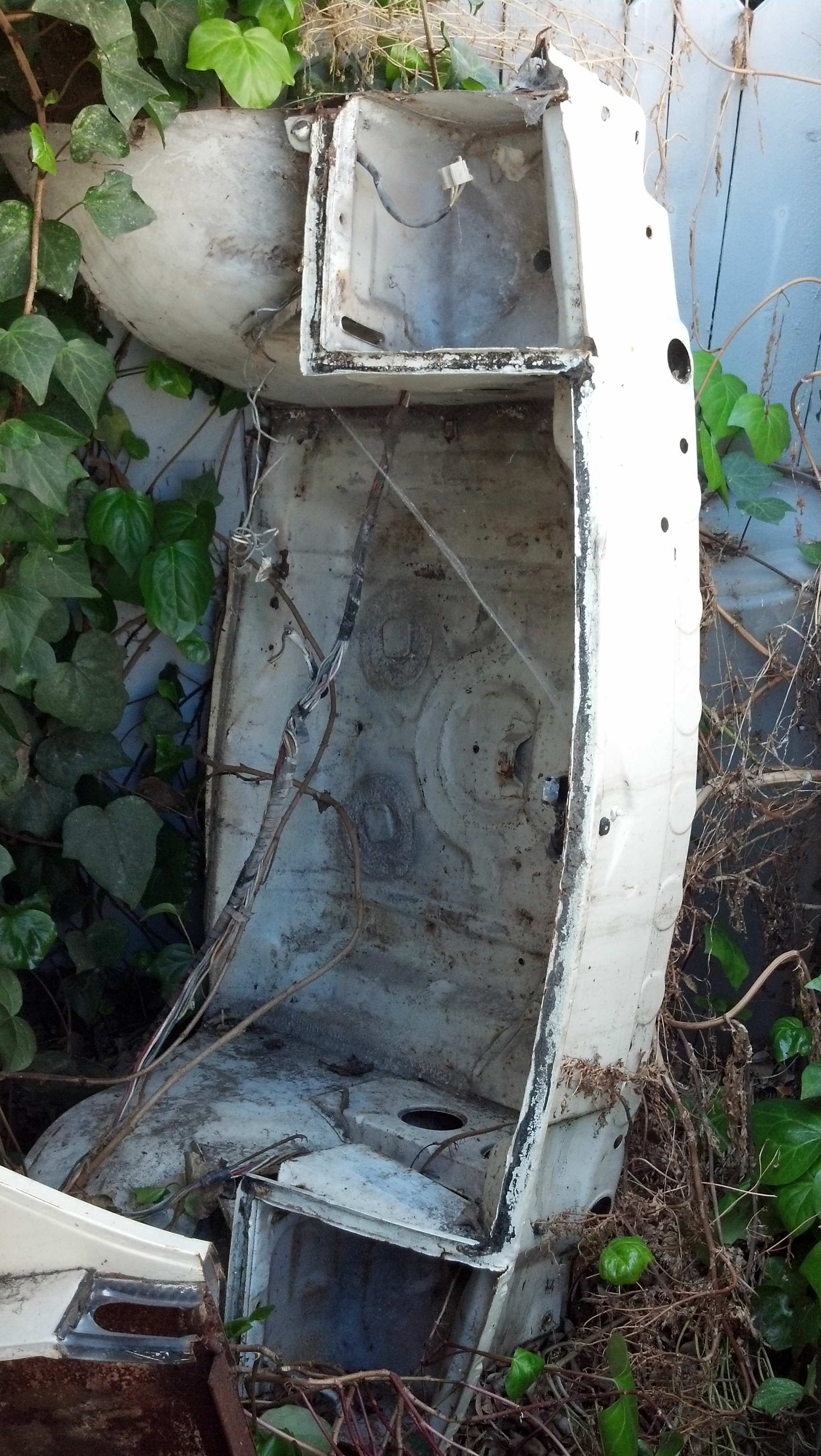

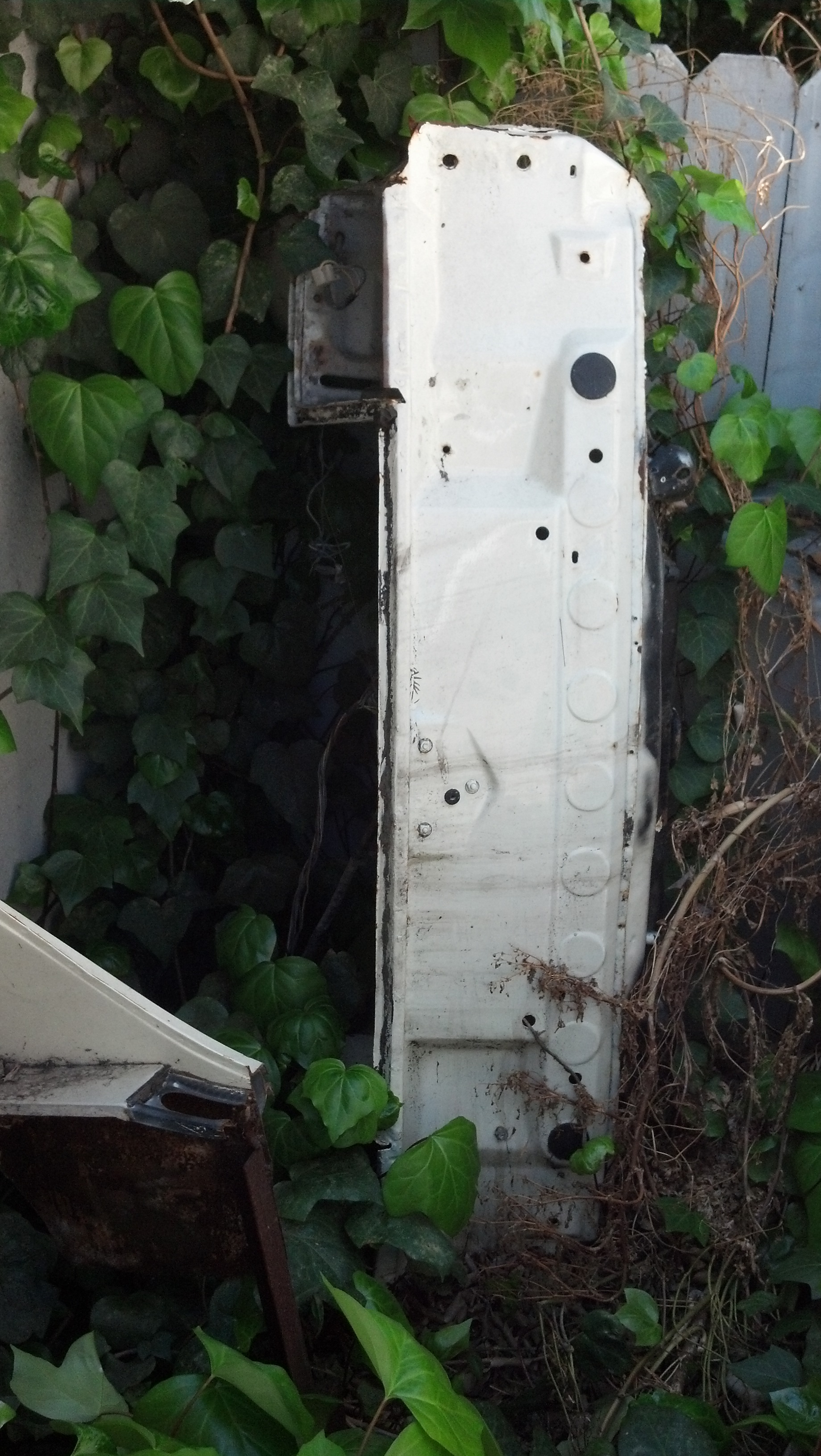

did you find a front nose section or will this work. From a 70 -4 dead and parted out

yes it was (IMG:style_emoticons/default/sawzall-smiley.gif) up but it's solid

Its a replacement panel like what was on his -6..

I appreciate you keeping an eye out for me but I found a panel at 914 LTD and Brad shipped it out this morning to Scotty.
