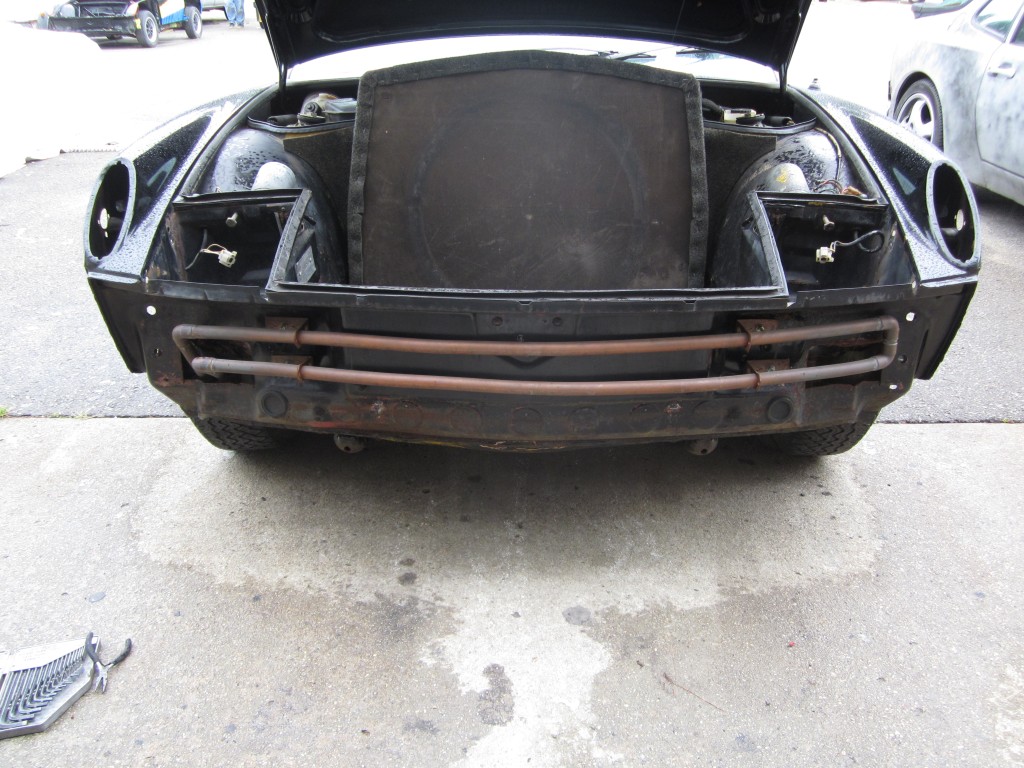

(IMG:style_emoticons/default/confused24.gif) This looks like it would work and you could keep the bumper stock

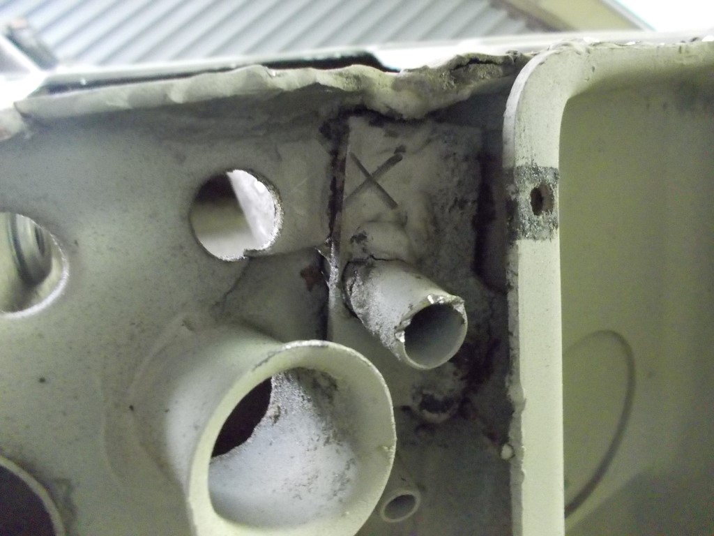

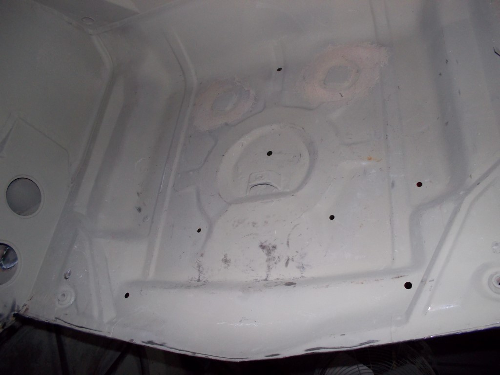

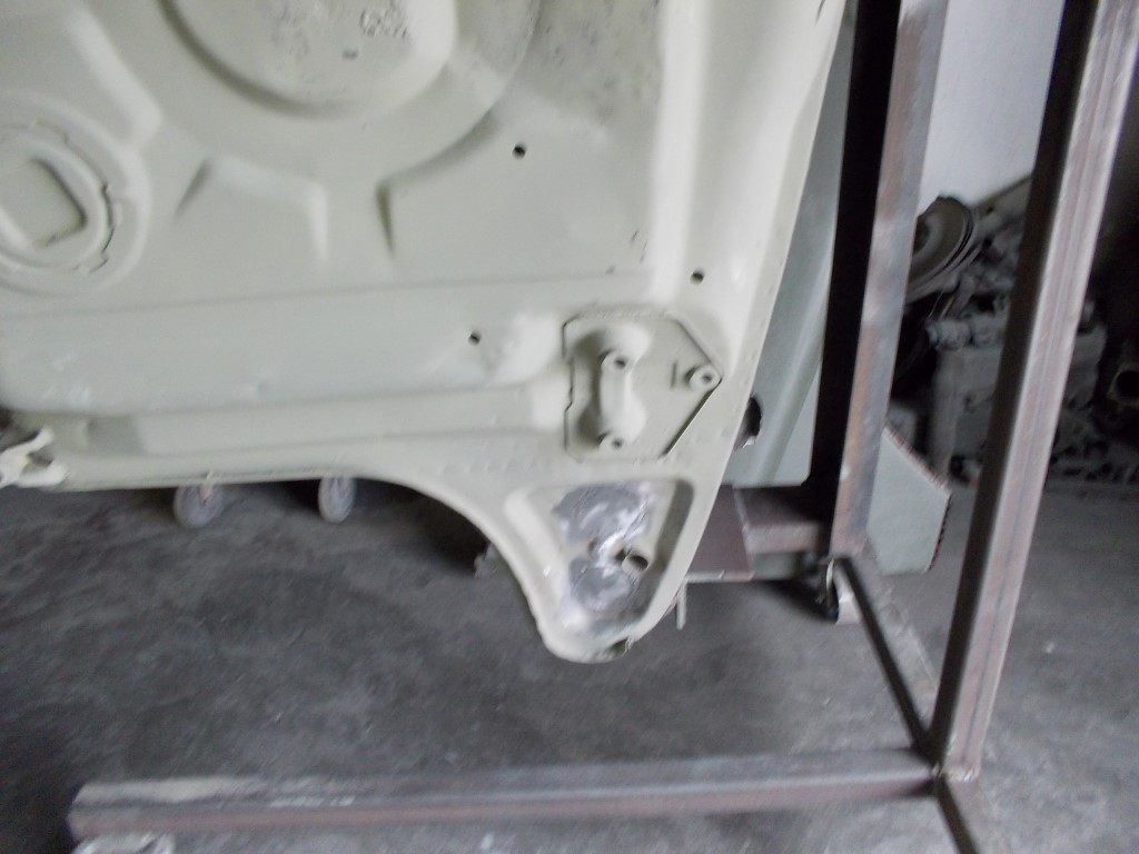

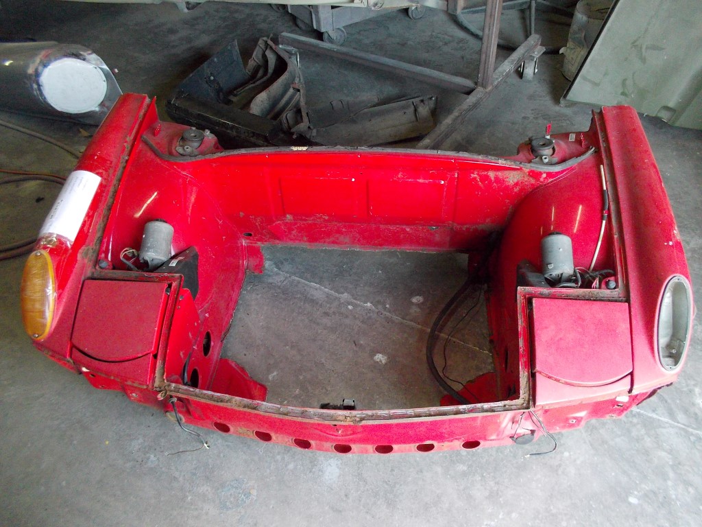

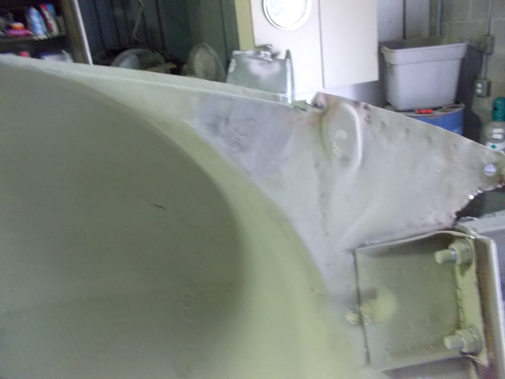

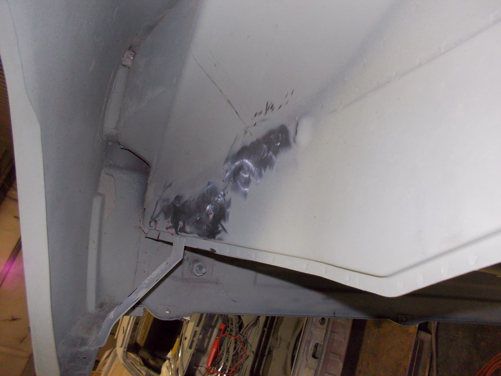

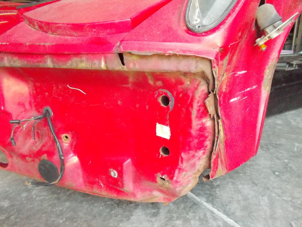

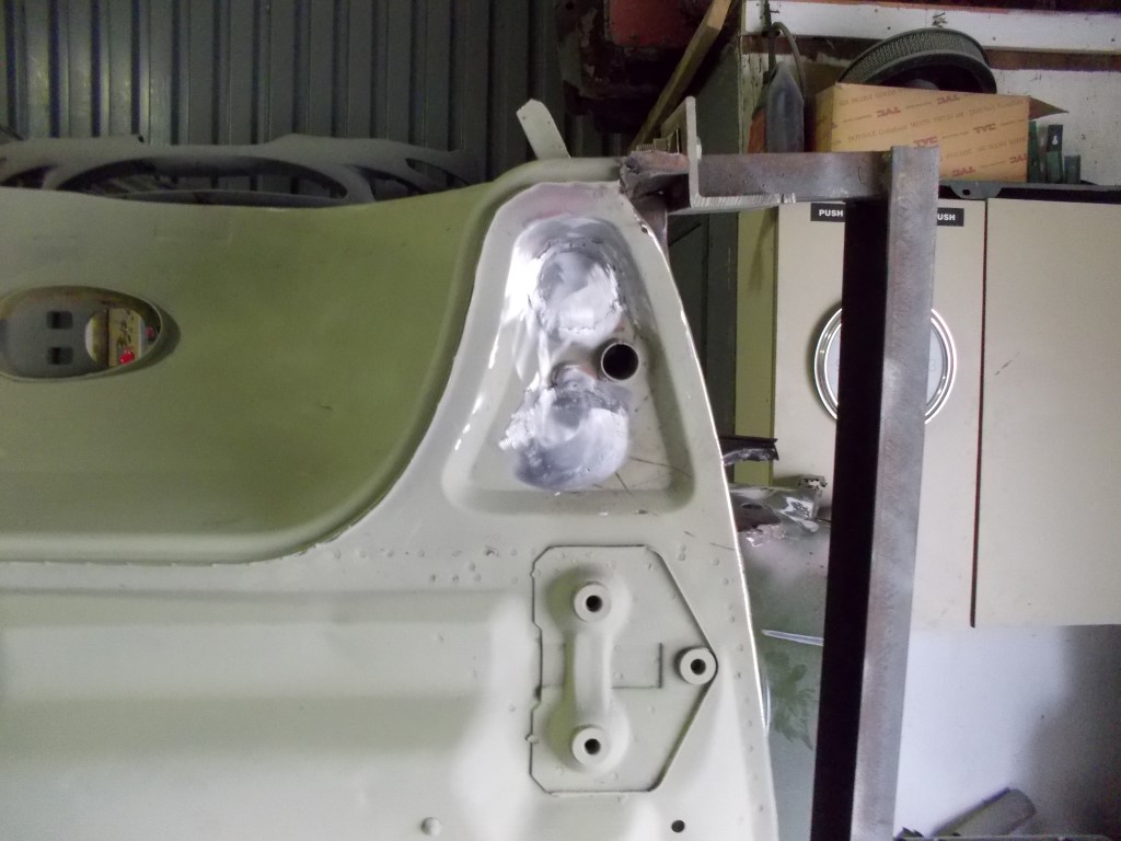

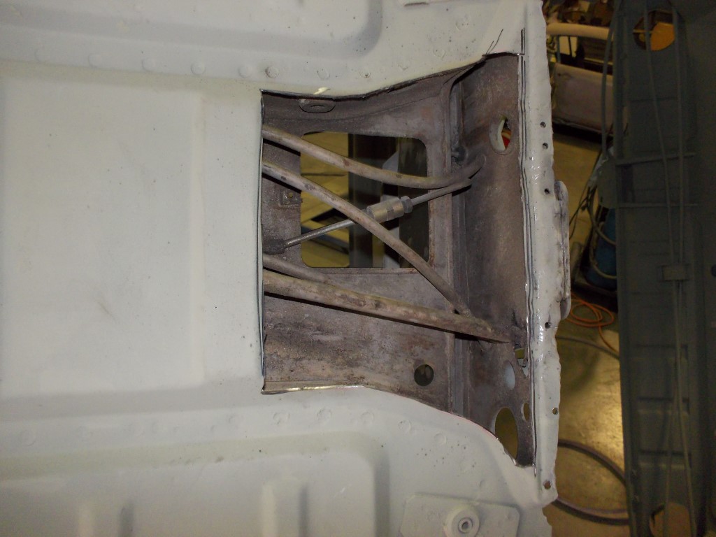

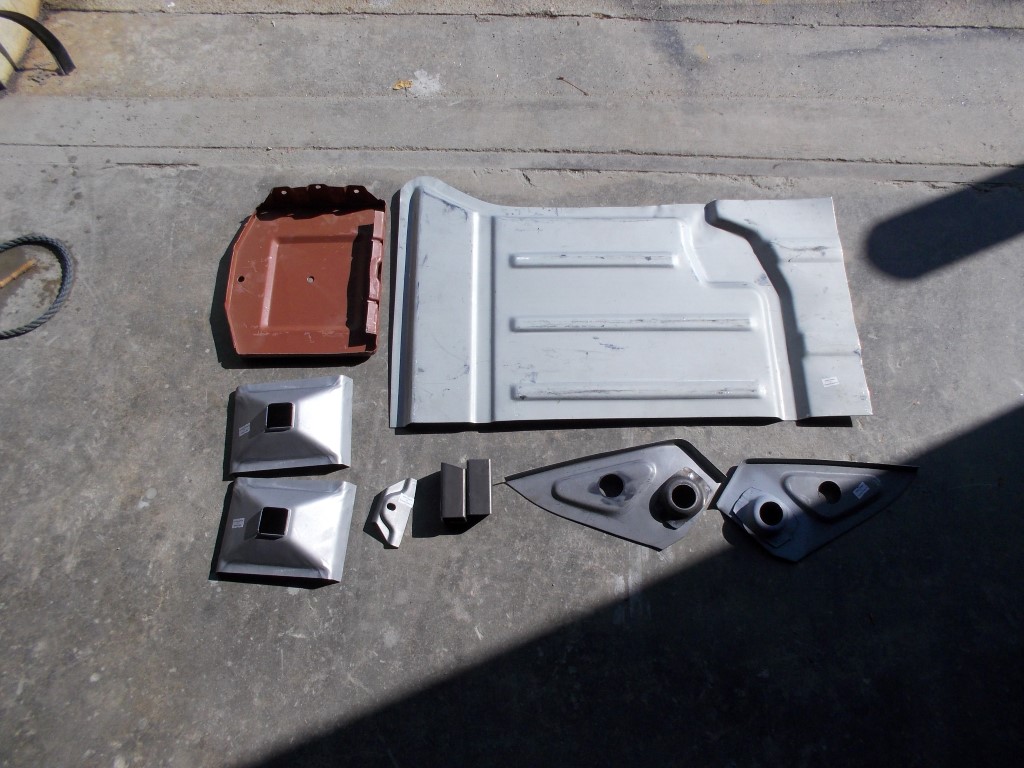

Got some smaller stuff done. filled in all of the holes form the previous oil cooling system, hammerd the front trunk back into place, mad ea patch for the engine shelf down in the hell hole, cut the rear center section out of the floor to repair and weld back in. While it is out I will also be repairing and reinforcing the clutch tube spot on the firewall.
Oh, and some goodies have arrived (IMG:style_emoticons/default/biggrin.gif)
Attached Image Attached Image Attached Image Attached Image Attached Image Attached Image Attached Image Attached Image Attached Image Attached Image

Ooooo, nice front clip.
