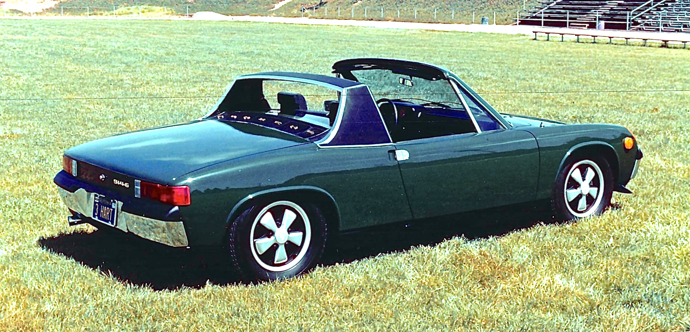

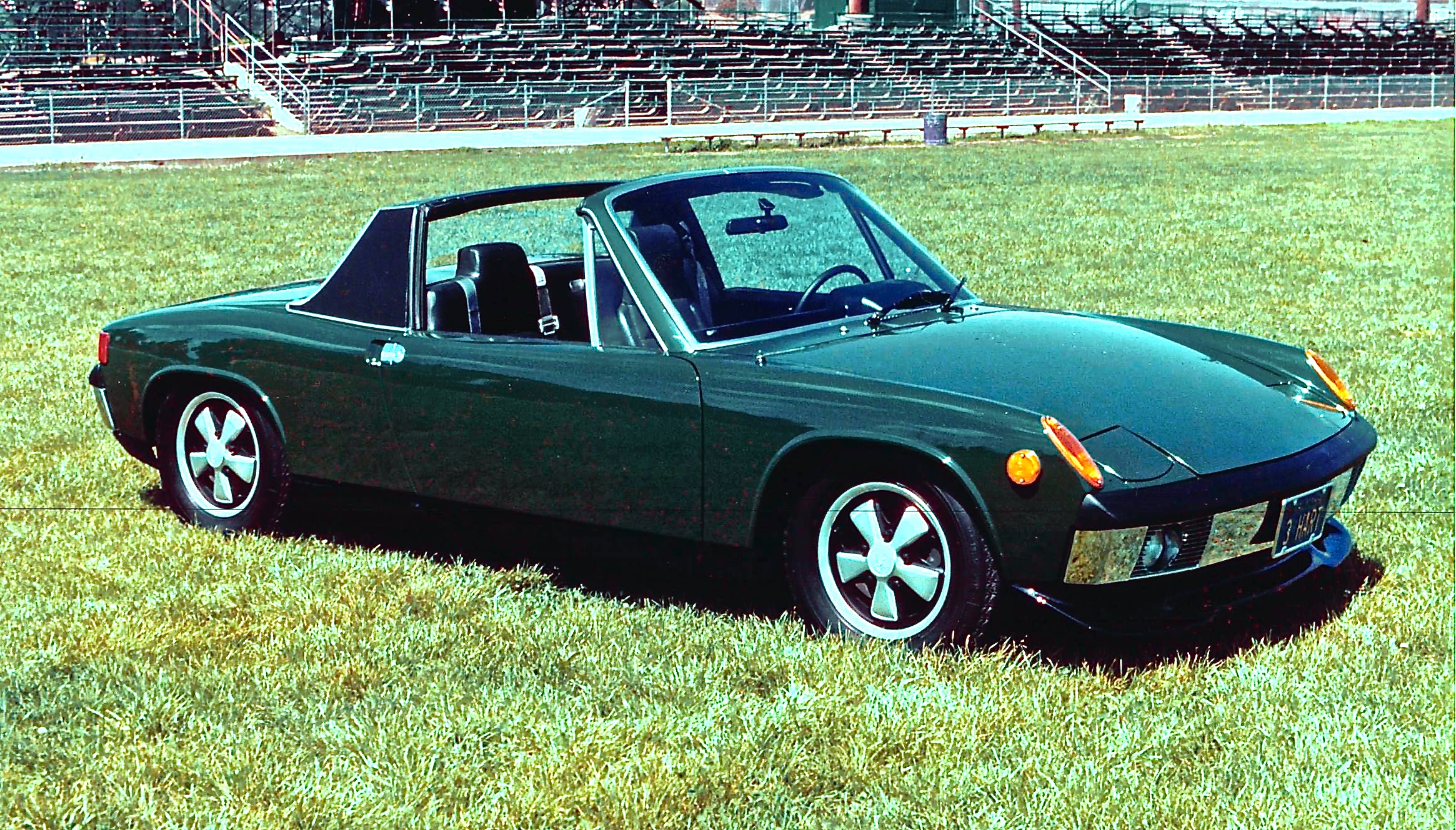

So it turns out moving is a good thing every 23+ years or so...I found two pictures of my last Six:
As you can hopefully tell, it was Irish Green. It was essentially stock, almost. It had a 3.0 with CSI, front oil coolers behind the fog light grills, Koni shocks, F&R sway bars and deep sixes. I had that little lip front valance which I would not use now. Car ran terrific and I sold it to further my education- tuition costs. Miss that nice little car.

OK, you have to share that oil cooler install setup...also how the CIS fit/worked. Inquiring minds want to know...

Thanks everyone. The oil coolers were VW small oil coolers and one was mounted behind each fog light grill. All stainless steel hoses and AN connections. Turbo thermostat mounted on passenger side firewall. Kept the car nice and cool- never overheated. That system may have not been in at the time of these pictures as I can see the actual fog lights still installed in the car.
The 3.0 with CIS ran perfect and never skipped a beat. We had to shave the ribs on the air-boot down a bit and we removed the engine lid cross brace and stiffened it up and moved the latch. It worked perfectly and still utilized the stock cable and latch.
Irish Green is a beautiful color- no doubt.

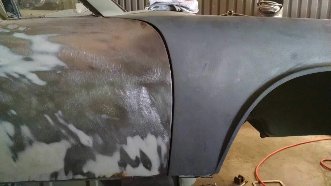

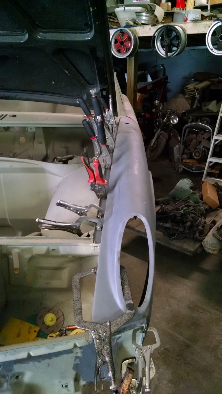

scotty b

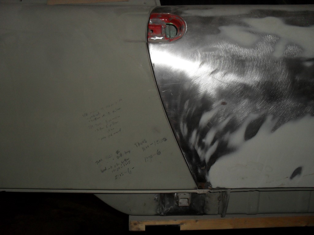

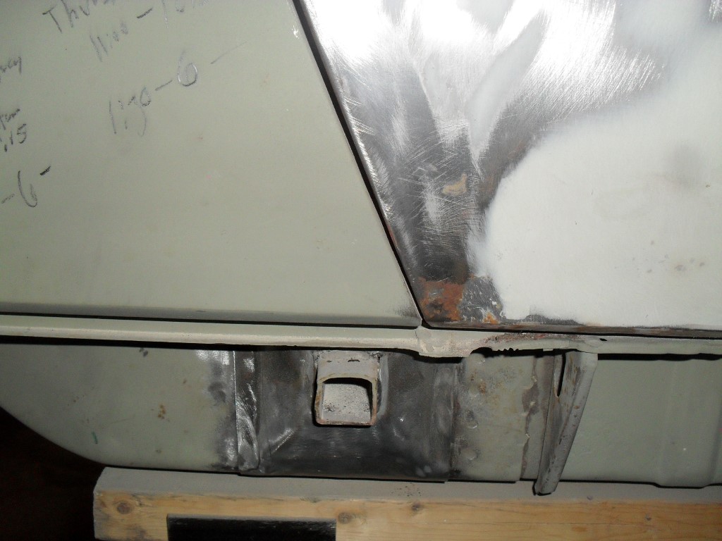

post Jul 27 2014, 11:48 AM
Post #356
rust free you say ?
Posts: 16,375
Joined: 7-January 05
From: richmond, Va.
Member No.: 3,419

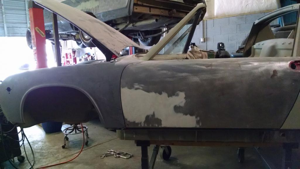

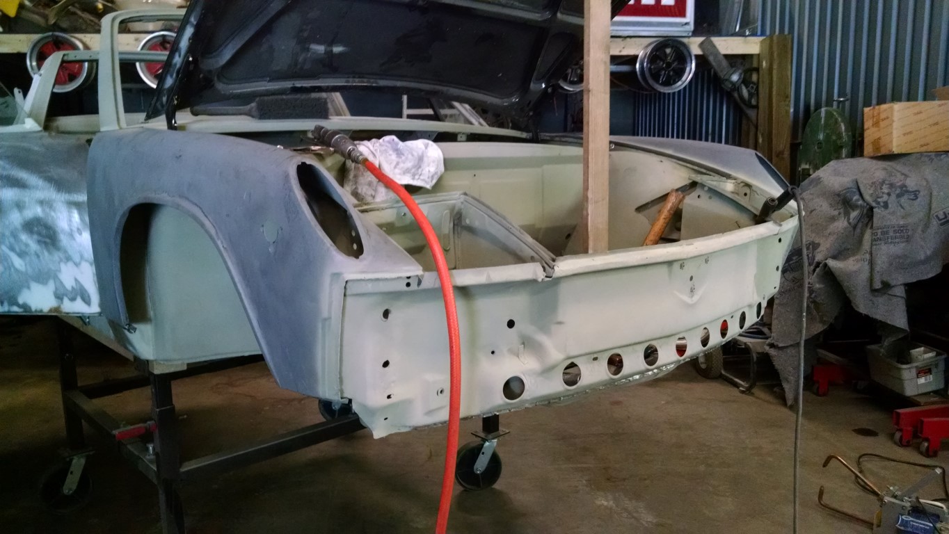

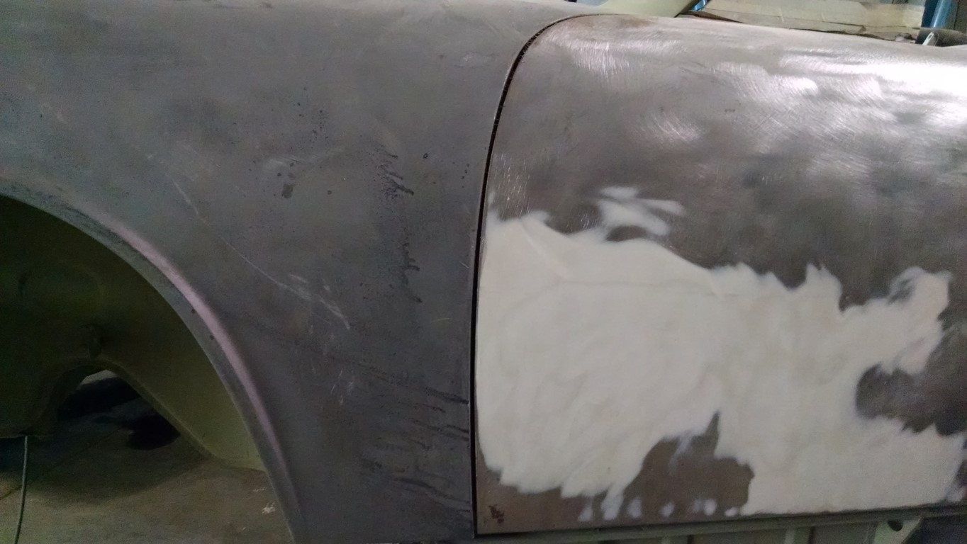

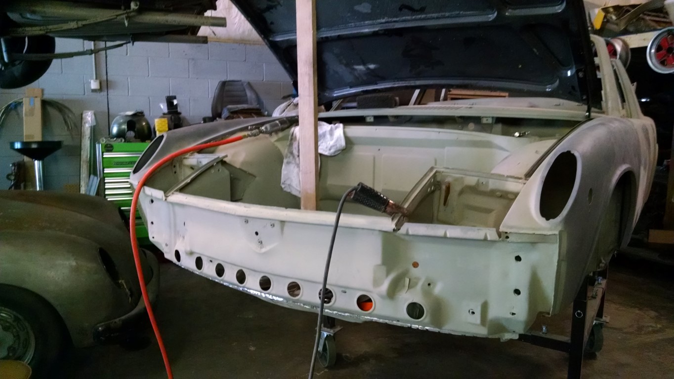

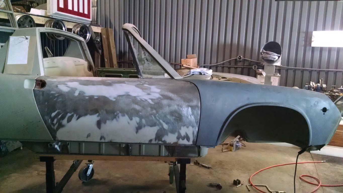

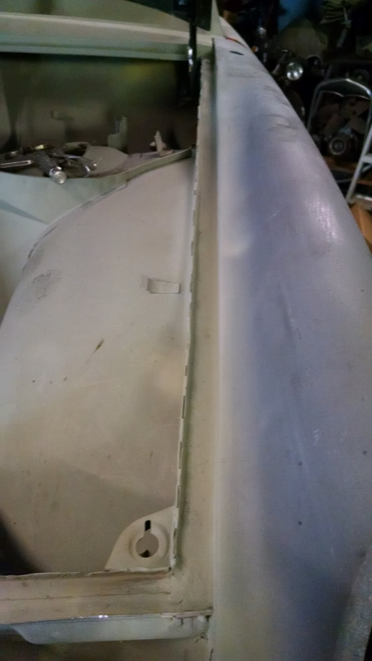

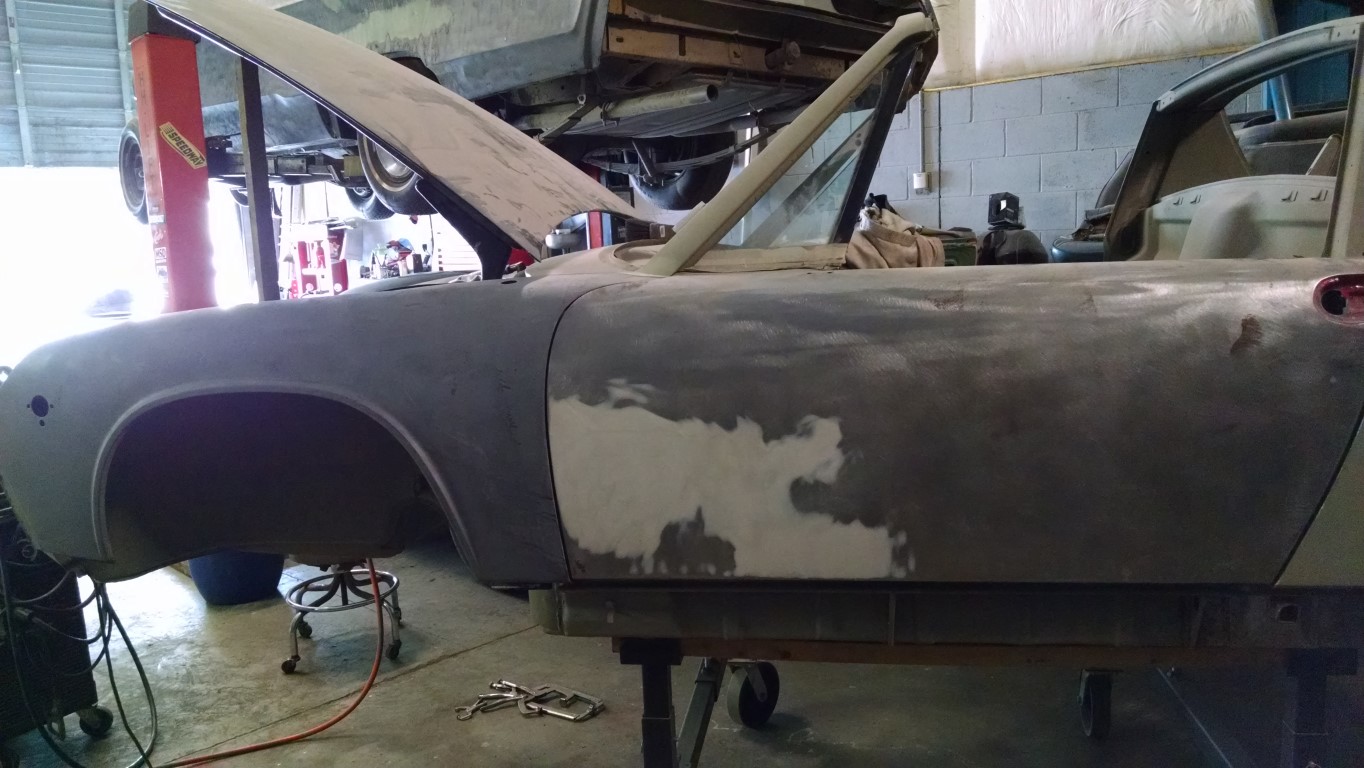

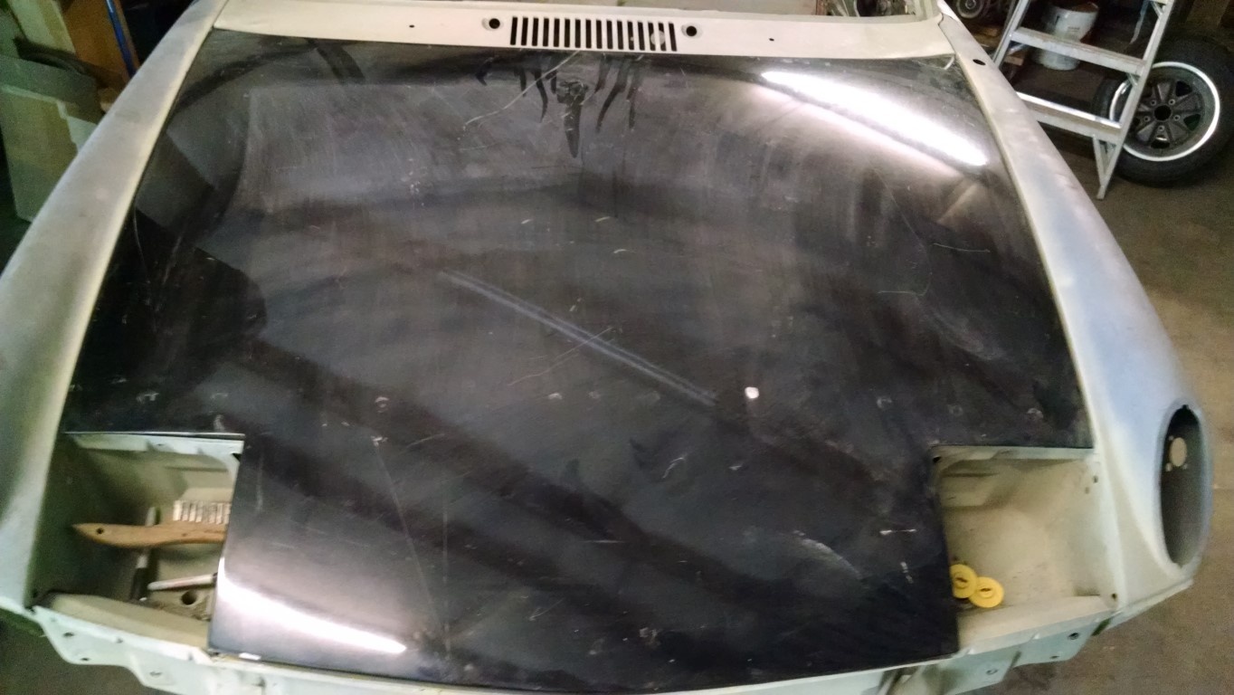

looking like a car again (IMG:style_emoticons/default/smile.gif)
Attached Image Attached Image Attached Image Attached Image Attached Image Attached Image Attached Image Attached Image Attached Image Attached Image Attached Image
scotty b
post Jul 27 2014, 11:57 AM
Post #357
rust free you say ?
Posts: 16,375
From: richmond, Va.
Member No.: 3,419
It doesn't show well in the pics, but the pass rear 1/4 is the last major metal obstacle. It's pretty mangled up from it's prior damage, and has some lousy repairs around the taillight opening. Most likely I'll be replacing the whole panel with another from a parts car. Unless someone has a NOS one laying around getting in the way (IMG:style_emoticons/default/poke.gif) That will be dealt with in a couple weeks (IMG:style_emoticons/default/smile.gif)
post Jul 27 2014, 12:43 PM
Post #358
914-6 GT in waiting
Posts: 20,820
Joined: 19-September 09
Member No.: 10,825
Happy to see the front panel is correct for the car.
