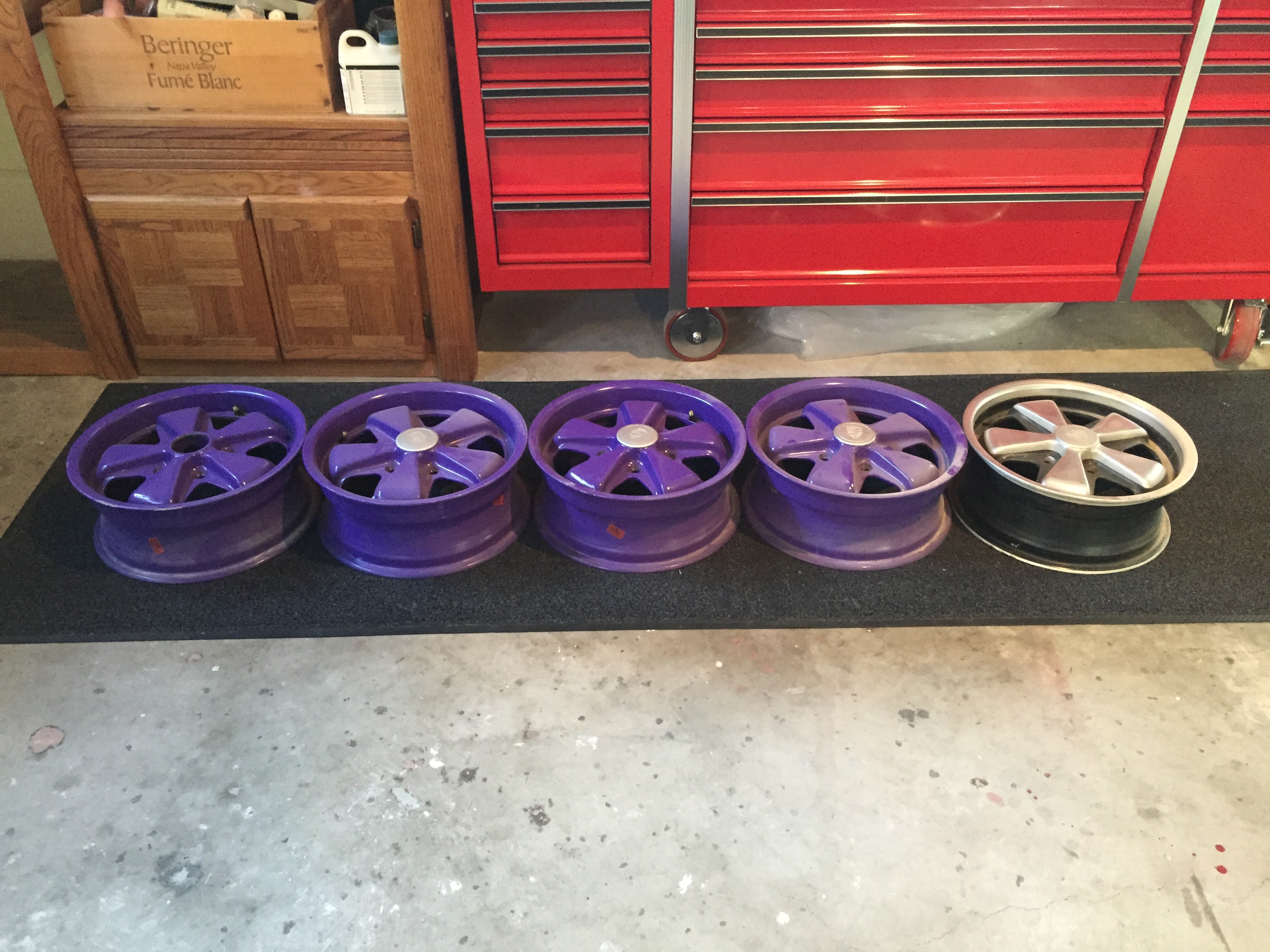

So I am taking a ride to drop my deep sixes off at Harvey Weidman's this morning to have them restored. I hope they are all nice and true with no issues so he has good wheels to begin with.

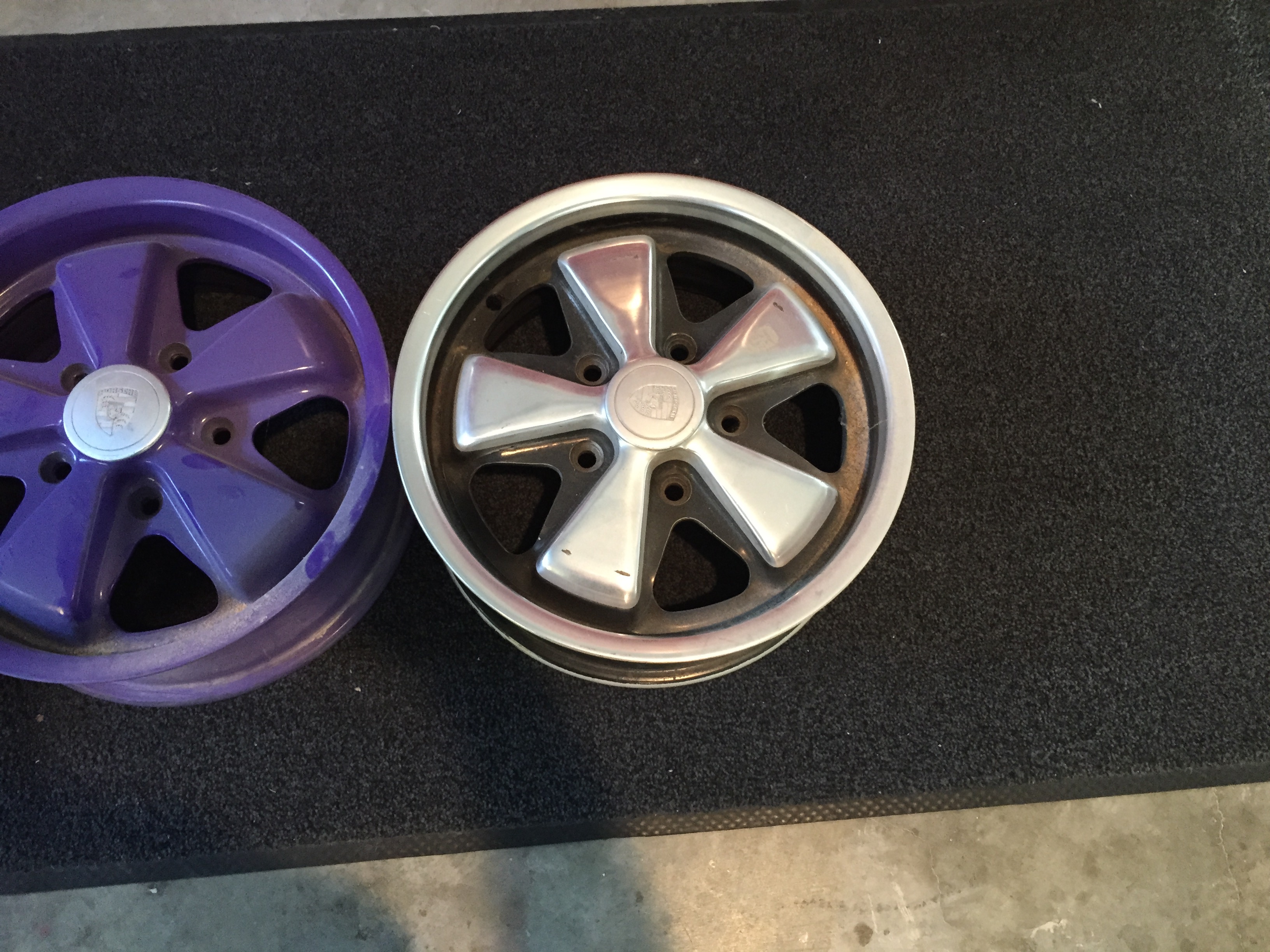

Here is another look at the wheels -closer-

What's wrong with purple Fuchs? (IMG:style_emoticons/default/confused24.gif)

QUOTE(Mike Bellis @ Nov 8 2014, 09:21 AM) *
Yeah, they'd look fantastic w/your gold paint scheme.... (IMG:style_emoticons/default/first.gif)

QUOTE(altitude411 @ Nov 8 2014, 04:33 PM) *
I'm digging the Purple (IMG:style_emoticons/default/drooley.gif) , let's start a vote thread

I dropped the wheels off with Harvey today. Got a tour of the shop and he explained the entire restoration process. I am having all 5 wheels widened 1" so I can fit a little bit wider tire on them to keep the rear hooking up a little bit better with the 3.2. I want all 5 to match. I also gave him 4 new center caps along with my 4 original center caps so I can have a couple spares and they will match the wheels as closely as possible.
Harvey is a terrific guy who enjoys what he does and it certainly shows in his finished product. I can't wait to see these wheels when they are finished.

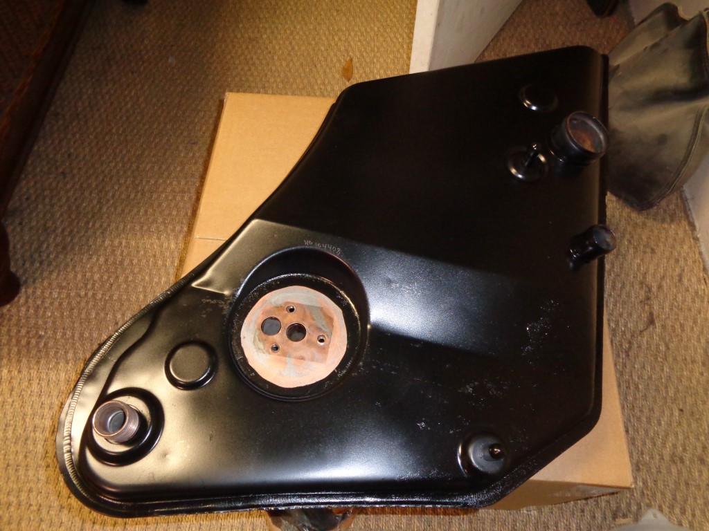

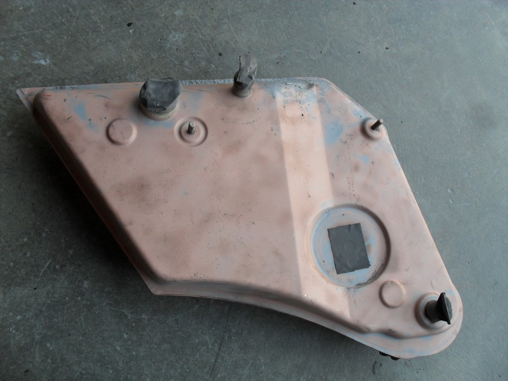

I blasted the oil tank and checked it over, cleaned up a previous repair, then sent it out to Pacific oil cooler for a thorough cleaning, pressure testing and refinish

QUOTE(scotty b @ Dec 14 2014, 10:12 AM) *
So glass bead blasting wont remove the copper plate?

Looks nice. Glad to see it is done. - will you be sealing it up so nothing gets inside of it in the interim?

QUOTE(mepstein @ Dec 14 2014, 02:14 PM) *
a heavier blasting or harsher media would. I've got a fine glass bead in the cabinet so all it would do without more time was remove any that was already loosening.
already done

I knew that but wanted to remind everyone not to let these sit unsealed. Thanks for the terrific work Scotty. (IMG:style_emoticons/default/smilie_pokal.gif)

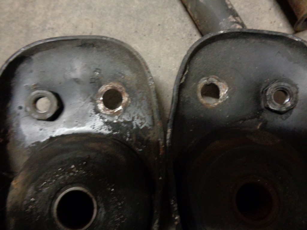

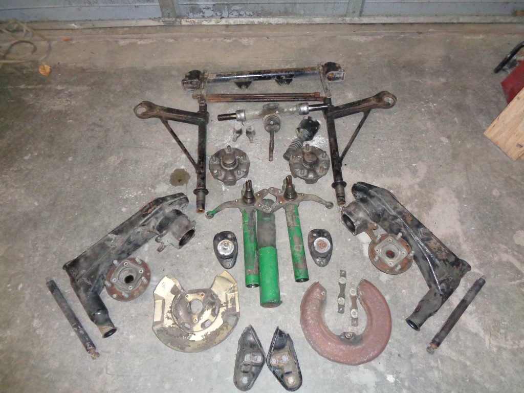

3.5 struts arrived and I was feeling a bit destructive soooooo. the broken nuts seem to be a regular issue I run across. Both of the new struts were broken, as was one of his originals. I have a box full of them so I'll grab one more good one, and repair these later

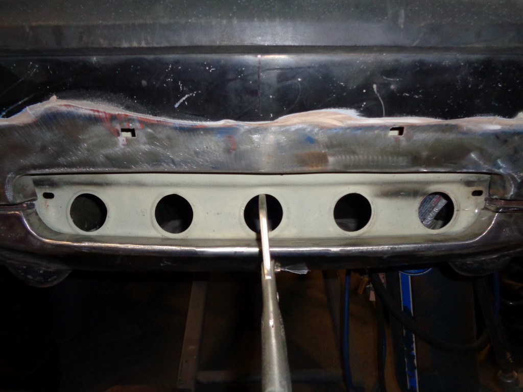

Fab work on the valance is done save for some clean up. some dents, warpage from welding, and I want to spend a little more time on some of the lines to sharpen them up.

:gasp: I see front license plate mounting holes in that bumper... (IMG:style_emoticons/default/new_shocked.gif)

QUOTE(Jeff Bowlsby @ Jan 25 2015, 06:37 PM) *
:gasp: I see front license plate mounting holes in that bumper... :zoikes:
(IMG:style_emoticons/default/dry.gif) There's also bondo and paint all over it too (IMG:style_emoticons/default/slap.gif)

No worries Jeff - all that will be gone. Scotty will strip that bumper and then it gets re-chromed to look like new - No holes of course.
That oil cooler opening looks very sweet Scotty.
