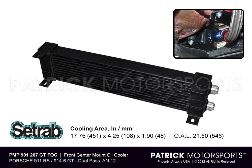

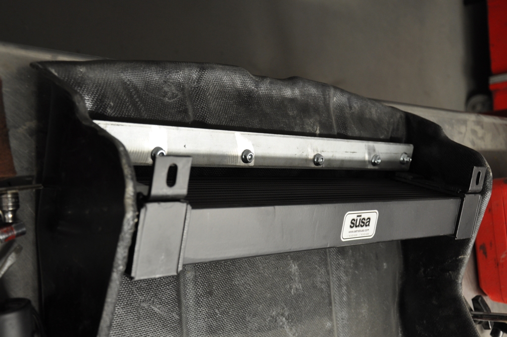

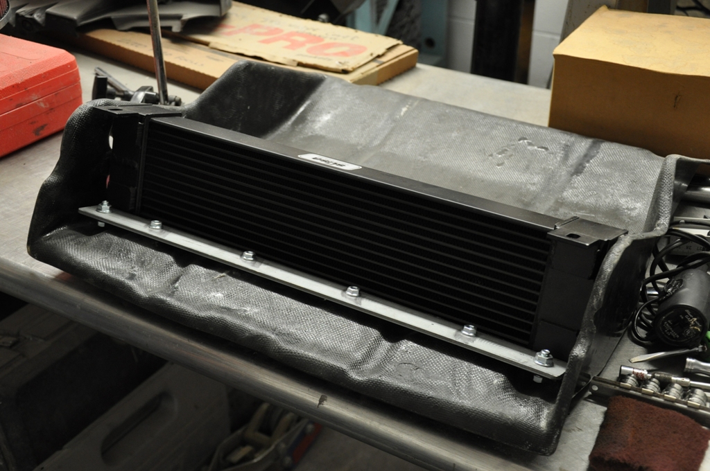

What oil cooler is going under that duct ?
post Mar 4 2015, 08:28 PM
Post #462
914-6 GT in waiting
Posts: 20,819
Joined: 19-September 09
Member No.: 10,825
I'm doing something like this with fans. I'm not sure Cairo will need as much oil cooling as me since he is using an on engine oil cooler. Mine will only be cooled from the front and a block off plate used on the engine.

QUOTE(mepstein @ Mar 4 2015, 06:28 PM) *
Same cooler I went with and its perfect!!!

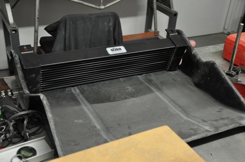

QUOTE(Socalandy @ Mar 4 2015, 11:47 PM) *
Can you squeeze a fan(s) in the shroud?

Here's a picture for you. I think you have room in front or in back of the cooler with the right size fan

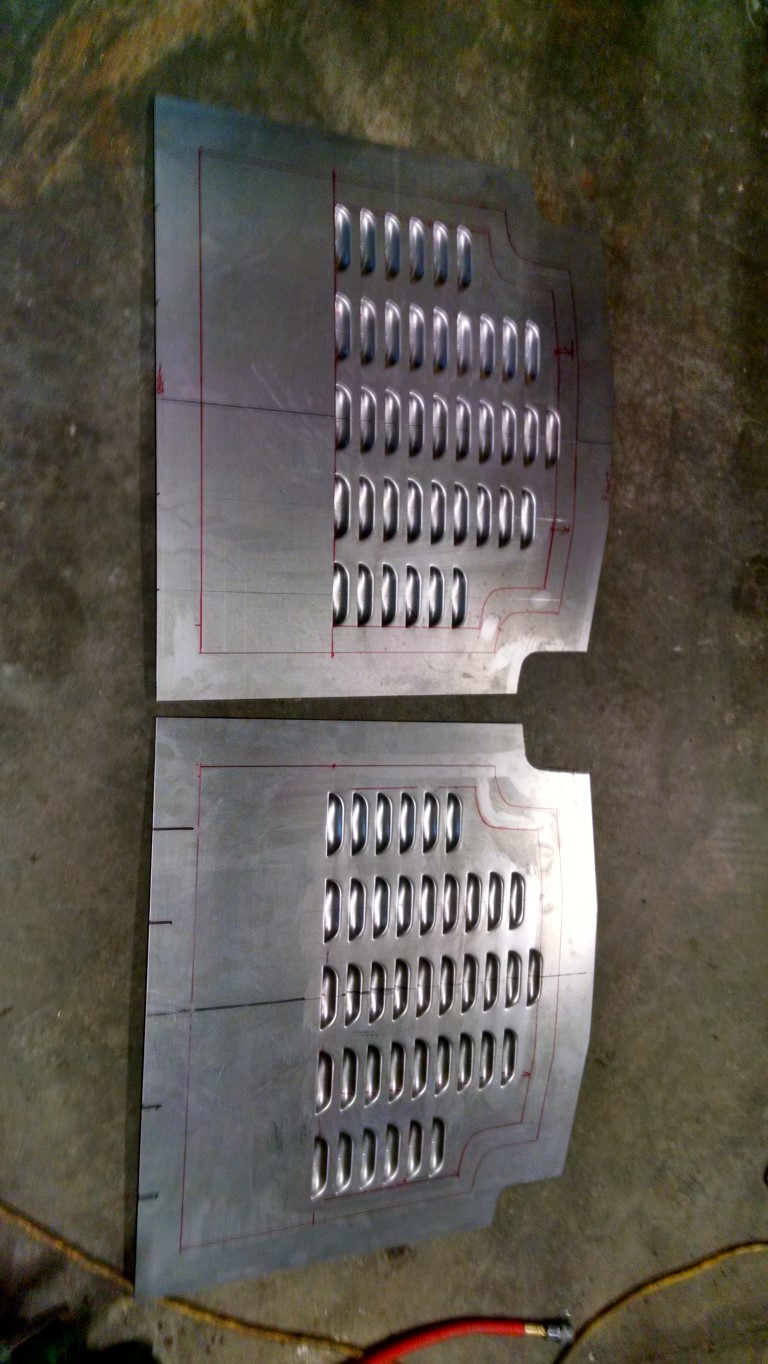

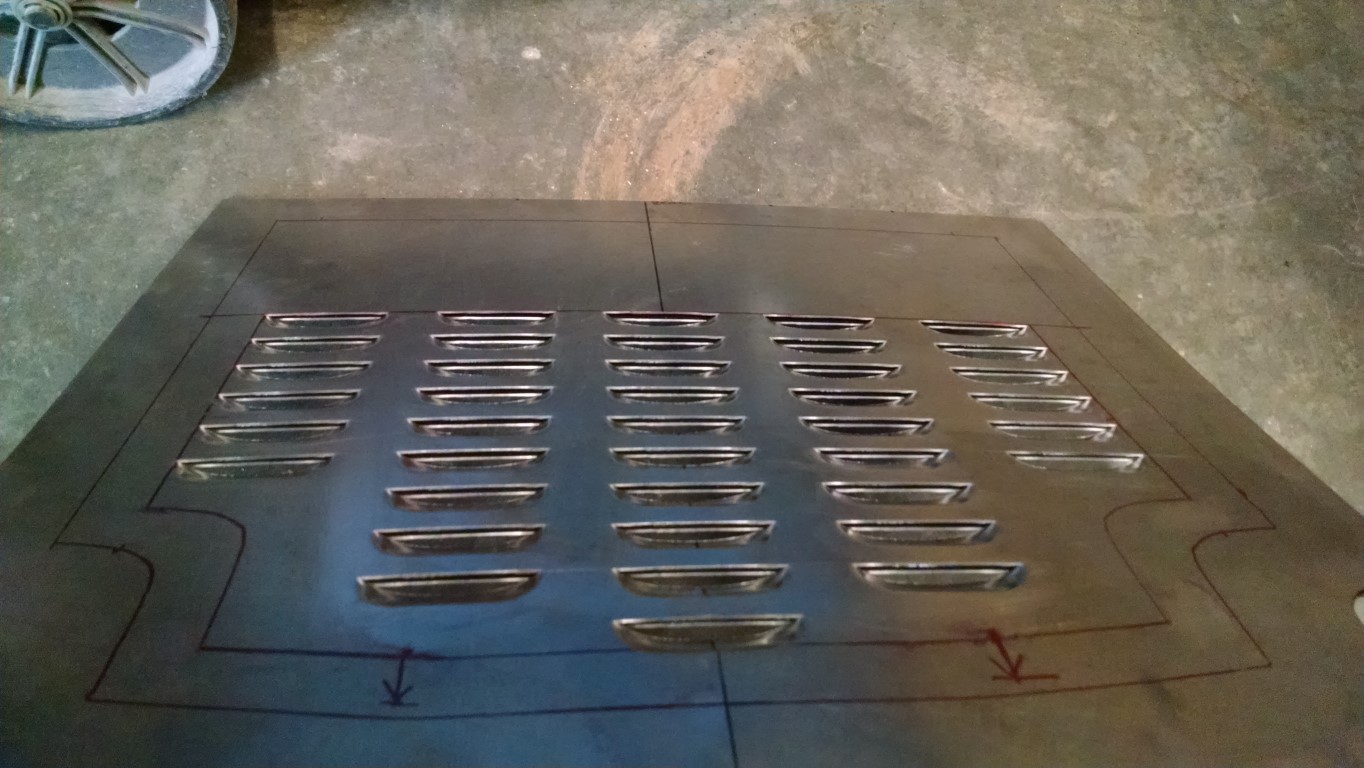

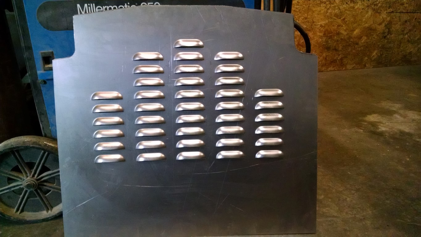

went to a friends shop last week before I headed south and punched some louvers. One for Michael, one for Mark (IMG:style_emoticons/default/smile.gif)

Cool!. Thanks, Scott! Jeez, I didn't even ask for this. Can you paint mine in off-Irish Green?
(IMG:style_emoticons/default/thumb3d.gif)
Thanks again,
Michael.

Loving that! Can't wait to see that panel welded in and the cooler system completely mocked up. Thanks for the picture.

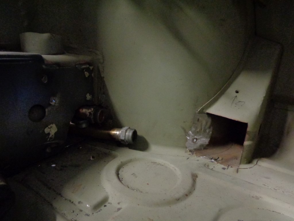

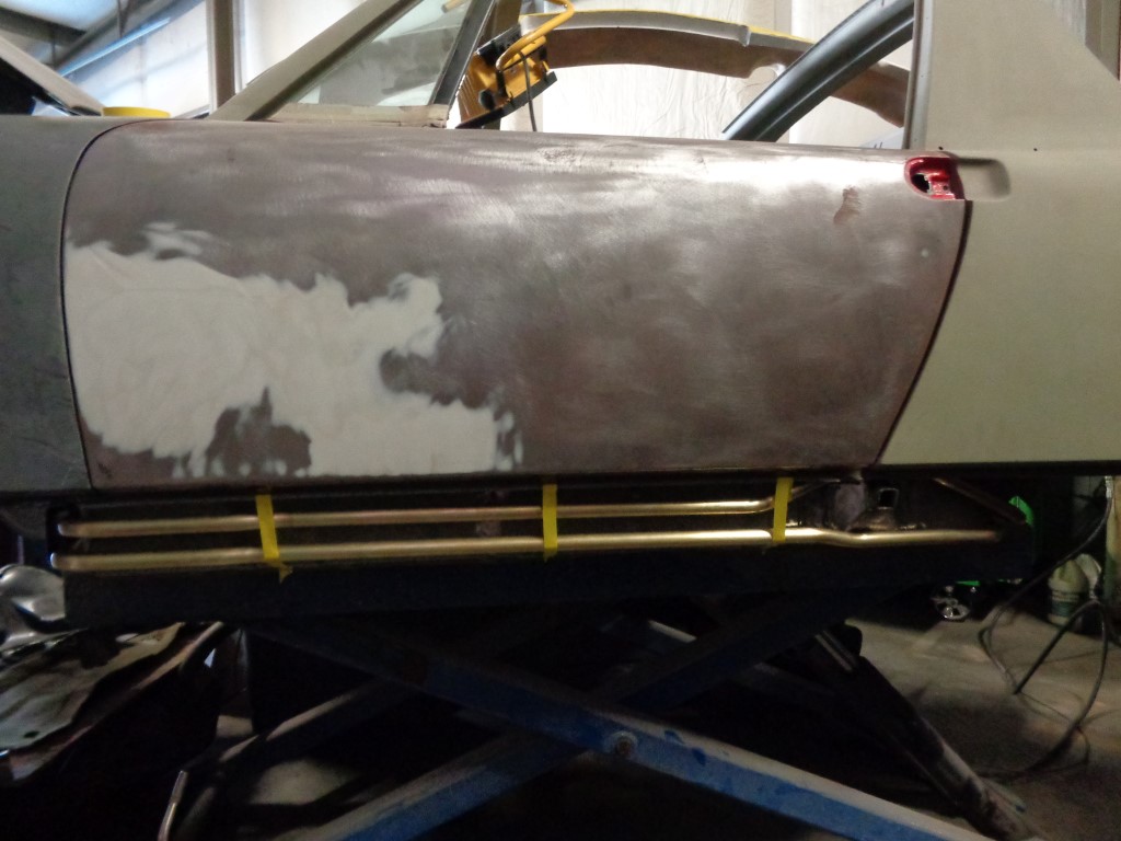

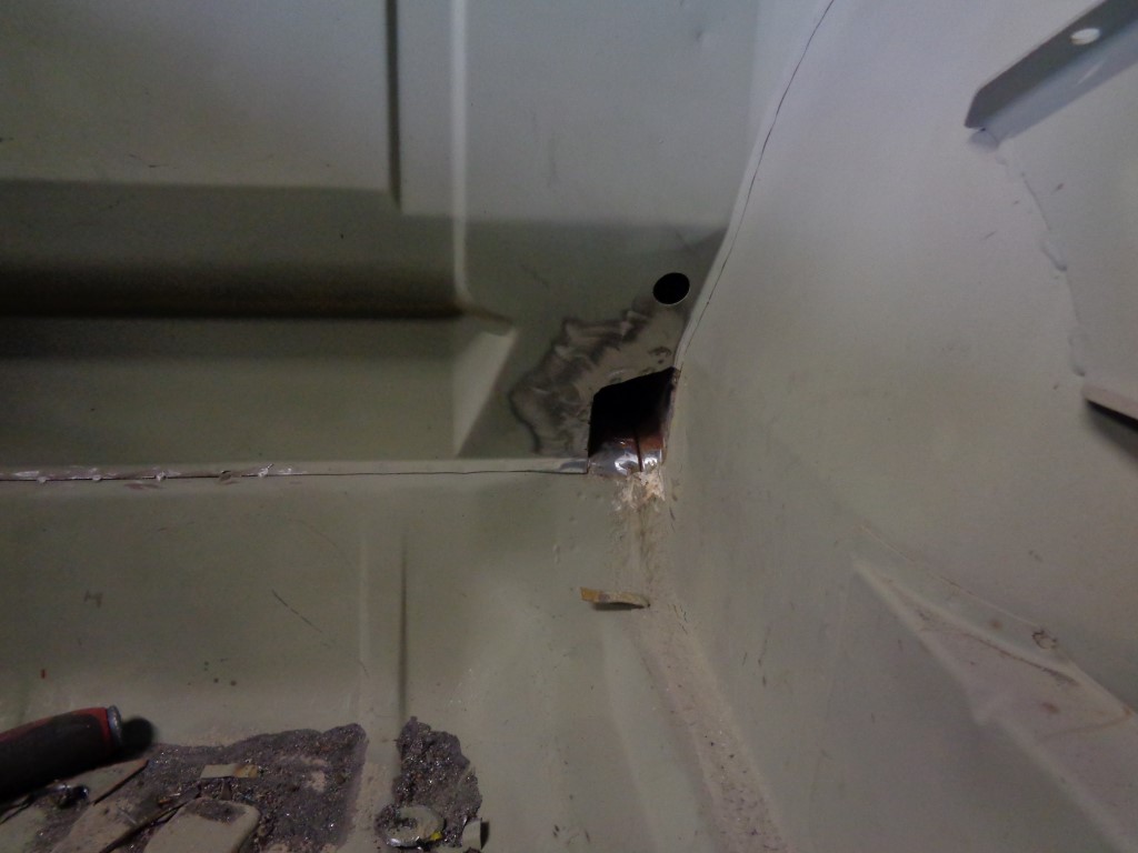

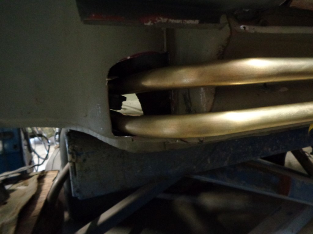

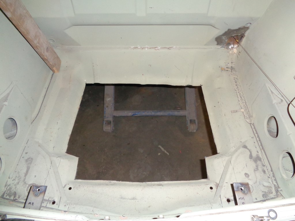

Bent some brackets, cut some holes, laid some pipe (IMG:style_emoticons/default/blink.gif) and cut a really big hole (IMG:style_emoticons/default/unsure.gif)
Attached Image Attached Image Attached Image Attached Image Attached Image Attached Image

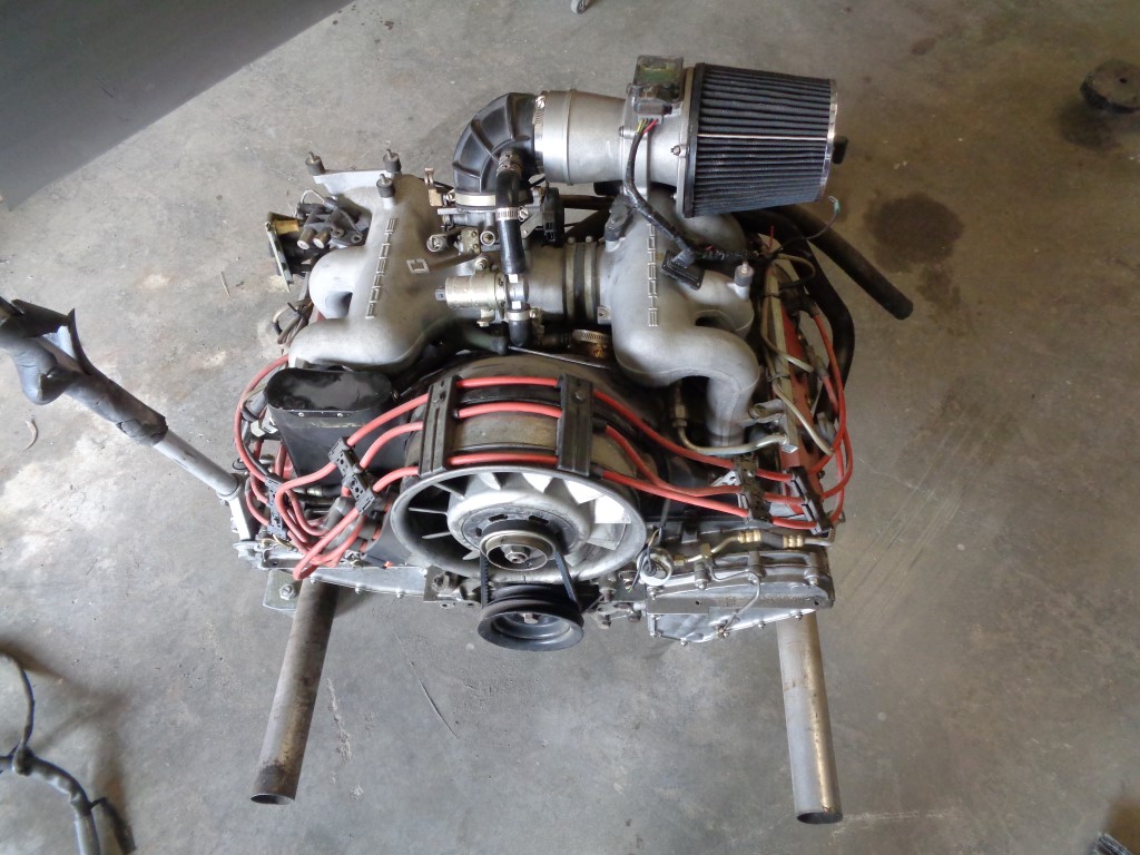

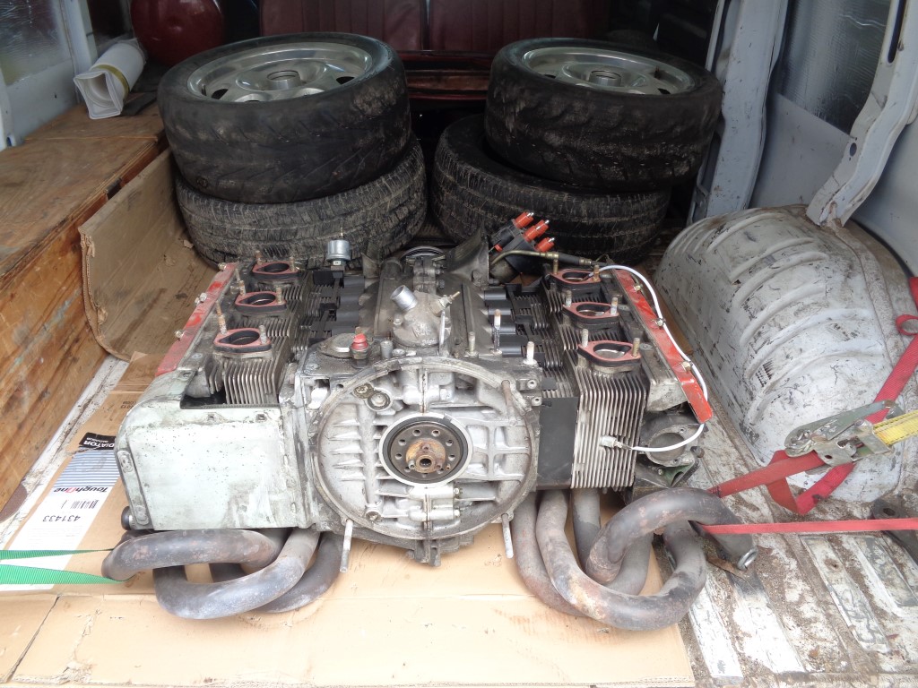

Tore down the engine and delivered to the builder
bigkensteele
post Apr 1 2015, 05:04 PM
Post #477
Major Member
Posts: 2,200
Joined: 30-August 04
From: Cincinnati, OH
Member No.: 2,660
QUOTE(scotty b @ Apr 1 2015, 02:58 PM) *
Scotty, who is the builder, and are those wheels in the second photo 911 spare rims? If so, what width? Look like they could be "7s, which I didn't know they made.
scotty b
post Apr 1 2015, 05:07 PM
Post #478
rust free you say ?
Posts: 16,375
Joined: 7-January 05
From: richmond, Va.
Member No.: 3,419
The wheels are Mercedes.

Cairo94507
post Apr 1 2015, 05:57 PM
Post #479
Michael
Posts: 10,709
Joined: 1-November 08
From: Auburn, CA
Member No.: 9,712
Wow! That is a big freakin' hole you cut in my trunk. (IMG:style_emoticons/default/lol-2.gif)
Anyway, what has got to be has got to be. Can't wait to see the new panel welded in the floor and the reminder of the oil cooler fab-work done. I know for sure where the oil lines turn into the trunk Scotty will make a nice piece to cover and protect them. (BTW, thank you Jeff for the beautiful lines)
The engine is coming along nicely. I expect that to be back with Scotty by the end of the month. Doing a complete rebuild, all new bearings, rings, replacing the pistons and cylinders (staying 3.2) using the 964 cams and the heads are getting new guides, valves, etc. I expect the engine will be perfect. I really like the guy doing the work - he has over 30 years building Porsche engines and definitely knows his stuff (Thanks Scotty for the hook-up).
