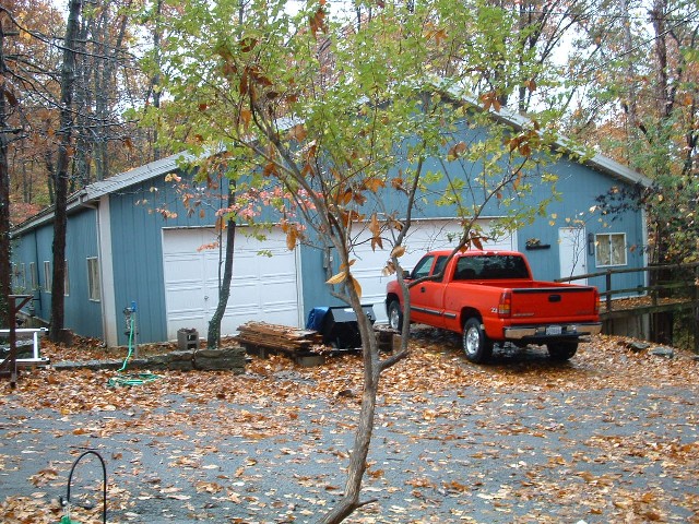

Here's the workplace for the day.

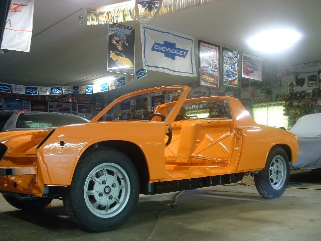

Here's the car -well roller. I did get the wiring harness installed since I took the pic. -Yes I'm slow -lol.

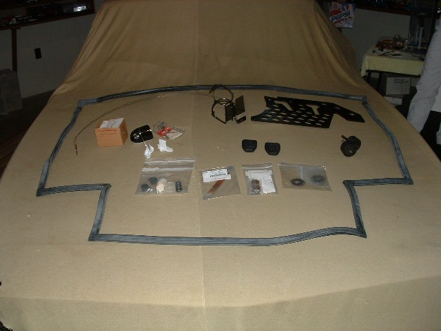

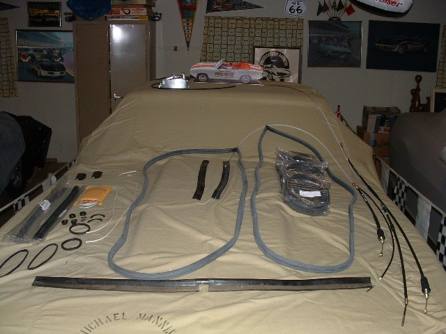

Some of the parts ready to go.

more seals and parts ready to go

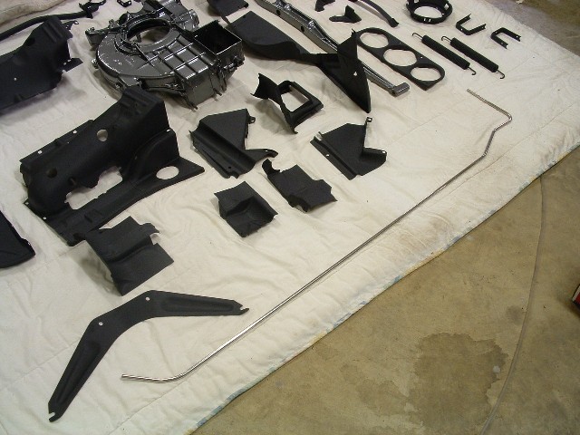

more parts

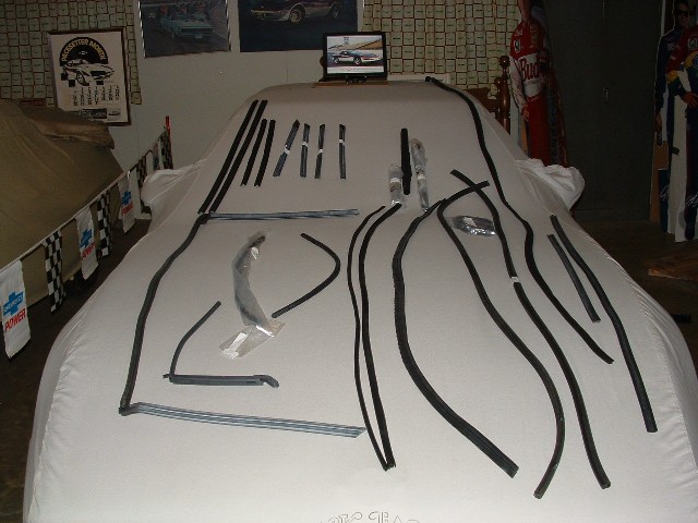

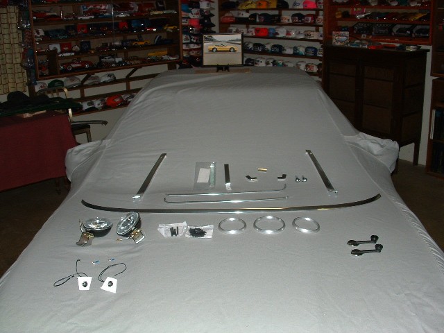

lights and trim

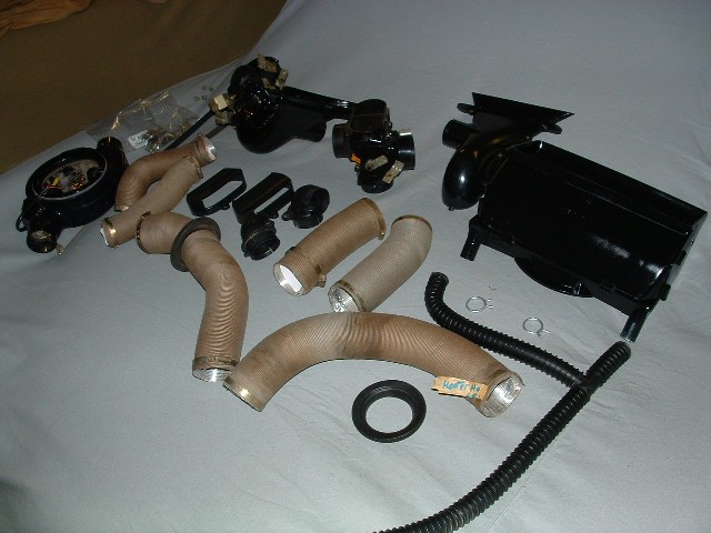

Air box and ducting - clean!

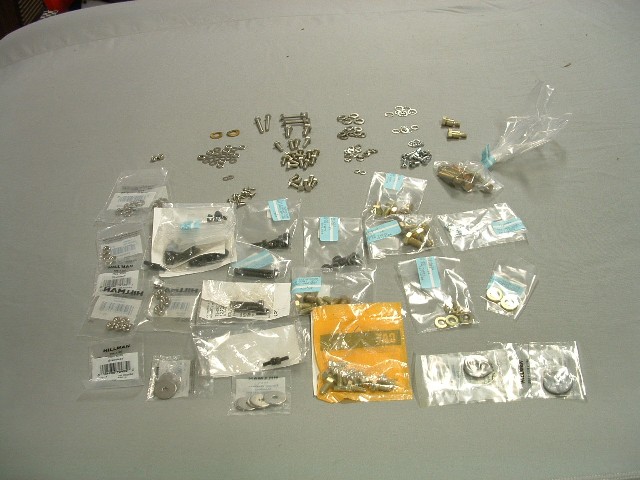

Some new hardware

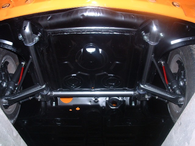

This is some of the work that has been done to the bottom side. I'm posting this one just because I like this pic -lol

Where did you get all that new hardware? I am in the process of doing the same thing to my car, but it is not even painted yet... Do you still have the "list" that you put together when you bought the hardware? If you did, it would be a huge help to me if you could pass it along - Oh, and by the way.. I love your "garage" !!!
Most of it came from Ace Hardware. I have found 2 Ace Hardware stores that have a good selection of SS fasteners. One of the stores even has some chrome metric cap screws! I could't resist, I had to buy a few. I also got many of the bolts from a Caterpillar parts place in Indy - thanks for the tip Sean. THe bolt heads have "CAT" stamped on them.
I do have a list of fastener sizes that I have purchased. At some point I will post the fastener info that I have.
One of the things that I'll be watching out for is to make sure that the fasteners that I use meet the duty requirements. I made sure to use the proper grade bolts when installing the suspension pieces. I will use SS where I feel comfortable. But if it's a potential safety issue then I'm using the grade of bolts that the factory used.
Engman
post Oct 19 2004, 11:54 AM
Zoisite
Posts: 1,349
Joined: 25-March 03
From: New Albany, IN
Member No.: 475
Be very very careful where you use the ss fasteners. Unless you get the real real expensive stuff (and ACE dont cary that) this stuff is the equivelent of a grade 2 faster in terms of strength. Engine sheet metal, cover panels, etc are fine for the ss. Do not use it anywhere you need the stength of a grade 5 or 8 bolt. I hope this is where you intended to use the ss.
