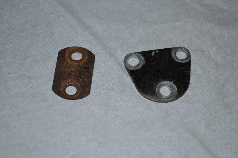

What is the correct coating for the headlight pivots & the headlight bracket plates?
I know the headlight motor arms are supposed to be yellow plate. What is it for the rest? Does it depend on year? 914/6 vs 914/4? Day of the week? How drunk Hans was? Supervisors mood?
Most of these parts are painted over in bad repaint jobs of the cars. For those who are wondering, I was thinking about getting them plated in the correct plate if
possible.
What is your opinion? (IMG:style_emoticons/default/smile.gif)
Attached ImageAttached Image

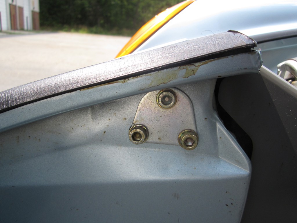

From the 28,000 mile car that came by last week. This is exactly why I took this pic (IMG:style_emoticons/default/biggrin.gif) The backing plate in person is significantly more silver looking then the yellow on the bolts.

Been through many of these mounting plates and they were all silver plated. The bolts are gold plated. I have seen a few that people have had replated gold, but I am 99% sure they rolled out of the factory silver.

You can see the sacraficial layer of zinc, some of it remaining in the 28,000 mile car pic, and I can say that my cast pivots had yellow zinc remaining/ that they were originally goldish in color.

The plate should be clear zinc and the fasteners are yellow cad.
