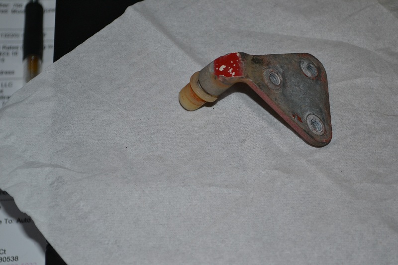

From the 28,000 mile car that came by last week. This is exactly why I took this pic
The backing plate in person is significantly more silver looking then the yellow on the bolts.

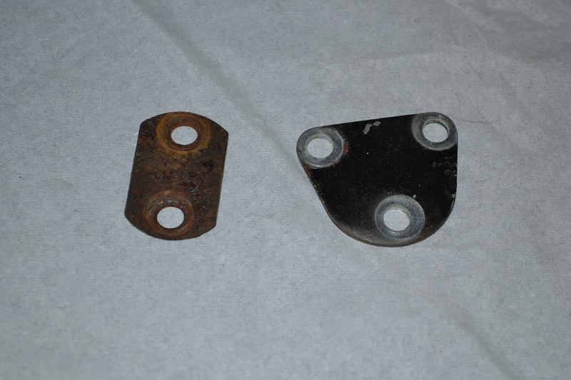

Been through many of these mounting plates and they were all silver plated. The bolts are gold plated. I have seen a few that people have had replated gold, but I am 99% sure they rolled out of the factory silver.

The cast metal 'arms' or pivots were bare though.

You can see the sacraficial layer of zinc, some of it remaining in the 28,000 mile car pic, and I can say that my cast pivots had yellow zinc remaining/ that they were originally goldish in color.
