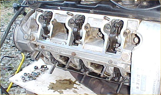

Trekkor
post Oct 20 2004, 09:29 PM
I do things...
Posts: 7,809
Joined: 2-December 03
From: Napa, Ca
Member No.: 1,413
I did it...Yippee (IMG:style_emoticons/default/boldblue.gif)
Took about 2 hours. I took off valve covers, cleaned 'em, cleaned off the heads. Adjusted 'em all, and painted my headers.
Open sez me...
KT
Aaron Cox
post Oct 20 2004, 10:21 PM
Professional Tinkerer
Posts: 24,548
Joined: 1-February 03
From: Corona, CA
Member No.: 219
nice... first time ive ever seen the inside of a 911 head
