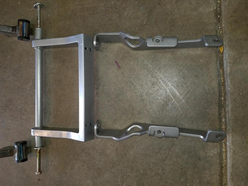

Ben - I have every item but the cradle. Instead of a cradle, I have a bulkhead mount - which I like better because it doesn’t get in the way of the exhaust. Whatever you want to look at to improve and produce is yours. Just let me know when to pack it up.

Can you post a picture of your bulkhead mount? I think we'll fab a cradle - they don't look very difficult, and I suppose we could jig up to make them, I don't expect there to be a huge demand, but it would be nice to have them available for those of us that want to do the swap.

http://www.914world.com/bbs2/index.php?sho...5&hl=cradle

Cool, has that mount been used for very long (durability)?

I don’t think it has ever been used. It is a combination of a small car Suby mount and a custom bulkhead mount. I plan on using it for my 3.3 conversion.

Mark I did not know you where listening to my rant against the cradle. Wow that looks familiar did not know someone else did on of these also. I like it (IMG:style_emoticons/default/aktion035.gif) Makes me want to redo mine. (IMG:style_emoticons/default/headbang.gif)
Ben you should start building this mount, even if the person has to purchase the small car mount separately, but I think you have the skills to build one that eliminates the bolts. If not you, I would love to setup the cut files and load it into a CNC plasma or water jet. Could make it so the center bar bolts in option to weld it in. Coat it in Steelin and it would be weldible or bolt on and be done. Smaller shipping box that way, reduce shipping costs. If you built the from holder with a plate it could also be a bolt on or weld in system.
That just leaves the trans hangers, again I am down with making this stuff also just not sure how deep the water is in this market.
Bulk head trans mount is the way to go.

Scott Amerson told me it would be a good fit for my project so I bought it and sold the cradle. I remember Ross had some issues making the exhaust fit around the cradle so the bulkhead mount makes sense.

I'm working on reproducing Ian's cradle with a few improvements.
I hope to have a functional prototype later this month.
If you're interested in one please let me know as the more I make, the cheaper it gets.
