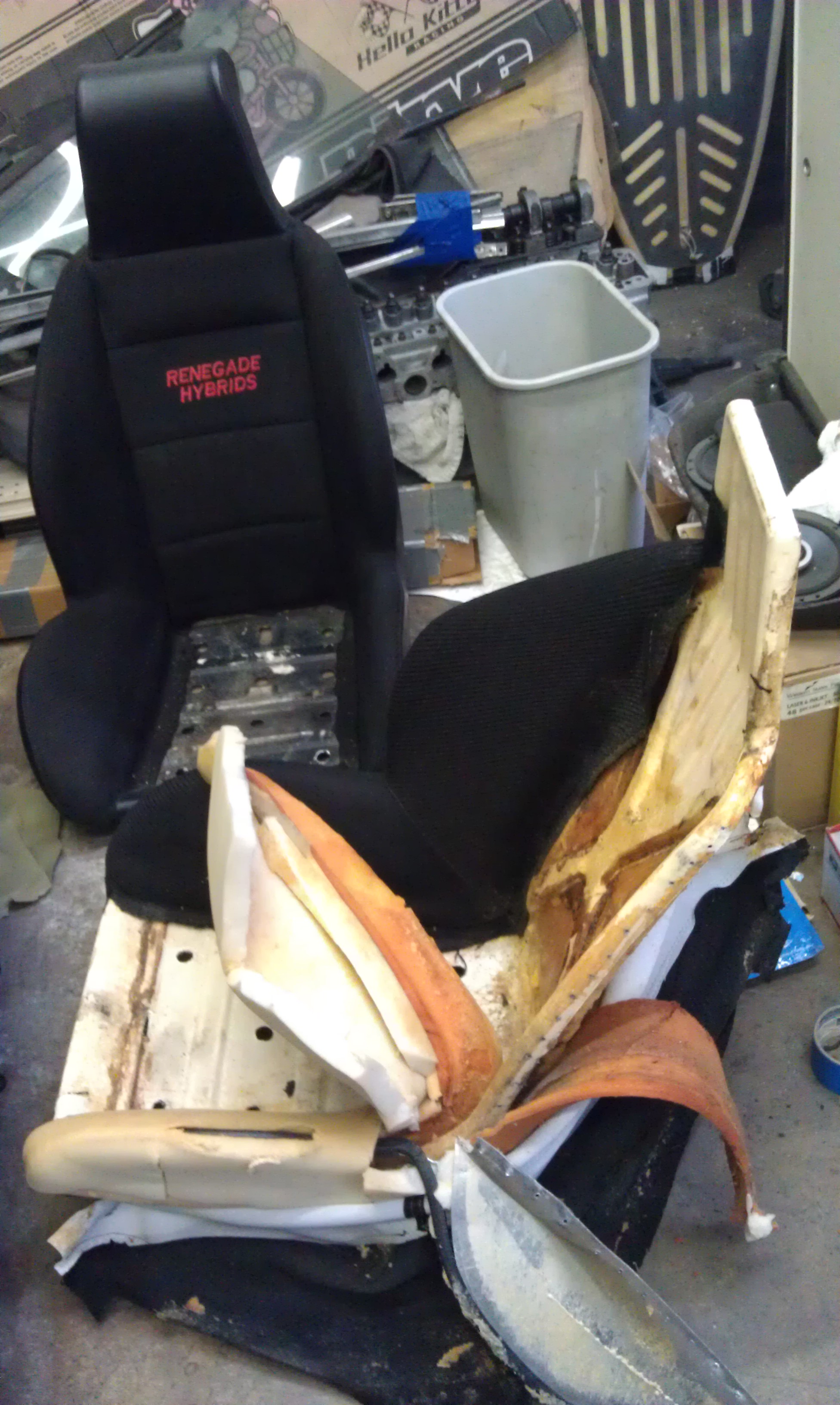

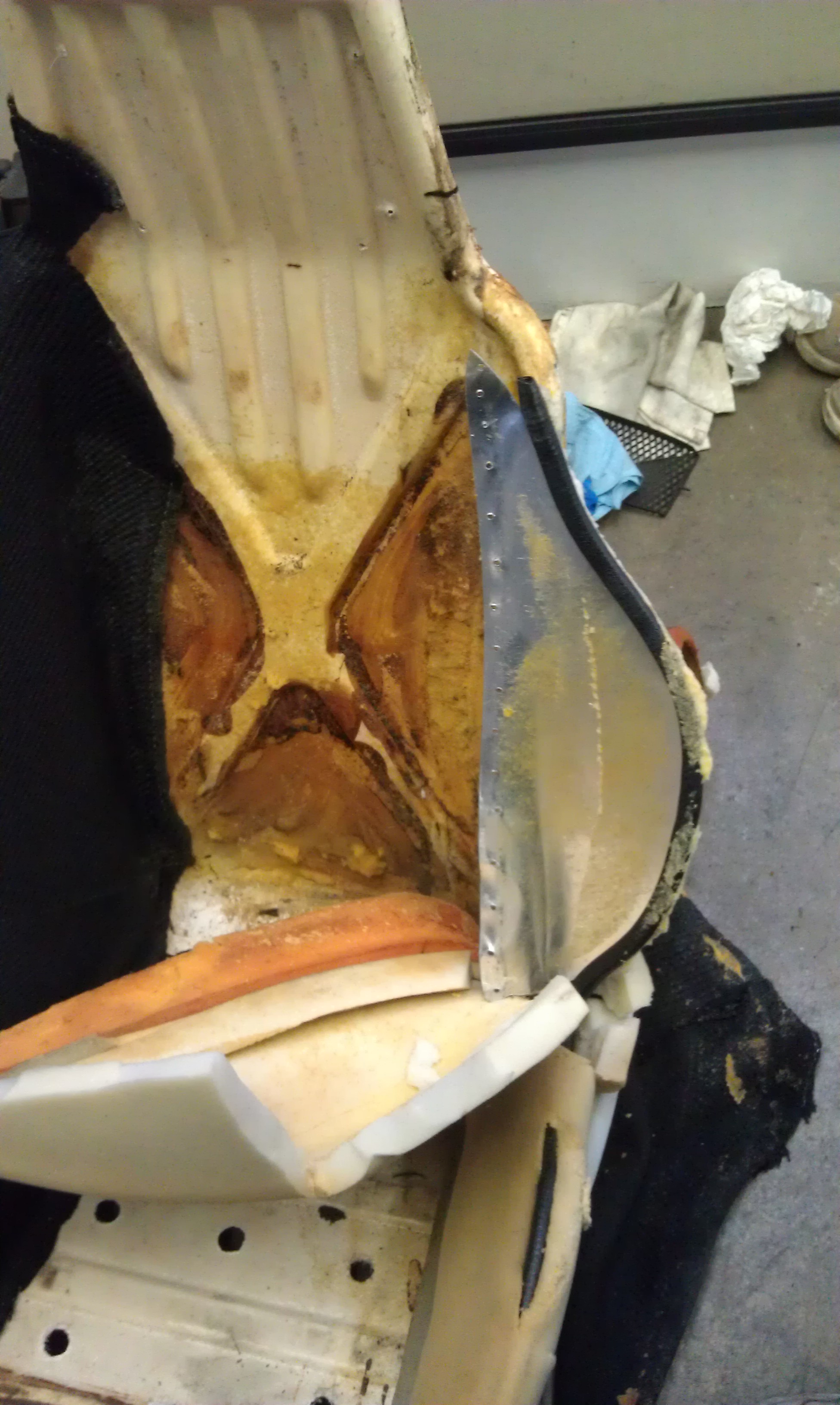

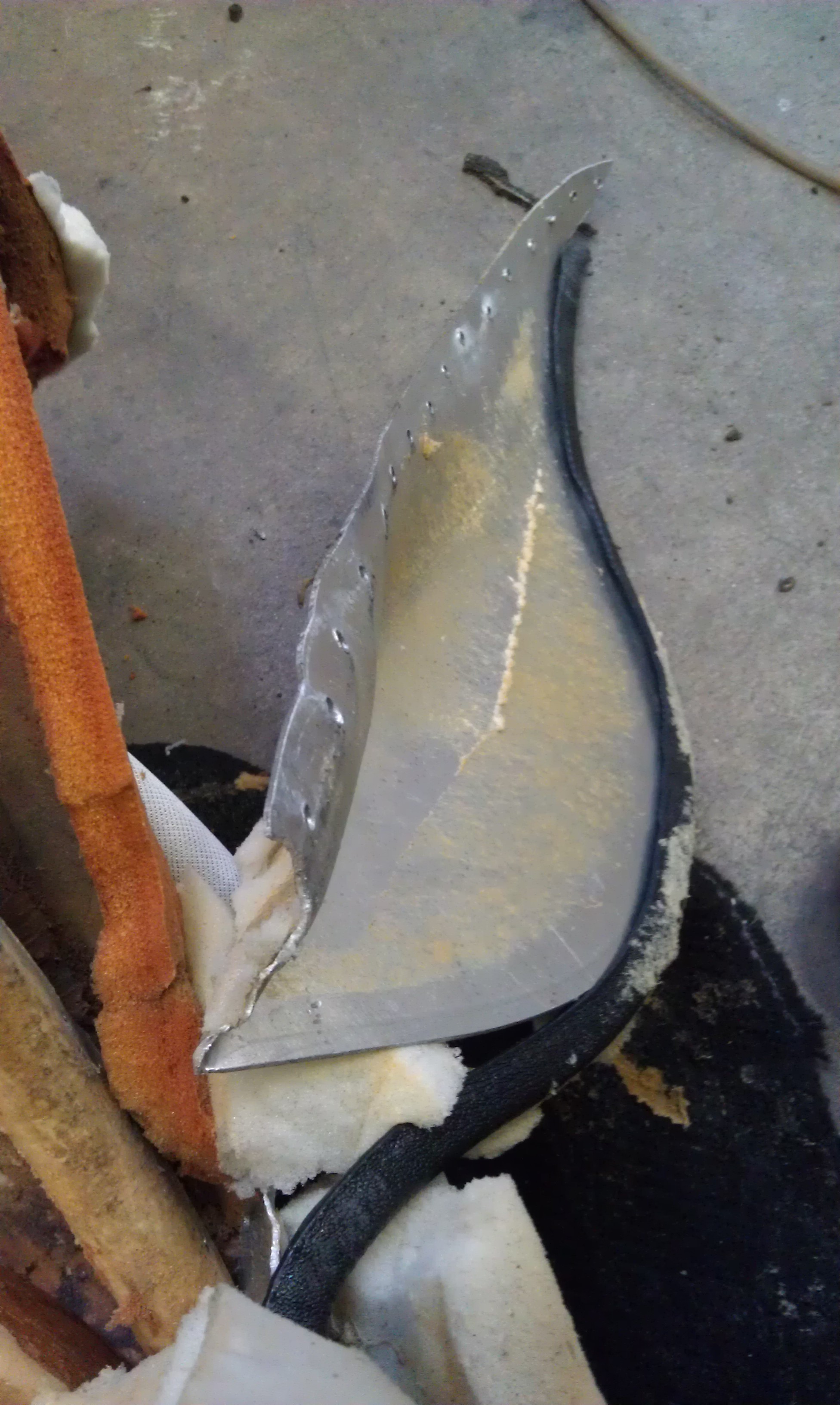

its a real 914 seat with added aluminum "wings" . the wings are riveted onto the OEM FG shell. the attachment point is too weak and the aluminum wing is also too weak. it flexes with ease and the movement of getting in and out of this VERY deep bolster will cause it to break with daily use

ill post photos of the fix. 2 steel wrap around ribs riveted to the FG shell and the wings
epoxy the broken head rest and epoxy teh wing attachment and rivets

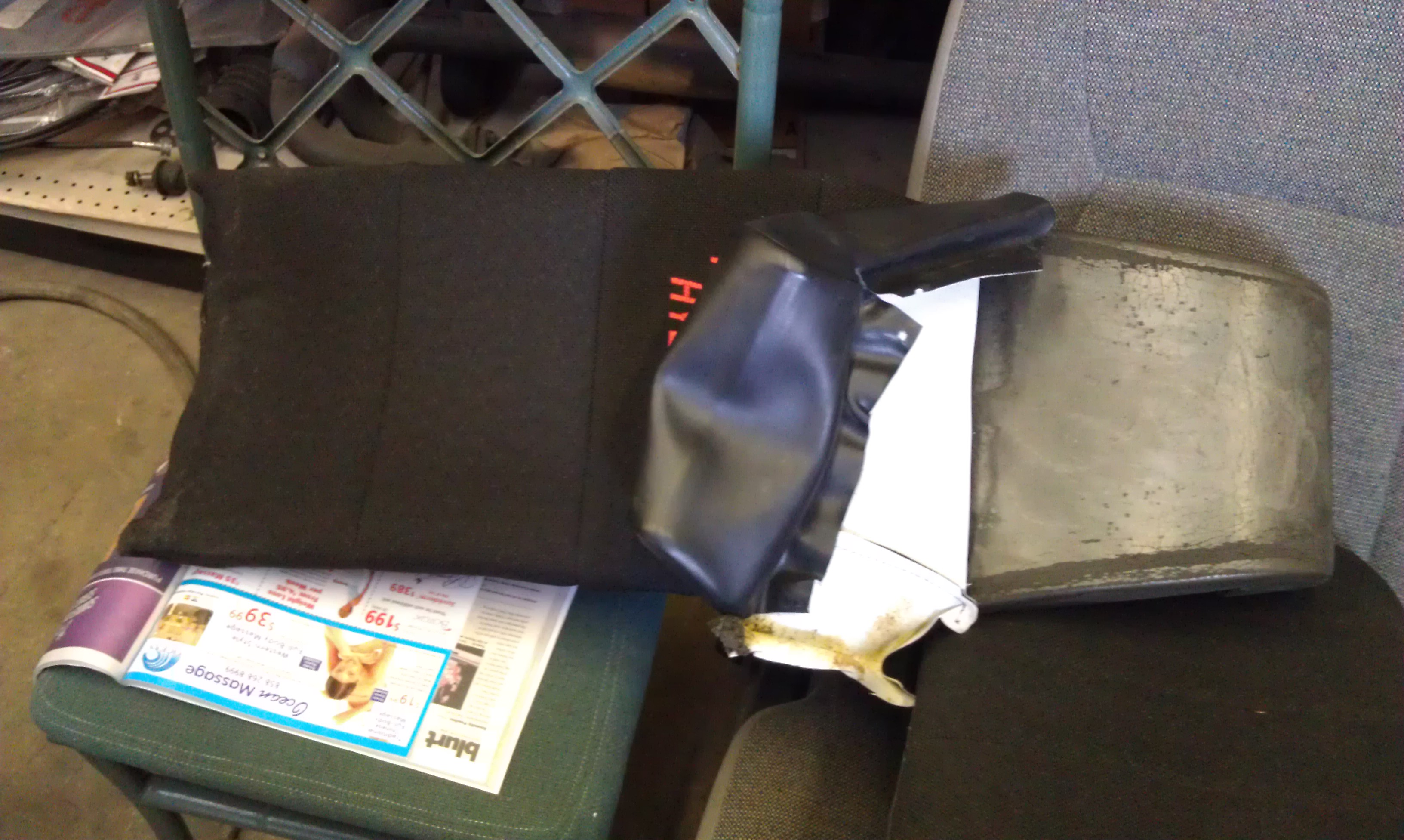

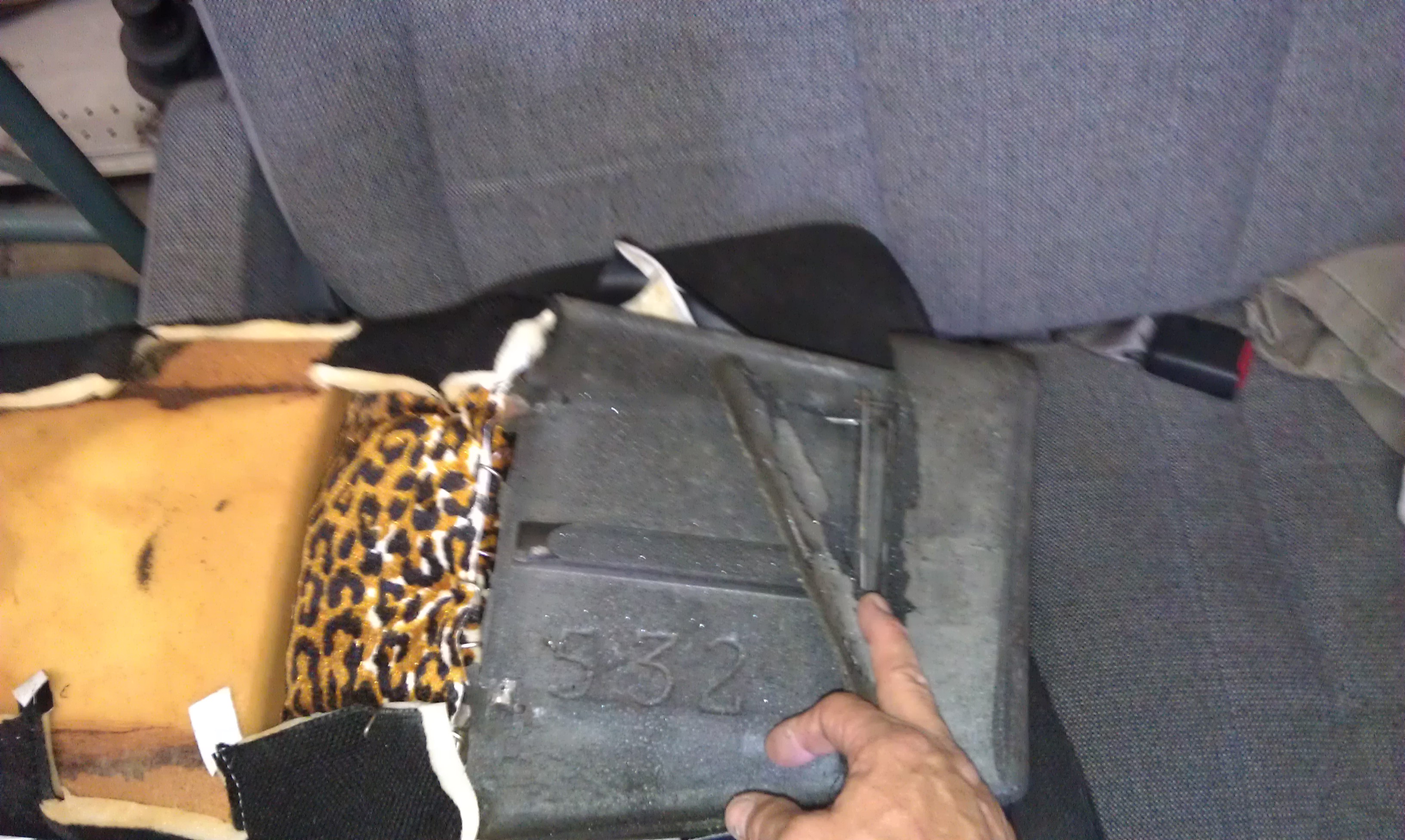

head rest foam block wraps around OEM wire frame. wire frame is screwed to FG shell

wing was 1 pc per side

Before this becomes a flame fest. These are my seats, and I had asked Sean to take a look at them. The side bolster was already broken when I acquired my car, earlier this May.
Thanks Scott, for standing behind your product, except I didn't purchase my seats directly from you. It came with my car I bought.
What happened to the driver seat? Who knows? It just happened that a question was posted and my seat was torned down for repairs.
Thank you for your time.
