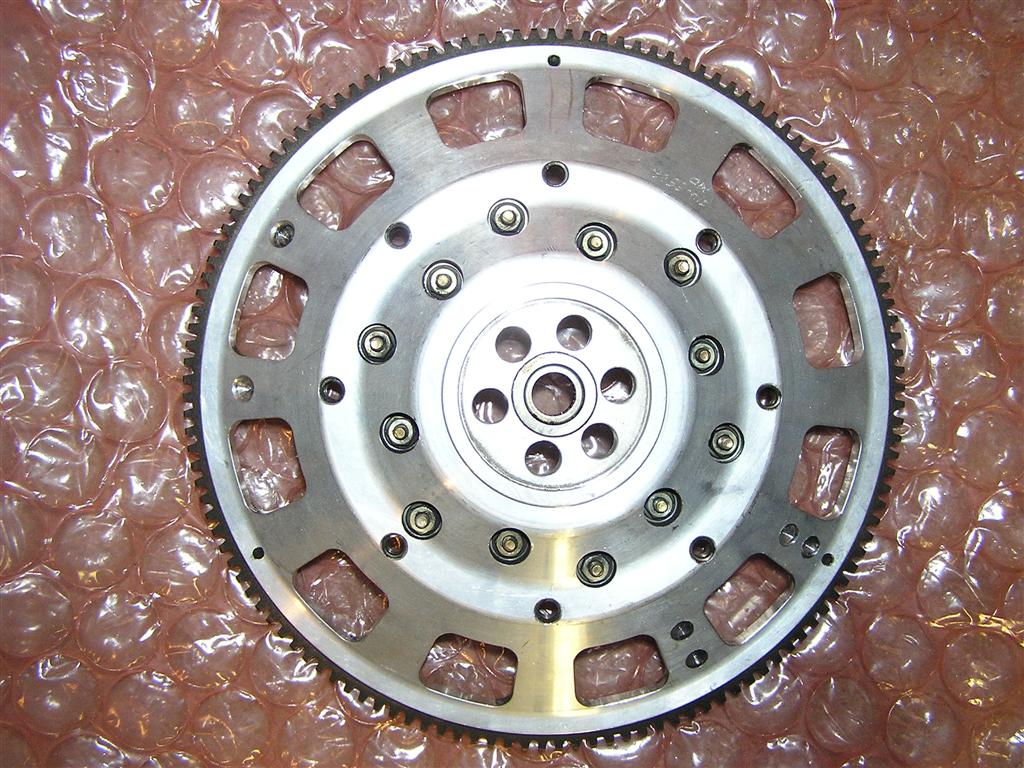

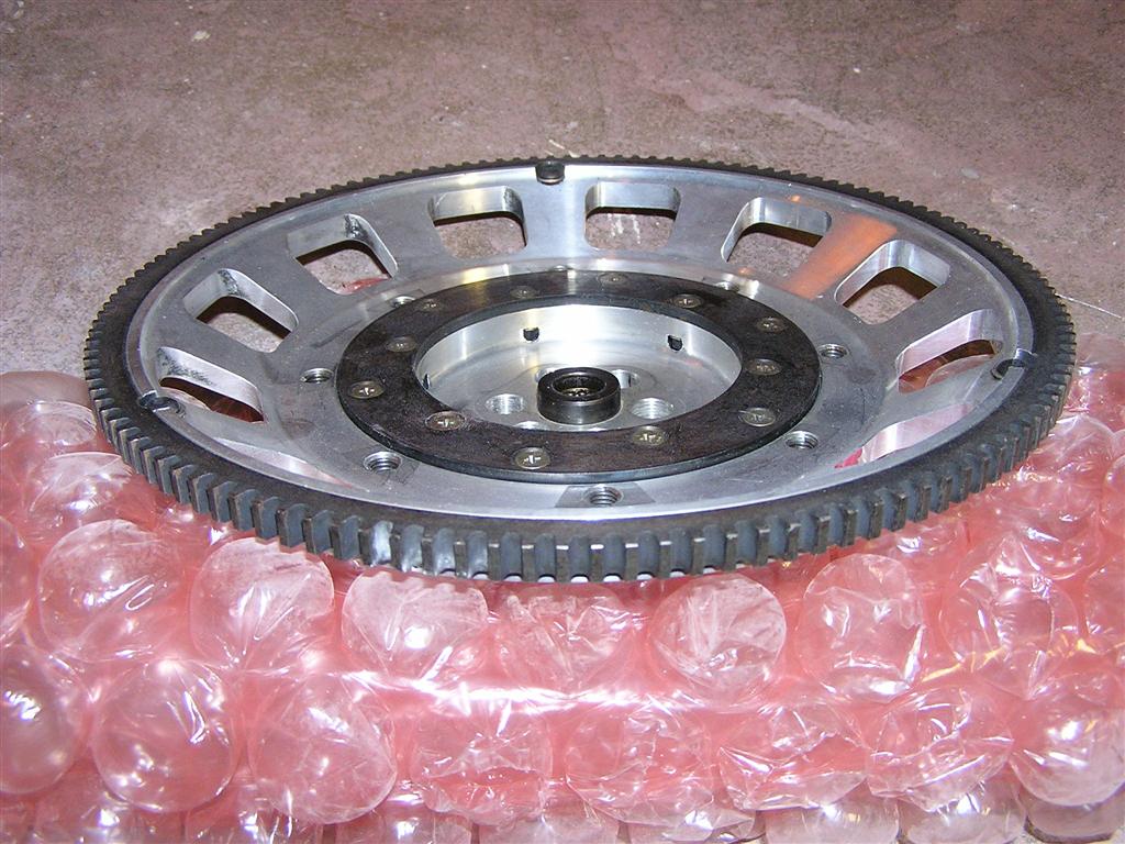

The new flywheel (not installed yet)
its the 4th different flywheel now
we upgraded once
we broke one
3rd one is not to be discussed
and here is the 4th, lightest one yet.
this one is for the new motor in a few months:
its actually used and came from Frank Beck's race car....

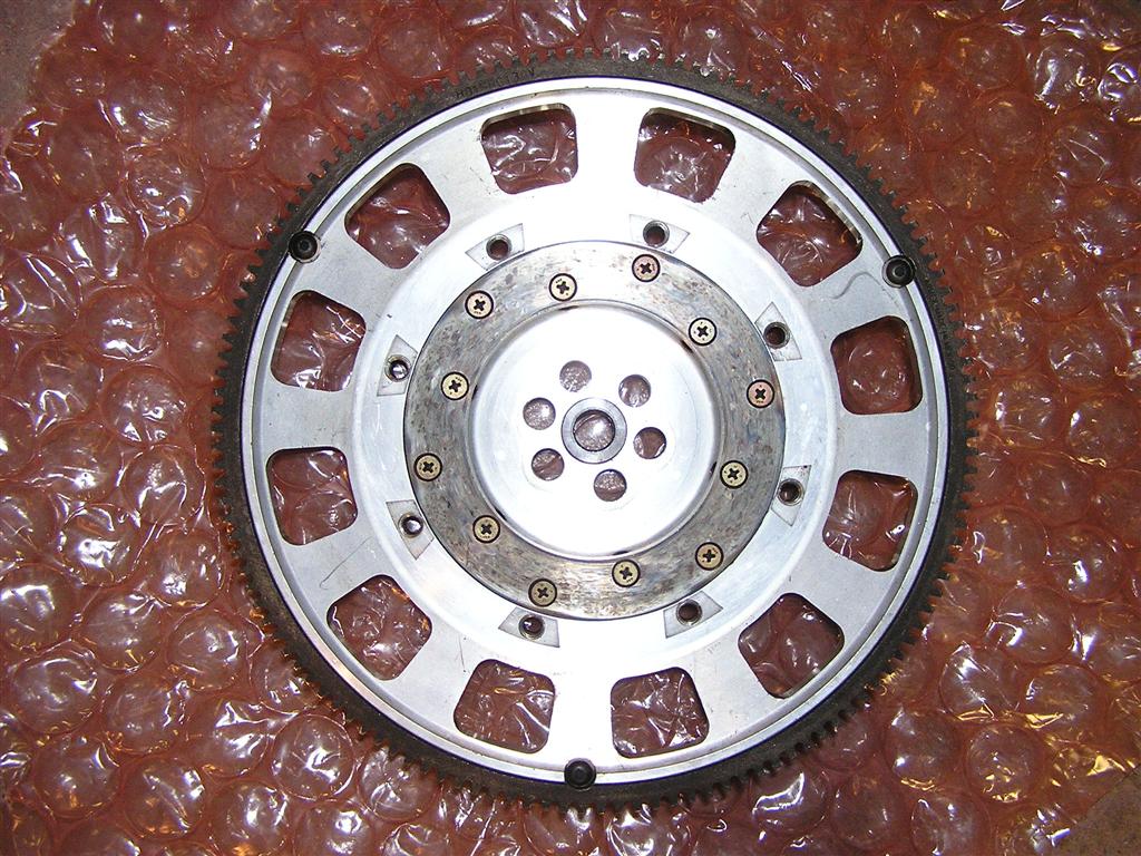

and:

(IMG:style_emoticons/default/drooley.gif)
Dude, that's pornographic.

QUOTE(Todd Enlund @ Aug 23 2008, 02:28 AM) *
(IMG:style_emoticons/default/laugh.gif) Everything in this build is true porn quality! (IMG:style_emoticons/default/w00t2.gif) (IMG:style_emoticons/default/w00t1.gif)

Dude thats not a clutch its so tiny.......?

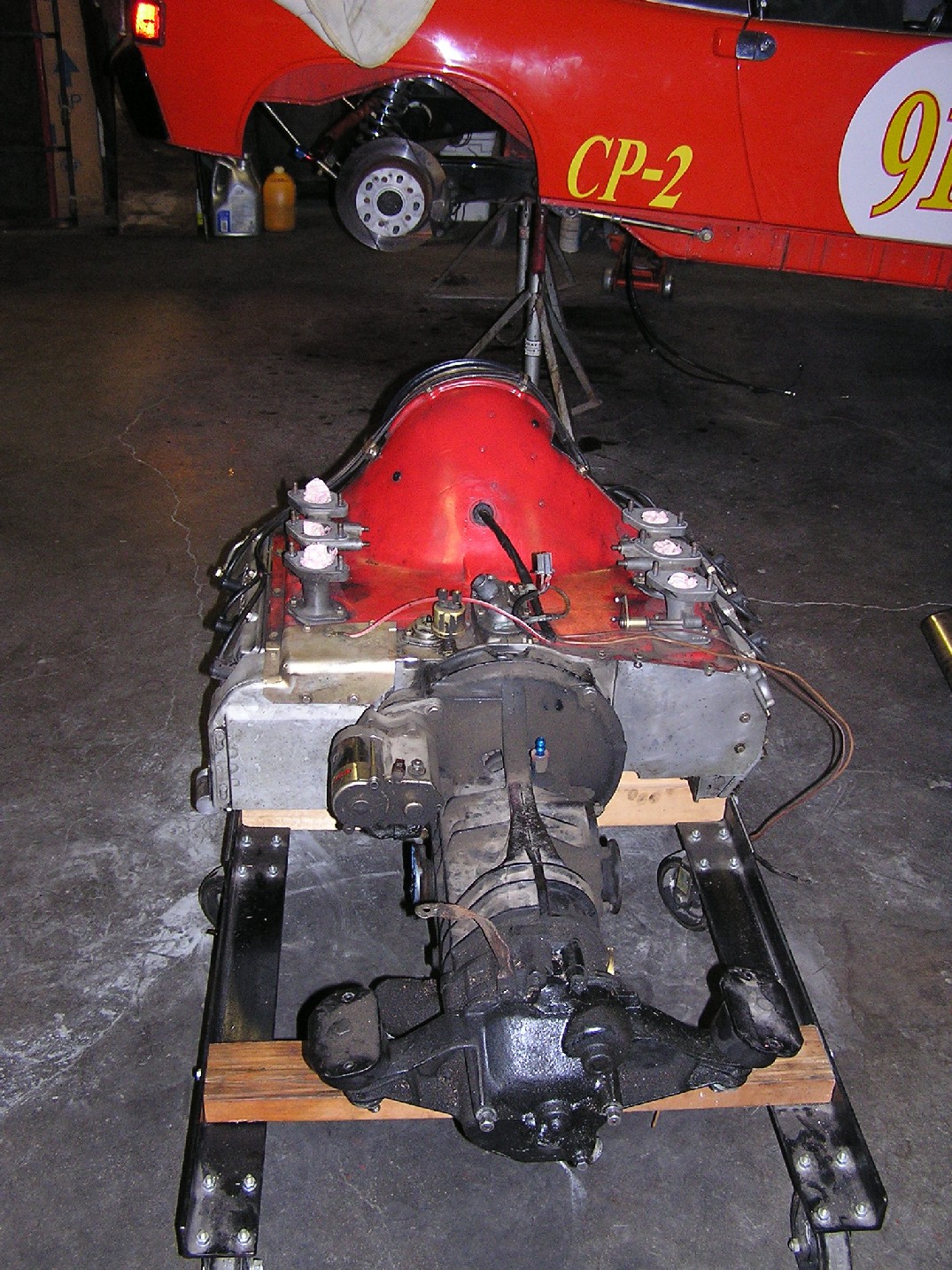

I don't have many updates to make....
today we did "out with the old"
the old is tired and dirty.
I don't have any "in with the new"
but hope to in a few months.....

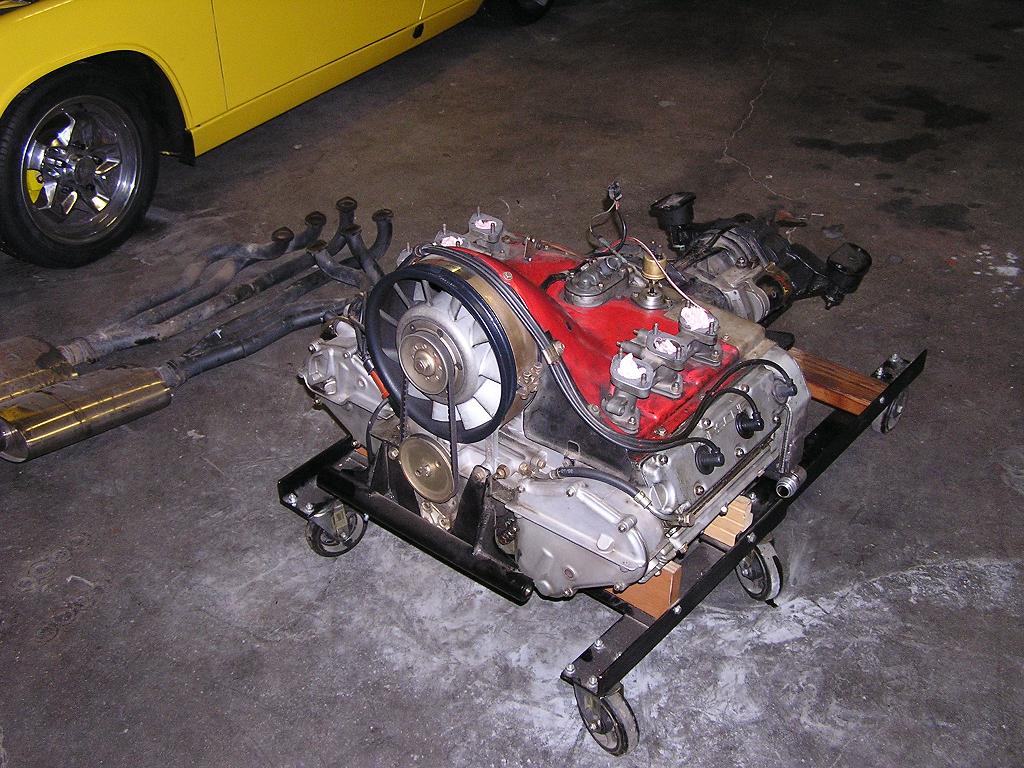

another:
brant
post Dec 15 2008, 02:00 AM
Post #475
Posts: 12,279
From: Colorado
Member No.: 47
last dirty picture for now....
things will look better in the future:

Brant,
Your concept of "dirty" qualifies you for a white cotton glove courtesy of Ferg... (IMG:style_emoticons/default/biggrin.gif)
That motor looks cleaner than most fresh rebuilds that are put back -into- cars. And that one is coming -out-...

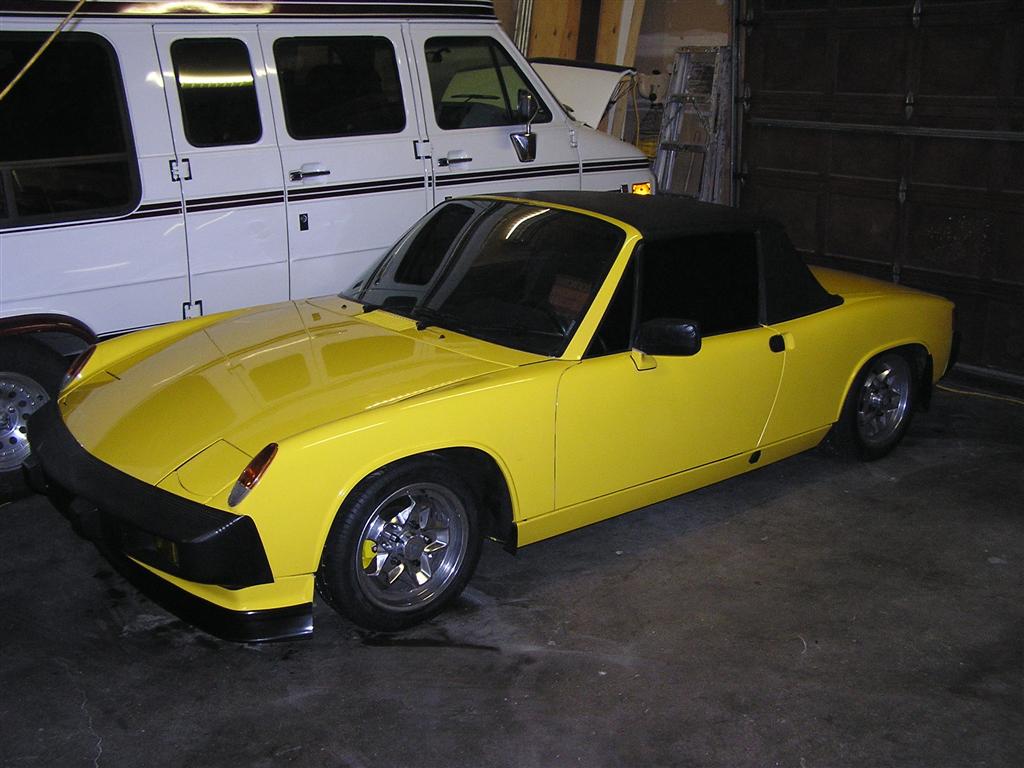

post May 30 2010, 08:21 AM
Post #480
Posts: 12,279
From: Colorado
Member No.: 47
whew...
found my thread in a search for something else
I need to get with it..
a year later:
-orange car is still running the old motor
-orange car has been hit again and both rear fenders are stripped currently.
-and I drive yellow car daily... (need to sell it)
time to start following through and doing!
