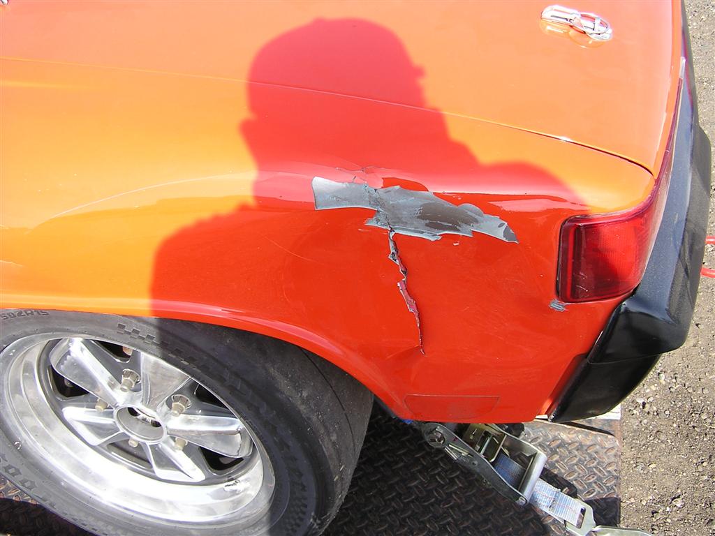

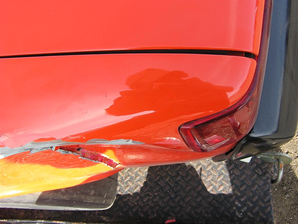

here is post-accident..... the day of.
now both rear fenders are re-worked and in primer
going in for top coat tomorrow-ish
torn weld:

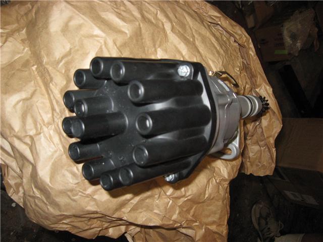

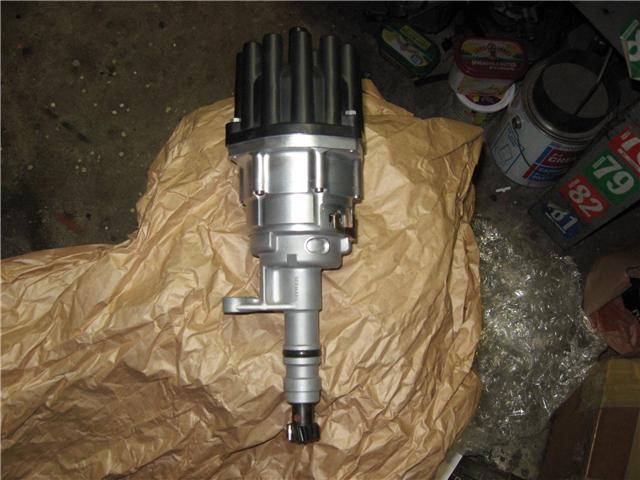

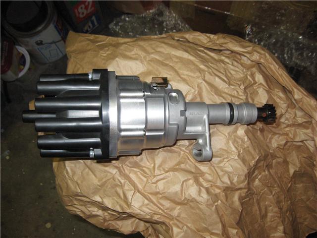

new motor is still coming together
here is the new distributor:

QUOTE(brant @ Jun 15 2010, 11:52 PM) *
(IMG:style_emoticons/default/drooley.gif)
Who made that one? I have an Electromotive crank-fire unit ready for my Twin-plug, but thinking of selling it and getting a 12 Dizzy from J-B Racing

QUOTE(carr914 @ Jun 16 2010, 01:19 AM) *
T.C.
funny.. I bought an electromotive too (for sale soon)
this one is from Aaron at Rennworks. We did a lot of research and found out that many of the manufactured units don't have upper bearings. The heavier than single plug rotors are causing lower bearing failures and upper wiggle due to racing and extended high rpm. This one has an upper bearing unit installed to prevent that

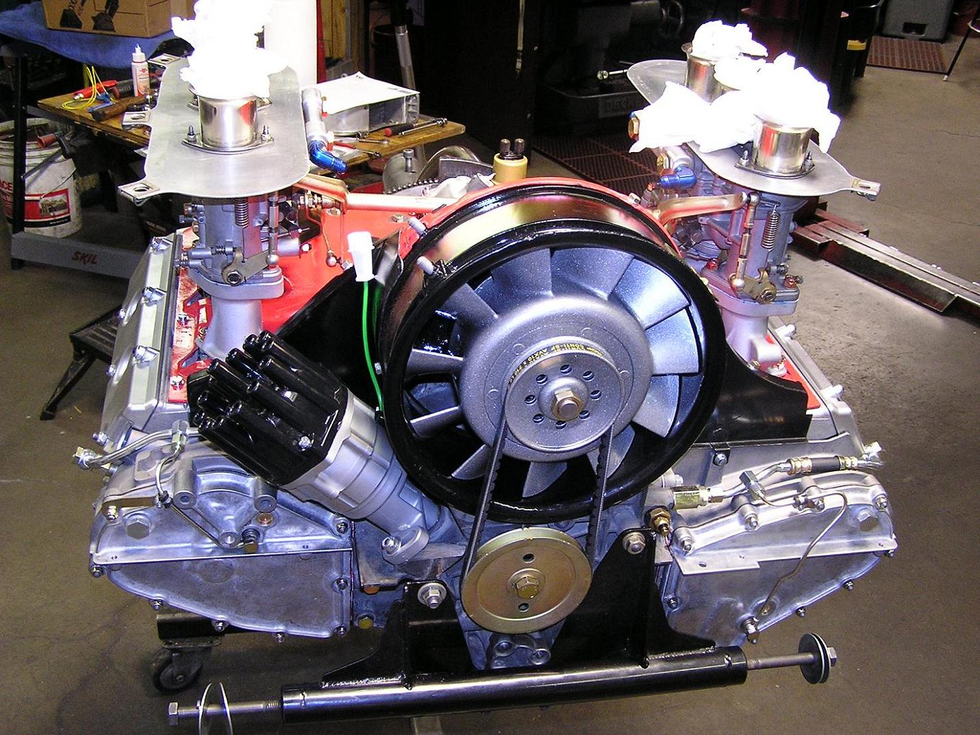

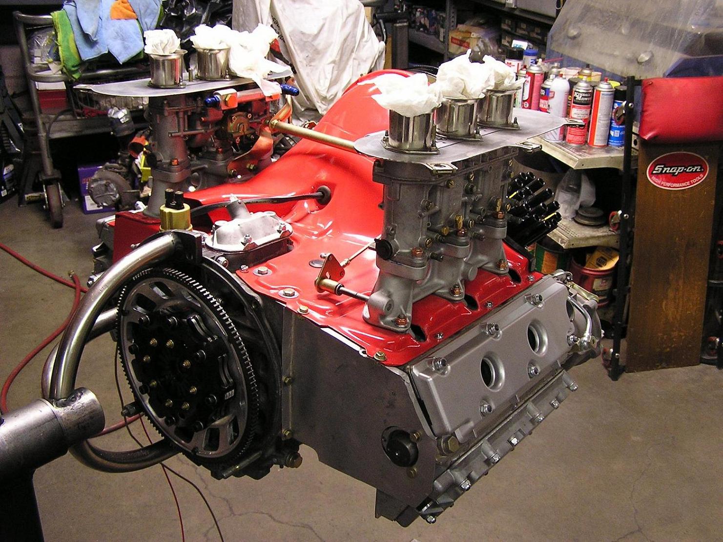

Well today I installed the new motor
were taking 4 days vacation to wrench in grand junction and hope to pour oil in tomorrow...

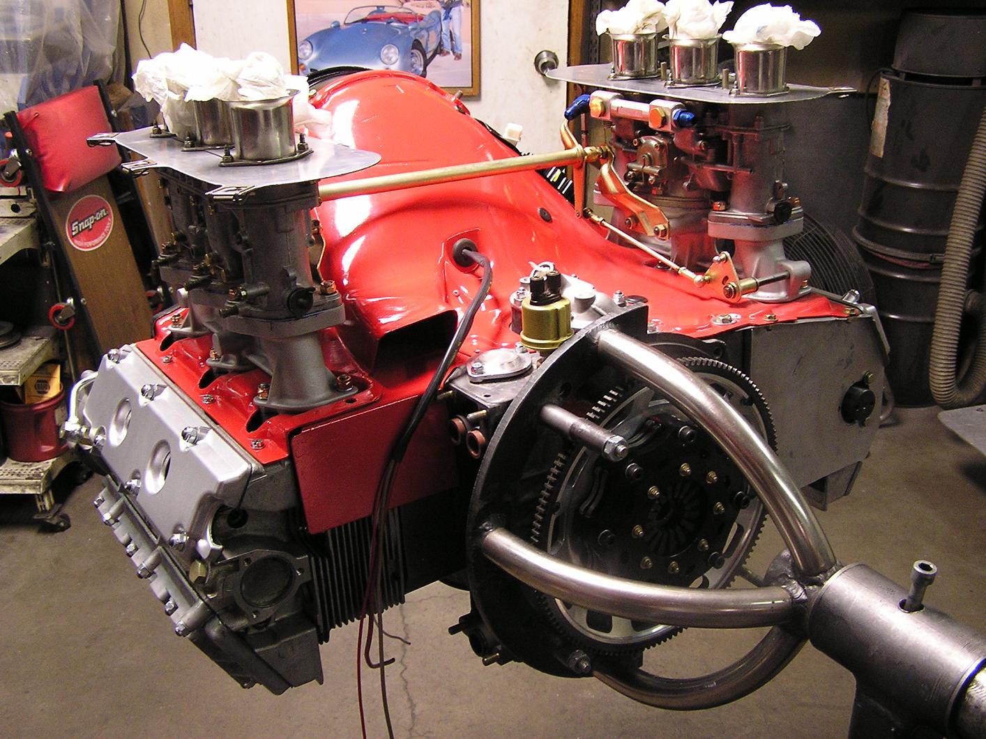

here is the new tilton (all new plates, discs, and housing) bolted to mr. Becks used flywheel:
brant
post Mar 2 2011, 09:40 PM
Post #489
Posts: 12,279
From: Colorado
Member No.: 47

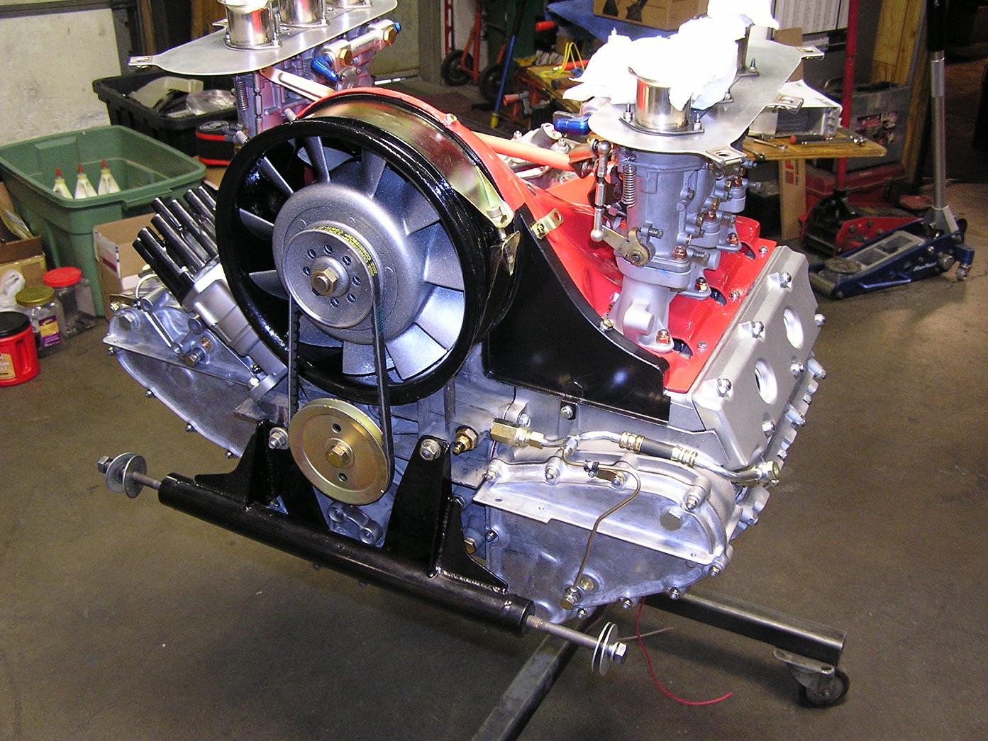

Carbs were rebushed last year...
new ITG foams
(I painted the shroud)
New upper and lower valve covers
a mild compression full motor
pauter rods, trick heads, 81mm bore
Mr. Shea had all of the zinc plating done for me
1973 7R case
PMO tall manifolds (ported)
rennwork distributor
all replated fan, etc.....
should probably be safe to 8k
brant

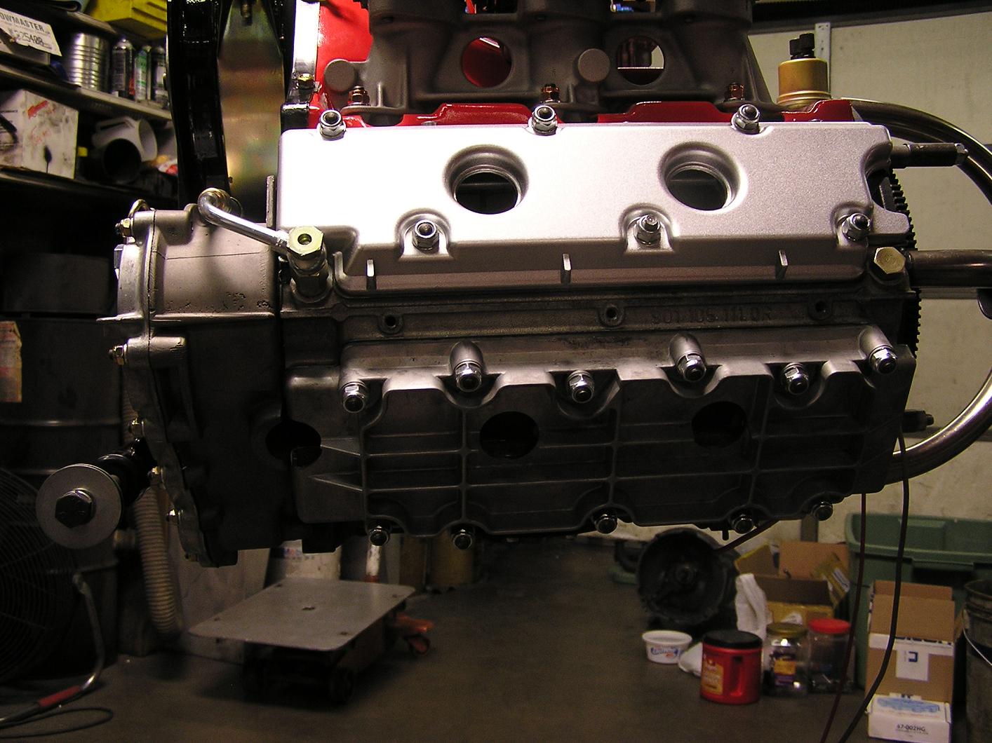

a couple more I need to store here:

and the mag case should be 20lbs (or so) lighter.....

Great looking motor, what's the size? I'm guessing rather high c:r with the twin plugs.
Is that the Patrick Motorsports engine mount...looks cool.
